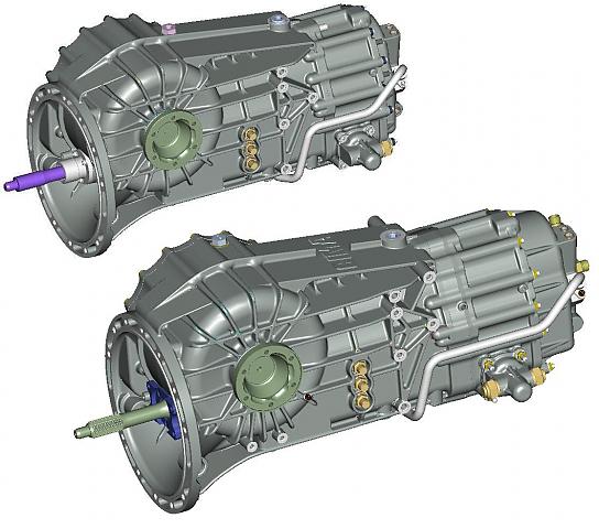

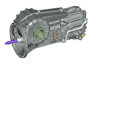

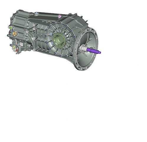

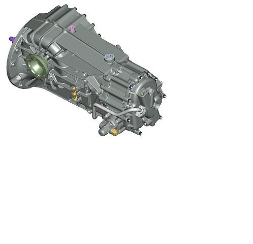

7 speeds but extremely compact and cost effective.
Appreciate first thoughts attached
  • G1007.pdf

The lenght will be in the area of 500 mm. The out put flanges are off setted only 40 mm from the engine central line. This unit has been designed to replace the Lamborghini Gallardo unit.
It is calculated for 700 Nm. The input gear change is what do you want. All my transmissions are borning to be H pattern, mechanical sequential and automated. RPM in the area of 8.000 revs.
This unit is a 3 speed with low mwdium and high.
The primary and thre thirthiary are shifting together when i shift to 4th by going back to first and shifting medium, and so on.
The potential is to have 9 forward speed without adding gears. Just by turning more the barrel.
With only 11 gears I have 7 forward + 1 reverse. normaly 17 are neede to achieve this job.
Open deck design with isostatic shafts and shifting on a separate cover.
Estimated weight is 65 Kgs.
7 gears because now Formula 1 has 7 and to keep the engine neer to the top power area after upshifting.
This concept works every day in the SMART which is a 3 speed high and low with 2 crown wheels.
Regards
Wanni

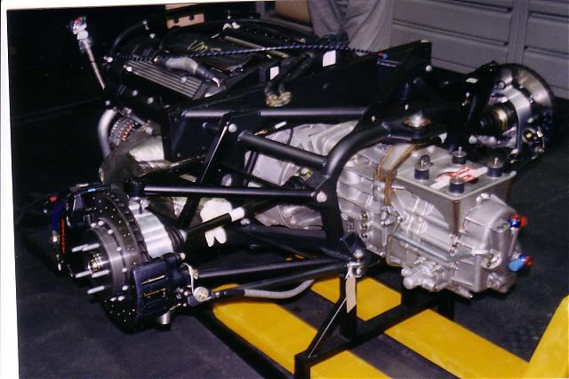

Or probably this is the easyest wayto fit in a GT 40.
Finally my boys have finished the down sizing of T756H getting in T606H.
It is 74 mm shorter. Enough to fit as a perfect replacement of a ZF, but with 6 forward speeds and 1 synchronised reverse.
The diff is " TORQUE SENSITIVE " unit.
Not bad.
Ciao to all my competitors......I am now ready to fight with the appropriate product.
N.B. My tooling is already paid.
Who is interested about this unit for .........10.000 €uros ???
Let me know.

The gearbox looks suitable in terms of size and the ability to mount the engine low down as the output flanges are well above the input shaft. However most users would need to have a bellhousing for a Ford small block and release bearing (preferably concentric). It would also be useful if there was some standard flywheel/clutch set up which would allow good levels of torque handling whilst maintaining a low engine level without danger of the flywheel hitting such things as kerbs. Would it be possible to produce a final spec and price for the above? I am sure this would make it a much more attractive proposition for people who do not have engineering facilities and would need a "complete solution" off the shelf.
Hi Mike,
in order that GearFox is a producer of concentric release bearings, it will be for sure concentric. Basic or with electronic control of the position ( for paddle shifting )
I am not used to the way you call the engines, but if you refere to the 4,7 Cobra engine, the packaging already exhists.....in the Koenigsegg.
I am sure that Christian will allow to use part of his packaging which is:
Specific clutch triple disk 215 mm with starter ring to the gearbox side, concentric release bearing, bell housing dimensions ( he is using part of the chassis ), flywheel and a nice super starter.
All that made for a dry sump conversion of this unit.
We are now considering all the enquires to make a commercial program.
LS7 will be the first getting the full package.
Wanni
