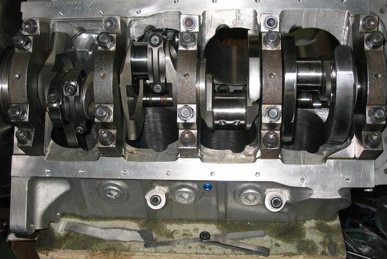

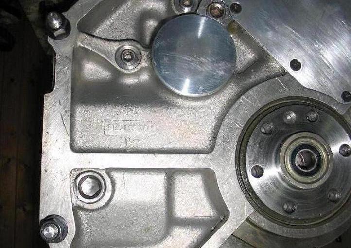

nanard289 said:
Hi Sandy

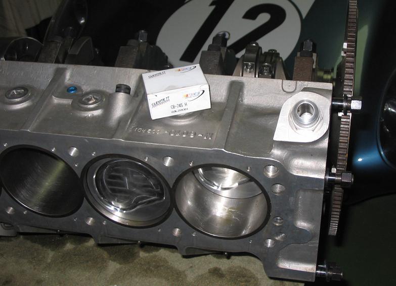

I bought this bloc 4 years ago at fair price from a local racing dealer in the States. To be honest, I don't know exactly the right reference (I don't receive back from the dealer any document nor information). We can see in the front a small Ford logo (from casting) and in the starter side, the ref M-6010. However, it looks like extension of ref was milled and it is stamped 302RDI (see pictures). At the bell housing side, there is an other casting number : BBO19276 with a stamped P- below
As I am not a Ford specialist, I don't know if it is an old or recent block generation but according to the dusty layer when I bought it, it was not from the last issue :o . Any informations are welcome ;) .
This might be one of the Dry sump blocks, It is different then my, I'll have to find some part numbers, It looks like your as only a fitting for the oil filter and my blocks have the oil filter boss. (The RDI site has no numbers listed).
I also noticed the oil crossover in the lifter galley. I had one running from the back of the main feed to both of the front lifter areas. I ended up taking it off as the shop that set it up had is badly 'rigged' with copper pipe and loose fittings. I have not noticed any problems without it, will see on the next teardown.
Again, excellent motor!

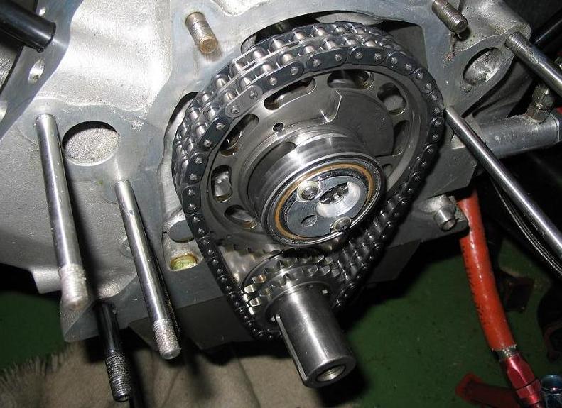

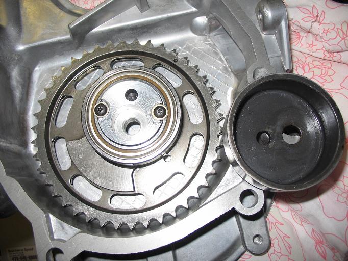

nanard289 said:
:p:
Picture here below shows the original eccentric cam and the modified.
If you want one part like that at fair price, you have to contact Scott Eatmon phone : (252) 237-2437. ;)
Thanks for the thanks on the forum, glad you like it.
252 area code is here in North Carolina where I live. This bit appears to be some sort of roller bearing cam eccentric. Question is, does it use a index hole or pin like the one on the right? I'm using a mechanical pump myself, and you can read about some of my issues with a cam gear that had no pin.
http://www.gt40s.com/forum/tech-engines-induction/19048-fuel-pump-eccentric-how-secure.html?highlight=mechanical+fuel+pump
If this thing bolts on somehow, with no tab or pin, I'm getting one!
Ron
Yes Ron it use an index. Fortunately, my engine is dismantled and I do one picture to show the pin. But be careful, this part is not a "bolt on" type. I have spend some time on my lath to adapt it :rolleyes:

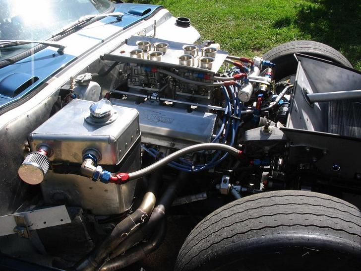

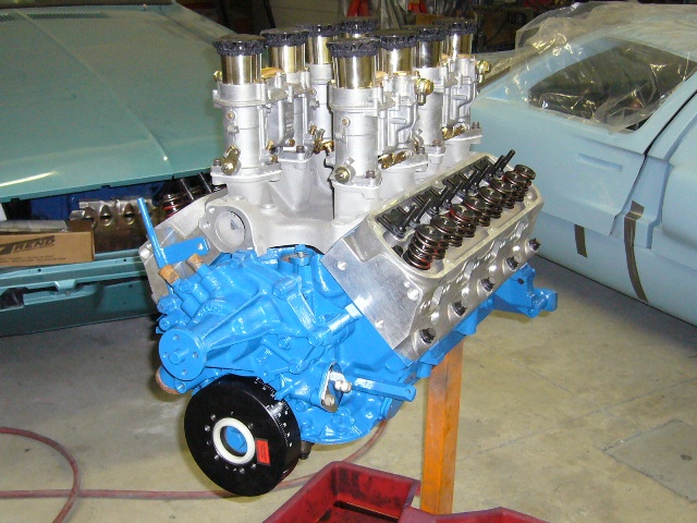

I was hoping my engine build would be done by now. Waiting for the collectors so the exhaust can be completed. Started out as 351W with 30 over and fresh rebuild. He forgot to tell it had been left out in the rain. Everything stripped and sold. Bored 60 over due to pitting, stroked and internally balanced to around 408(don't remember the stroke #s. Topped off with TWM 8 stack, comp cam and AFR 205s. Intake has been port matched to the heads. Should have some #s in about two weeks if no more delays.
