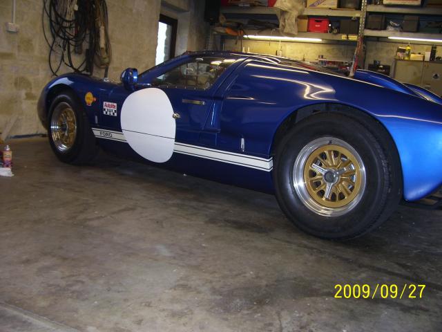

Mine are Image Halibrand type pin drive with the wineglass shape. These more suit the MkII

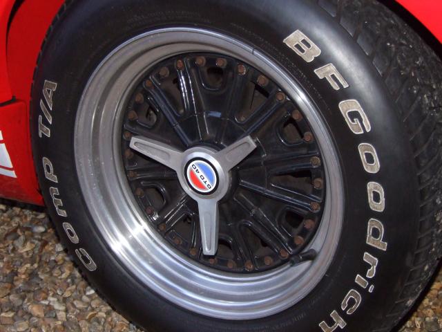

Thanks everyone. Image were my original choice, but, never been sure about split rims since we had major problems at Le Mans with them.
