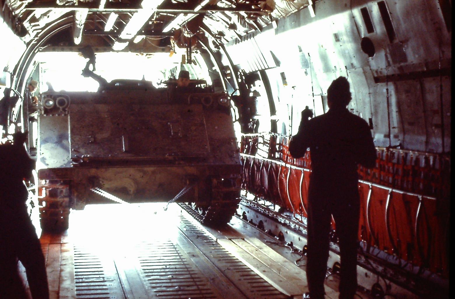

My guess is the load had vehicles. At least in military cargo flights (picured below), we chained them to the floor of the aircraft. I'd think the high angle climbout to avoid ground fire coupled with a tie-down failure caused it. Tragic...

For those who don't know, I'm a pilot for American Airlines, and also a C-5 Galaxy pilot in the Air Force Reserves. Coincidentally, I'm also a trained aviation accident investigator, although fortunately I have never had to put that training to use.
There are very, very strict, written guidelines for securing all types of cargo in the C-5, and I would presume similar guidelines exist for 747 freighters. Our floor is strong enough to allow wheeled vehicles to drive directly on it, whereas the KC-10 tanker has to have pallets loaded on their cargo box floor, then vehicles can drive onto the pallets. I suspect the 747 freighter uses a similar system.
Based partially on conjecture, and partially on the statement that the crew radioed that the cargo had broken loose, I would suggest that it was secured improperly. The guidelines assume failure of individual tiedowns is possible, and thus there is lots of redundancy built in. I don't know what percentage of tiedowns would have to fail before wheeled cargo would break loose, but I suspect it would be rather a lot.
However, nothing can prevent a disaster if the tiedowns are installed incorrectly, or in insufficient numbers. I hesitate to cast aspersions unfairly, but it seems that a combination of crew loadmaster and/or ground loading crew error is likely the cause of this tragedy.
