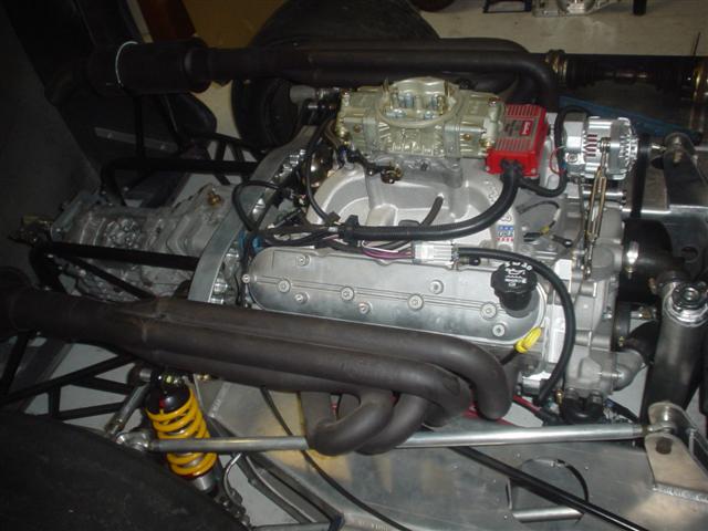

Daihatsu (that's who?) ----? not sure --- about 85 amps --probably ok for ignition module , electric fuel pump,rad. fan, stop lights --race car ? + a bit
David / Chris, thanks for input. I am looking for something less than 120mm long from centre of v pulley to back of unit, preferably with no electrical connections right at the back face. Thanks again, Frank ( I will follow up the Honda gullwing unit to see if I can get a V pulley on it )

Thanks for the warning Ron, I will ring them tomorrow. Bill, no its just a full house Gurney Weslake with dry sump pump etc, we have just kept everything tight to the front of the engine to maintain its position ( in a GTD ) without having to modify bulkhead etc. Plan is to mount it directly in front of the left hand cylinder head, but the v belt alignment has been moved back closer to the block making things tight ! Thanks guys for all input, Frank
