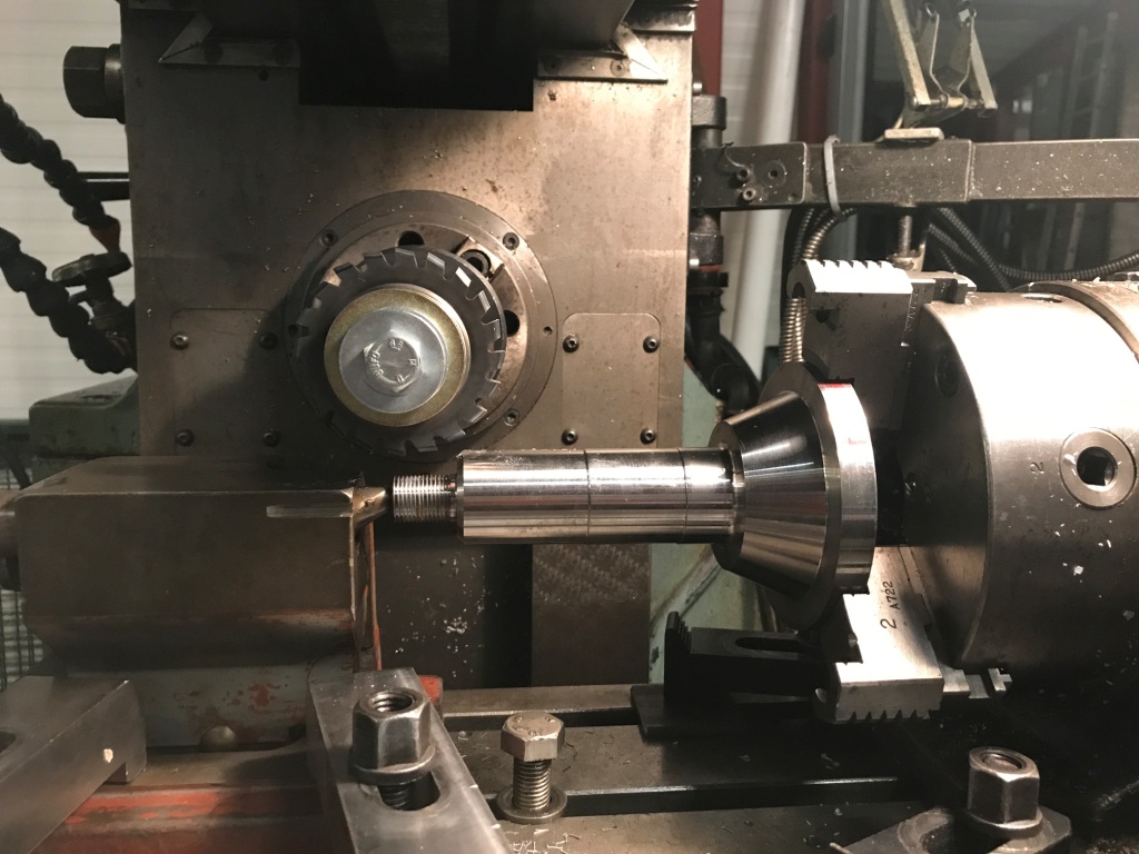

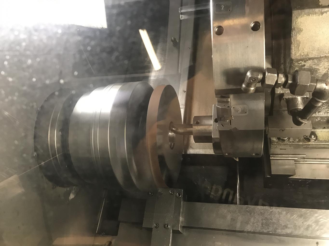

I have started to produce some outer stub axles and the flywheel. It is lots of programming to do before the machines can do the job. But it started well in the lathe. I will use 930 CV joints in both end now to start with, and might change to donut later.
My work now is sanding sanding sanding all day long.

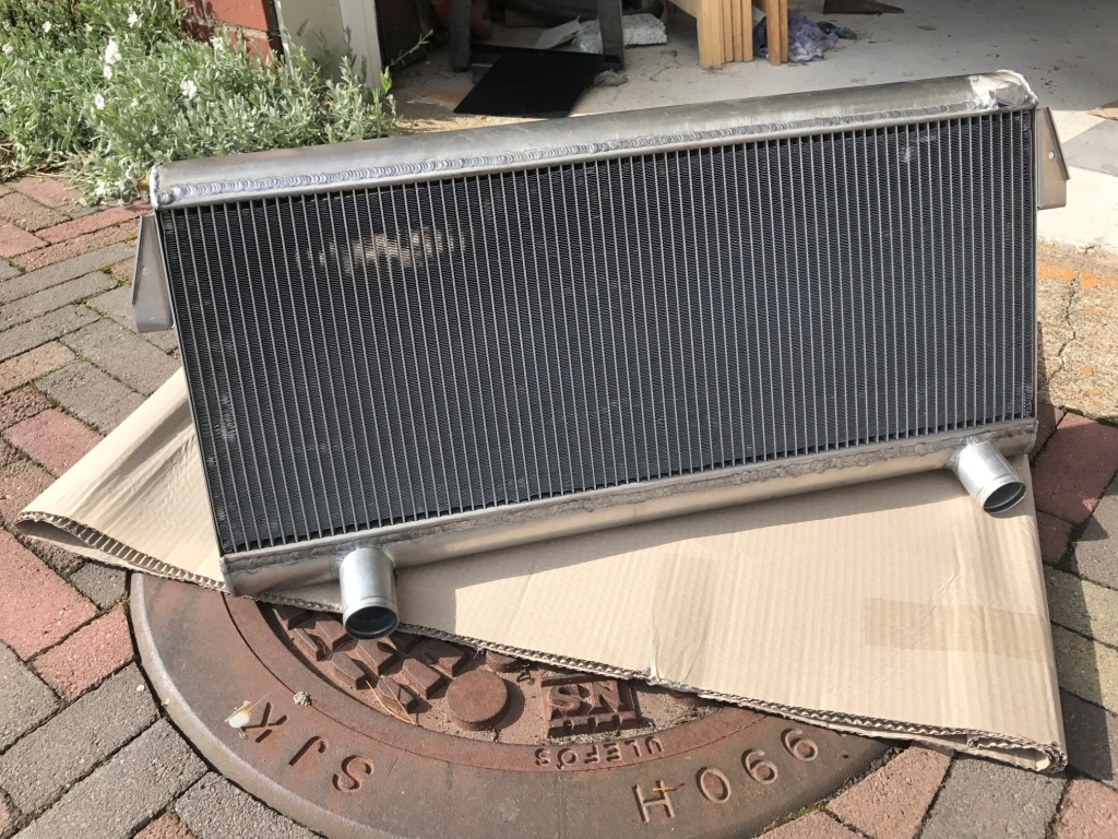

Rune

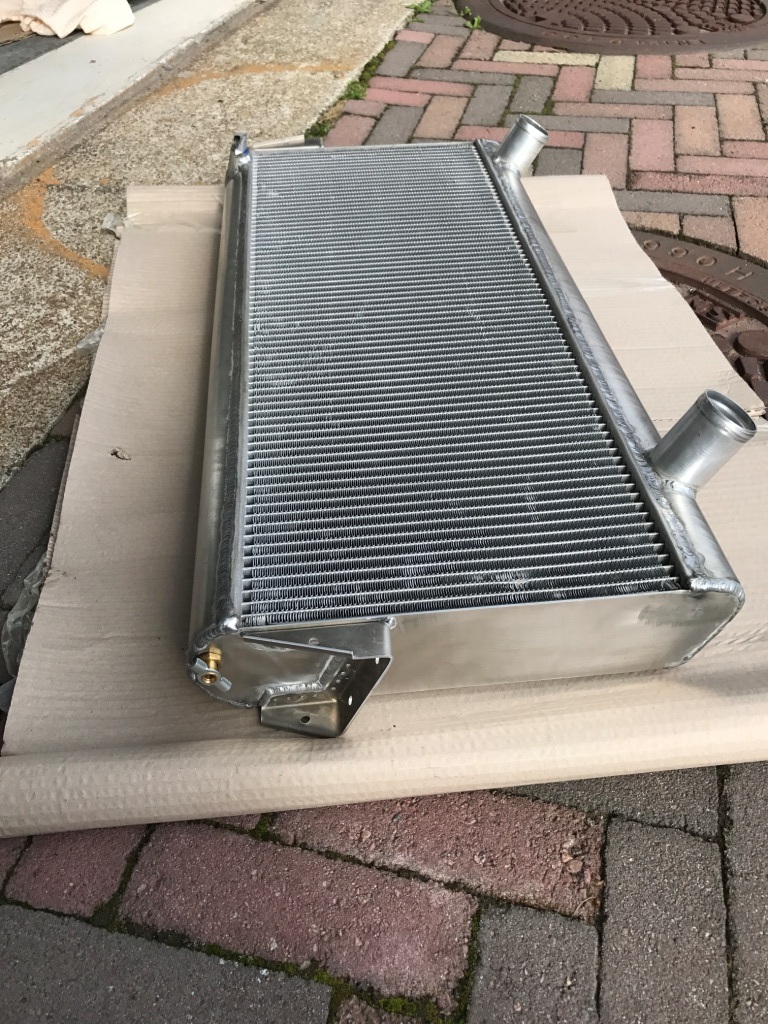

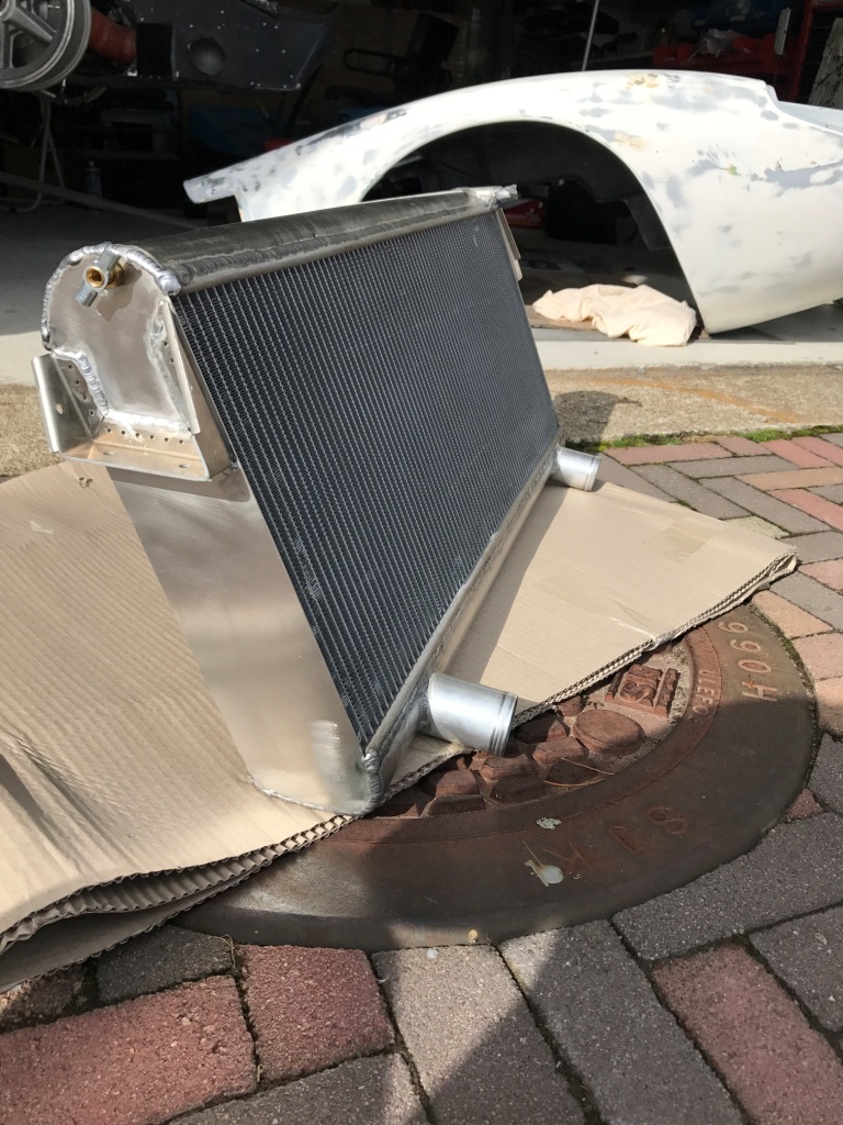

Finaly I got my radiator, it is the closest you can get to the original without the Marston stamped on. It fit 100% in the car. It is made from old drawings. I'm happy that these good people did a excellent job on this semi original rad.

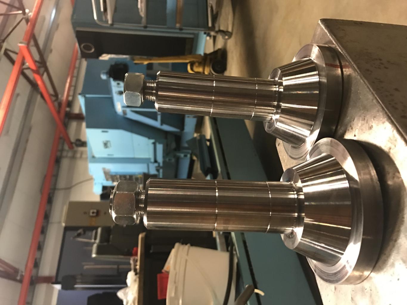

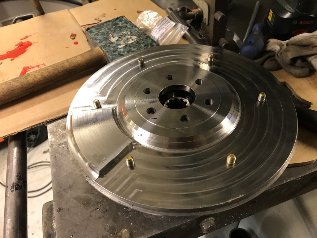

Rune

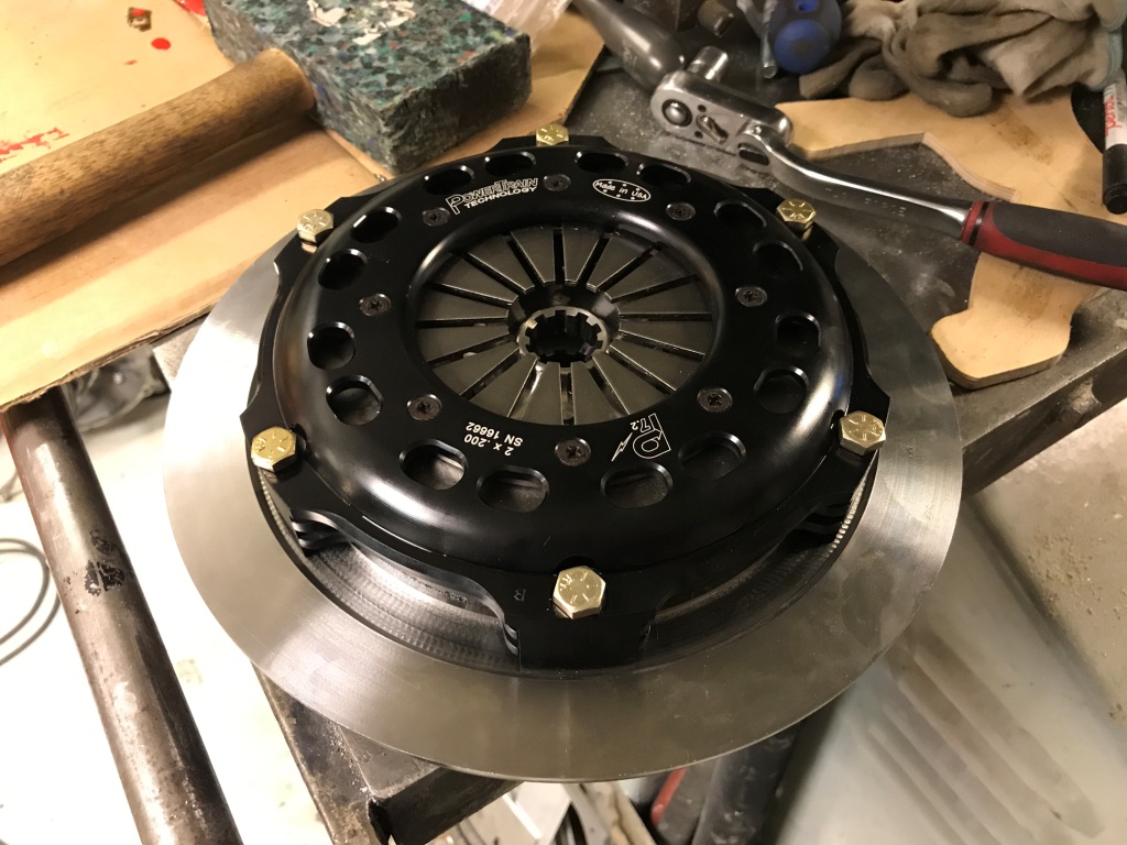

Then finally the Flywheel is complete just have to do a balance job and connect the starter ring. Also made the outer stub axles complete. So now lots of work is waiting for me in the work shop.

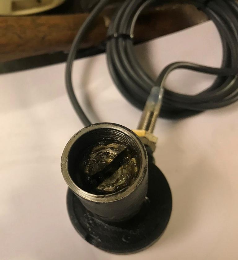

Rune

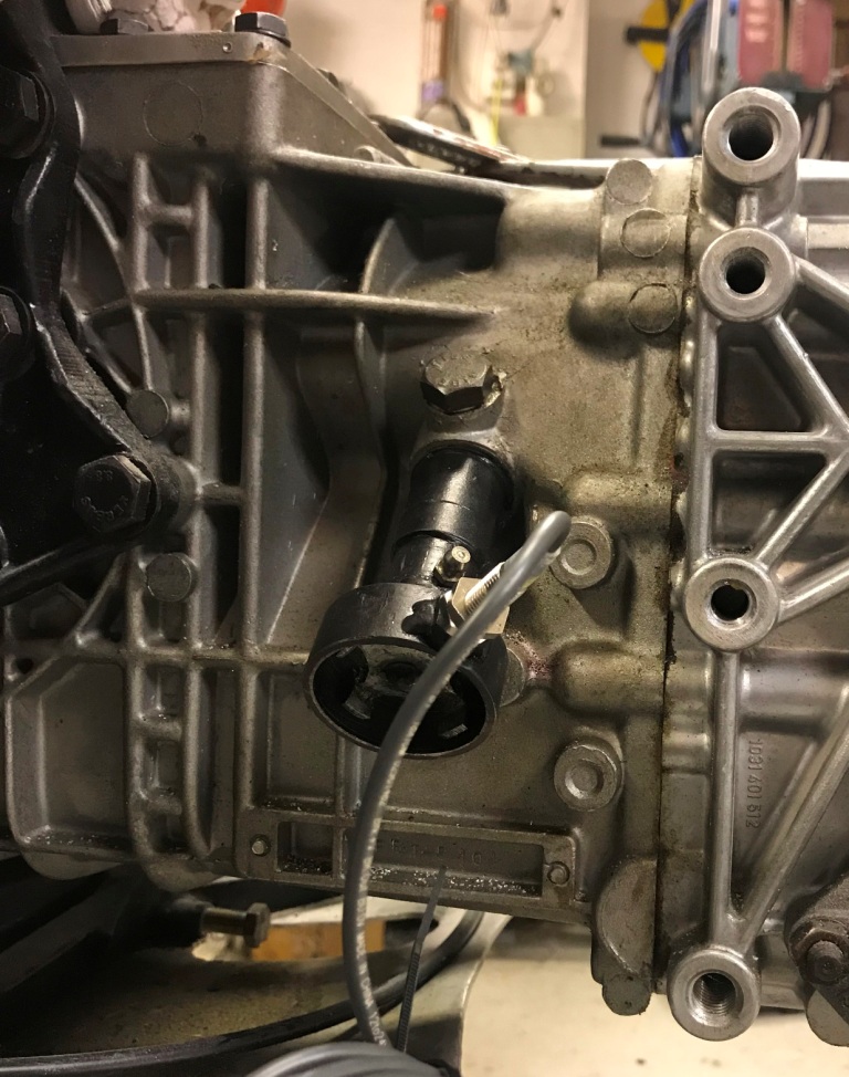

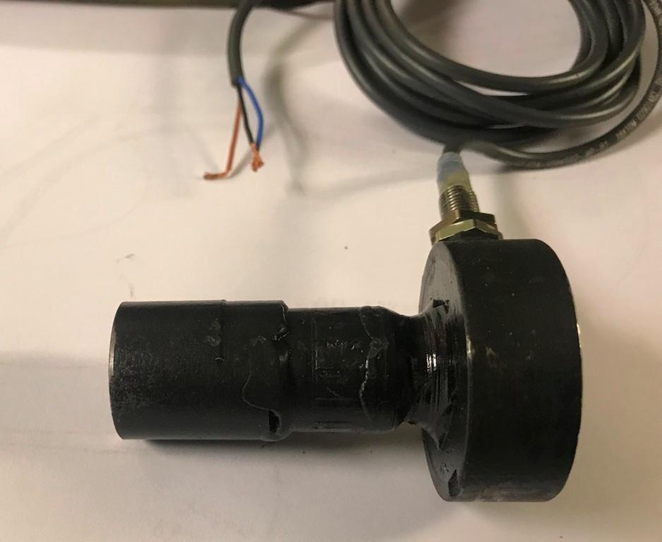

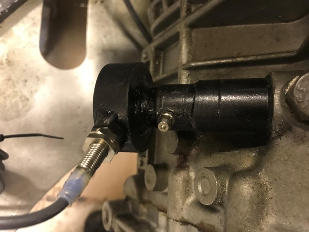

I do not trust the old mecanical speedo cables , so I changed to a digital instrument, and made my own pickup for the sensor.

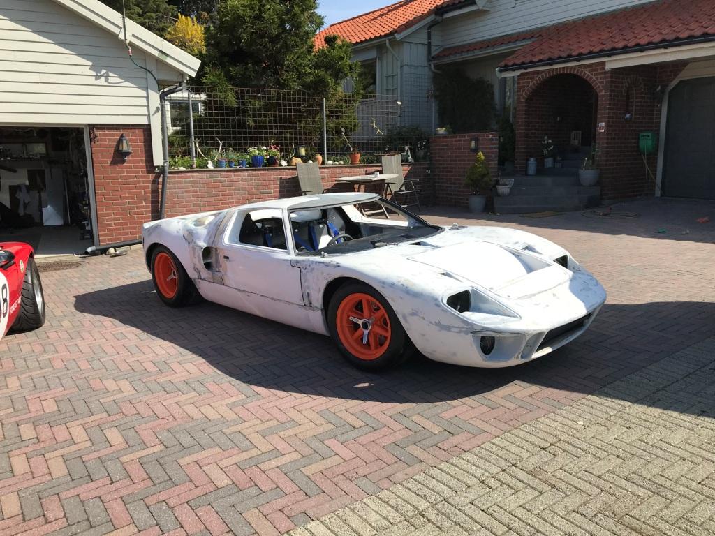

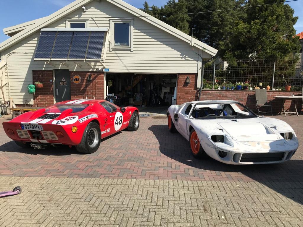

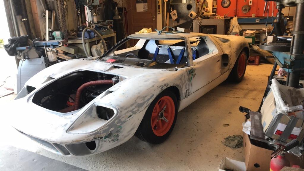

Rune

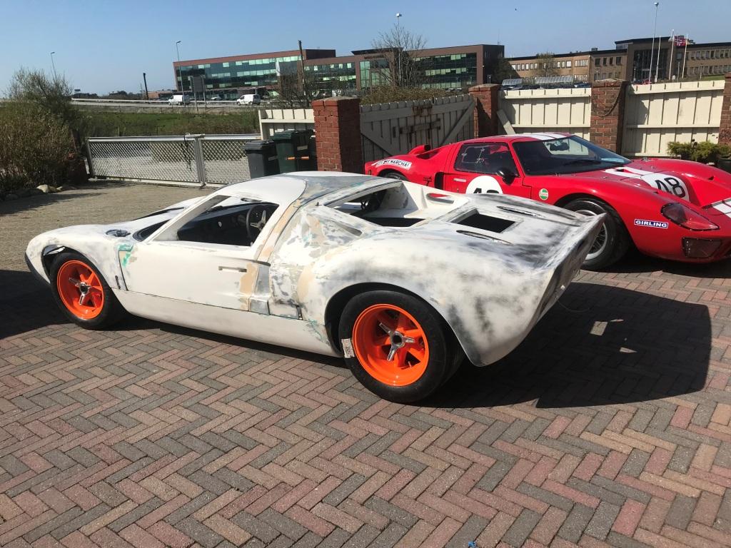

A long time since I posted here, but I have worked on the car almost every day , and now it goes to the painter, his price will ruin me, but then he give a good result hopefully.

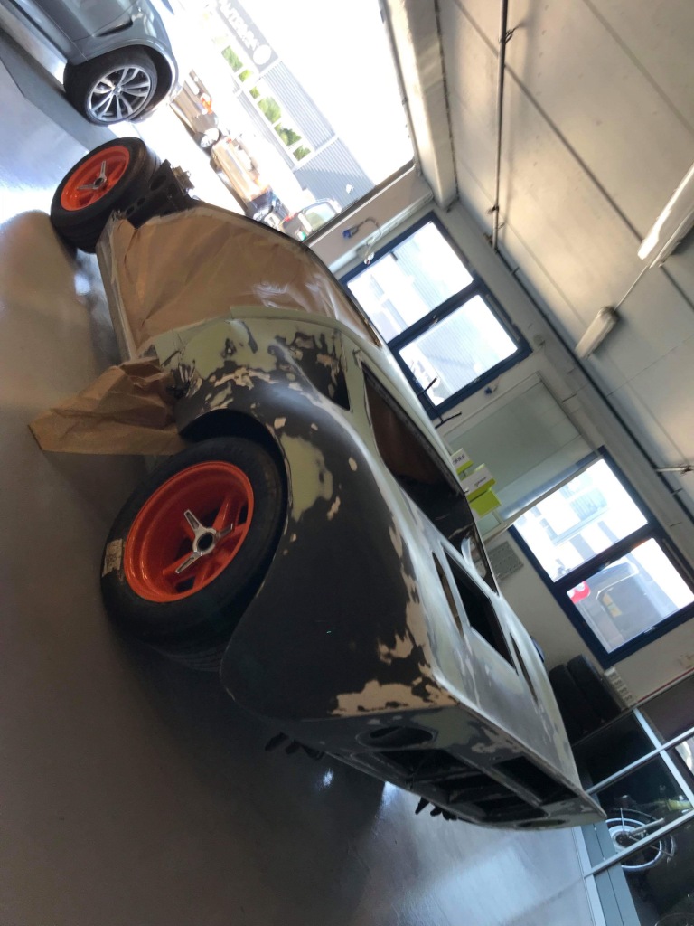

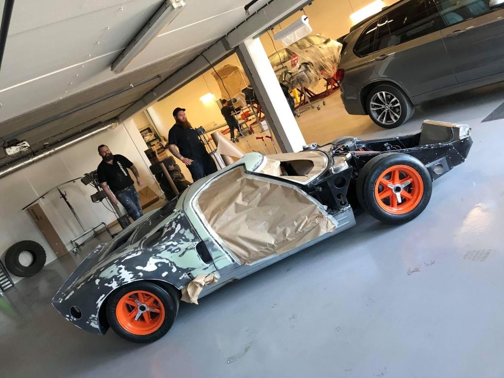

Rune

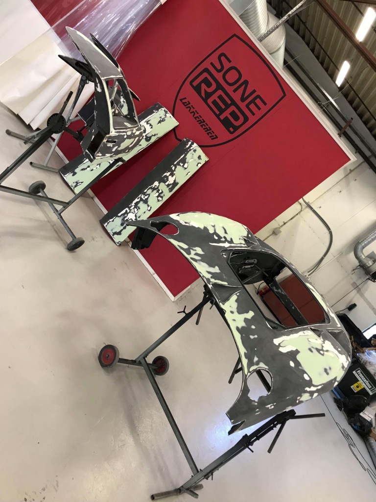

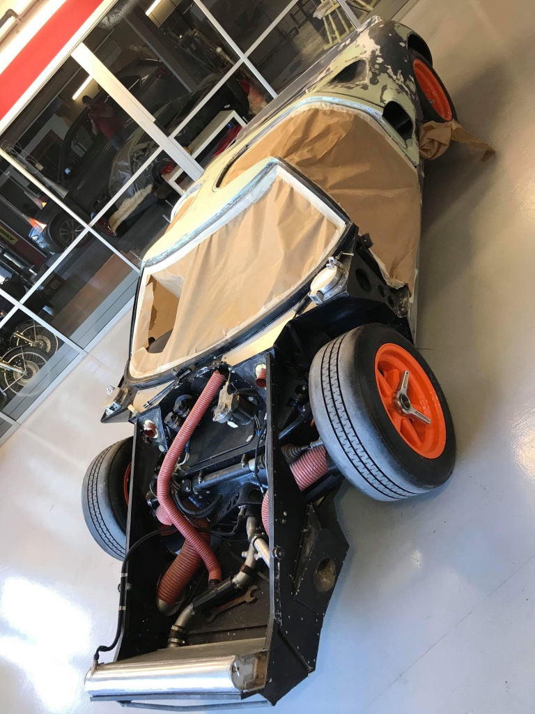

Started the next step , painting. I leave this to the people that know how. Even if I sanded for long time they said not good enough. The car is in good hands.

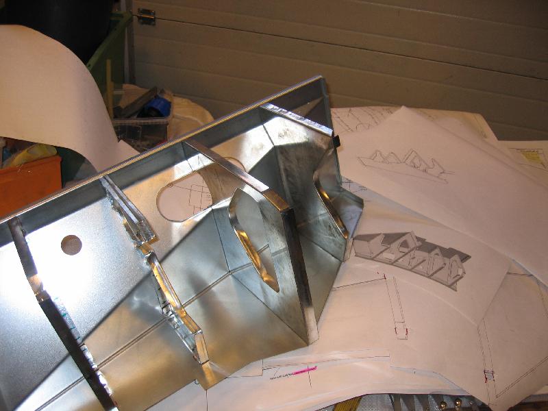

Rune

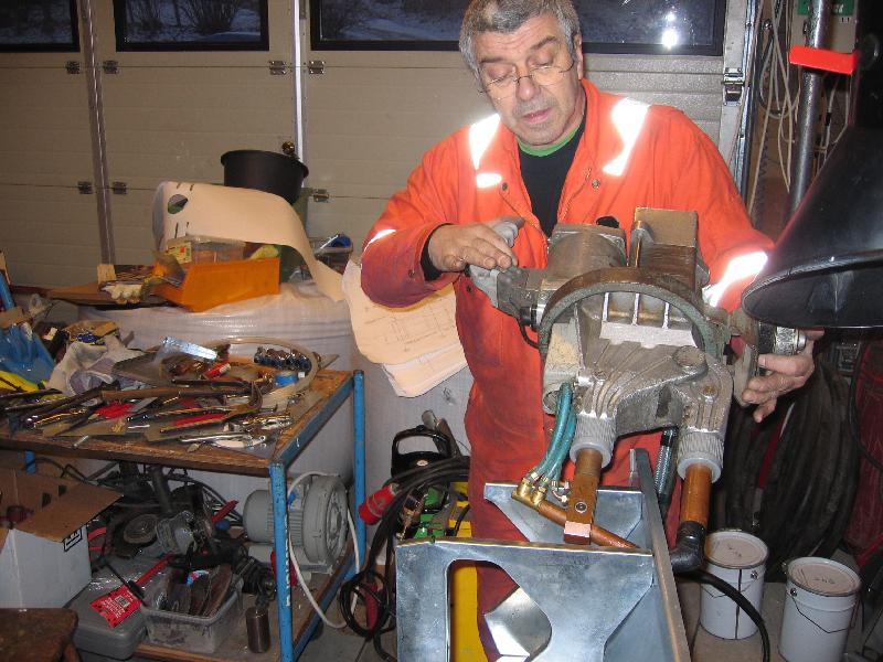

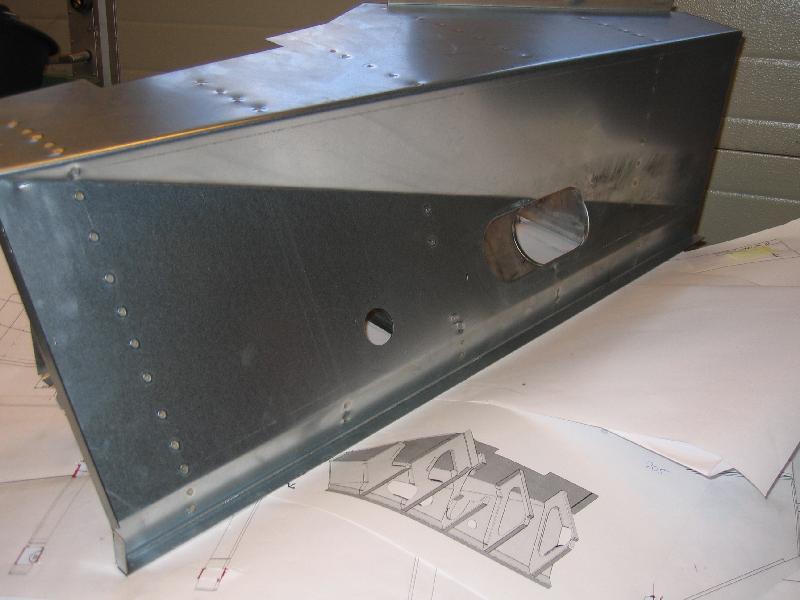

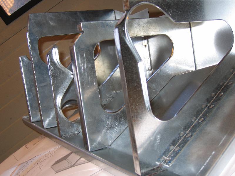

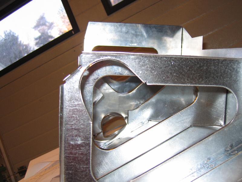

Here are those early pictures , They are from 2008 a early stage in spotwelding
