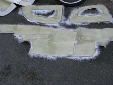

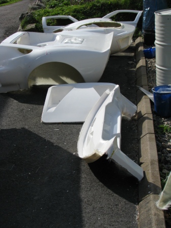

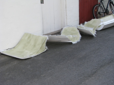

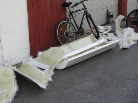

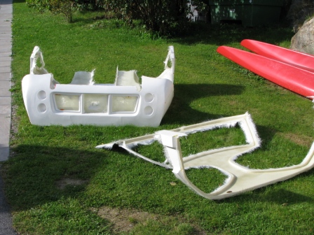

Here I'm back again with some pictures of the plastic parts. It is both for mymonocoque and a replica to a customer in Sweden.
Now the bodywork start. hrs. of sanding is what I can see the next weeks .

Rune - Is that a left hand drive dashboard I see? :stunned:
Your work is always a pleasure to view...
Bill Hara
Old Hand
I'm curious, the GOX monocoque is a rivet replica, why spoil that with a LHD version?
I hope not to offend, it's just that with all this incredible effort and workmanship it seems a shame to not carry it through the whole 9 yards...
Bill H
the fibre glas that looks wrong is probably wrong to, because those parts is for a square tubing replica. the real mono has metal spider and also most likely RHD... othervise it wouldn´t be as original as bune want it..

Sorry for the confusing pictures . Reason is that Goran also had a LHD replica that was finished at same time as my monocoque . And all this parts was taken pitures of before the trimming sesion. So it is almost two cars you can see spread out there .
