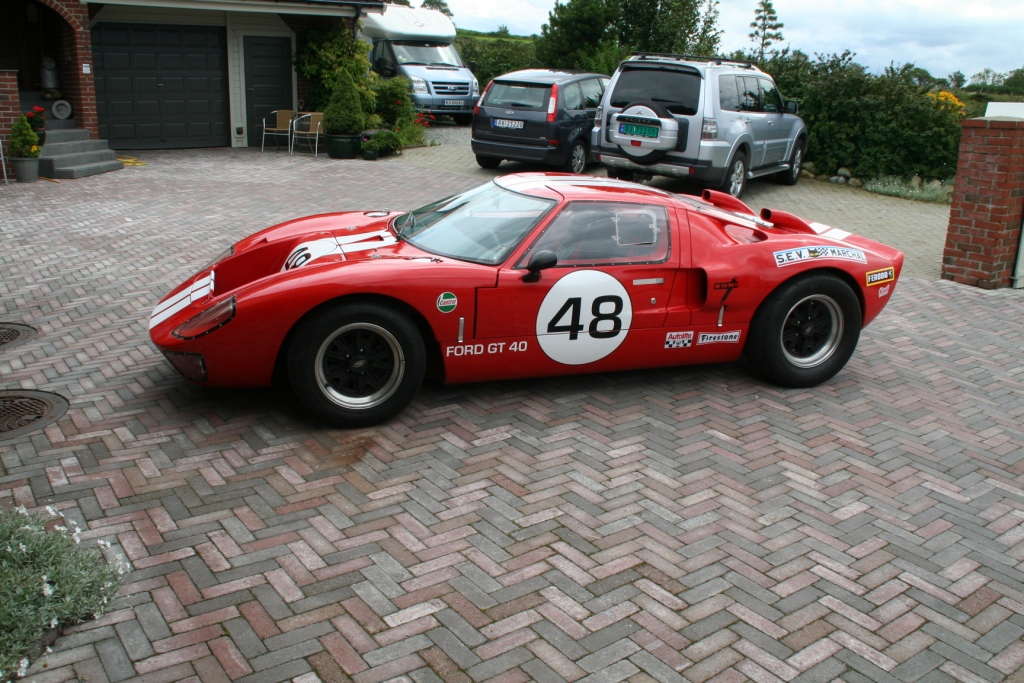

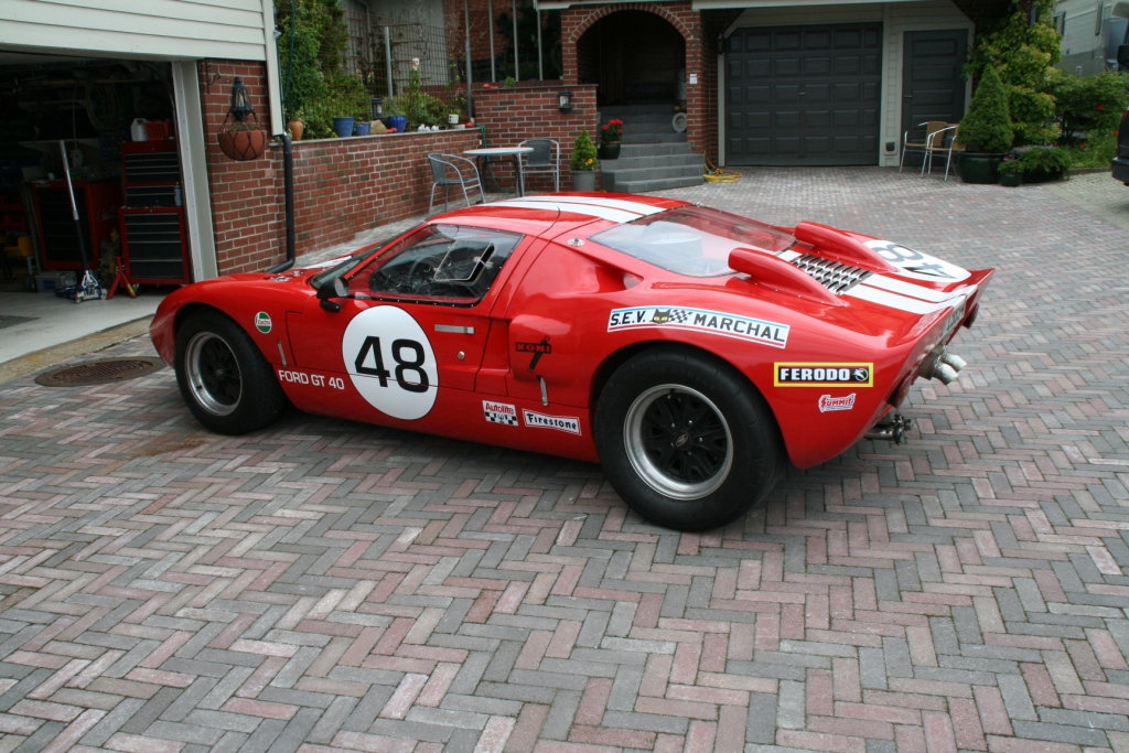

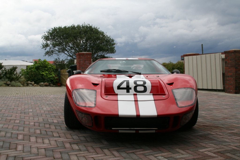

While building on my monocoque, I had some sticker on the 40 which I use on the road when weather is ok. The rear tyres does not like wet roads.

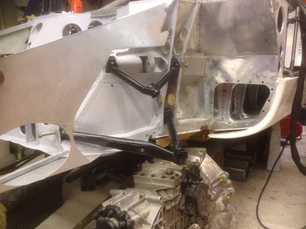

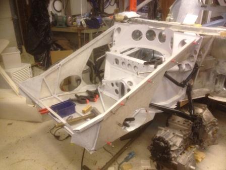

Rune
Some pictures just to show that the spirit are still on top

That is some incredible craftsmanship!! It's obvious the original chassis is a very complex piece. And to replicate it 100% is a testament to your skills and passion. Well done!

Thanks Will . It is hard to have 100% spirit all time. My wife always find me working with the car when I told her I 'm doing something else :-)
I'm lucky to have a gt40 with registration that can be used on the street. Then it is easier to axept that it is some time until the project will be on the road.
I will continue to feed the forum as it move forward.
