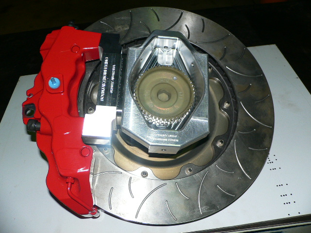

Ian,
As per Jac Mac's reply we have put a lot of work into creating a stable platform for the whole front assenmbly, we are using quite large front rotors so the calipers are hanging a long way out in the breeze so to speak ! We have swung the mount down as low as possible, probably no significant advantage but it may as well be low as high ! What I find more interesting, and this may be a little off topic, is the relation ship between wheel weight and rotor weight. I am spending a kings ransom on superlight wheels yet the rotors will become really effective boat anchors when they have done their tour of duty ! even if I could afford the carbon alternative I just cant beleive that there isnt something between cast iron and carbon....
Iain

Iain, while its a bit late in the process, the adaptor you have sandwiched between caliper and upright is a possible source of caliper deflection. As the two bolts that attach the adaptor to the upright are on closer centers and offset inboard from the rotor centerline the caliper will tend to deflect inboard @ the top & outboard at the bottom when the brakes are applied resulting in tapered pad wear & a long pedal . A better solution would be to redesign the upright using only the two original caliper bolts to mount directly to the upright, delection would then be minimal due to the larger center distance and elimination of the other two bolts.
The other thing I notice is the large amount of rotor surface @ the ID that may not be in contact with the pad surface & could be removed for weight reduction.

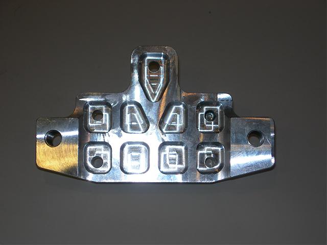

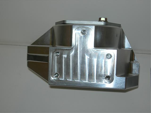

Thanks for your ideas on the caliper mounts, we have tried to make the base of the mount as wide as possible and the upright has a shoulder milled into it to accept the adaptor, both done on a CNC machine so they should be a tight fit, I think the fact that the upright has been designed to be ambidexterous may have driven some of the design compromises, only time will tell. One of the iterations of brake set ups we had on my Cobra generated excessive pad tapering with the resulting "long" pedal. If this occurs again then we may have to go back and remachine as per your recommendations.
Iain
Iain
That puts a different perspective on it Iain , with 5 bolts & that large 'footprint' of the adaptor I dont think it will deflect any direction in a hurry, I'm always telling people not to jump to conclusions, might have to start listening to myself! :)
