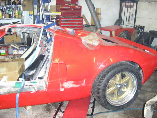

First of all thanks to Brian for putting up with me on the phone the other weekend. I think I know what I need to do on the CVs now, but I don't have the time, as the car goes away to get the body put on it in a few weeks. So its trying to get to a point where that can happen!!! Here's today's attempt to get closer to body fit!

Steve,
They are 17" BRM bolt-ons with dummy spinner covers from Image wheels here in the UK: BRM6 Classic Build
I have had the centres powdercoated in Gold and then the rims ceramic clear coated, but not polished, I didn't want a too bling look.
I am running 235/40 17 on the front and 285/40 17 on the rear. This also gives me tyre heights pretty close the the originals, albeit on 17 rims. I am using Kuhmo KU31 rubber: Tyre Selector

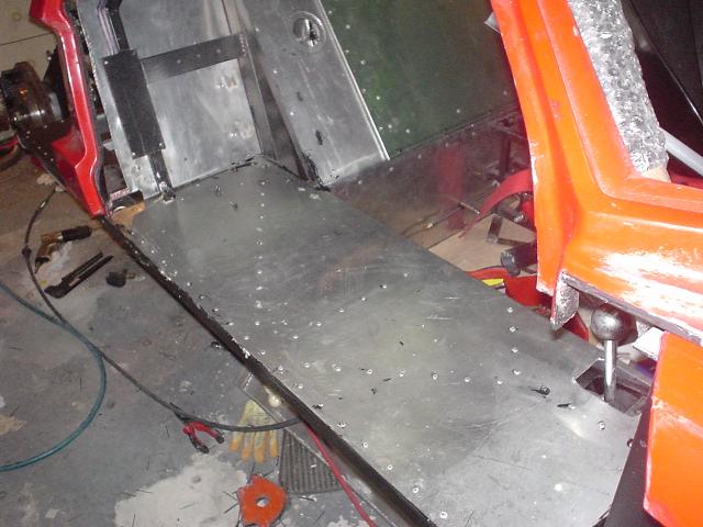

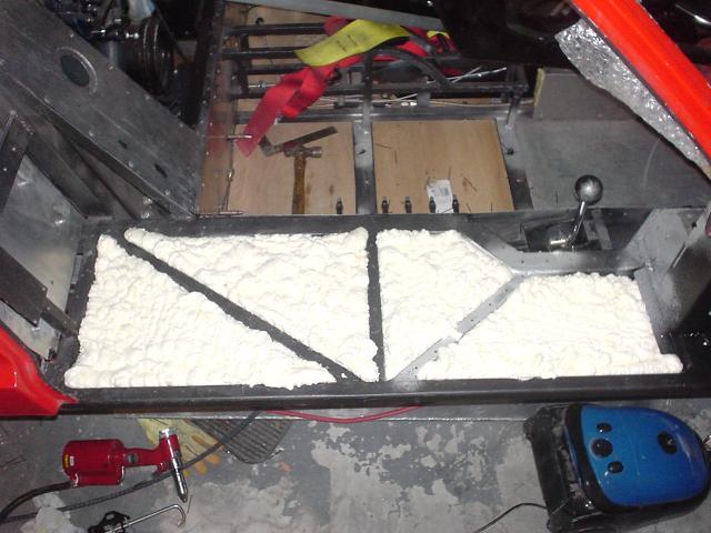

Alittle more done today. Finally about 2 years after I made it the drivers sill panel is on... Still double skinning it, I decided to fill the void with Exact Gap foam, which is only meant to expand 5-10%. Well lets say its the most generous 10% I have seen and required some clear up...

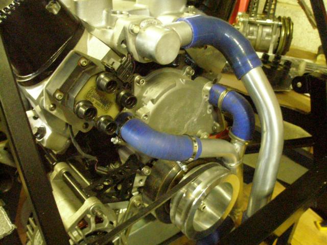

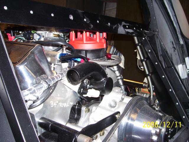

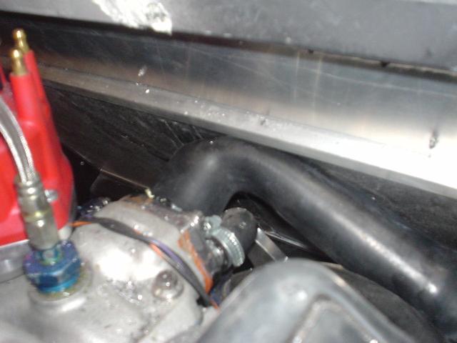

I also started to look at making an infill as I have made the engne cover smaller, which also has a 13mm lead sandwich stuck on the back. The only problem is that I seem to have now run into an interference issue. I remember the old GTDs had custom water necks. Does anyone have any ideas, or pics I could look at to see how they have done it. Thanks

Hi Brett
This is the item MDA originaly provided and it has worked well with a bleed off back to the header tank. I have had no issues with airlocks etc.

Hi Steve,
The car went to Mick on Thursday ths week and that is one of the items that wil be fixed when it is there; the car will have one of Mick's water necks, amongst other things :)

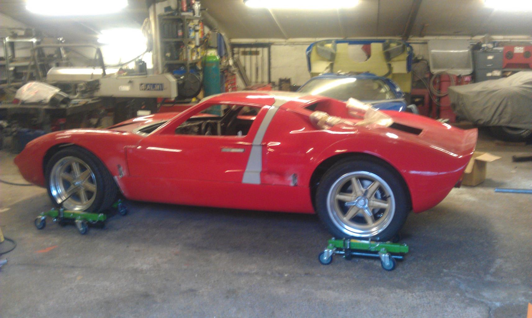

Well finally the car is home... and the body is fitted :thumbsup:
Mick has done some other work, but this is a major milestone, if you check to see when I first posted this build log...
Some fo the eagle eye of you will notive that the spider is now grey and not red as when it left. FOr some reason Mick could not get the orginial one I got from Chris Melia to fit on the Roy Smart GTD chassis. However, the SGT spider fitted straight on without any problems. Also, the sills seem to be longer on the chassi, so they had to get modded as well. All in all though clips open up and doors shut and open so nothing an keep the grin off my face...
... OK one thing could, the fact my wife said I am not allowed in the garge to work on the car until I finish installing the new bathroom :thumbsdown:
