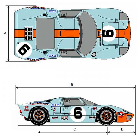

I'm embarking on a custom trailer build for a my RCR40 that is due in a few months. The trailer will be enclosed however the car I will pull all this with has a maximum towing capacity of 2,100kg. I need to make the trailer as small and light as possible. My towing vehicle is a new 4 door sedan with a 310KW 6.0Lt V8 so I will easily get up hills but I will pull the trunk off it if I exceed this weight!!
I would appreciate it if a current RCR owner with +2 rear flares could tell me the measurements below.
I know there are many lists of common dimensions like wheelbase etc. but I just want to make sure. DIM A is probably the only different one.
Dim A = ?
Dim B = ?
Dim C = ?
Dim D = ?
Front track (width) = ?
Rear track (width) = ?
Height from the bottom of the door to the ground when it is open = ?
I know I could try Fran but his email is pretty full at the moment and calling from Australia is too late at night.
Thanks in advance

Jason,
I have a +2, but it is under construction and the panels are close, but not perfect. As it is on the lift and wheels are removed, I can only give you A - D. Well, I can also tell you that from the face of one brake rotor to the face of the other in the back is 51" if that helps:
A = 71"
B = 162"
C = 96"
D = 39"
Hope that helps,
Mark

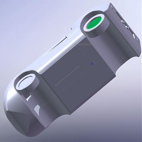

Just a very rough 30 minute CAD model to design the smallest enclosed trailer that will allow me to get out of the car! I'm thinking of making the trailer quite narrow with a door on the side to allow me to get out on the drivers side. Depends on the height of the door from the ground as it will need to clear the trailer wheels/guard to open.

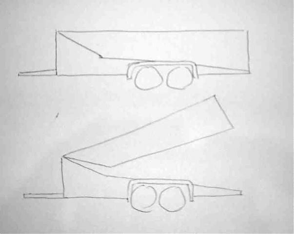

Jason
Have you considered this style of trailer?
Sorry about the quick sketch but I am sure you get the idea.
If it was made from light box tube and covered with thin ally it should be very light. If you use 14" wheels the door should open over the mudguards. You have no doors to make, just a hinge at the front. Asuming you load the car backwards you could reduce the height of the back to suit the car. Also you can make canvas sides to fill the gaps when the trailer is open to make a waterproof workplace. A slightly curved roof would add strength and stop drumming.
Brian.

The only thing that scares me about the clam-shell designs is that if they're light enough to not impose a large towing burden, they're probably not heavy enough to keep from being ripped off like a kite or a parachute in the wind if not opened in with the front facing upwind..

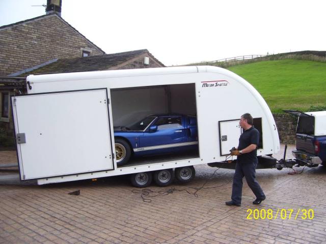

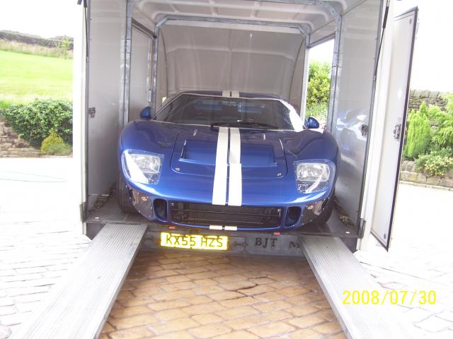

Hi Jason,
I had my car transported by a specialist who used this trailer that had a tilt bed and tripple axle; very shallow entry angle. The side doors allow you to drive in and then exit the side door. The top hinged door makes a useful shelter from rain or in Oz the sun.
It's made by Brian James Trailers their website has lots of detail that may be useful.
Steve

Hi Steve
I like the look of the trailer you posted with the side doors but my only concern with that trailer is that the side doors are suicide doors.
For peace of mind and safety if it was my trailer I would swing the doors to the front rather than the rear so that if they opened the wind would not rip them off while driving.
The locks in this one would have to be absolutely foolproof.
Dimi
Not so sure that Id want the triple axle trailer, tyre diameter, axle width, and deck height would make for some undesirable handling traits in my book, and that rear hinged side door would give you & other motorists a hell of a fright if it decided to unlatch at motorway speeds.
