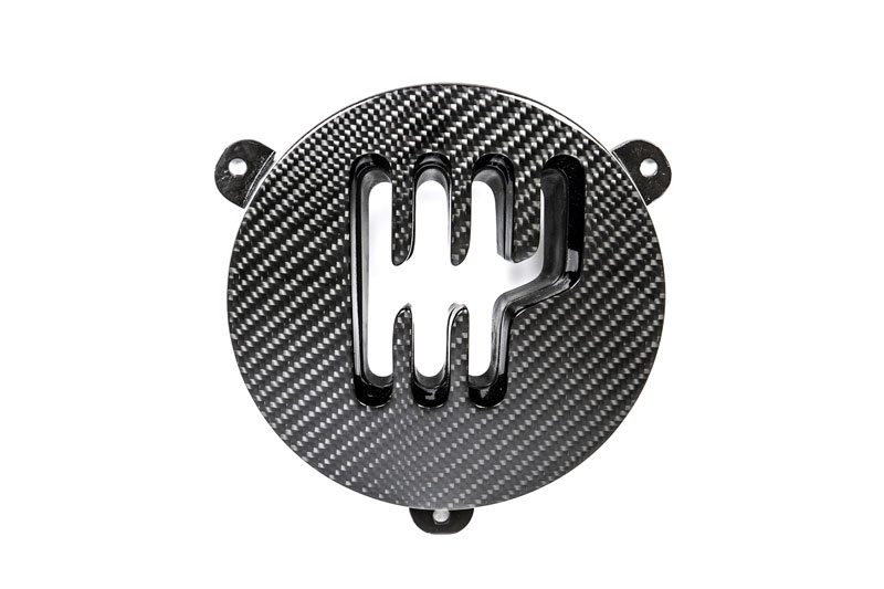

Came across this digging around on Neidfaktor site and thought of you Cam. I actually think this may be too much carbon for your console.
I can't believe I actually used "too much" and carbon fiber in the same sentence, lol.
