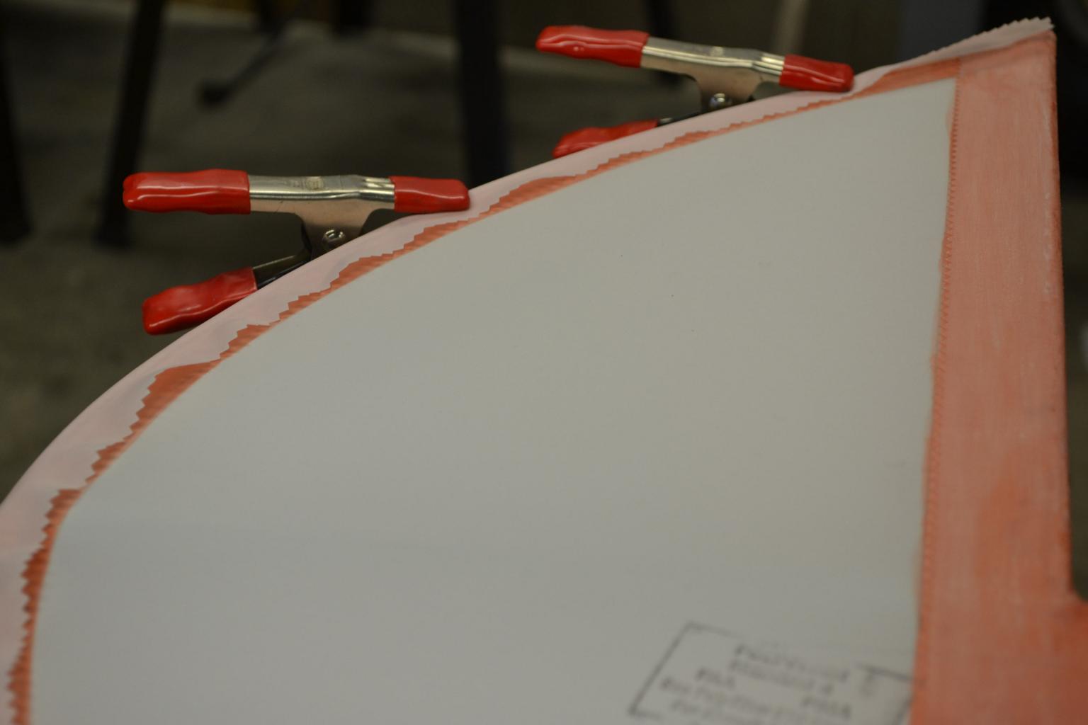

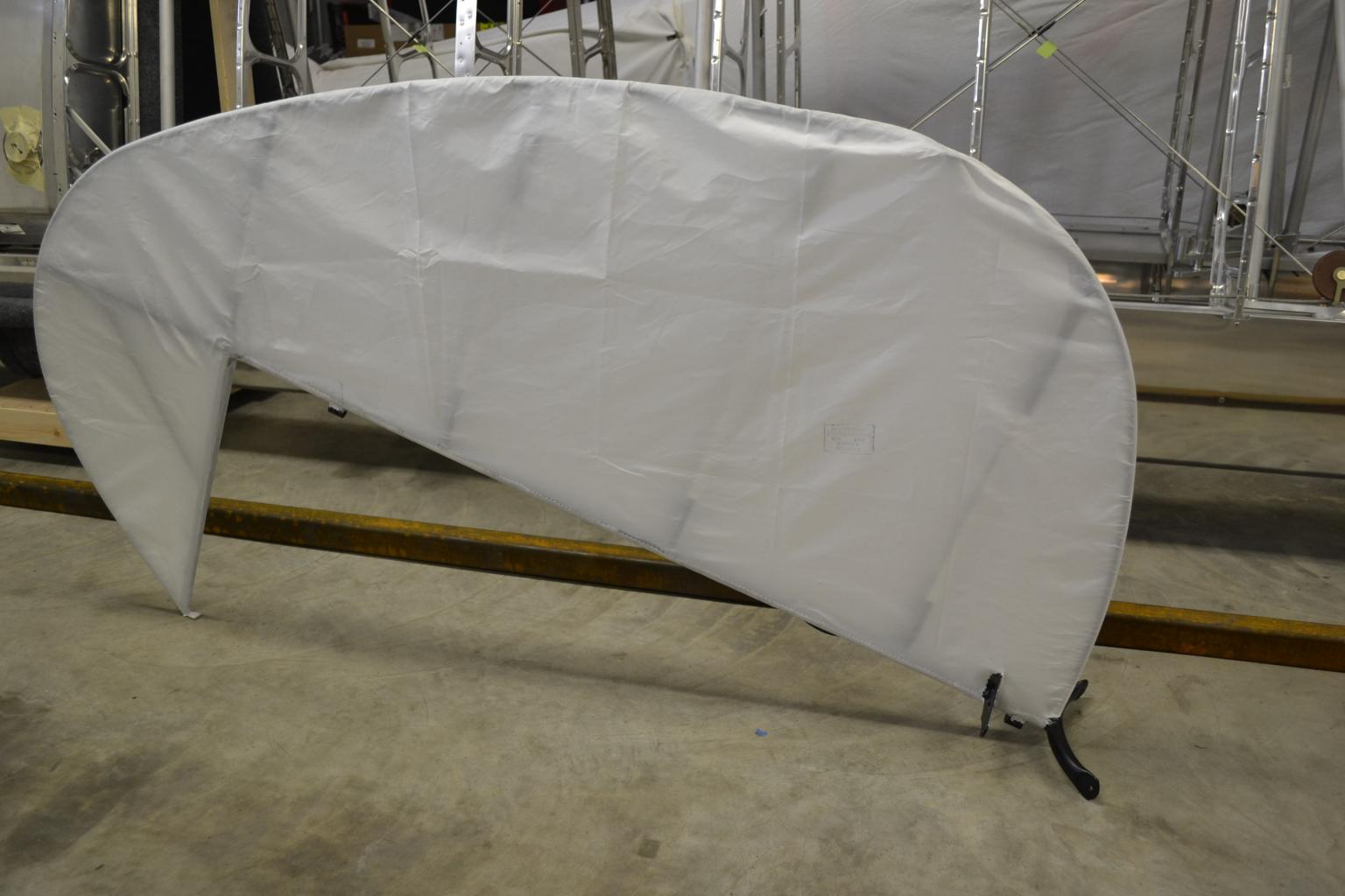

1. One goal is to keep the sewn seam centered. After putting the cover on and aligning the seam, clamps were applied at each rib. Note the seam center line is actually one side of the quarter inch sewn seam. The fabric had a darker line making the center point making it easy to line up.
2. The fuselage end of the envelope is stitched about two inches too far. Pull it back on itself to determine how long a cut will be needed, then a single cut along the seam line only.
3. The glued edges are straight, so rather than using a compass a straight line was marked and cut before the fabric was glued in place.
4. Be sure and keep the final visible pinked seam on the bottom. Cub Crafters marked the fabric covers “right” and “Left” so that the envelope seam would also be on the bottom.
5. I shrunk the fabric in increments: 250, than 300, than 350 degrees, going back and forth from side to side in an effort to keep the seam on the leading edge centered.

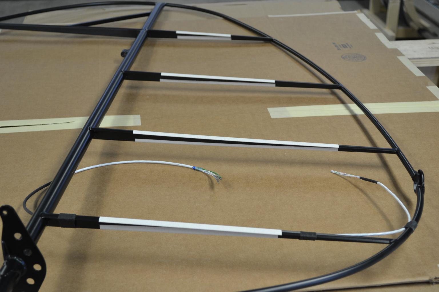

1. Don’t forget to place the strobe light wire. It is held in place with tree wraps of friction tape in three locations per the lighting manual.
2. Glue was applied around the strobe light opening and permitted to dry before the fabric was applied. After the fabric was applied and shrunk, the glue was activated with MEK to help secure it in place. The opening was then cut, pie style, and the pieces glued in place. There is a lot of tension around the opening and I wanted to add a bit more glue to make sure the fabric stayed put.

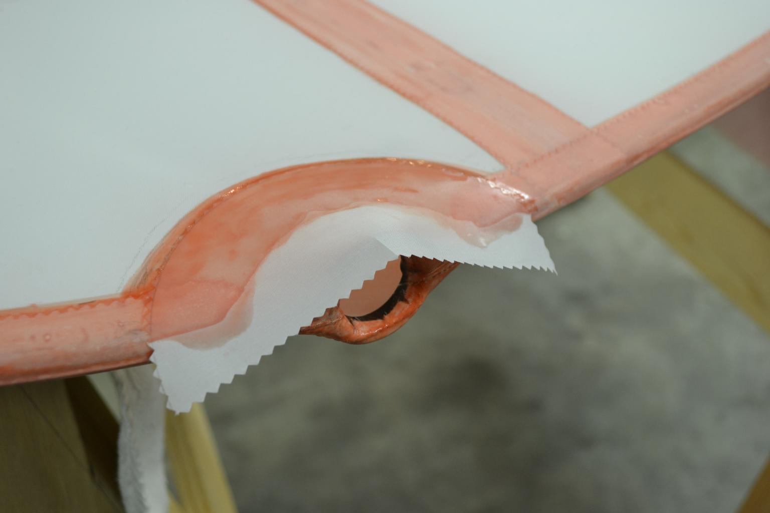

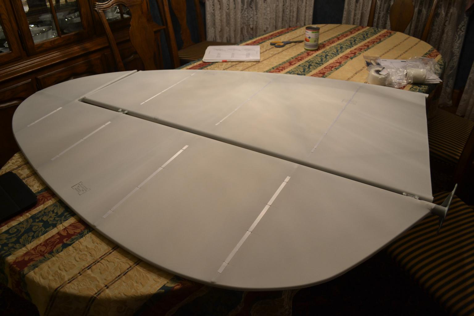

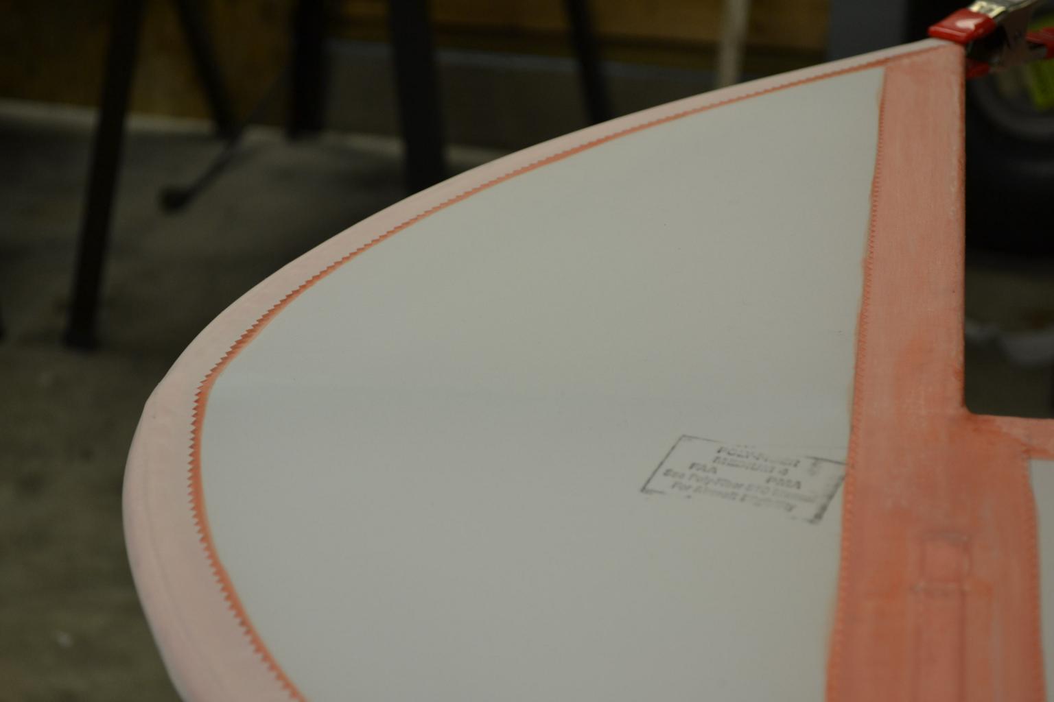

Following the Cub Crafters rather than Poly Fiber’s guidelines, two coats of poly brush were brushed on where the tapes are to be applied. The tapes over the ribs were applied first, trimming the ends where they meet with a straight scissors so the seam would not show. Next the tapes around the perimeter were applied. And finally the grommets were Polybrushed in place.
The tapes are applied by brushing the Poly Brush on top of the tapes. After they are in place a fourth coat of Poly Brush is applied, per Cubcrafter’s practice.

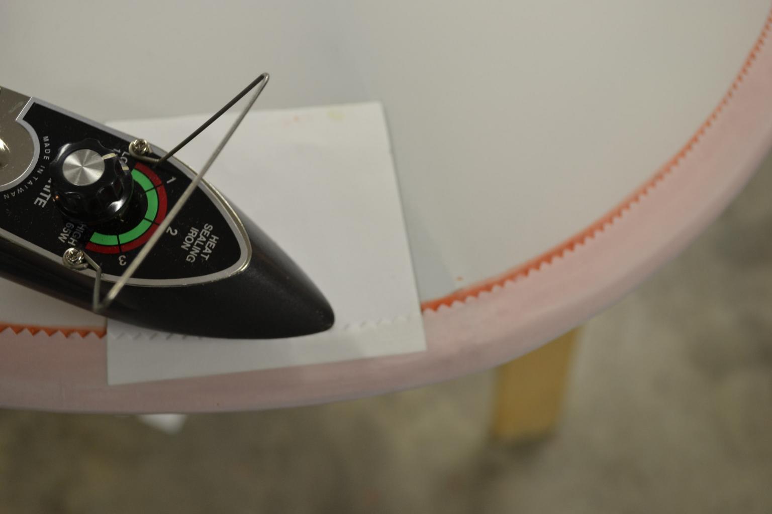

The tapes around the perimeter of the elevators and rudder were stretched to make them lay flat per the award winning Mitch Travis video with one slight change. When ironing the tapes to make them lay flat, a piece of paper was placed between the tape and the Poly Brushed surface so the tapes would not stick. Both sides were ironed before Poly Brush was applied. This worked well.

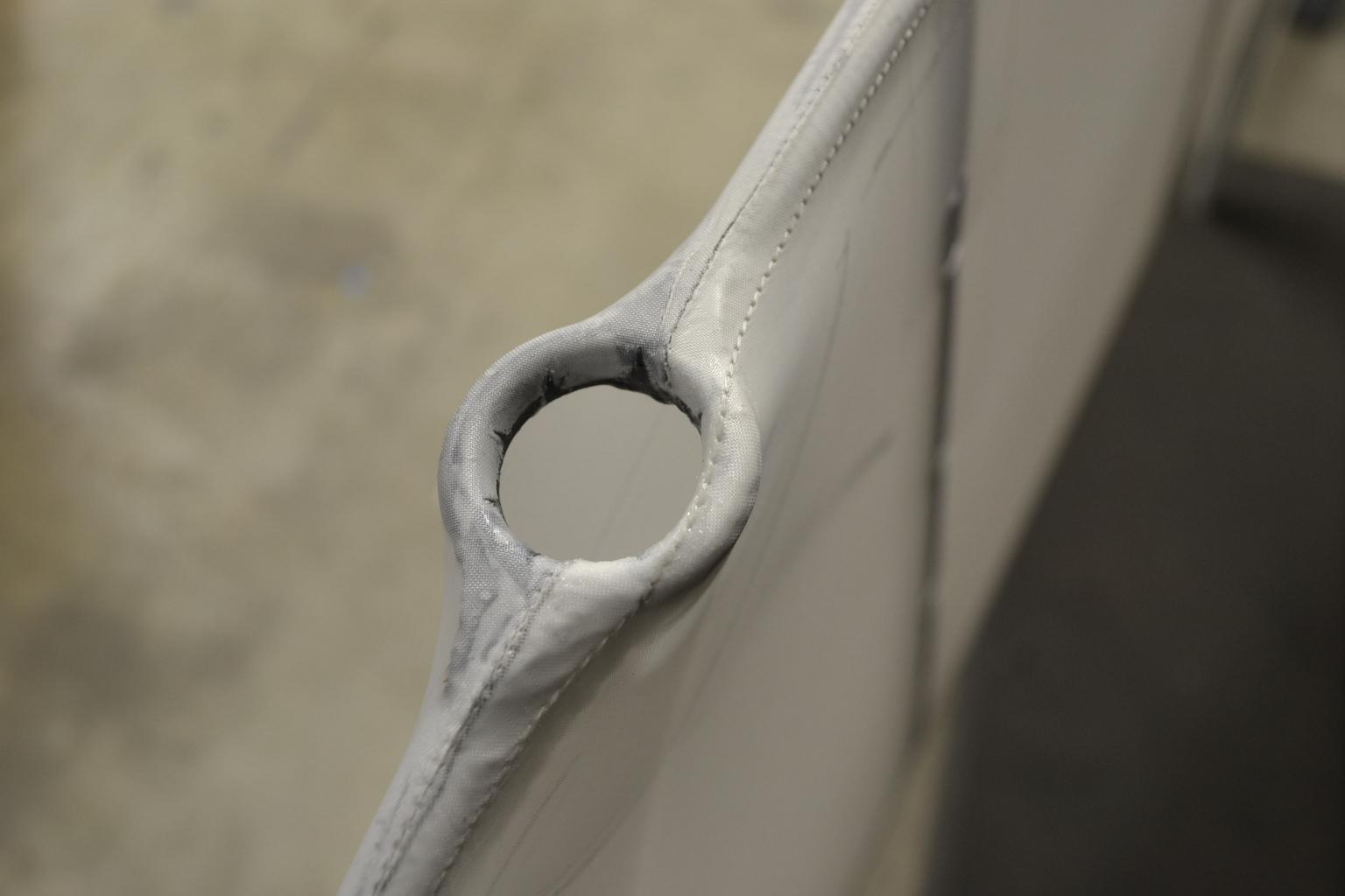

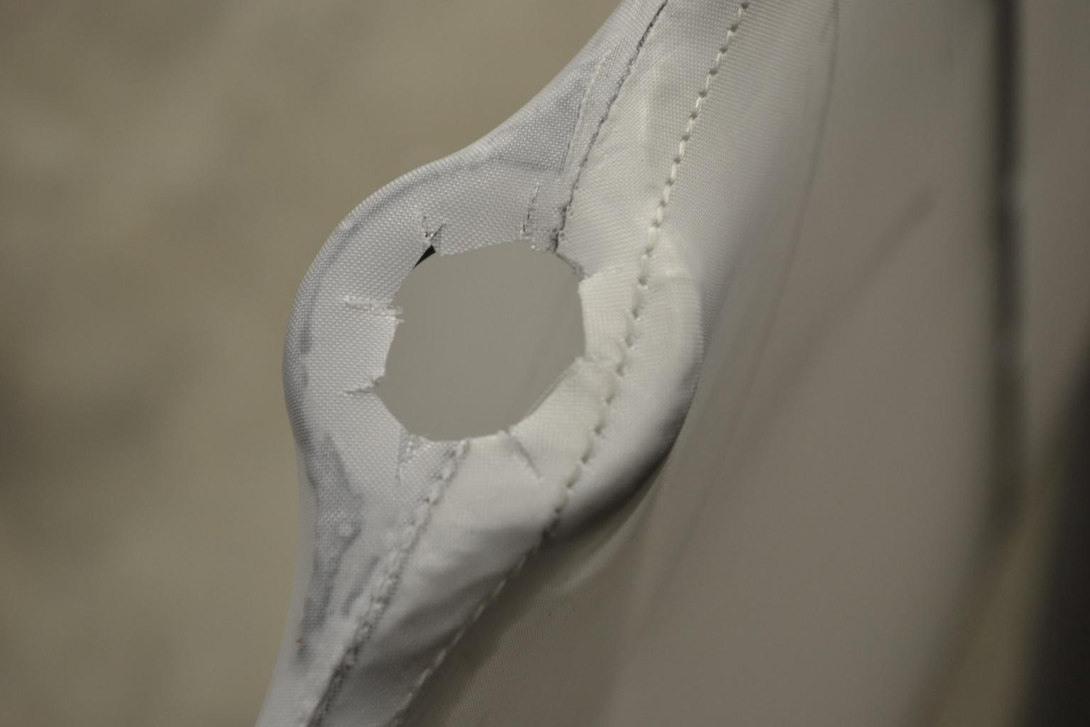

There is a trick to installing the grommet around the strobe taillight. Per Mitch, it is split in half and then Poly Brushed in place with the cut edge along the center seam of the rudder

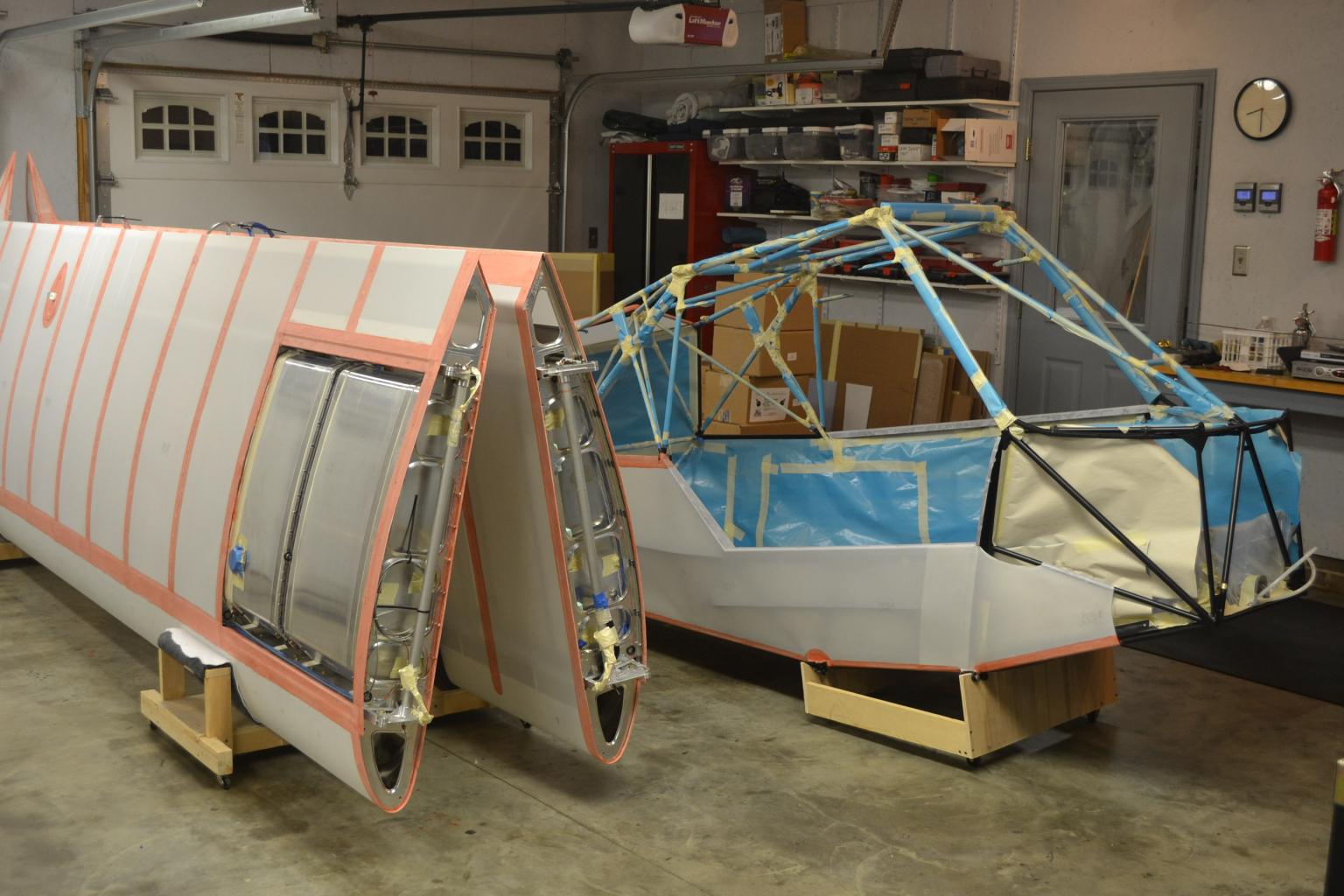

It has been a long time since I posted a progress report, so I thought it was about time. There are several posts over at Supercub.org and Cubcrafters.com, if anyone wants more details.
As of May 15, everything is covered.
We started this project fourteen months ago in March, 2014. Approximately 575 hours have been invested, which does not include setup, research and collateral matters. (Those collateral matters would probably add at least another 100 hours.)
Time spent building the wings up to cover was around 150; the fuselage up to cover was around 150; and the balance was covering. Frankly covering took much longer than I was expecting.
The left wing which was first took 55 hours to cover. We thought the right would go much faster. Not so. It took 53 hours.
