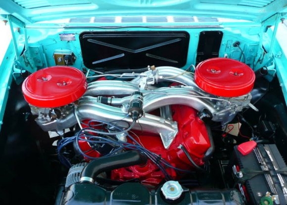

The Chrysler “Cross Ram” is a very unique case. It’s really a common plenum carb intake. It obviously has very long runners. In fact, there was actually both a “short” and “long” runner version of that intake as the location of the divider in the runner was changed to affect the runner length and point in the rpm range where Helmholtz resonator affect occurred. Because of the cylinder firing order, this was not a 180 degree intake but it didn’t matter much. This was also not a racing induction system but one that was very purposefully designed to produce low rpm torque for moving a heavy street car.

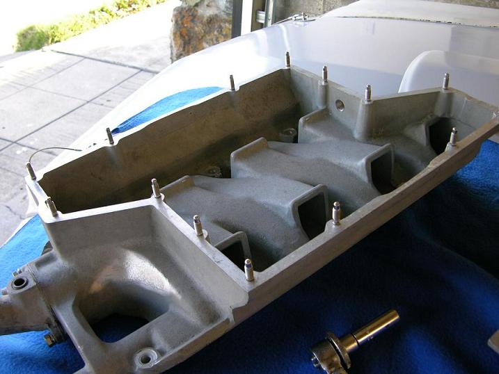

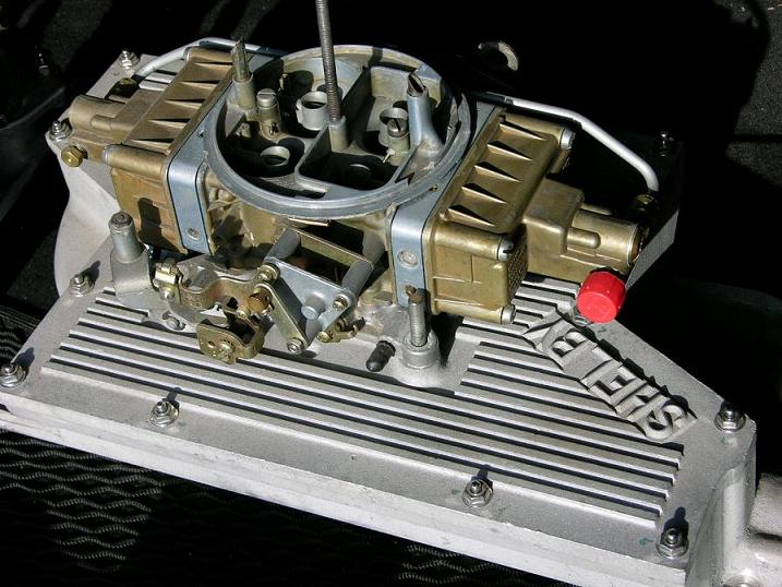

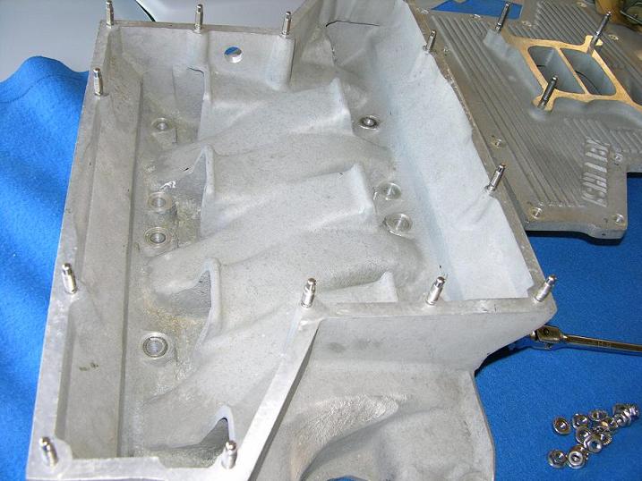

I have been using the single 4 rambox top on my 65' hipo 289. The engine is equipped with the S3 Cobra Road Race cam used back in the late 60's. It pulls hard from 3000-7000. I am assembling everything that I need for the dual 4 top that I also have since I read in an old Shelby American catalogue that the S3 cam works particularly well with multiple carburetion. Most likely this means with Webers, but webers do not work at all well in Denver! Bundle of Snakes posted the only picture of the linkage that I have ever seen for the dual 4 application. I have researched it and it is an Enderle fuel injection linkage. They still can make one for me, but I need to know the length of the two hex rods that go from the bell crank to the carbs. Can anyone help me?
Thanks!
Walter

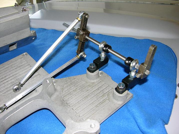

Hello Walter,
Yes you are correct in identifying the dual linkage as Enderle pieces. As for the length in the photo of the rods; they were just for photo purposes. I have various lengths and would use and or adjust the length as needed. Hex rod stock can be purchased in lengths up to 24 inches long! I have a couple spares as well as a 10/32 LH & RH taps for the rod ends (heim joints). This is the same stock I use for making Weber linkage. As for my Ram Box manifold, unfortunately it sits on the shelf along with the 2 tops and two Holley 390cfm NASCAR type carbs with “Lemans” bowls (long nose). I thought it would look cool. I may use it some day.
Another note on the linkage for the dual four set-up. The driver side carb is designed to be mounted in reverse (backwards). I have seen some guys using the RamBox dual four set-up wrong and they wonder why they are having fuel mixture distribution issues. Drivers side carb needs to be mounted backwards! The clearances on the top are for the carb linkage arms.
