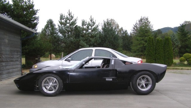

What you see here is the foundation for a Mk 1 Road carn. No doubt you’ve all read about, if not seen for yourself, the remarkable starting point Fran Hall and his team at RCR has provided for builders. On the off chance you’ve been on a hunting trip for the last year or so, the quality of the body work and chassis are artwork; the chassis welds could bring tears to your eyes they’re so good, and the bodies, well, they’re just plain exceptional. It’s no wonder the backlog of work at RCR continues to grow.

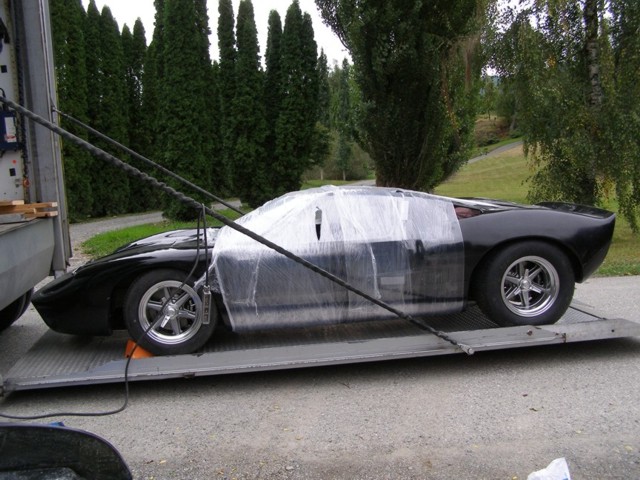

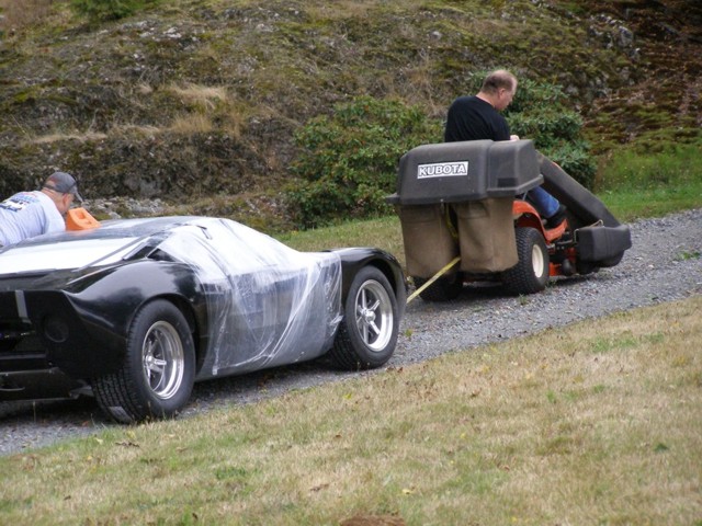

Until then, here’s a couple shots of the arrival (I'll bet you had no idea a lawn mower could pull one of these up a hill) More soon…

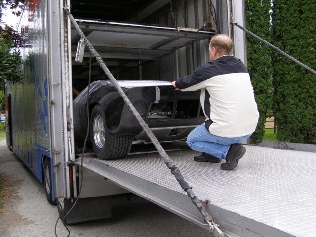

First, I couldn’t have been more pleased with the delivery of the car last fall. RCR’s Fran Hall and more than a few forum members strongly suggested using Rich’s Classic Transport for the hauling. Several conversations and some weeks later, Rich delivered the car and even helped me get it up the driveway and into the garage as shown in the previous pics. A number of other transport companies I’d contacted were unwilling to commit to delivering to the street in front of our home, let alone be of any more help - Rich and Doug of RCT, on the other hand, were more than helpful getting the car to its new home (they’re definite car-guys, too). I’d highly recommend RCT to anyone needing a car transport.

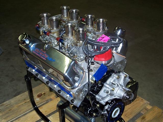

Maybe six weeks ago I shipped off the carbs and an oil pan from Armando’s to Keith Craft Racing Engines. I’d heard nothing but good things about them, the quality of the engines and how they stand behind their work. Well, three weeks ahead of schedule and just last Friday, I received a call from Tony at KC announcing that my new 331 is finished, dyno’d and is ready to be shipped. Although I was a little disappointed in the 435 horsepower figure, I was very pleased with the 450 ft-lbs torque which is, by the way, nearly equal to the 427-equipped Corvette I had some years back – and destined for a car weighing at least 1000# less!

Your HP seams a bit low. Any specs on the camshaft in the bling blanger?

Neal – The cam is Crane roller, #TFS-51402001 (Intake 542 lift / 286°, Exhaust 583 lift / 294°); the heads are AFR 185’s. I’ve since learned that the horsepower ‘issue’ may be more closely related to the 48 IDFs on top - they're not IDA's. When I discussed my preferences with KC prior to placing the engine order, I’d hoped for results a bit closer to your 8-cyl monster. What I didn’t know then was how Webers have a real affect on those horsepower numbers, and what I still don't know is how IDFs match up with IDAs. Had I opted for a 4-bbl carb, I was told this engine would easily make it to 500 horsepower. Oh well. I’ll just have to suffer with this underpowered boat anchor for the time being. :)

I have a slightly larger comp cam in a 342ci with afr 185 heads and dual 4 barrel carbs. I am expecting around 500 HP. It sounds like from your experience I should be pretty darn close.

I am always amazed at how disappointed people are if their engine does not make 500hp, one friend of mine would not pay the engine builder until he had a dyno sheet for 600hp, I watched several dyno sessions and this engine made about 576 pretty consistently with a lot of torque, the engine builder was finally able to come up with a 600 hp pass after he used every trick and device he had, most of them would make the engine very difficult to drive on the street, My friend was happy, he has a sheet with the magic number but I suspect that this engine will produce about 525 hp in the car and I will still be able to run rings around him with my weber equipped 347.
The essence of these cars is hard to capture, some one will always have more horsepower or money and we can all get a lighter. faster car than a 40 (RCR Lola, Penske PC 7 Indy car?), The webers and the 180 degree exhaust are a big part of what makes this car for me and I think that you will find your 331 will easily allow your car to exceed your capabilities (I do not mean that in a negative way, any of us could easily outdrive Dan Gurney or any of the fine drivers from that period!).

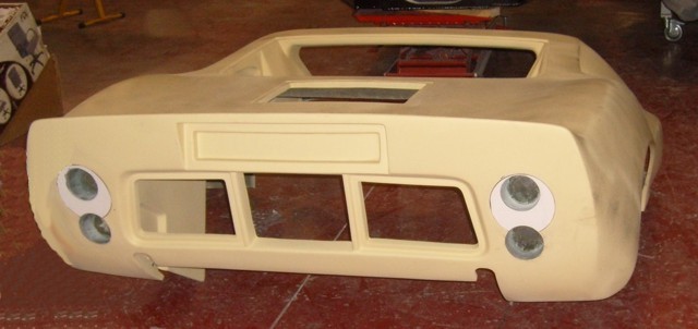

One of the first orders of business was to modify the tail section to the early 4-lamp rear light setup, so Frans bodywork team went to work on it. Having an original tail section hanging in the RCR shop made for easy reference; in no time it was done and the primer was applied.

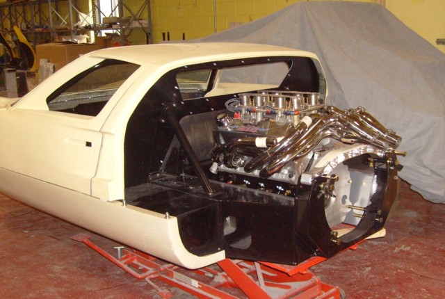

And then the engines first test fit…
