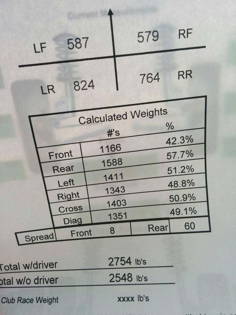

The verdict is in and my wallet is dry but its officially aligned, weighed and race prepped. Check the attachment for weight and four corners weight distribution.
This is with 10 gallons of fuel so it weighs just under 2,500lbs.
Wow, 2500lbs!
That's a street car with a LS3 motor, G50 transaxle and a relatively bare interior...Correct?
That gives the rest of us a baseline to shoot for!
