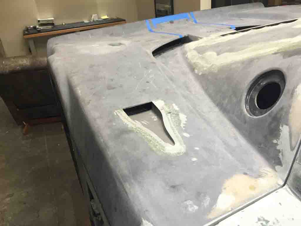

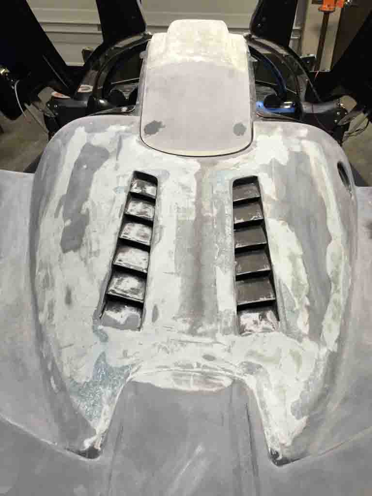

Rear Hood Vents- I wanted to eliminate the rear window... keeps people guessing. I leveled the recess and added fiberglass vents to improve cooling.

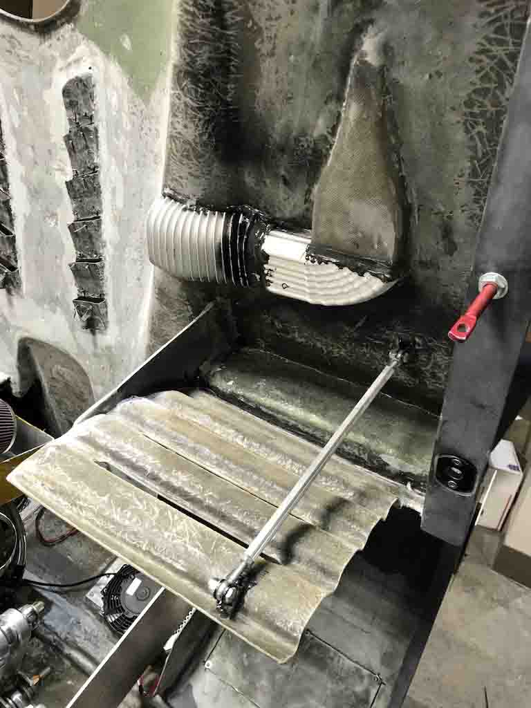

Splash Guards- The rear wheel guards are connected to the rear body and supported with an adjustable rod/Heim jts.
NASA Vents-Behind doors. Note the high tech use of flexible guttering to direct air into engine bay.

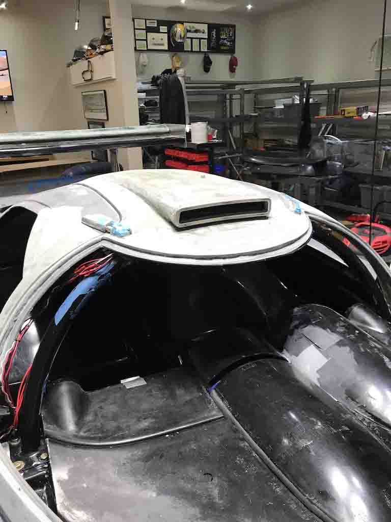

Roof Scoop- I learned a great technique that can save tons of time. Go to Hobby Lobby and buy the scrap lexan material that they use to serve as glass over pictures. Cut to shape, roughen and panel bond. This will save tons of time with fabrication. This is what was used to create the "tunnel" from the front roof scoop passing air back to the cold air box . BTW- I love the shape of this scoop too!

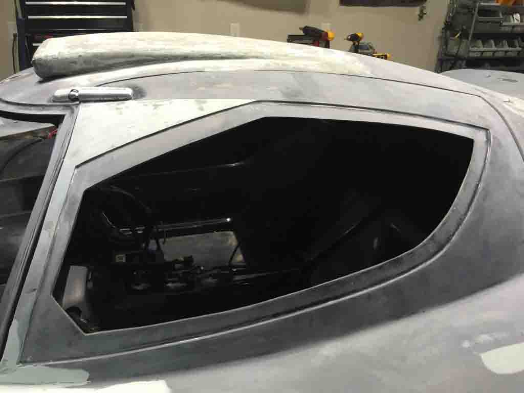

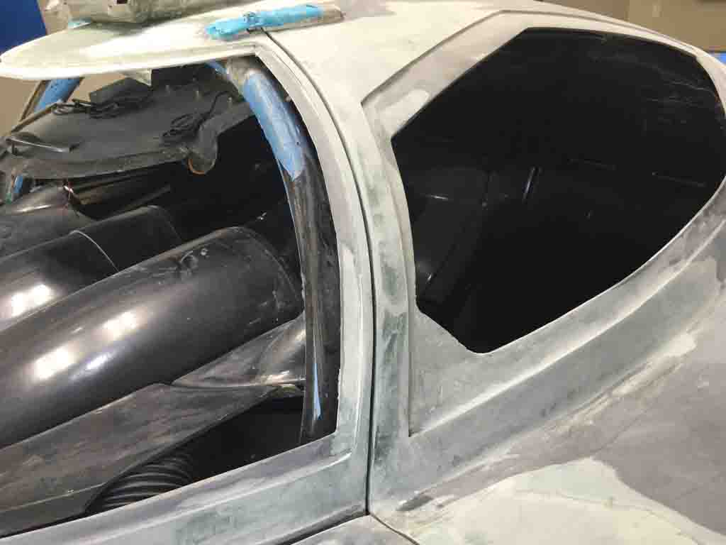

Windshield-Windows- Note that the side windows don't extend to the front of the door. Fiberglass was added so the leading edge is not the lexan side window. I also fiberglassed around my glass windscreen, building up the "A Pillars" so they are flush with the glass. I have a DOT approved lexan windshield for final install. Thus there will be no gasket but instead a smooth transition from windscreen to body, body to side windows.

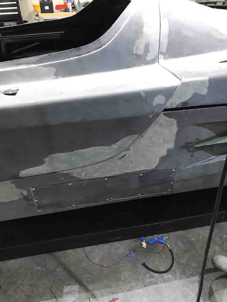

Accusump- An access panel was added on the side to service the Accusump and E Stopp. You can also see that I modified the rear inlet.

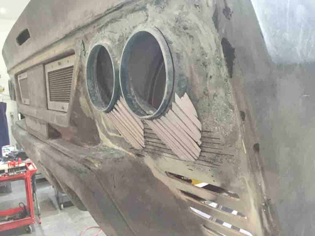

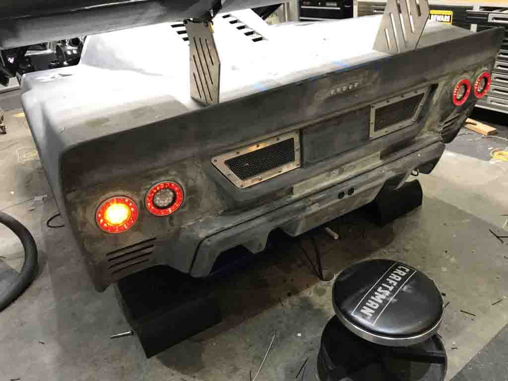

Tail Lights- Body was modified for ring LED Tail lights

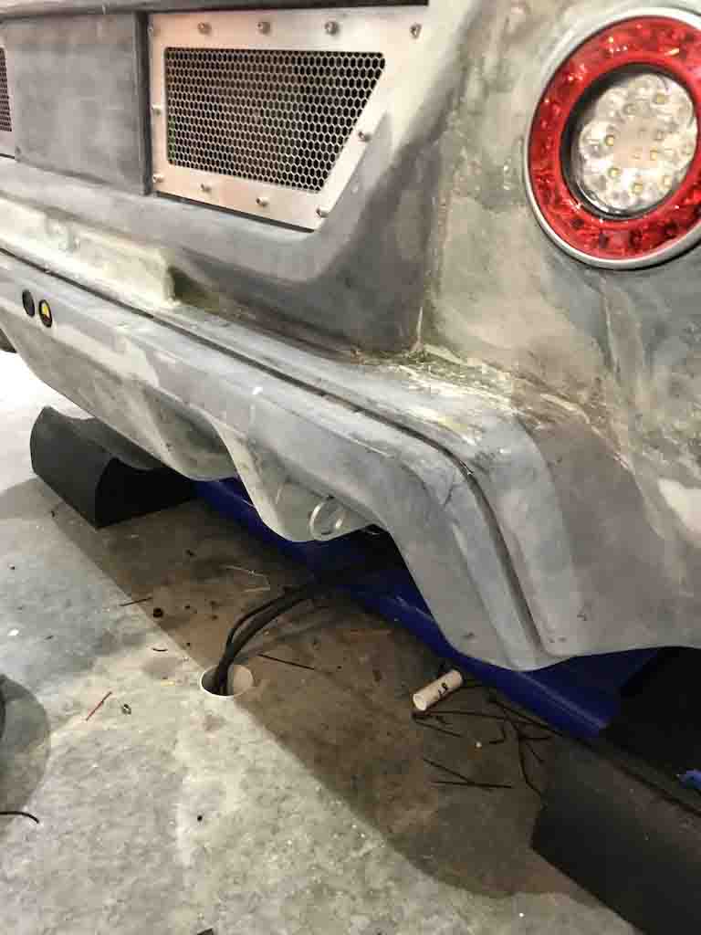

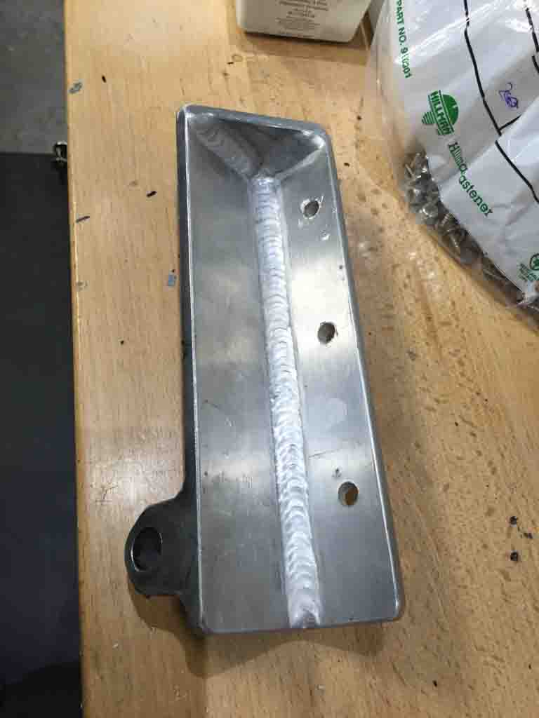

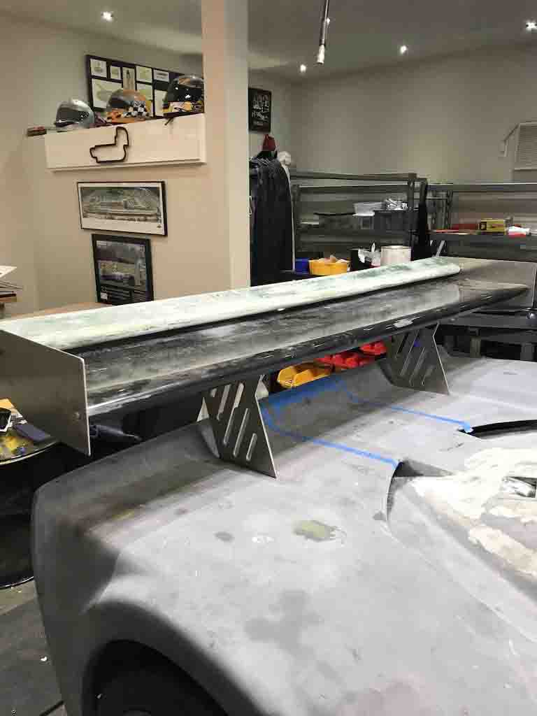

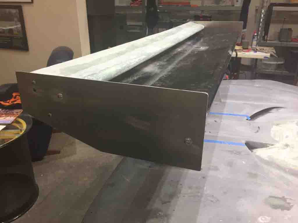

Rear Wing-A support was fabricated that incorporates with the rear hinge. The wing supports connect to this transferring down force to the chassis.A second wing was fabricated just because I think it looks cool.
Rear Tow Hook. A rear hook also extends from the hinge area. You can see the rear diffuser was modified to cover the back of the transaxle.

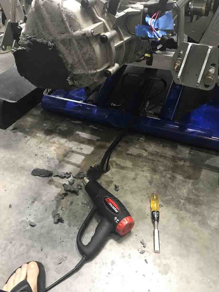

Transaxle-the ol heat gun was used to remove the black stuff :shocked:

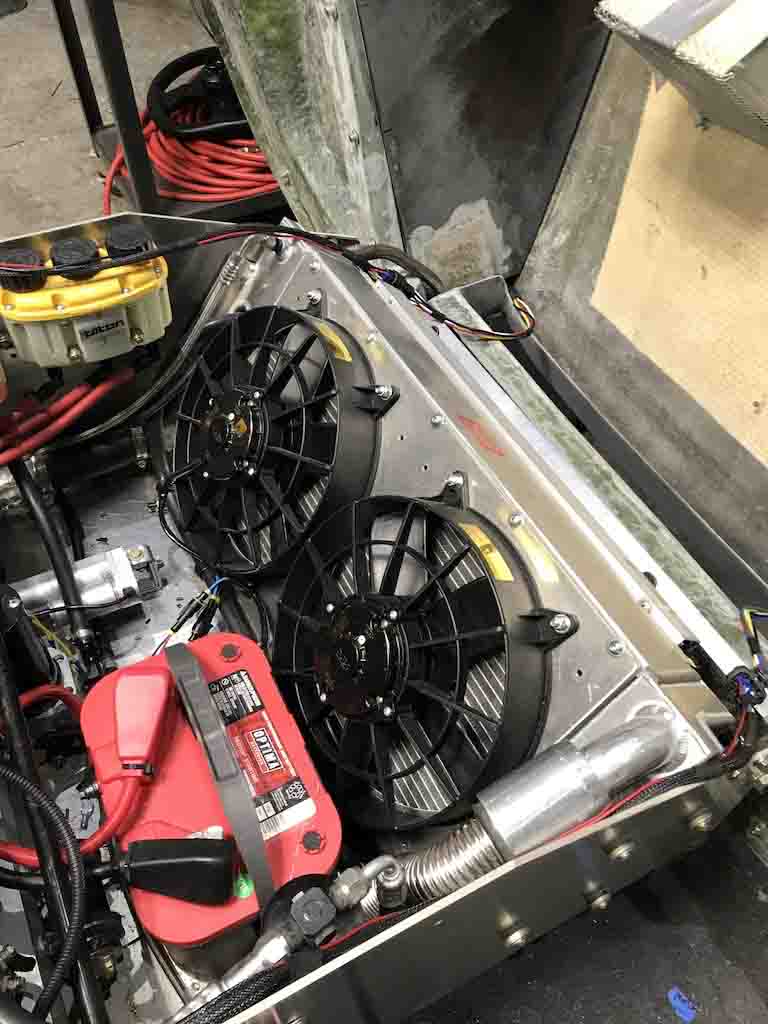

Note that fans are placed over the rear screen vent to exhaust for air. The body behind the rear tires was vented too.

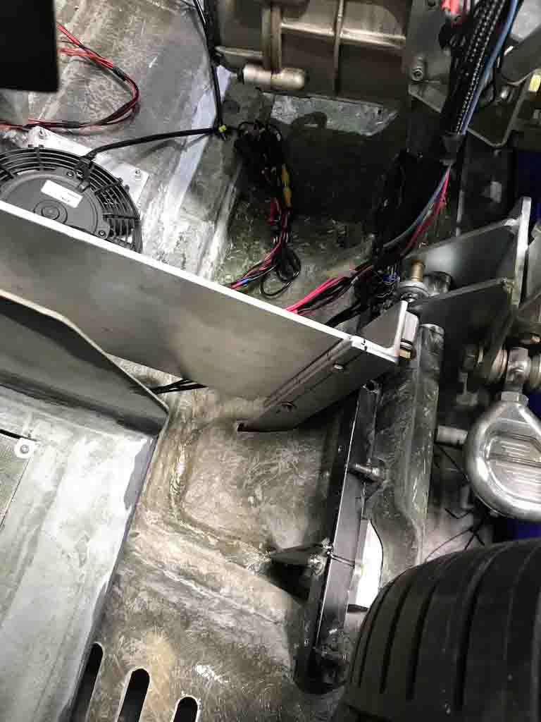

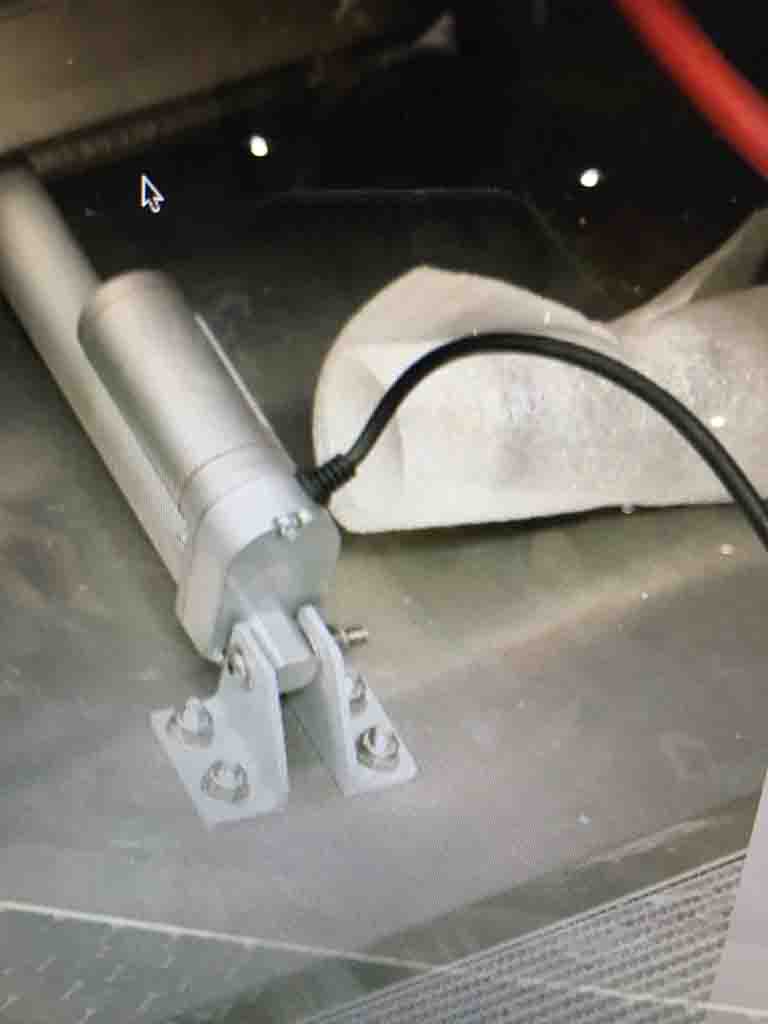

Foot Pedals- A motor was added to move the foot pedal assembly.

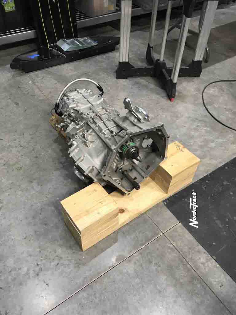

Gears- Guess who got new gears installed?

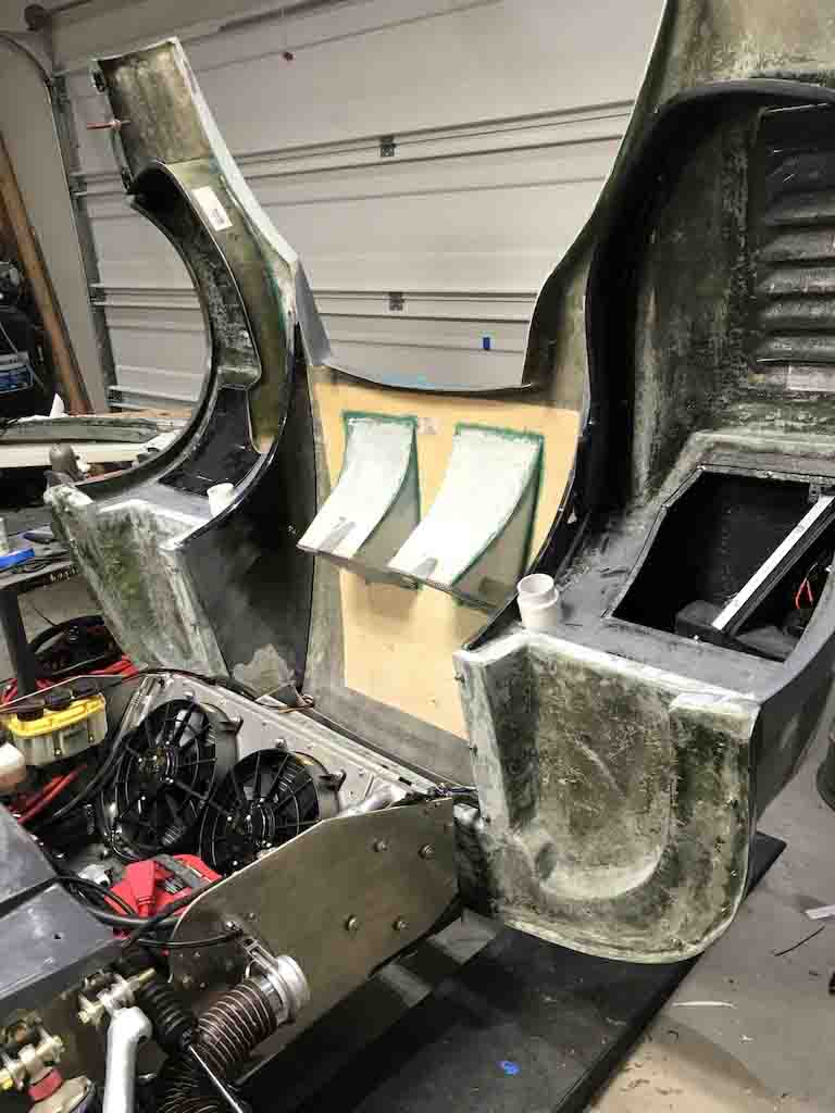

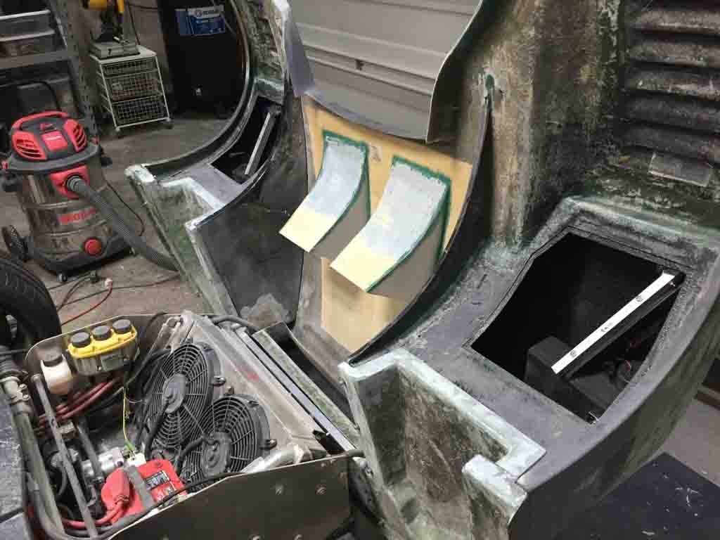

Front Nose-New fans up front, a hinged front end, and you see the vents formed for air escape from the radiator. I think it makes the front end look killer!
I also modified the center section extending fiberglass all the way across.

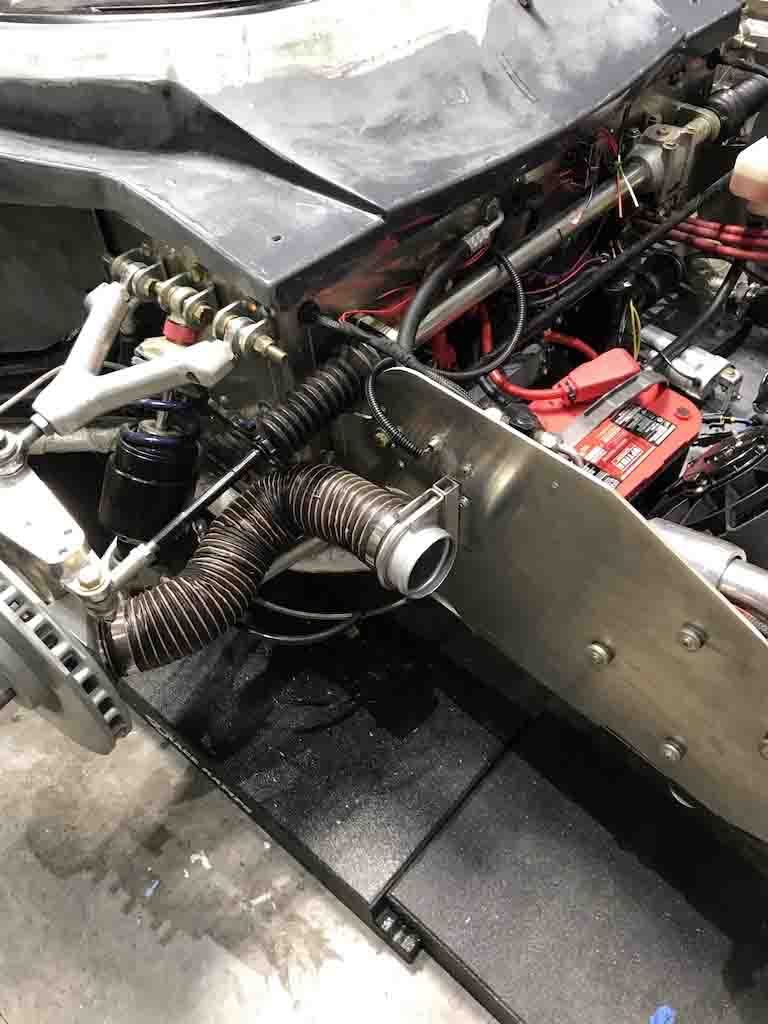

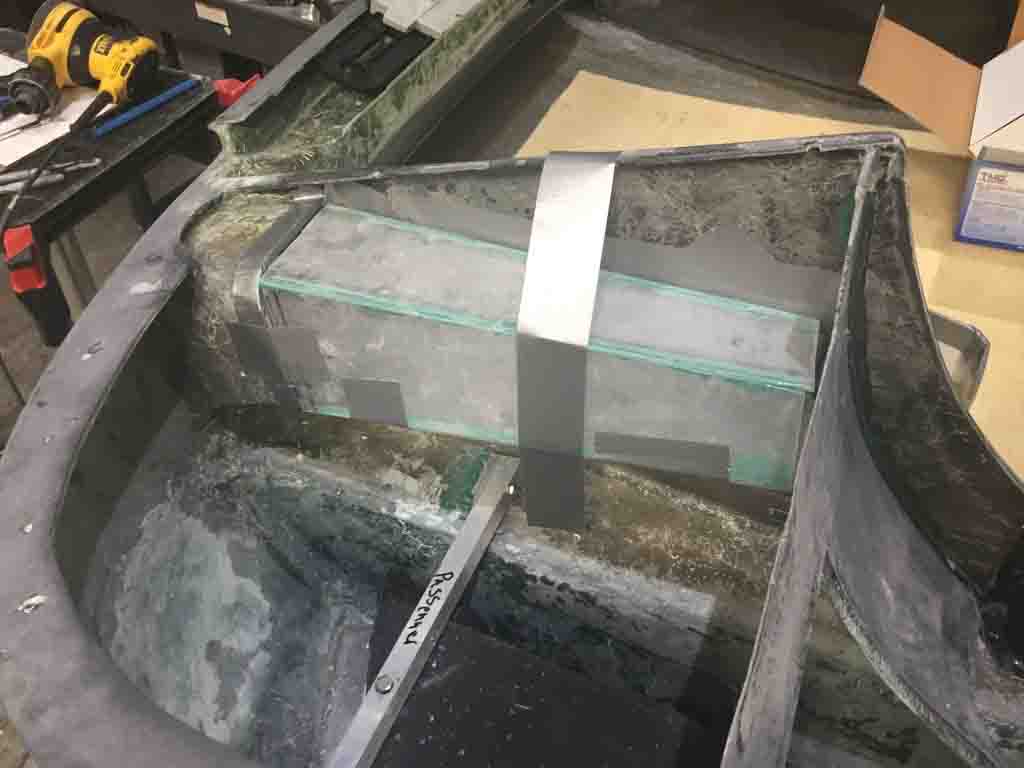

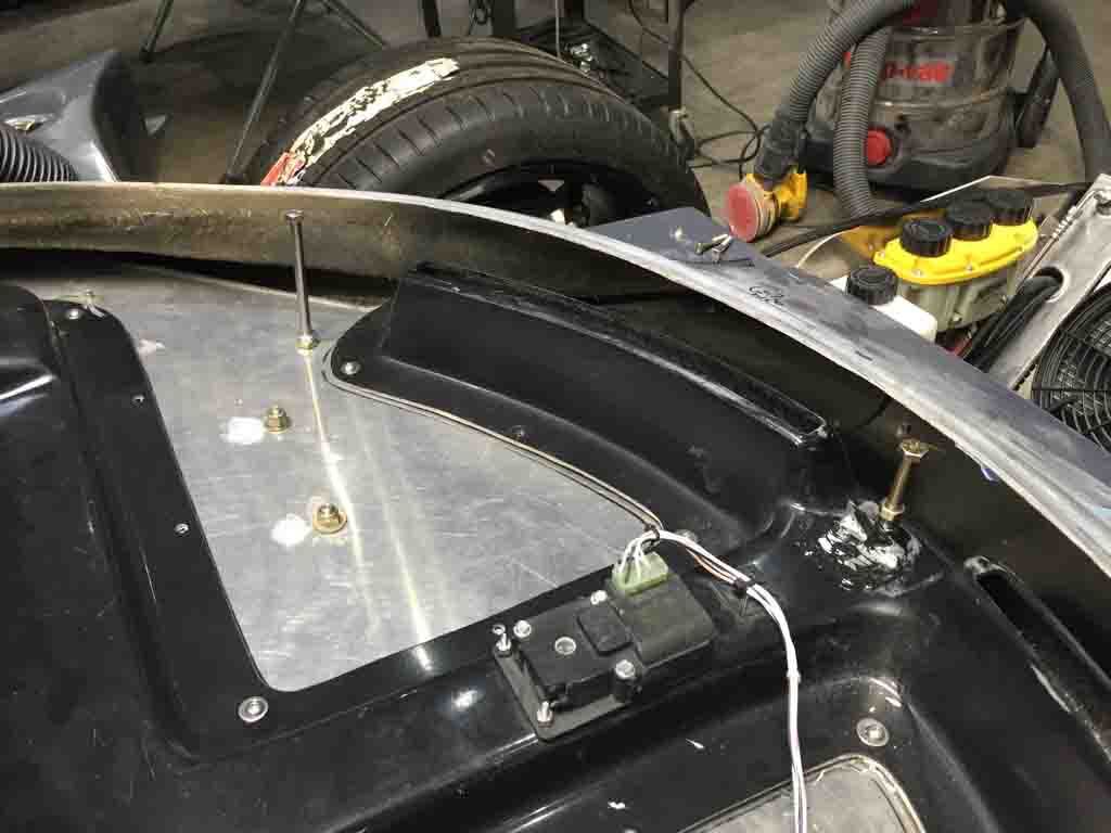

Brake Cooling-Front brake air hose assembly should help. I fabricated tunnels from the HL lexan. The PVC lines up nicely with the ducting when closed.
Dash-Dash supports have rubber stoppers that will hopefully reduce rattles. Removable access panels make repair more manageable.

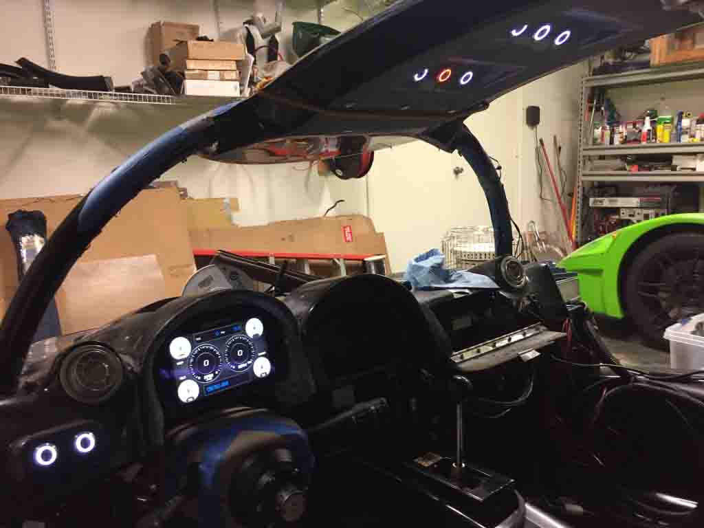

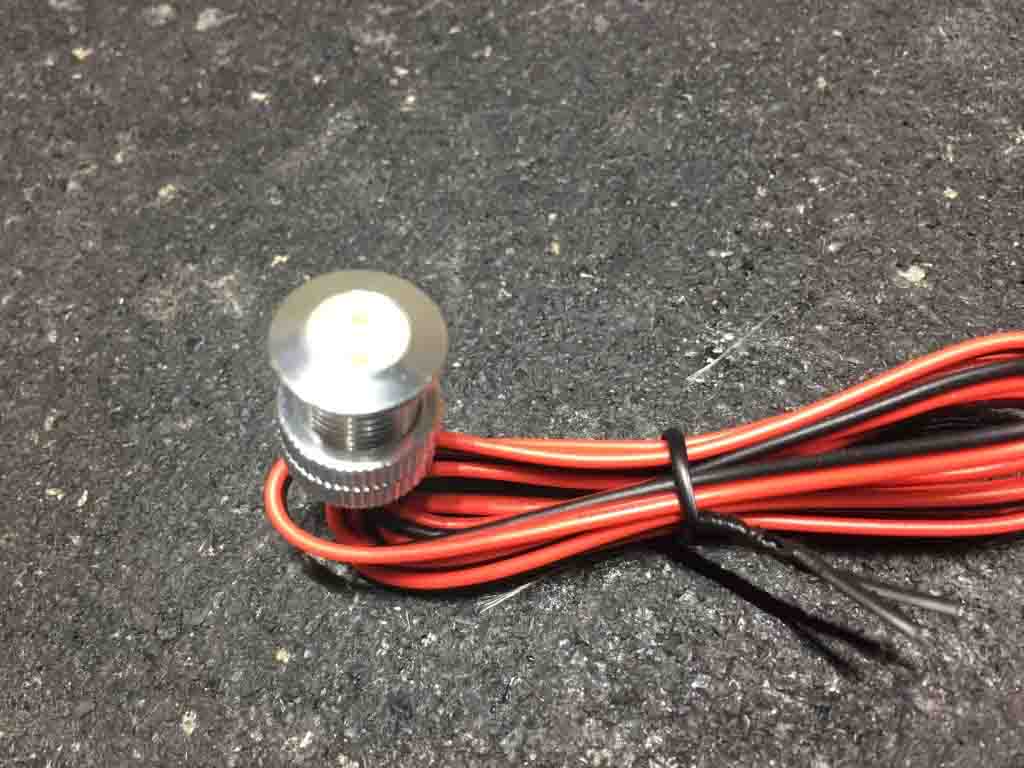

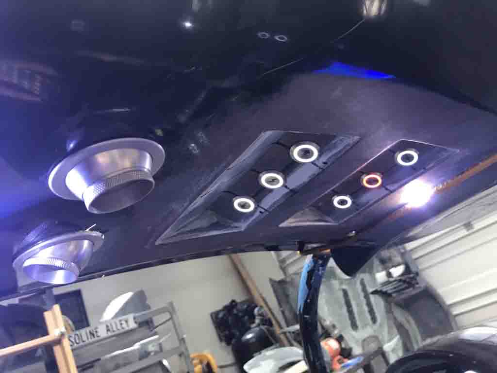

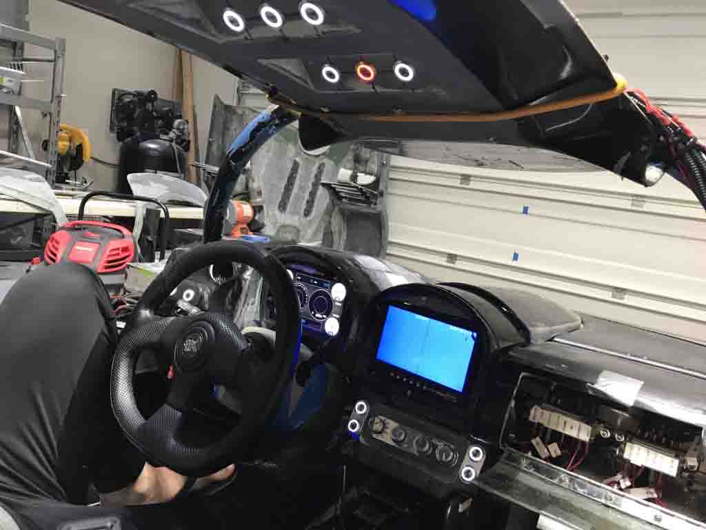

Special thanks to Craig with wiring! When my electric doors open (TY Alan), 2 LED dome lights, 2 LED's from the center console, and 2 LED's under the dash come on. They turn off when doors close. However they are switched so they can come on when the center console button is pressed (and doors are closed).
All of my buttons have custom logos and are "ring Light".The buttons on the ceiling console are...
POWER
HAZARDS
Driver Door
Passenger Door
Driver Map Light
Passenger Map Light
Center console buttons operate...

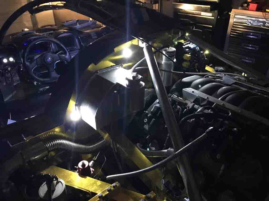

Engine bay LED's
Front trunk LED
Glove box LED
Off/On dome lights
You can see that I have aircraft style vents in the ceiling for bring air from the roof tunnel.

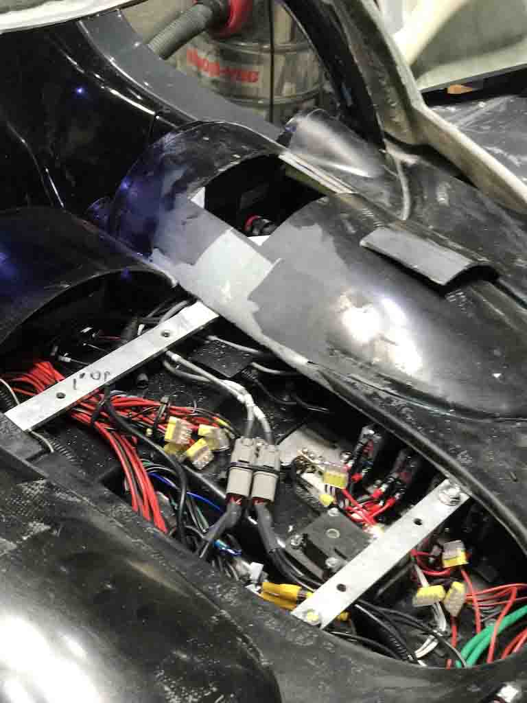

I HAVE SPENT SO MUCH TIME RECENTLY REWIRING THE ENTIRE CAR. BTW- I AM AMAZED BY THE CUSTOMER SERVICE THAT JAY HARRIS PROVIDES. I DECIDED TO SOLDER EVERY CONNECTION AND UTILIZE PIN CONNECTORS WHERE PARTS NEED TO BE SEPARATED. I JUST GOT NERVOUS WITH CRIMP CONNECTORS?

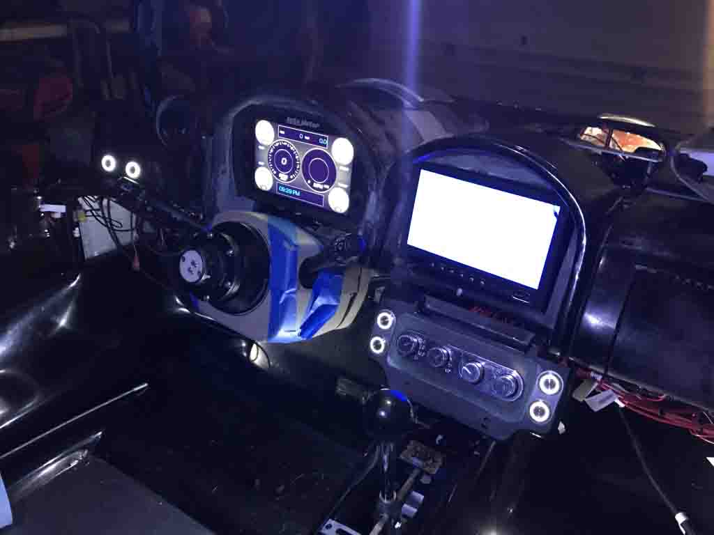

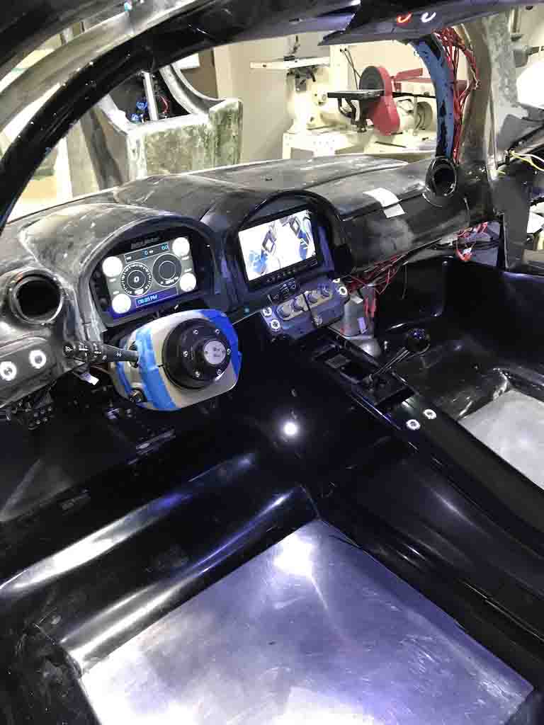

I am using the Autometer LCD Dash. It is fully configurable and customizable. (I respectfully defer all questions to Craig. If you want to know about teeth, feel free to ask me). It shows milage, GPS speed, when the sun sets etc. It looks awesome too.
I am also using a back up/rear view camera(s). One is wide angle and the other close up. 1 or both can be displayed. Its also has a back up grid.

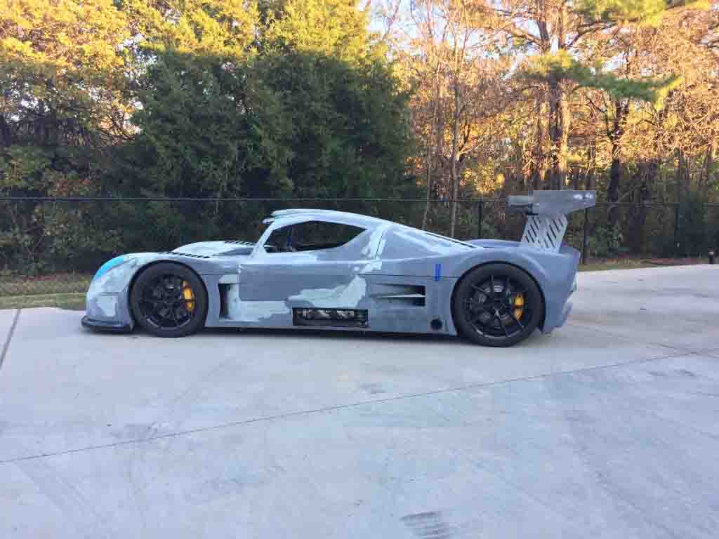

The car is at the interior shop now having preliminary fitment of panels. WE are waiting on the new RCR gated shifter (Please Fran- I need it). Then off to body work. I have had a change in exterior and interior finish. Stay tuned...

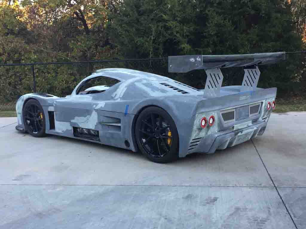

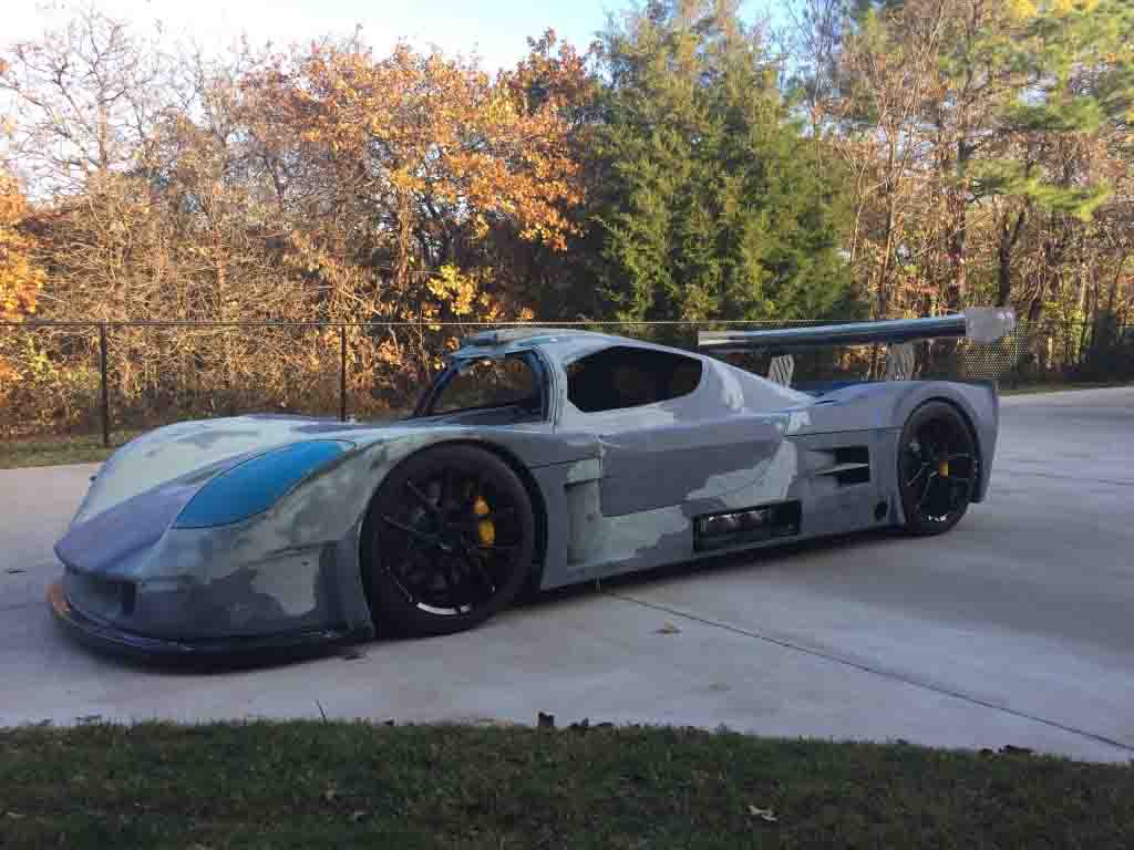

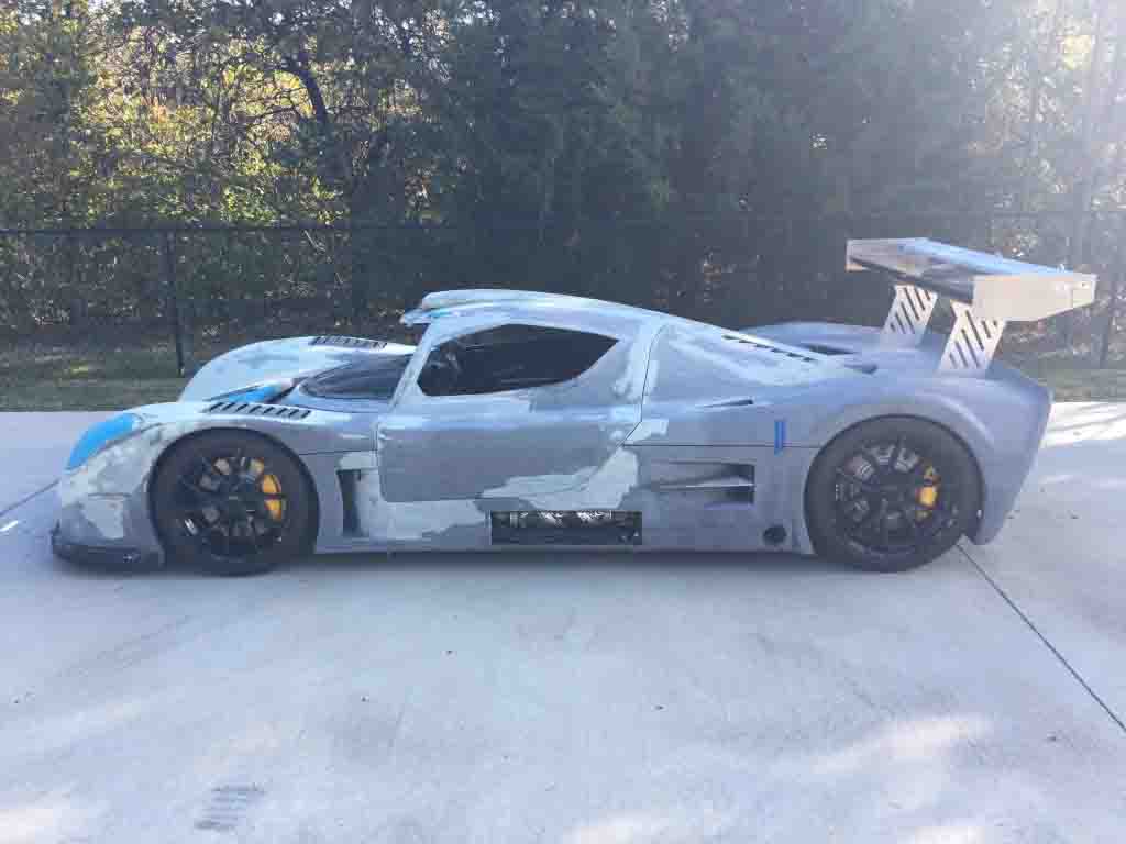

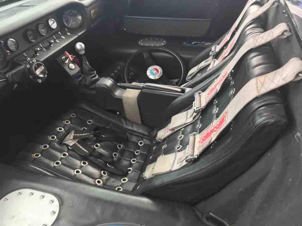

With a helmet on, I just don't have the space I want. So... I am having custom seats (very simple) made much like the old days. In my formula car, I sit on the frame panels with a poured seat. I will have a similar solution keeping me with maximum room. A seat much like this ON IN A GT40 will be made. A spacer will/can be added behind it to bring it forward SO MY WIFE CAN REACH THE PEDALS.
