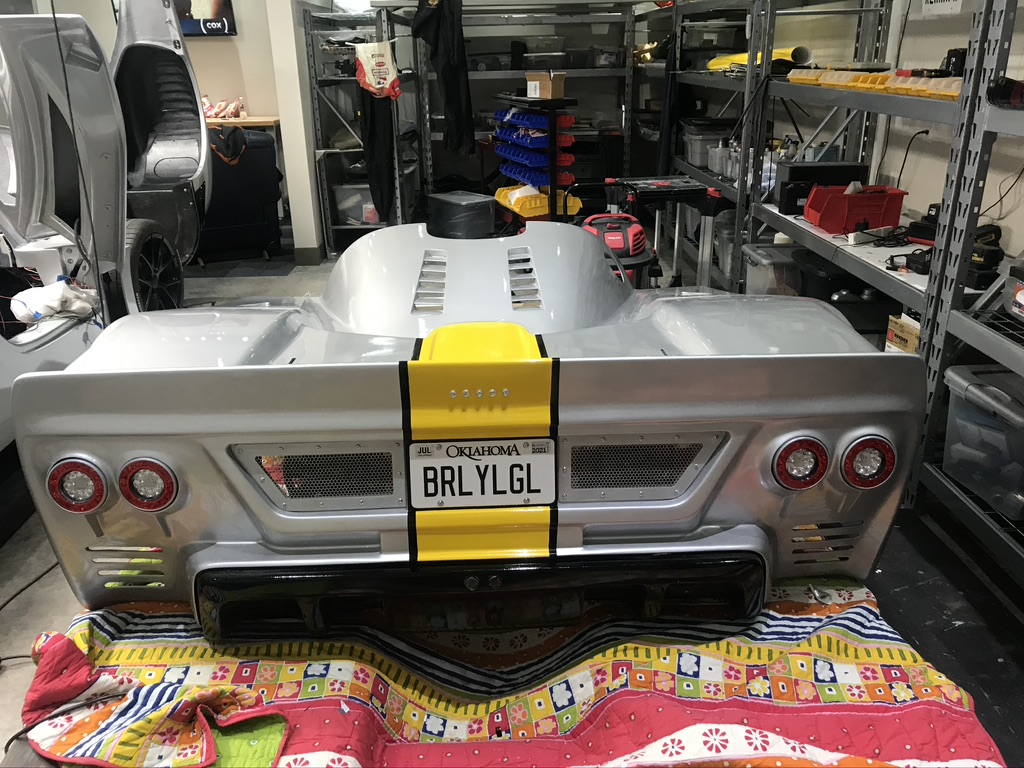

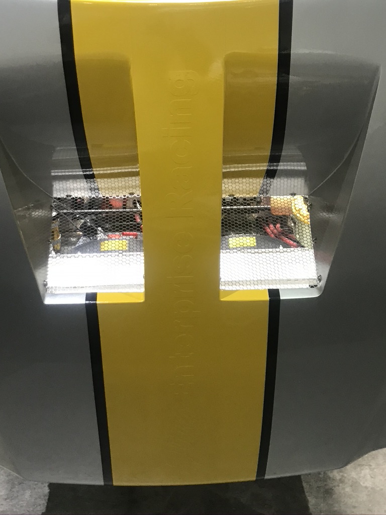

The little fans on the rear vents are a great idea. How much difference do you think they will make on the engine compartment temperature? Living in West Texas any cooling ideas are welcome. Great build !!!
I have no idea... it just seemed like the right thing to do. They are triggered to come on at 200 degrees. Much like the front vents, I just liked how it looked. Hopefully it will help.
