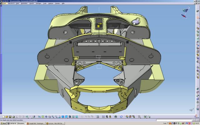

..here some little update:
I finished everything except the rear horse collar so far, so in two to three weeks time the drawings shall be ready for cutting the sheets..

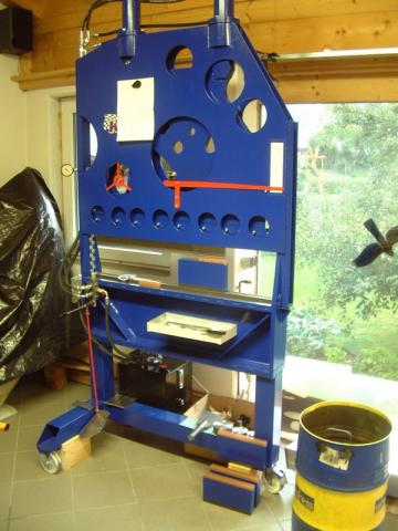

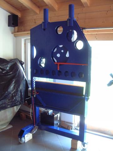

I was terribly busy the last few weeks in my regular job, but my father and me managed to get the bendpng press done (in the picture just the hydraulic lines are missing which are done by now) and did some installation work on my (new to the shop) WF1.
August is fabrication month: monocoque.
PS: check the highly illegal foot control on the bending press ;-)

Shame on you for stilling the curtains of your village's school!
You bending press really looks like coming from outer space! I like it.

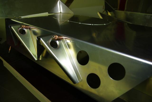

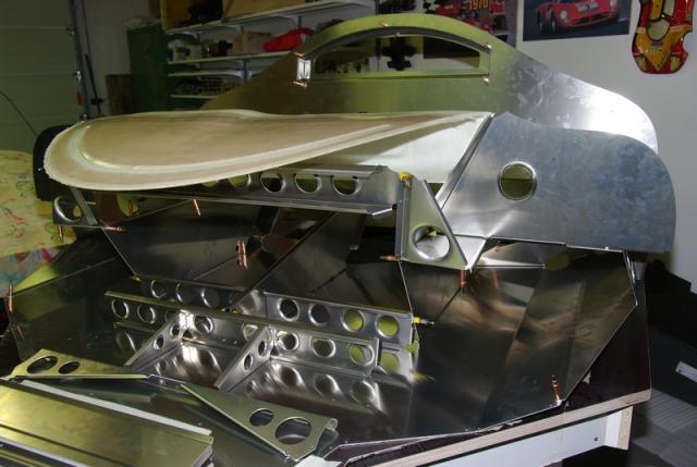

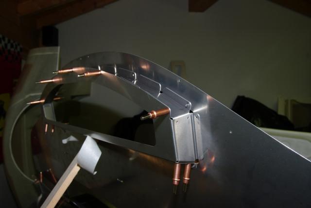

..after sorting out the troubles we had with our equipment me and my father yesterday started to do some more sheet metal work. Surprisingly two days of work produce quite some ready for assembly parts.
As we were courious about the fitting of all the bent parts we tried to index them to each other and ended up with a big, big problem: ...everything just fitted perfectly in place. Check the attatched pictures for our progress.
The next two weeks will be full of work like this until I will have to be back at my regular job.
As we were very happy with the days result, we finished with salami, beer and schnaps (the Austrian whiskey)!
Best greetigs from a nice autumn day in Austria...

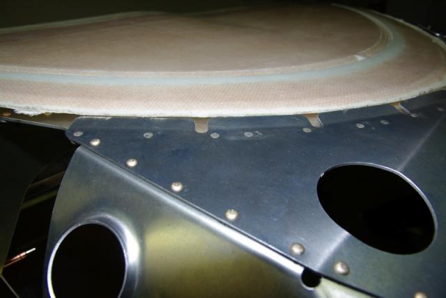

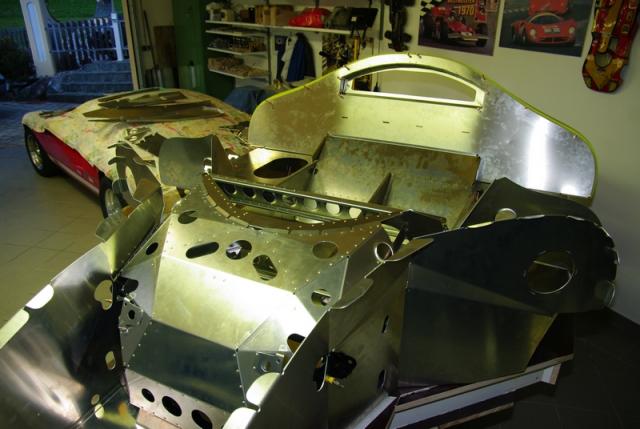

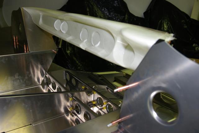

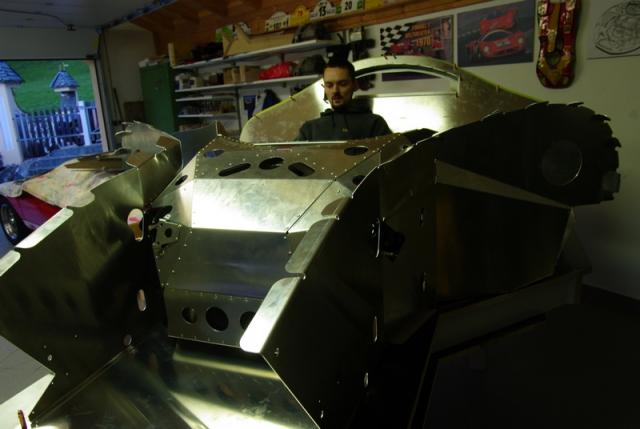

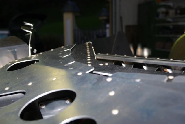

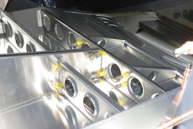

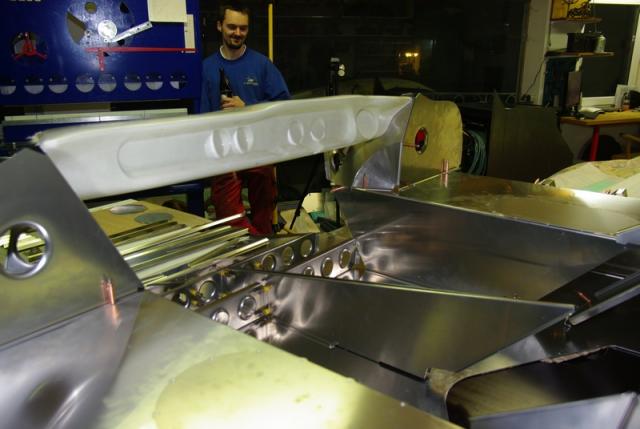

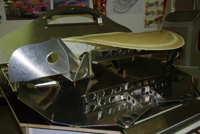

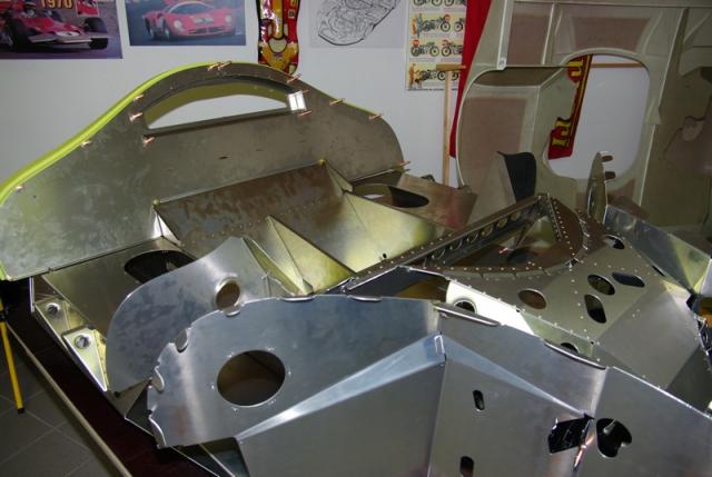

...the welding of the steel parts was more work than expected, also the painting was quite demanding. But, fortunately, dad and myself had three very productive riveting days, see pictures. Today I tried the drivers seat, and believe it or not, it is more comfortable than our GT40 (in one picture it the sister car even was degraded to a shelf, sorry for that...)
four to five effective days should give a finished monococue if we can hold that speed. Sadly my holiday is over, so we have to do the remaining stuff on weekends.
best regards from Austria,
just about now we leave for a good Austrian style meal and some Schnaps to the Hatzhof.
