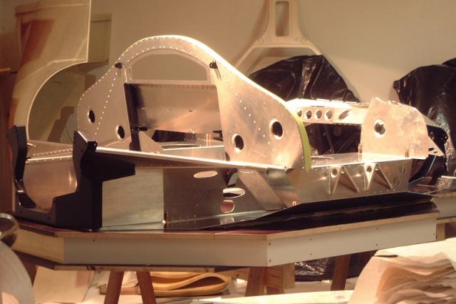

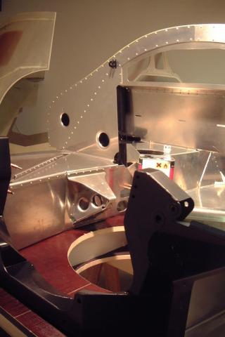

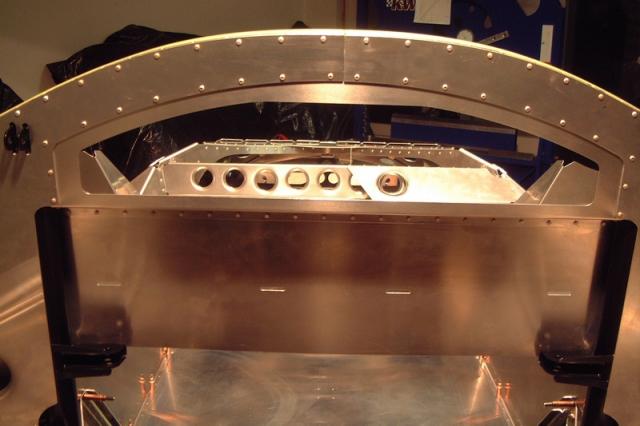

..the monocoque is coming together quite neatly.
Yesterday, with the finished main bulkhead we checked the gap between the door and the structure. Its good even though the parts were fabricated independent of each other.

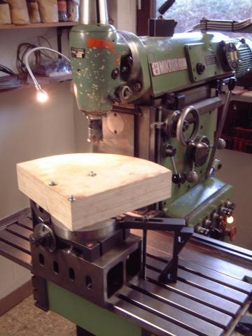

I attatched a picture of machining the mandrel benders turning die. Well this is from a very early stage, but I didn't take any more pictures after that step. Again, after the weekend..

greetings Leopold,

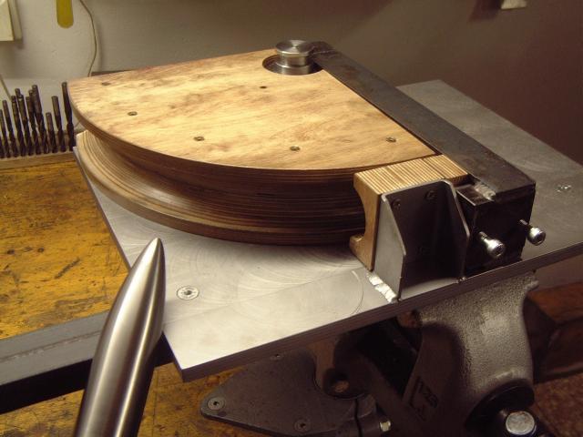

i am very interested in your radius form you are making
with the help of your Emco-Maier rotary table ---
what kind of wood did you use?
is it several layers glued together to
arrive at the desired thickness?
and did you cut the radius form on the Deckel style machine?
if you have the time could you please post more pics of the
completed radius form & your tube bending?

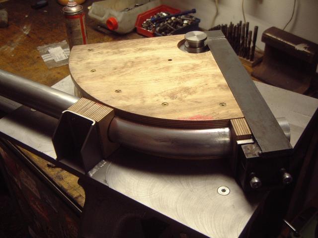

Hi Scott,
sure thing, i didn't post more as I thought it wouldn't be of interest.
Just give me time till mid of Jan, because I have no time to go home before that (and I don't have any more pictures of this tool on my PC).
Very well seen, the rotary table is an EMCO type, although it was nearly too small. I had to tighten the friction quite strong to keep it from vibrating during the machining.
The radius was cut after the picture above was taken, with the horizontal spindle (you have to dismount the head to use it). As I couldn't do it in one cut (too much cutting load as well as the lack of a radius cutter that large) I did it with a R6 radius cutter and used the pitch circle option on my DRO. I know, it is intended for drillings, but it worked fine for this purpose.
The material is multi layer birch plywood (as used in aircraft), because this wood has the highest youngs modulus of our domestic woods in Europe. At the beginning I wanted to use POM plastics, but the material would have cost me 95€, so I decided to go for birch wood, as the y-modulus of the latter is higher anyway.
I'll post pictures later,

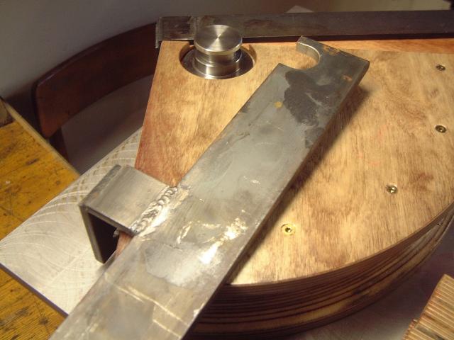

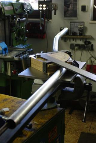

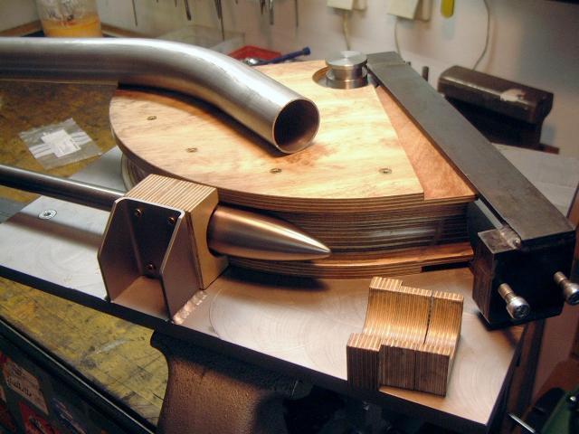

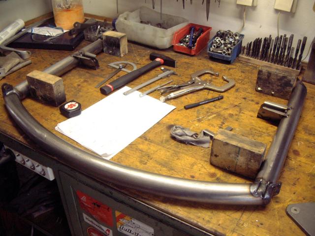

Scott, I made some pictures of one of the test bends this weekend.
The center line radius of the bend was in this case configured so that the most outward line of the tube has a technical strain of ~10%, which this alloy takes without fracturing (before ageing).
The mandrel is necessary due to the low wall thickness to diameter ratio, if it wasn't in there, the tube would just buckle during the bending process.
The only thing not shown in the pictures is the mandrel carrier, but this is just a u-channel to which the mandrel is bolted.
This is the lever on which you have to put a huge amount of force (even though it is 5 foot long).. My calculations say that the bending itself consumes about 480Nm, however there is a lot more friction to overcome additionally.
I hope the picures show what you meant.

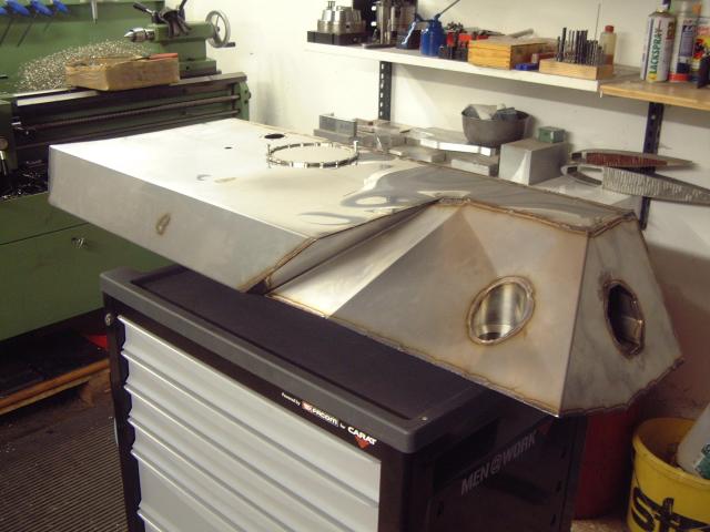

Gents,
here are some more pictures which I wanted to post but nearly forgot. Bending operations, finished fuel cell (very thin walled, check the distortion of flat areas), rolling bar, finished fire wall.
The last two items are already fit to/into the monocoque, next is fitting of the water pipes before the last sheet panels can be installed at the front and in the center.

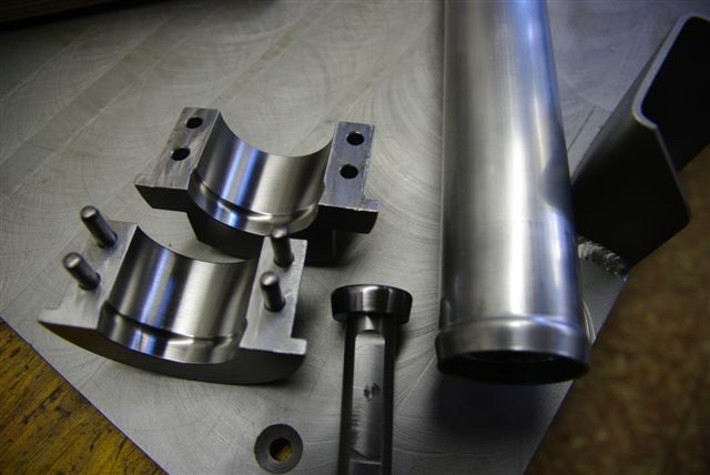

..more tubing progress..
The waterpipes are done, next time we make another spare set to put in stock.
The tool for flaring the hose seats took another half day to make but it works very nicely.

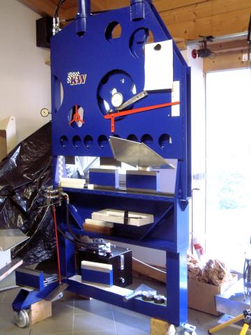

and i too am very glad you have posted more pics of your press. it is
a very cool piece of tooling & someday perhaps i can know more about
its unique design.
