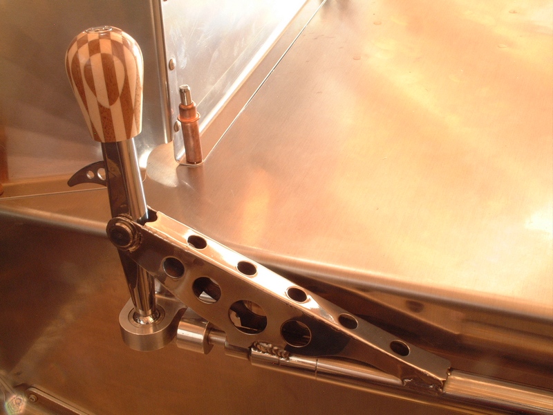

hi Leopold,
fantastic design & machining efforts . .
are the 2 "colored" parts (serrated steering link, i believe)
anodized? it is a very nice result.
the orange doughnut looks like an elegantly applied solution
could you explain what material it is, please.
AND ! like Olivier --- i have some
detail questions to ask of your tooling efforts so
may i also receive your email address please ? (!) : )
danke und grüße,
scott
harrisonville, mo
scott, thanks.
The shaft and fork extension are not anodized (they're not out of aliminium), these parts are heat treated with a (quite new) process which increases the surface hardness to about double the natural hardness (this grade) and gives the material an alloy layer which is completely corrosion resistant (very high class firearms are sometimes treated this way).
The orange part is an aircraft type universal joint (military standard). These joints are very precise and very stiff in torsion.

At this point I wanted to add a final picture of the shifter, as it is currently installed:
attachment.php

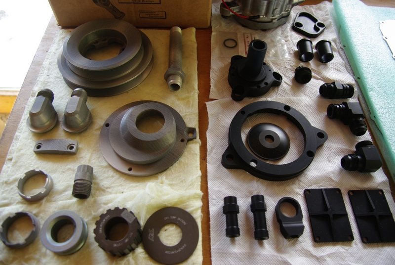

..this weekend a friend of mine and myself did some anodizing.
The picture shows some of the custom parts treated (the pulley at the bottom and its washer are not custom made, all the other bits are)

Leopold,
that is an excellent black result for your ano setup & efforts.
congrats.
did you glass bead blast the AL to achieve your "flat/satin" look?
i love this particular finish "look" more over the polished (read bling!)
result favorable to those paintball clients.
beautiful consistency in both patinas across the many parts.
you are accomodating the "artisan of the devilish details" . . . superbly.
:thumbsup:
Hi Scott,
good question..
No, those parts I didn't blast before anodizing, however in order to keep the results consistent, we used a transparent PVC canister in order to be able to check surface appearance in situ during the anodizing. I know, by measuring current and knowing the surface of the part this is theoretically possible, too, but not any more when you have more than one part hanging on the master rail.
I tried to make the parts gold before taking black, unfortunately this didn't work out well because I used different alloys of aluminum according to the mechanical use of the parts.
Thanks for your heads up!

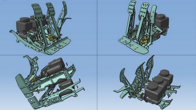

gents,
here is a snapshot of the pedalbox, I am currently deriving the drawings for cuting these parts.

Hi Leopold
That looks really good. ......
Thanks Mick, much appreciated.
How long did it take you to draw that ?
Approx. 65 hours of CAD and FEM time. The pedals are quite heavily loaded, the brake pedal is e.g. designed to take 2kN foot force, which gives 12kN (!) at the master cylinders. The fact that all the pedals are longitudinally adjustable made the design problem a bit tricky.
Best,
Leo
Ok i know that N can not be directly converted in kg, but just for a the sake of comparisson. 10 N = app 1kg; 2000n = 200 kg, doesnt seem to be a lot. I think the mastercylinder rod will have to take only 40 -60% of the 1200 kg due to the balancing bar setup or do you have a pedal ratio of 12 :1 ( more likely 5 :1 to 6:1) as well because it is only loaded along his axxis. I think the critical part is the balancing bar itself. which have to take the full 1200 kg as bent force in 90° to his longitudenal axxis. What diameter is your balancing bar and what is the center axxis distance of the two masters

Hi guys,
thanks for your comments.
@ Tom:
  • Newton can be directly converted to kg, the factor is 9.81, as you already said, approx. 10.
  • You are right, the 12kN of course split on both master cylinders, depending on the balance bar center bearing position, which is the thought or the mechanical principle of the balance bar.
  • When you say 200kg is not a lot, can you push with both your feet more than 400kg with your calves? Well for sure I know I cant ;-)
  • Of course the bending load on the balance bar is high. However you have to keep in mind that in a good lightweight design all the load carrying parts are close to failure when you reach the design load. If they weren't, it wasn't lightweight. Besides, the balance bar is the most simple part in this assembly, you can even analytically solve the strength calculation. Don't worry, it is safe.
