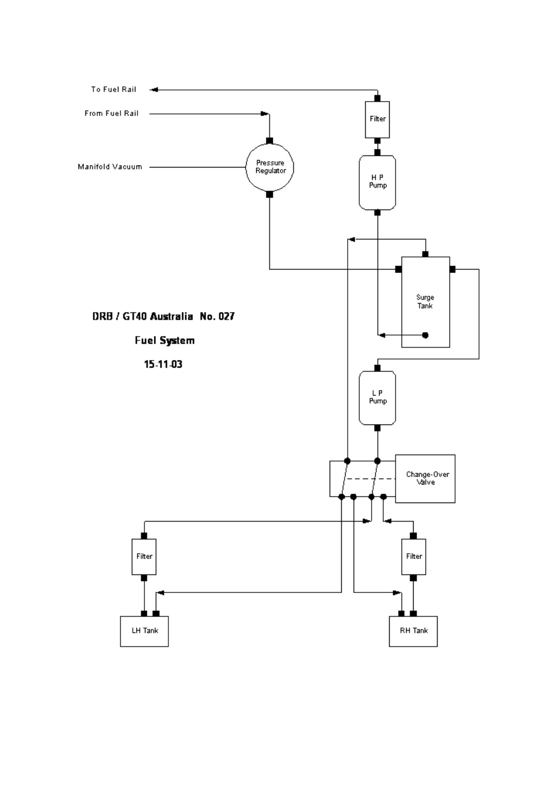

Hi Dave,
Attached is a pic of my fuel system diagram. The LP pump is basically a "lift pump" to keep the swirl-pot full - these tend to be more tolerant of pulling air for a while than the HP pumps. (And you will probably pull air, regardless of baffles in the tanks, if you park facing downhill for a couple of hours with fairly empty tanks).
Most GT40's simply need the swirl-pot as "holding tank" - simply because of the long fuel tanks which usually have the pick-ups at the back.
Hope this helps a bit.

Following Peter's schematic above, I'm not quite clear on what appears to be a return line from the Swirl Pot thru the change over valve and back to the main tanks.
Is it necessary to return fuel to the main tank?
Would a swirl pot float switch that turned off the LP pump eliminate the need for return lines to the main tanks?
Would a LP fuel pump be susceptible to failure if starting a stopping constantly?
Tim,
That's a return line for excess fuel (EFI). HP pumps push more fuel than the EFI uses(pressure regulated). From the changeover valve, the excess fuel is distributed to which ever tank is currently being drawn from(no possibility of overfilling the wrong tank).
Hi Tim
Interesting idea re the float switch and only topping up the swirlpot as required - I like the idea but suspect that running the same fuel repeatedly through the fuel rails will to an extent turn the swirl pot into a radiator, which will gradually take heat from the engine back to the pot, thus heating all the fuel you are drawing from - not ideal.
The swirl pot is important though, without it, unless you have very tall tanks (bit like Dave's R42), you won't maintain an even (air free) delivery of fuel to the engine - which in turn will make it a bitch to tune, will run lean and lose power every time air runs through the fuel rails..
Tim Kay

Good point Paul
Are the return lines from the swirl pot to the main tanks gravity feed?
The design I am considering would be just like Peter's. Since my left hand driver side fuel tank is shorten due to the position of my battery box I think I will reduce the passenger side fuel tank the same and use that rear area for my swirl pot. But gravity feed from swirl pot to main tank may not work, especially to the opposite side tank.
Thanks Gary and Buzz, more design suggestion would be helpful /ubbthreads/images/graemlins/tongue.gif
Hi Tim
The 'non-injected' (excess) fuel returning from the fuel rail back into the swirl pot, together with that being added by the lifter pump, will create an overflow condition and it is this which will flow back to the main tank(s).
The lifter pump needs to be able to flow enough fuel at max rpm/full throttle to keep the engine fed, so when the motor is idling or at part throttle, ALL the excess capacity of this pump will be fed back by the overflow return from the swirl pot to the tank(s), together with any air that might have been picked up by the LP pump during cornering/braking etc. Consequently, the fuel will be flowing at quite a speed during idling and part throttle so there will be no problem with it flowing across to either tank.
One thing, always make sure your return lines/fittings are capable of flowing the max capacity of your HP pump without causing a restriction to the flow, if they do restrict and cause a back pressure, the fuel pressure regulator will have a hard time holding the desired fuel pressure.

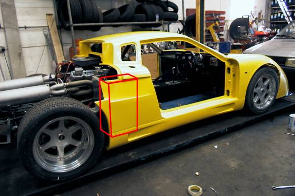

Returning to Dave Parker's R42 - this has no swirl pot, feeds from one tank and returns the other with a 2" dia balance between the two - but his tanks are tall and short, see pic below where I have indicated the location/shape.

Tim, I suspect that the swirl pot will be under slight pressure all the time, courtesy of the LP pump - so any overflow of fuel or air should be forced from the top exit of the swirl pot back into the tanks, regardless of where you mount the swirl pot. Buzz Clarks setup seems to bear this out - his are just mounted inside the tanks, but I would bet that the same situation would apply to the return lines / venting ports at the top of his internal pots.
Paul's point about the heat transfer provided by continually cycling fuel is a good one. I only really noticed it the other day, but I had the engine well & truely up to temp with the clip closed, then opened the clip & put my fingers on the fuel rails - they were stone-cold, whilst everything else around was way too hot to touch !
Colder fuel = denser fuel & no vapour locks. I understand that some drag racers use ice-filled "cooler boxes" to run their fuel thru for this reason.
Kind Regards,
Peter D.

On the schematic above the return from the fuel rail goes into the swirl pot. 3 questions
1)If the swirl pot is slightly pressurised would the return feed not also be pressurised to force the return fuel into the swirl pot and thus put additional back pressure on the rail relief valve and hence invrease pressure on the injectors?
2) If the "hot" fuel is returned to the swirl pot are you not possibly continually heating the fuel?
3) Would it not be preferable to T the return from the rail into the excess return from the swirl pot this should be at 0 pressure and flow direct to the fuel tank from which the fuel is being drawn.

Peter Delaney
Hi Ian,
I am a complete amateur when it comes to EFI, but I felt comfortable going with the setup in the diagram after pouring over it for some time - just based on logic.
With regard to your questions :
1) At the end of the day, we have 2 fuel circuits operating out of common swirl pot. The HP circuit pump just works away at pressurising the injector rails, and fuel that is not used by the injectors is returned to the swirl pot via the regulator - ie, return pressure is much that same as in the swirl pot. My understanding of the regulator is that the HP side stays as set, as long as the downstream (LP) side pressure is lower.
The LP circuit pump simply keeps circulating fuel from the tank to the swirl pot & back to the tank (just keeping the swirl pot full). Any excess pressure in the swirl pot would just ensure the flow of fuel back to the tank. My setup has vapour breathers from the tops of each tank back to a carbon cannister, so pressure in the tanks should be pretty much atmospheric (ie, virtually open).
2) The HP pump keeps circulating fuel around the rails & via the swirl pot (potential for heating up the fuel), BUT, the LP pump is also circulating fuel from the tanks to the swirl pot & back. This last bit is the secret for keeping the fuel cold - the tanks effectively act as huge radiators. As I mentioned, I can put my fingers on the fuel rails after the car has fully warmed up, & they are stone-cold.
3) I think that the fact that the LP circuit is continually refreshing the swirl pot with cold fuel from the tanks solves this problem.
Re the valves - I'll check out what mine is & let you know. From memory, it is a marine job that is basically a double-pole / single throw switch/valve.
I am not sure that the capacity of the swirl tank is critical, but I'll also measure that as well.
Re the Lp pump capacity - all that really matters is that it can deliver enough fuel to match consumption by the engine. Therefore, any decent LP carb-type pump should be able to do the job.
