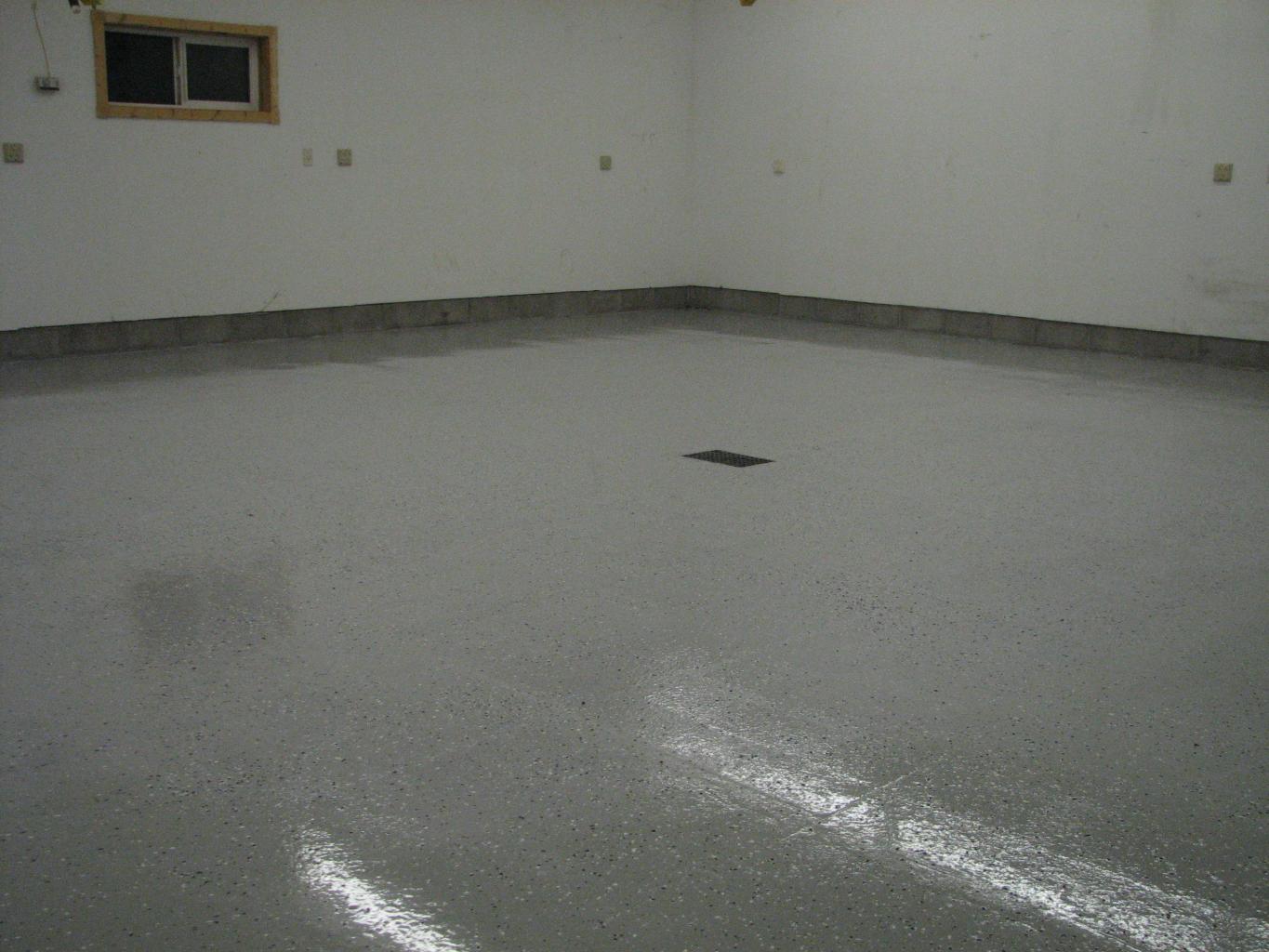

My local mechanic has the epoxy floor and has had it for years. Tons of spills and thousands of cars and hot substances on it and it is still going strong. Granted it isn't show worthy but it will take the abuse. It isn't the Home Depot type stuff, industrial in nature. Will have to ask what it is.

I convicted my grandma to get her garage done with epoxy. It was done by a professional. Life time warranty, oil,cool lent and chemical resistant, Wont peel. We have had it for a little over a year. Very easy to clean. I just take the pressure washer and hose it off. If some thing rust on the floor I can get down with simple green and scrub for a bit and it comes out.
I see your out west so you can take this with a grain of salt. During the winter the water never freezes up. It just sits on top and puddles up. So I can go out there with a squeegee once every few weeks and take care of it.
I will take a Picture of it once it warms up and is clean.
