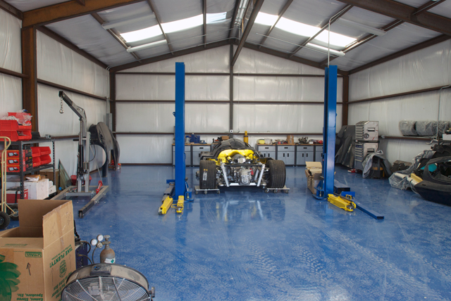

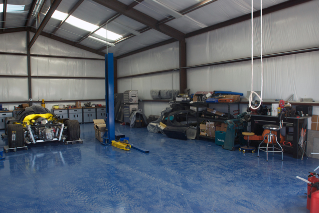

Tnemec. Lasts forever, any color you could possibly want. I've done three garages with it and wouldn't change a thing. We use the hell out of our garages too, no show cars or polishing here.

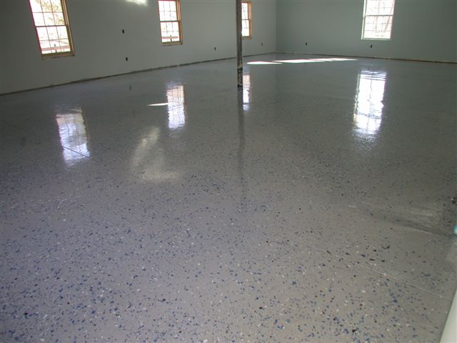

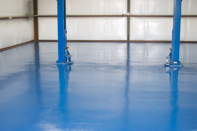

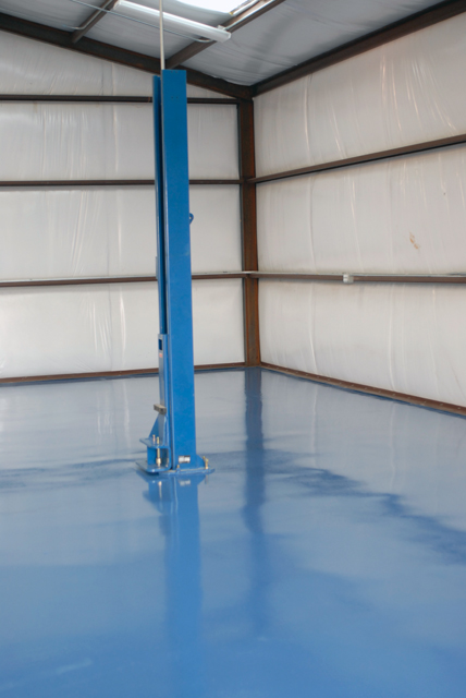

Lot's of prep-work, but if done correctly, it's hard to beat a commercial grade 100% solids two-part epoxy/urethane coating.

I'm with Doc Kaler on this one. I cleaned, acid etched and neutralized after renting a concrete grinder for a weekend. Stained with concrete paint and I'm getting bleed through all over because of moisture coming up from underneath the concrete. Decided to wait and do it again using Doc's methods.

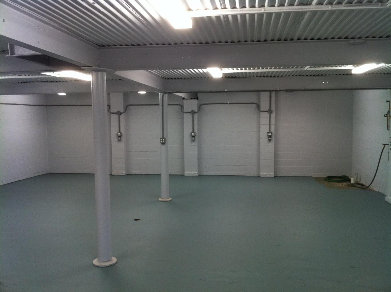

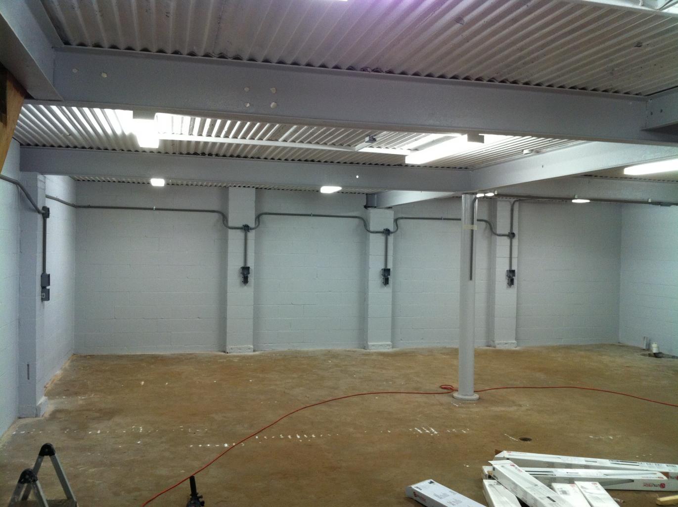

Doug - The Sherwin Williams product was acutally Drylok concrete floor paint (Drylok is owned by SW). See the attached picture of the can and also a couple of the floor. I think I paid about $30 per gallon on sale. This is probably the only paint I have ever bought where the coverage listed on the can was actually the coverage I got. They recommend you thin the first coat with 50% water and the second coat full strength. I followed this recommedation. The stuff goes on very easy, dries quickly (although they recommend 5 days curing before heavy traffic) and makes a big improvement in the overall look of the shop. Like I said previously, I couldn't see spending $1000 on this, but $100 seemed reasonable (this part of the shop is about 1,000 sq ft). The other half of the shop (the "car" side) is another 1,000 sq ft and after I get done remodeling it I will use the same stuff on it. Might not be the right solution for everyone, but I am happy with it and would make the same choice again.

Doug - The Sherwin Williams product was acutally Drylok concrete floor paint (Drylok is owned by SW). See the attached picture of the can and also a couple of the floor. I think I paid about $30 per gallon on sale.....Might not be the right solution for everyone, but I am happy with it and would make the same choice again.

Doug,
You can put the second coat on in a few hours (however, I did it the next day), the five days is their recommendation for cure time before driving and parking hot tires on it. It is dry enough to walk on the next day. Also, I am not sure that this is actually a Sherwin Williams product, the guy at the SW store said it was but when I looked at the can it shows UGL as the manufacturer (maybe SW owns or acquired them). It comes in about 6 premixed colors and they can tint it to just about any color. It does not leave a gloss finish, more of a satin or eggshell.
