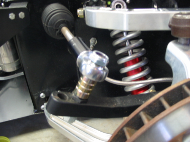

Bill: The steering arms on my car have two holes. If one uses the aft hole it tightens up the turning radius making it manageable. Is yours configured the same?

Not sure what you mean. where are the holes?

Sorry for the fuzzy picture. But note the two holes in the steering arm. Use the aft hole for a tighter turning radius.

Chuck. Good picture. My steering arm has only one hole. Did yours come that way or did you drill it out?

It came with two holes. I did not modify it. You may want to give Fran a call. I am guessing it would be an easy swap. (A lot easier than drilling another tapered hole!)
