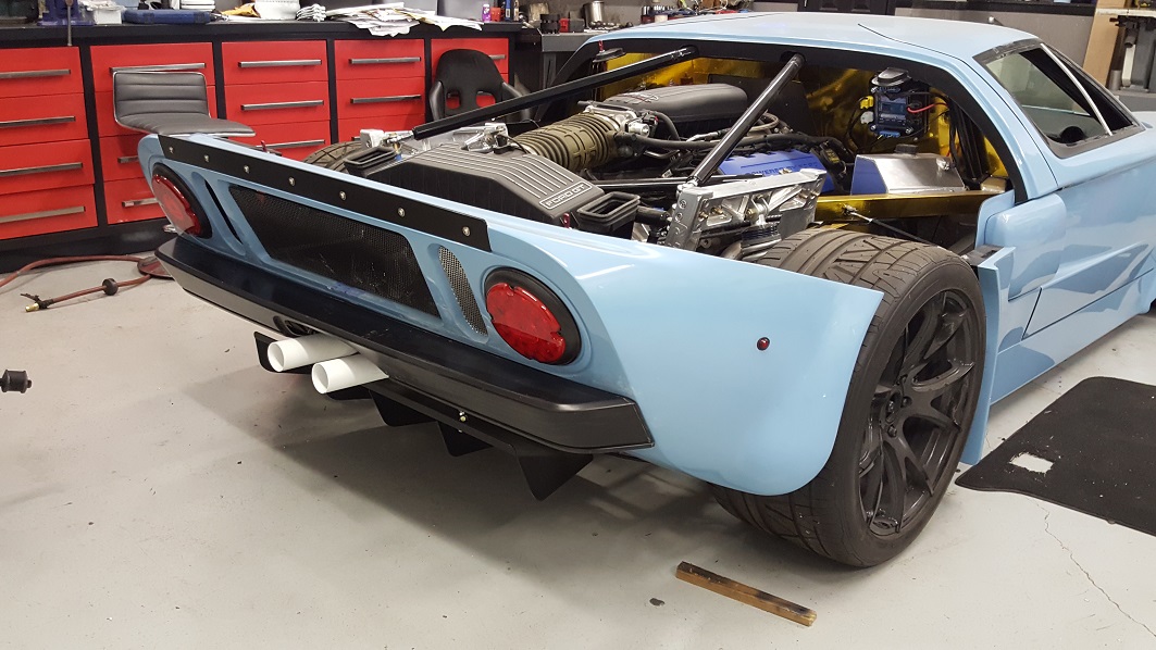

Turned up some standoffs for the tail gas struts today. The strut runs between the side of the upper wheel arch and the bumper frame.
whilst a pair of 60lbs struts hold the tail up right now I think that Ill have to go for a stronger pair once I've finished adding paint, trim and the rear window.
I,m still working on fitting the wheel arch sections that go in front and behind the rear wheels, making brackets to hold them in place and generally going around the body adding brackets and fasteners to hold it all in place.

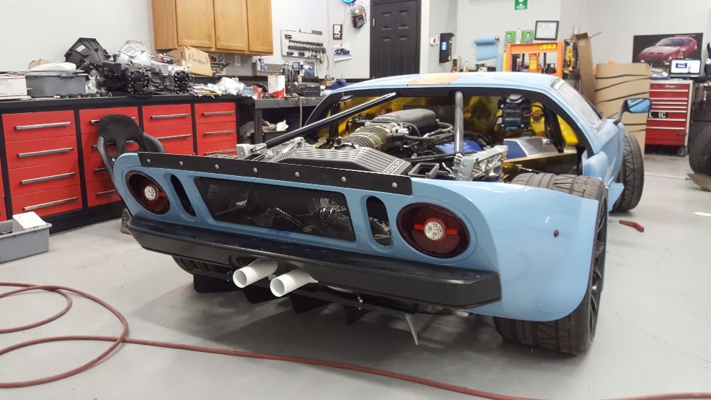

Mine is down to fiddly bits and pieces now, I'm trying to Finnish up the cold air delivery to the air filters, the air will enter from the ducts on the top of the engine cover into the rear arches then out the side of the arches into the air filter buckets.
Air enters here.
Then into the wheel arch which is bonded to the engine cover.
Then I'm creating these fences that will funnel the cool air into the air filter buckets, they will seal onto the air filter buckets with a rubber bubble seal as the engine cover closes.
I had the priviledge of seeing H's GT-R in person last week and I must say that the build log does not do it justice. H has seemlesly integrated many of the factory GT parts (unobtanium for most of us) to the RCR platform. There are too many fine details to fit in this build log. He even machined spacers in the chassis to eliminate the washers that the kit comes with to position the control arms. So many little but time consuming details are going into his car.
