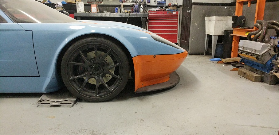

Stance, its all about the stance. This is with the splitter modification where the splitter is mounted on top of the floor in order to get the wheels fairly well tucked into the wheel arches.
Floor to underside of rocker in front of the rear wheel 4"
Floor to underside of rocker behind the front wheel 3 1/4"
Floor to underside of splitter 3" all over
Its the first time the car has been on the floor since I've had it, totally pleased with the results.

Just for comparison, here's what it looks like at the same ride height without the splitter modification.

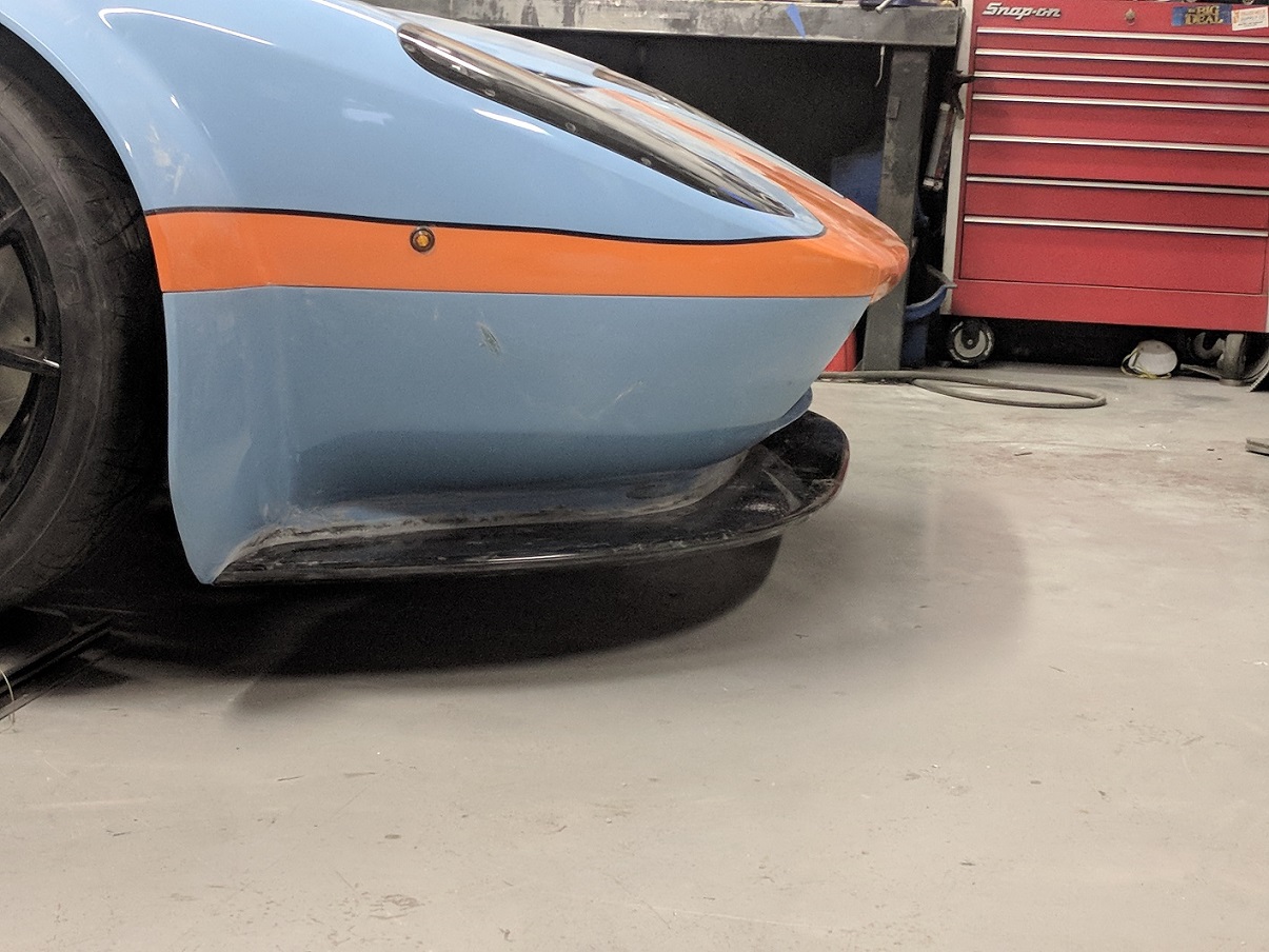

Ron McCall
And after. ( a RIDICULOUS amount of work at this stage of the build!!) Note: the car is sitting on 1.5" tall turn plates in this pic.
Ron
I am putting the car on the ground for the first firing of the motor and a go kart ride, and I have come to the same conclusion. Either I have the front tires too far out of the wheel well, I can have the splitter too close to the street surface, or I modify the splitter position relative to the front body work. I know it must be a lot of work, but there is no way I can look at the car and have the "Stance" off.
Mark, if you need any info on what to do to make it happen then don't hesitate to ask. Its not a bad job to do just a little time consuming especially if you already have the radiator in and plumed. but a lot easier now than on a finished and painted car.
