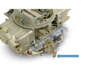

That being said, I have successfully used the hole on the other side of the primary axis to reverse the action on the plates. This is on the bottom of the staked linkage plate, but you'll need to ensure clearance because it lies below the bottom of the base.

My QF did not have that arm on the bottom so I am modifying the arm to have the same.

You don't turn the carb around, you just actuate it from below instead of above.
In standard front engine applications, the throttle cable or rod is attached to the linkage on the side of the carb on the left side, some distance above the centerline of the throttle shaft. The cable/rod pulls to the rear to actuate the carb.
In mid-engine applications, such as the Pantera, and GT40, the cable or rod is attached to the linkage an equal distance below the centerline, and pulls to the front.

Linkage can be funny when connecting to the bottom of the carb's bellcrank. Getting the correct angle and correct throw (due to shorter lever length) can be a challenge..

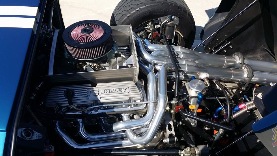

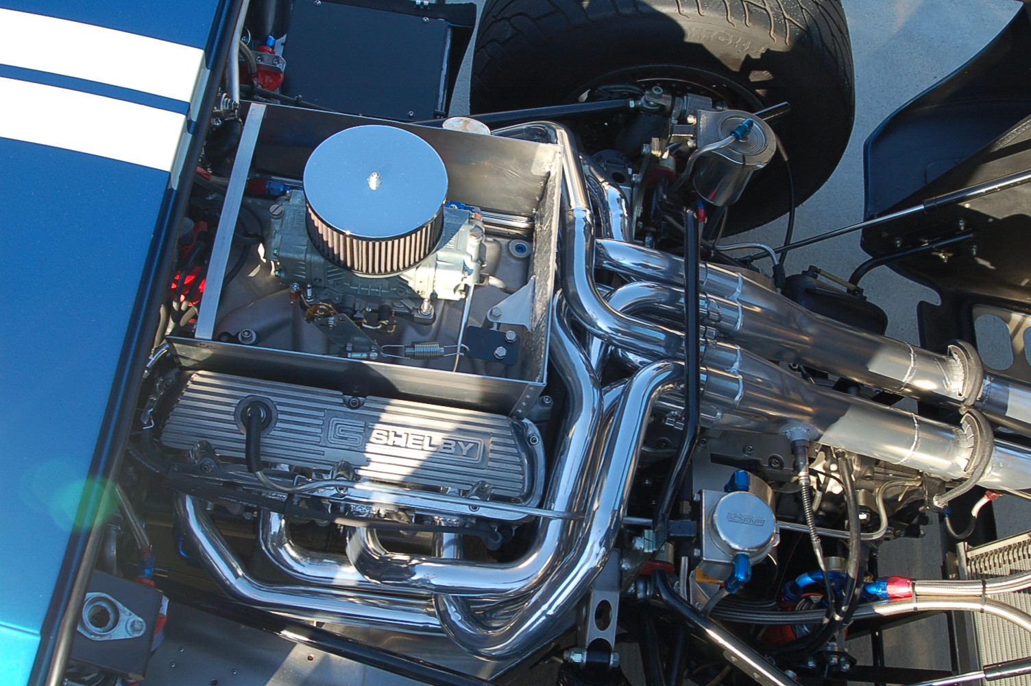

I hadn't realized that the angle/level of the Holley could affect running as Jac Mac pointed out....and reversing might affect things (maybe not at Randy has noted). I've got enough variables going on in this build already the last thing I need is a potentially poorly running Holley because it's not sitting at its usual angle. On the linkage I do have the arm extending down below the plane of the pivot axis (as in the pic posted by Terry)....so maybe I'll use that to get the throttle opening in the right direction. Arm is a little short so might have to extend it to get proper throttle modulation otherwise it might be somewhat like a light switch. My 10 year old son gets a kick when I "get on it" with the throttle but it's a drag to drive like that all the time.....

I have a 750 double pumper on my 408 right now mounted as normal and have plate attached to the throttle linkage on the holley which is longer and angled to give it the right geometry to pull forward from the bottom of the linkage.
