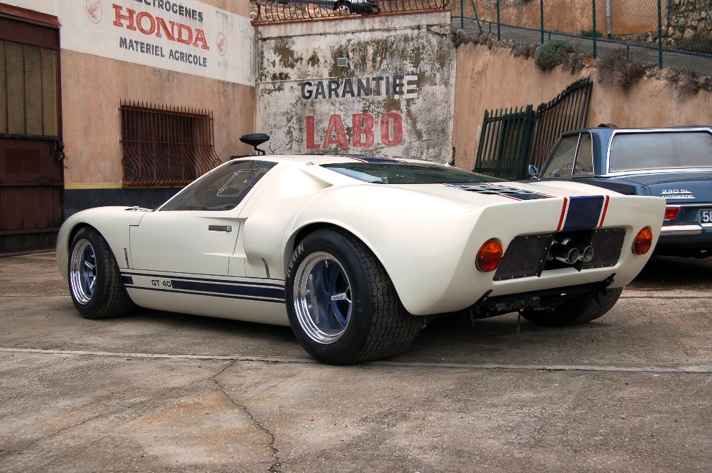

Superformance chassis GT40 P 2280 was conceived as a FIA qualifying car from the start. The base idea was to copy a 1968 chassis and complete car to the full specifications set out in the original homologation including the extensions (and using chassis 1075 as an example) to obtain FIA Historic Passport papers for European and International racing. It was not an easy process and took nearly 2 years to complete.
For a 1968 version, we have been able to include a 302 engine, ventilated discs, 14 inch rims on the rear with appropriate bodywork modifications. The car is specifically built for hill climbing with very short ratios on the ZF box.
The result has been a qualifying car (FIA 34354) that also can be used for road use (yes -registered in France for everyday use) and rallies. It FIA Class is TSRC 18.
The new French owner has been the Historic Hill Climb Champion more than once in the past years – a Porsche man – and wanted to move up to 5 liters as a swan song to a long and happily successful career.

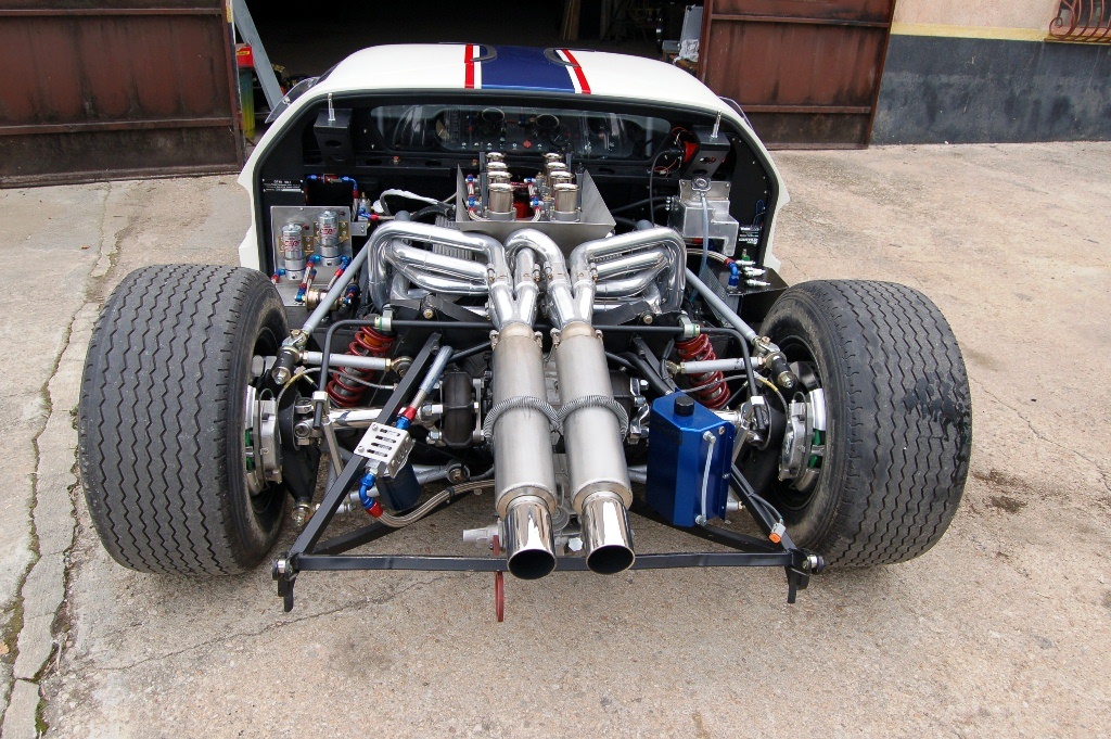

What is the blue tank on the back? Also, looks like dual rear clamshell hold downs as opposed to the usual SPF single. Was that a modification or did it come that way from the factory?
Kevin
Looks like an oil overflow tank to me. Doesn't look big enough for a dry sump and I only see 1 line to it. Obviously a lot of custom mods here. Not many replicas with u joints and donuts! Nicely done.

I too, am interested in the dual clamshell holddowns. Specificially where the bracketry was sourced, if not through SPF.

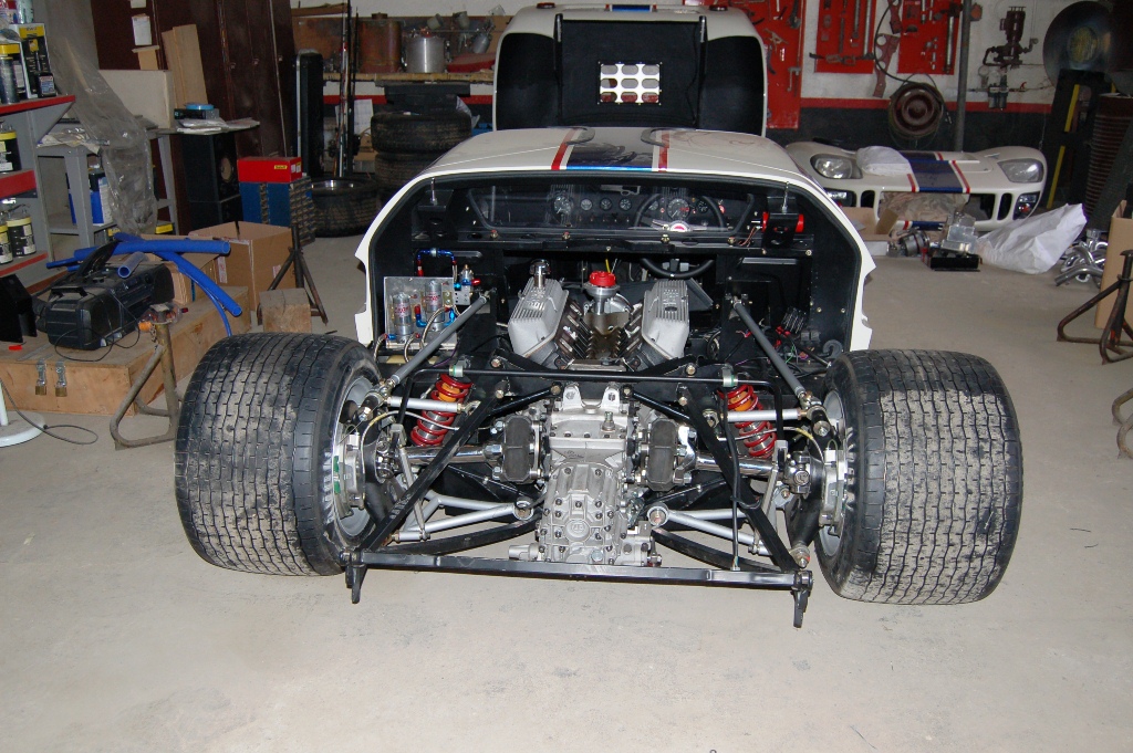

Kevin – we supplied the car with two sets of wheels – the original SPF 8 x 15 and 10 x 15 for road use and an alloy set 10 x 15 and 14 x 15 for racing!. Attached photo of the “big boots” on the rear – note Avon race treads per FIA regulations.
The Clamshell hold down fittings are original SPF.
The small blue tank is an oil catch tank required by the FIA regulations – basically it is plumbed to the rocker covers to collect engine oil vapour.

The rear roll bar also had to be changed - see photo

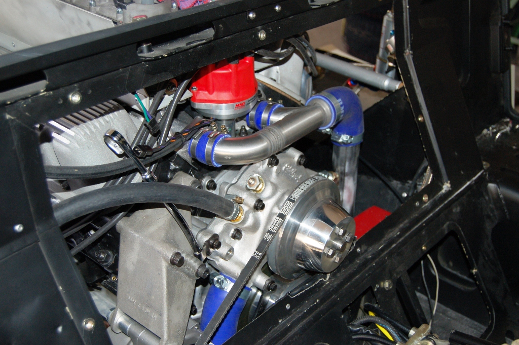

Jim - yes Weber setup but no thermostat in the water system - just blank off the radiator as necessary.
