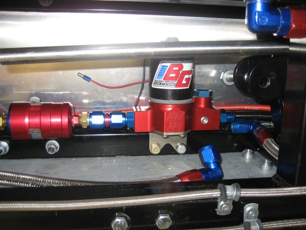

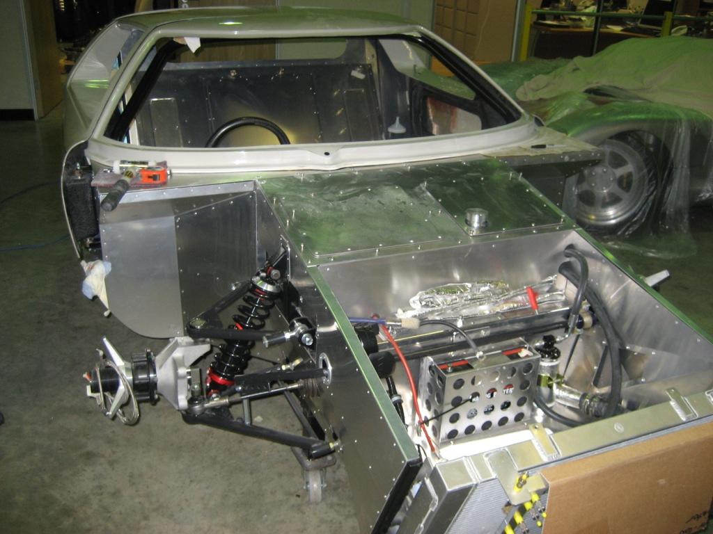

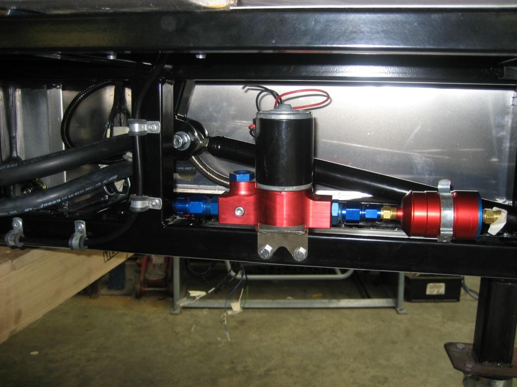

Decided to install the low pressure fuel pumps one in each side of the engine bay sills, Due to the high output of the engine and that it's being built with a view that it can be upgraded later, I decided to fit the same pumps as I have in my Ultima. These are Barry Grant 220's with a flow rate of 220 Gallons per hour ( will drain the Hoover dam in a few hours ).
These are mounted as low as possible and level with the -8 outlet in the fuel tanks. Before the Pumps are high flow filters.
Both pumps feed a swirl pot in the engine bay.
Pictures are before all the -8 lines were finished

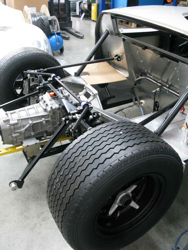

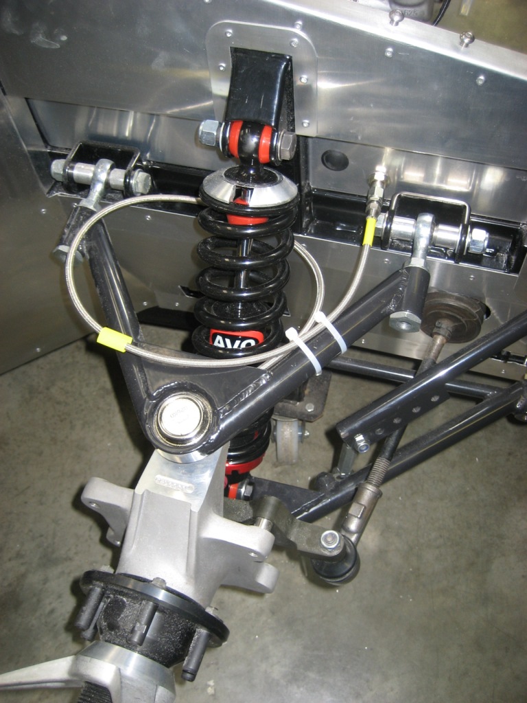

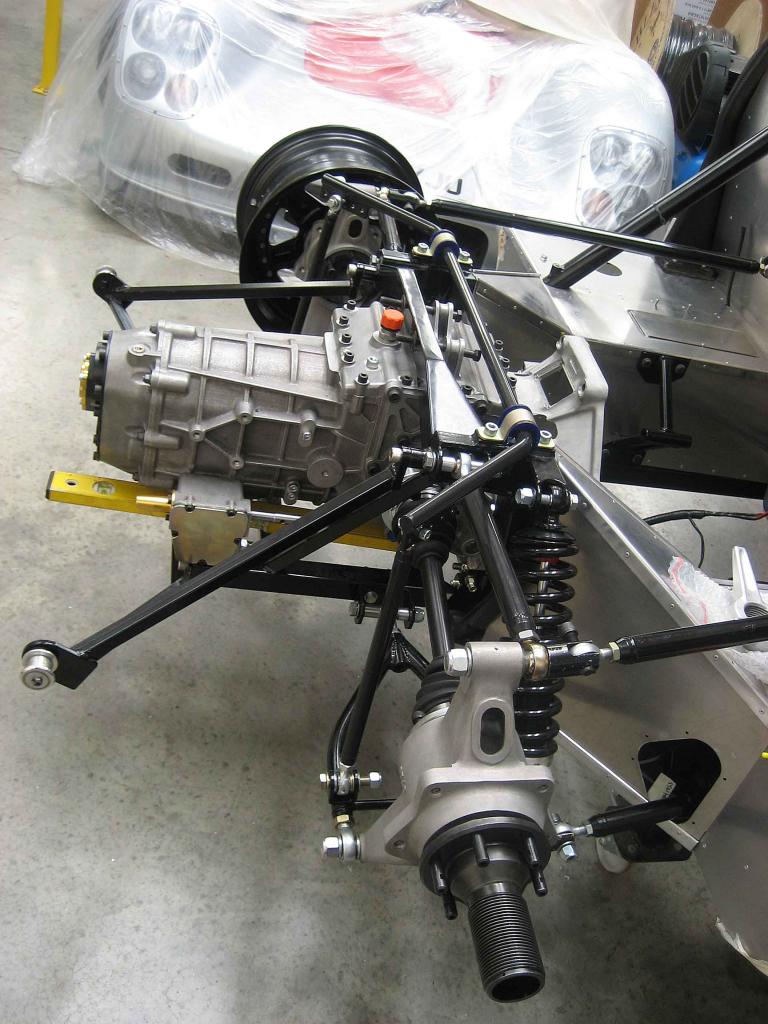

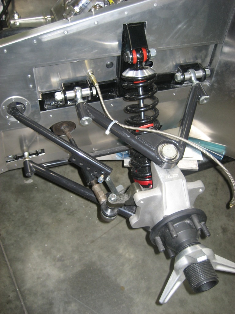

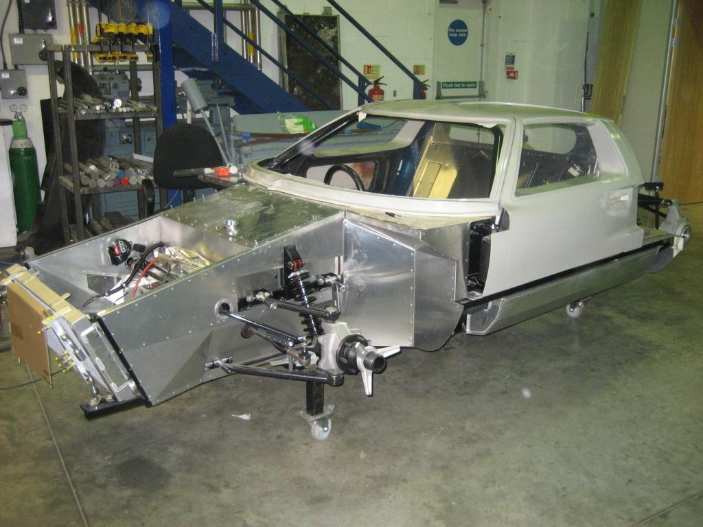

The front suspension is now all in. Have been informed that my AP brakes should be with me this week, wheels are in transit to me as I write.

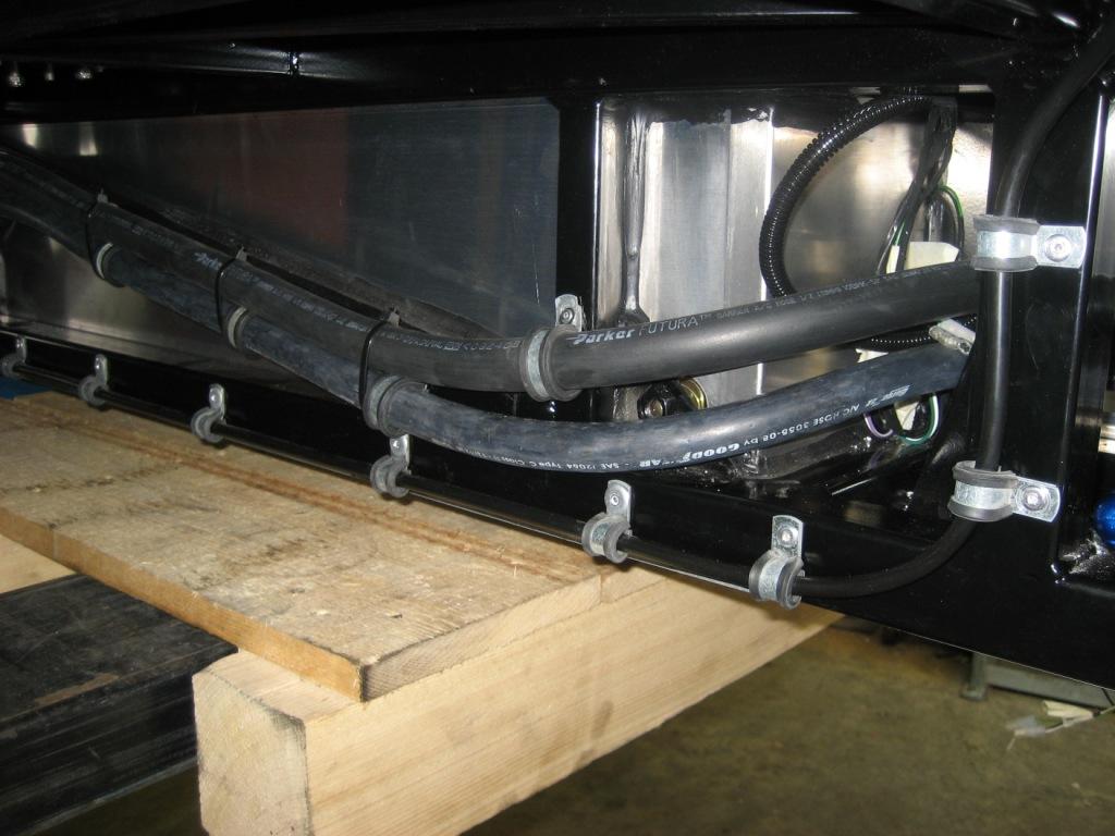

Air con pipes should be crimped up next week with only the two at the air con pump to do later when it's gased up.
Fire extinguisher lines are going in down the passenger side chassis.
Decided to go for Southern GT's reccomended Shocks for now as the Koni's are 12 weeks minimum delivery ( do they want to sells these things, were supposed to be in a recession ? ).

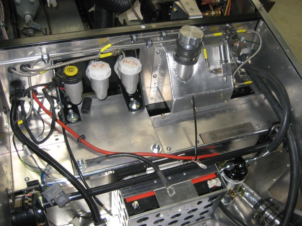

Decided that washer bottles although hardly ever seen were cheap plastic items made in china and only to be fitted in beach buggies or wheel barrows, therefore I made a pattern to fit within the designated area that would hold at least 1 ltr to satisfy the IVA tester and mounted the washer pump on the side.
This holds 1.9 ltrs.
The filler cap passes through the ally panelling and the rubber tube fills any gap and stops movement of the panel.
When polished it should look OK.

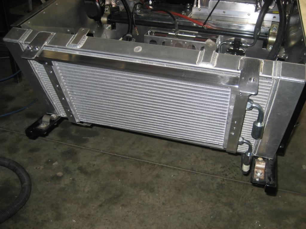

The air con radiator is mounted in front of the rad by ally bracketry and wont move anywhere, the radiator is mounted on four rubber buffers 1" thick and hopefully will not act as a structural item and should not damage the rad ???
All un polished at the moment.

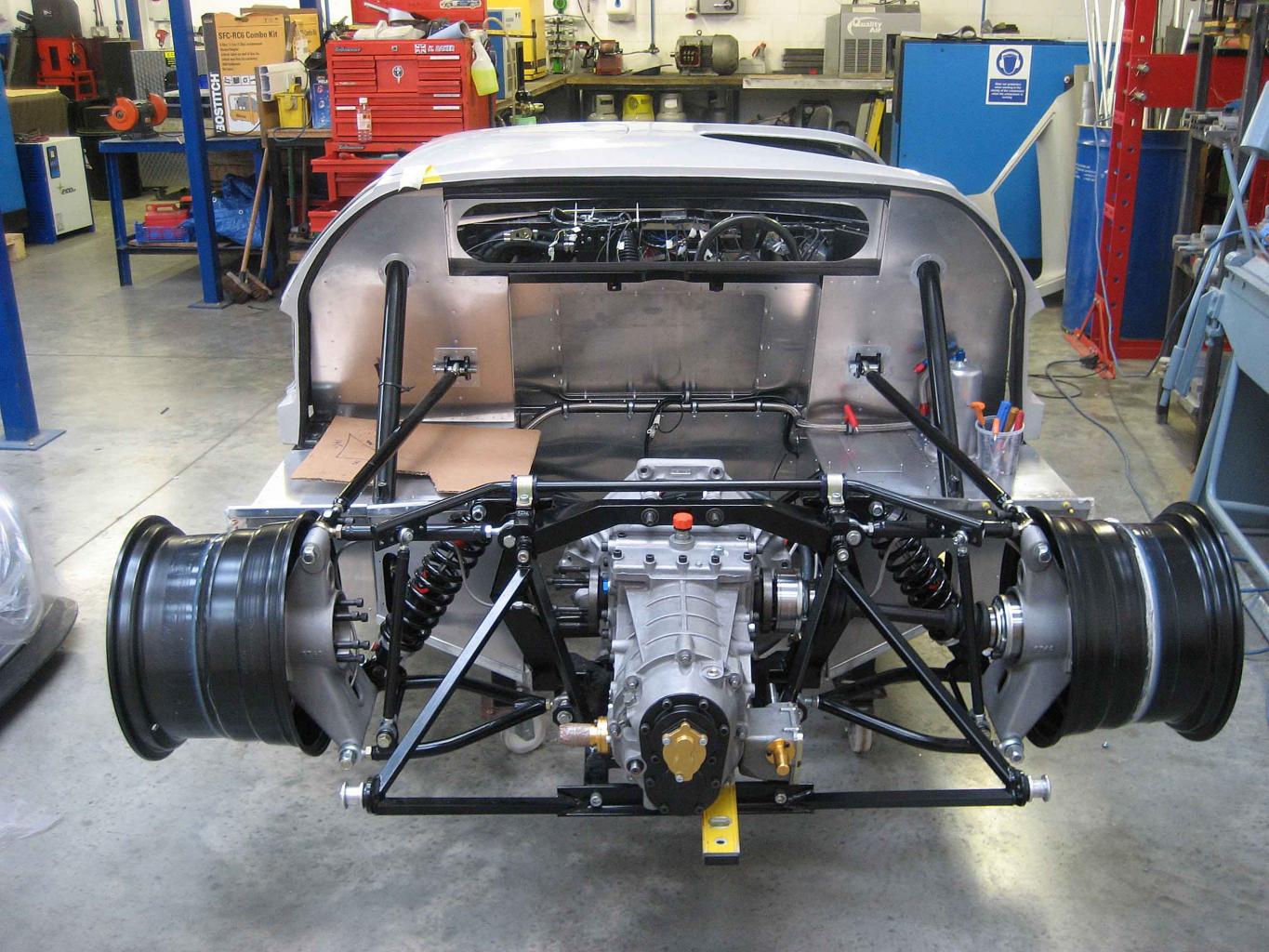

Trial fitted the doors, brackets were from Southern GT and these are almost the same as the old GTD ones except they have bearing in and knowing how difficult it is to align the doors I welded bolts onto the rear brackets of the hinges, this means you dont scratch your hands to bits whilst adjusting.
I cut the slot out of the top bracket so that the door can easliy be removed and put back virtually in the same place.
Fitting the body can take time and although Ive fitted a few now I know it's going to take time. " Patients is a virtue "

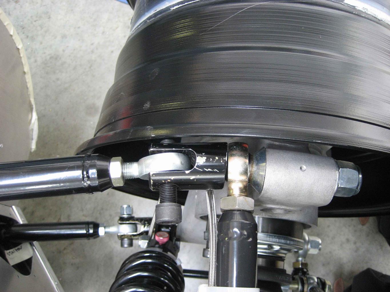

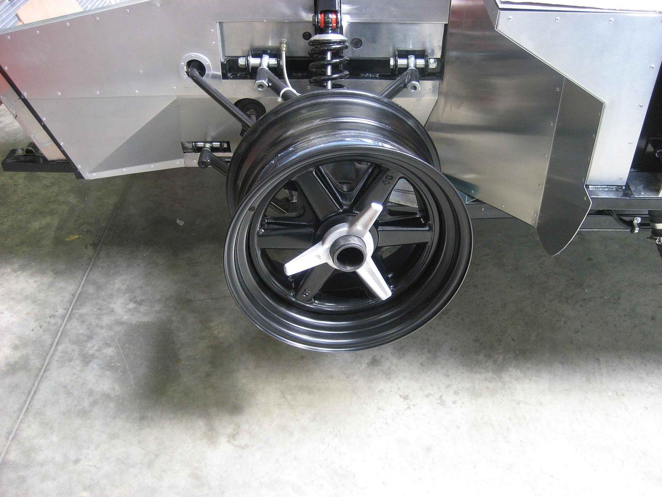

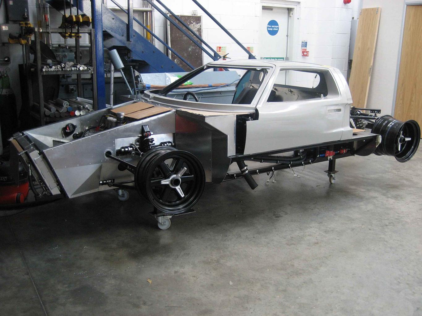

Wheels arrived, look good but the powder coating was thick enough to stop the wheels sitting back correctly so started to rub back the centre, got them almost there and got worn out and fed up rubbing with scotch brite,, from the pictures below the clearances are tight, very tight.

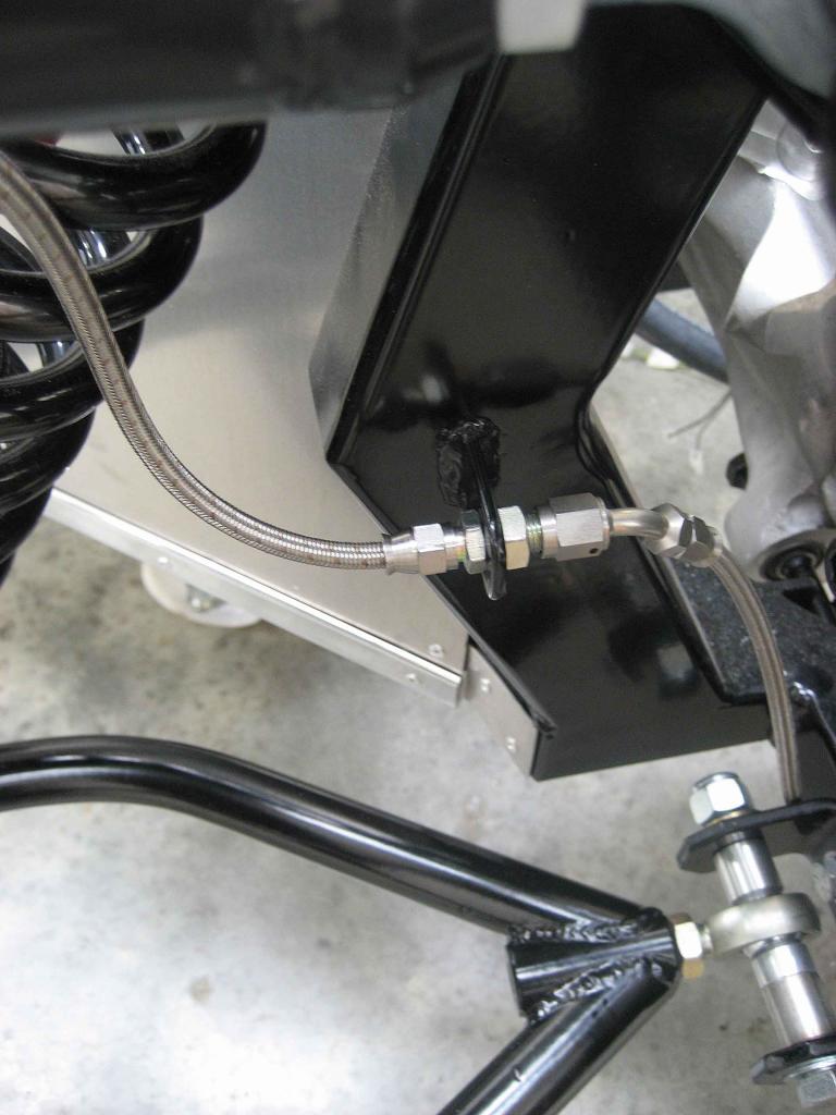

The rear Brake lines are virtually finished, one fitting short.
All the brake and clutch lines are in Goodridge stainless steel with internal sleeves , this is acceptable for IVA tests.
Starting to look like a car now.

Hi Trev,
Yes these are Image wheels there 6 spoke BRM's in matt black actually a satin / matt, you can get from SGT or image, polished, coated or a mix of both, I was told about 8-10 weeks but actually got them in about 4 through SGT.
As Mick says the clearances will be better when the brakes are on.
One of the wheels on the inside did have a reduced amount of powder coat on in one point but it will never be seen unless you look hard. Also there was some rough coated bits on the centre hole, these I have smoothed out. I'm fussy and always look at everything as the Devils in the detail.
Nevertheless I'm more than happy with them.
Thanks Mick for the reminder of the brake disk bells, sometimes you forget the blooming obvious, you cant see the wood for the trees.... you know where I,m coming from !
Speak to you soon
Hi Keith
hopefully you have not powdercoated any of the mounting surfaces of the wheels. Nor the back surface where they sit in the brake hub, nor the center where they slide over the cylindric part of the knock off and not the part where the knock spinners taper sits on.
This section must be not painted or coated, otherwise the wheels don´t sit right and will be dangerous to loosen themself, due to the coating sets itself.
TOM
Hi Tom, The wheels were powder coated at the factory but I think they should be OK. When I get the brake hubs I will know whether any coating needs removal.

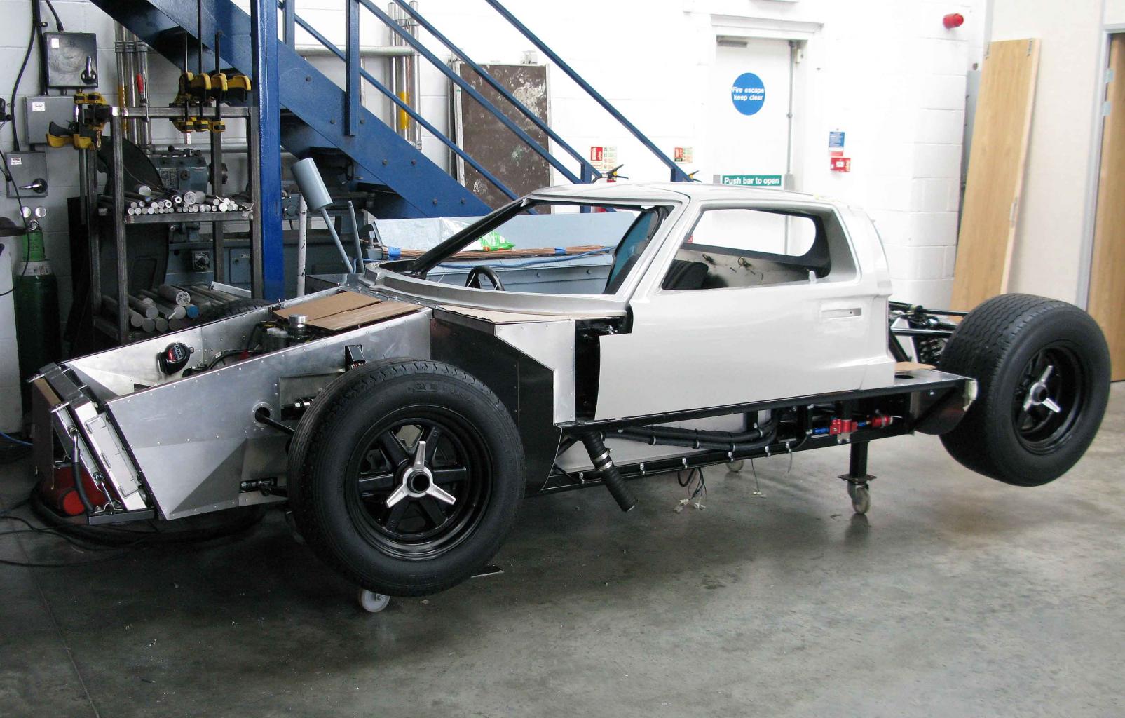

Got the tyres fitted today, going to Italy in a couple of days on Holiday , then it.s full speed ahead again, plan is to have the car IVA tested October "ISH" and in for painting over the winter.
