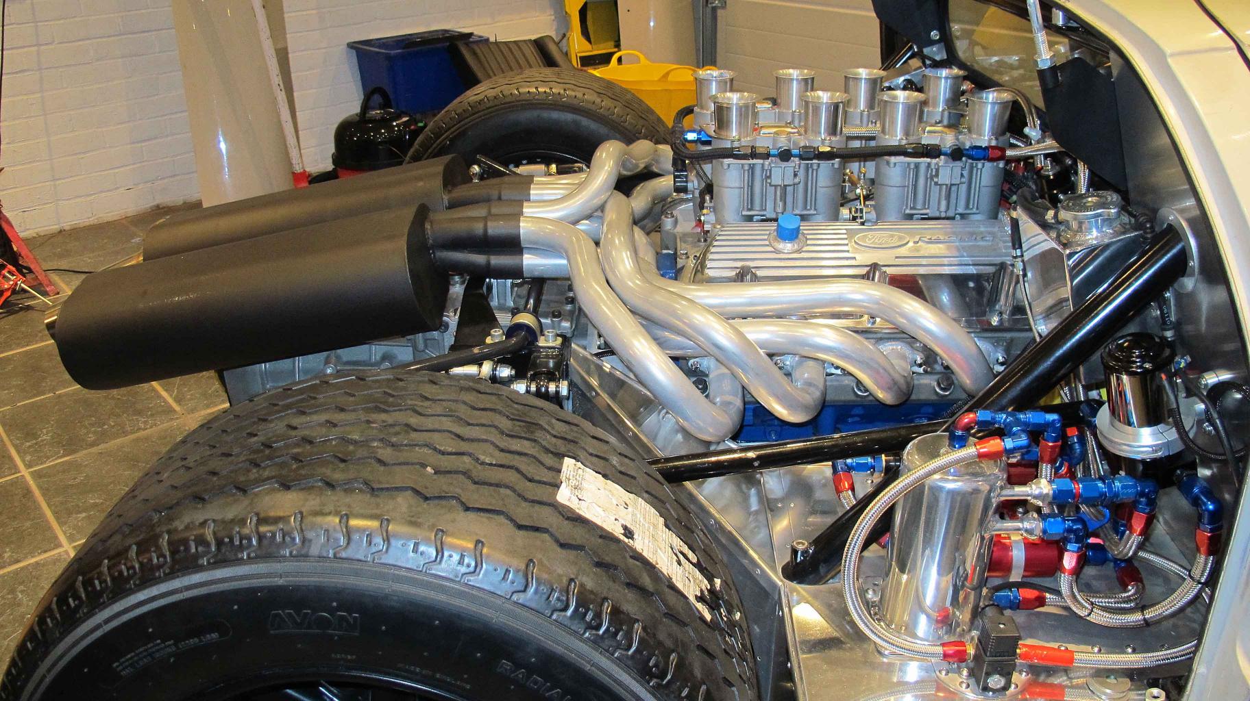

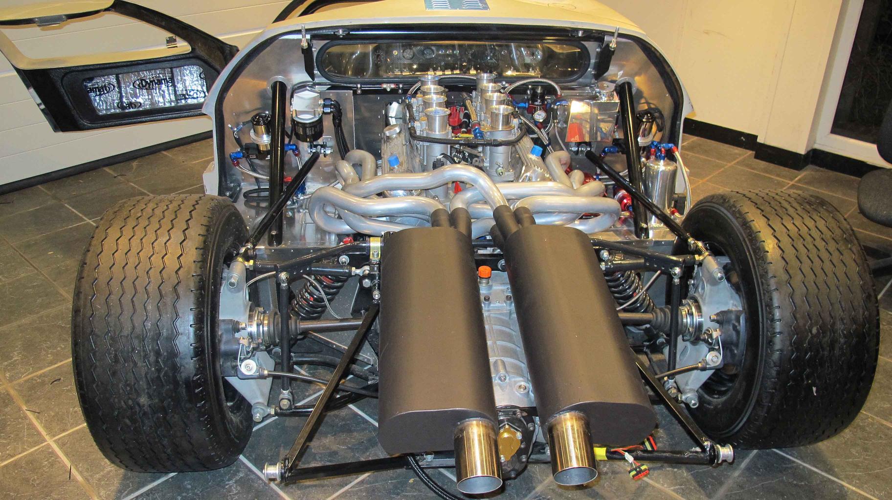

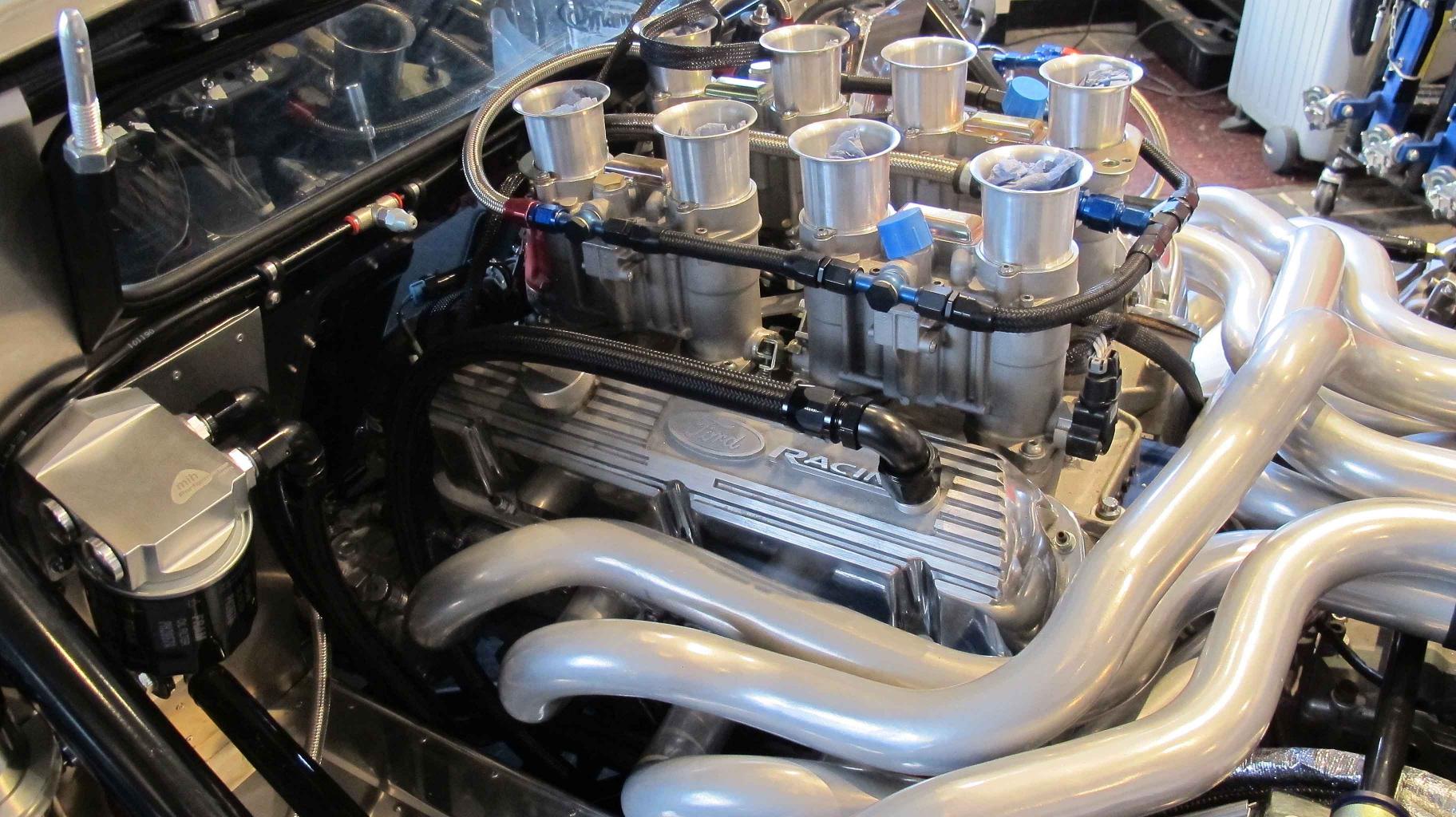

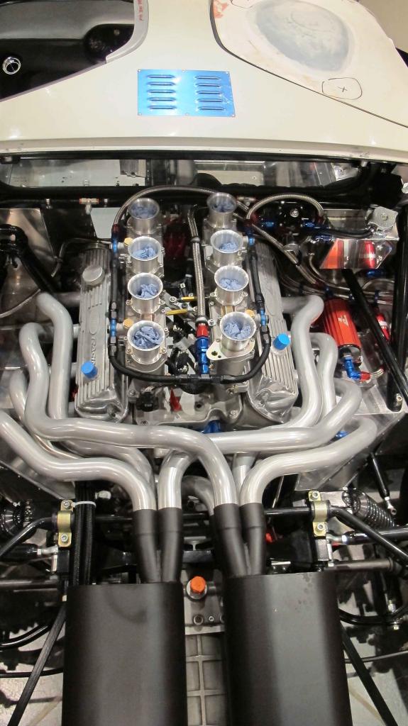

The exhaust arrived today so I decided to do a trial fit and it all went together a treat.
This will allow me to sought out the plug leads and all the other oil lines, coolers etc that you can't take a chance fitting without the exhaust in situ.
First impressions is a nice job done by SGT...Thanks Mick.
Also nearly finished the breather lines for the tanks. I decided to use the method that SGT uses as they say it works.. Thats good enough for me then.
I must say the fuel system is a plumbers nightmare and I'm glad it's almost buttoned up.

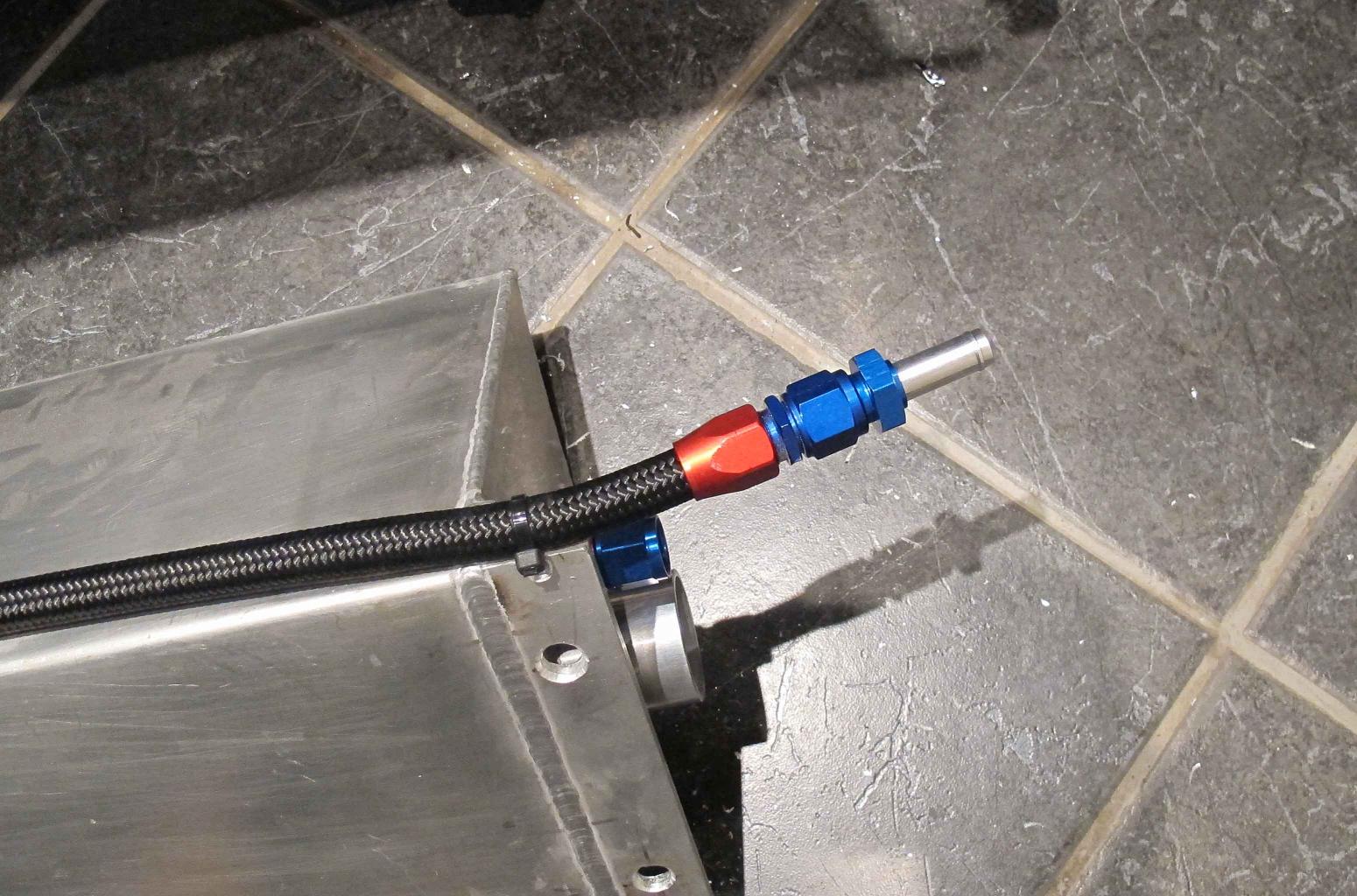

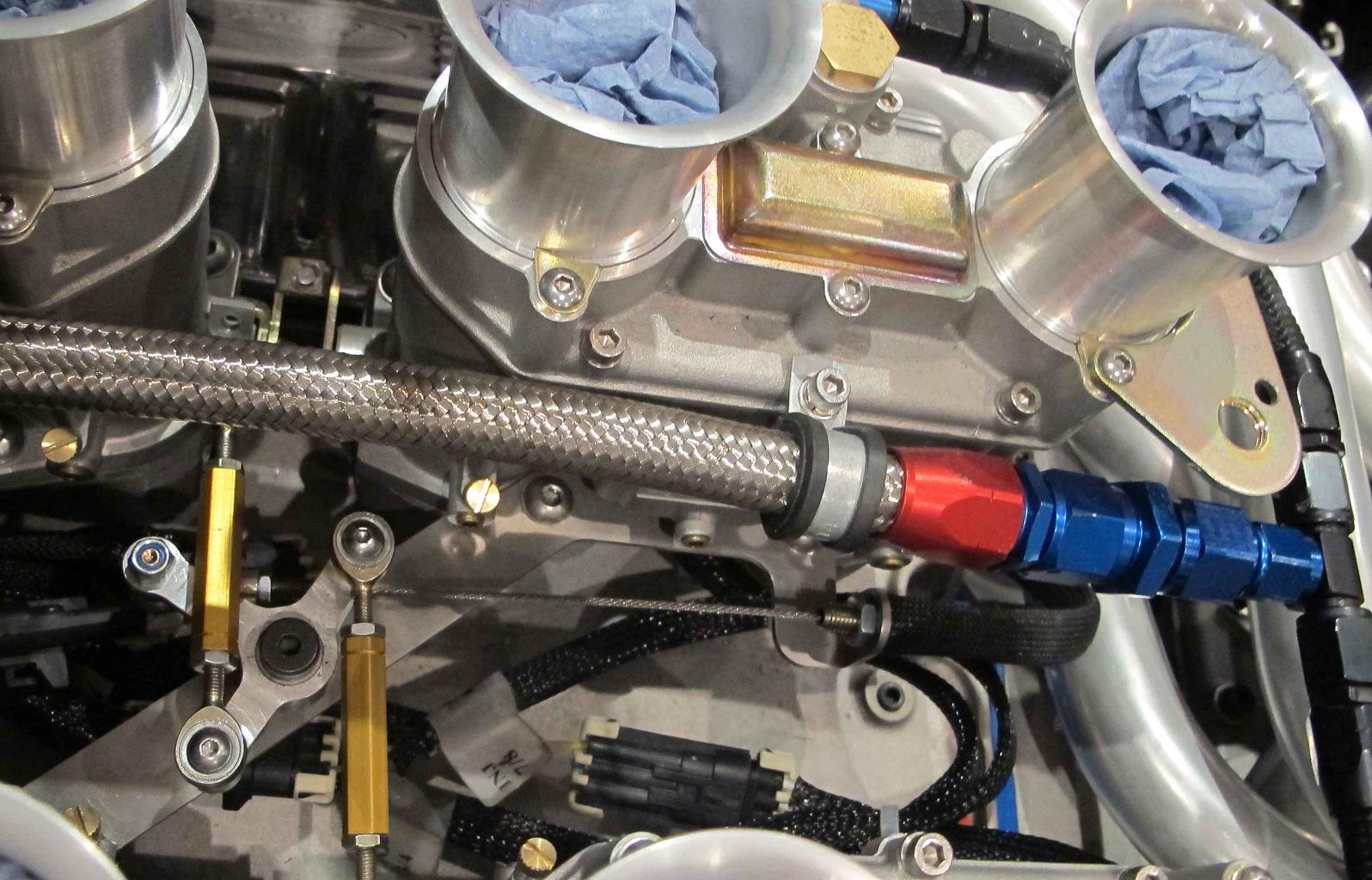

The breather lines are -8 front and rear of the tank, some say there should also be a breather outlet in the middle but I think you have to go with what the people in the know say , so two it is.
Two fuel hoses at the front of the tank then rise to the filler neck and hopefully breath through the fuel cap.
rather than have a multitude of adaptors I machined a -8 fittings to fit the rubber hoses.
Fuel solenoids are now in, with return lines to the tank.
Nightmare !!

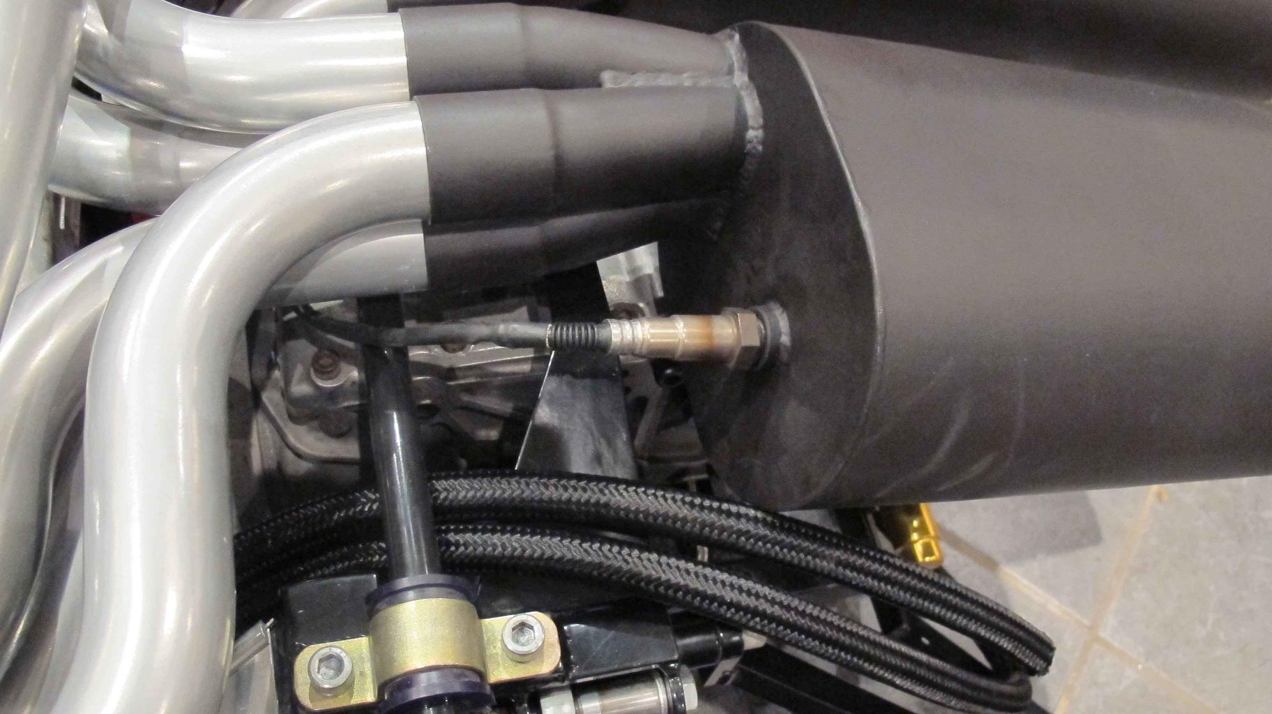

Would have liked the Lambda sensor on the other silencer box as the lead only just reaches but perhaps there's a reason. Nevertherless it fits.

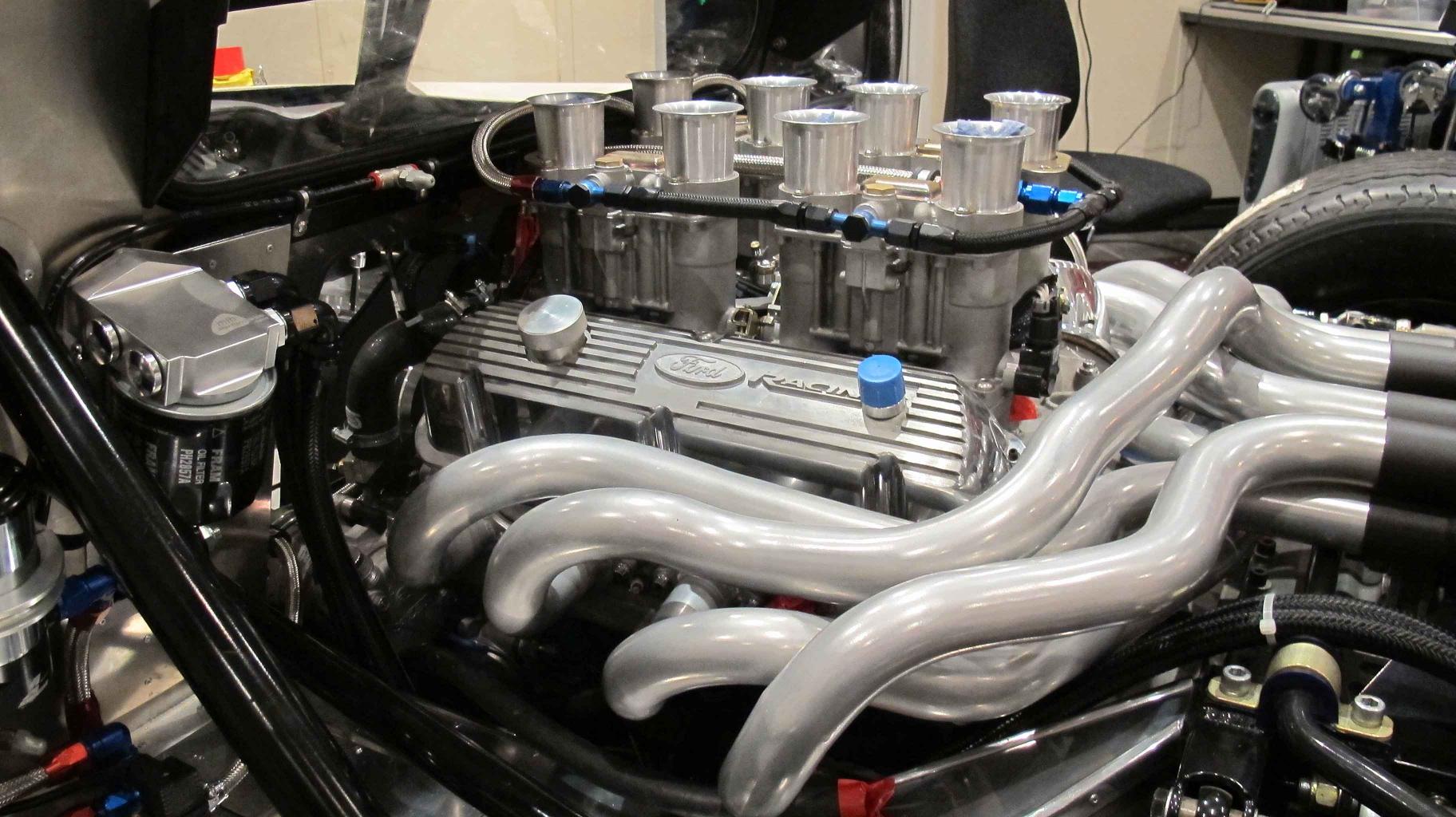

Fire system is plumbed in, a nice big bottle going between the passengers legs after IVA.
In the engine bay there are 4 nozzles.
One around each fuel pump, solenoids, hp pump and swirl pot.
Another smack over intakes and the last around the lower part of the intakes.
All engine bay areas should be covered. Hopefully never need to fire it.
System is electric.
The space around the engine is tight but there seems to be good clearance around the air con pump and the ac hoses should clear all ok.

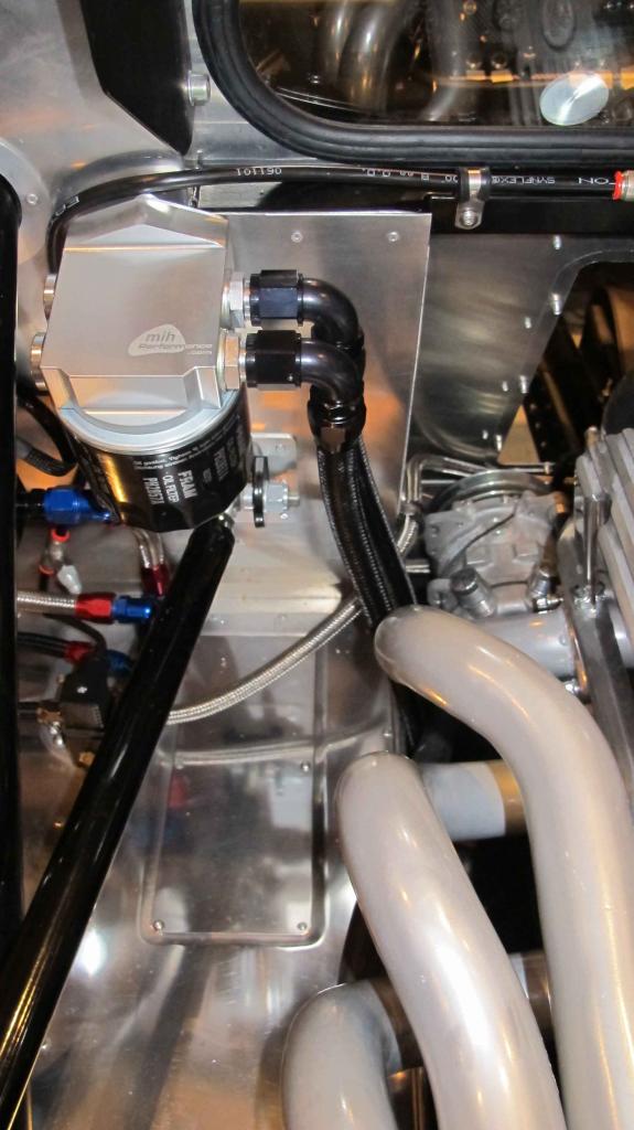

The oil filter -10 lines clear the exhausts.

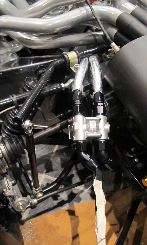

Ha, I'm normally up this late. Just been shopping for bits for mine online and then off to the garage to work on it.
I was thinking at first that two breathers seemed overkill, especially at ~10mm each, then I thought about it some more and it makes sense if the car is at an angle with full tanks.
What remote oil filter is that btw?
Looks really nice and I need one for my engine.

I see you also opted for the black race silencers. I did the same and I'm really pleased with the look. Yours looks great. I had a heat shield to go on but i'm not going to bother now as it doesn't look as good and the exhaust is far enough away from the body not to need it.
Amazing progress. It's taken me years to get to where you are now.
Martin

David. The remote is MIH Performance, Frank Catt said as it's billet it's a better flow rate than say Mocal and better looking, not sure where I got it but I'll look up my paperwork and let you know. It wasn't cheap and if fitting it to the bulkhead as mine you will need to make a bracket like mine, easy enough though.
Martin. I was going to fit stainless heat shields over the exhaust as I think although the black looks good it may look age tatty in time.

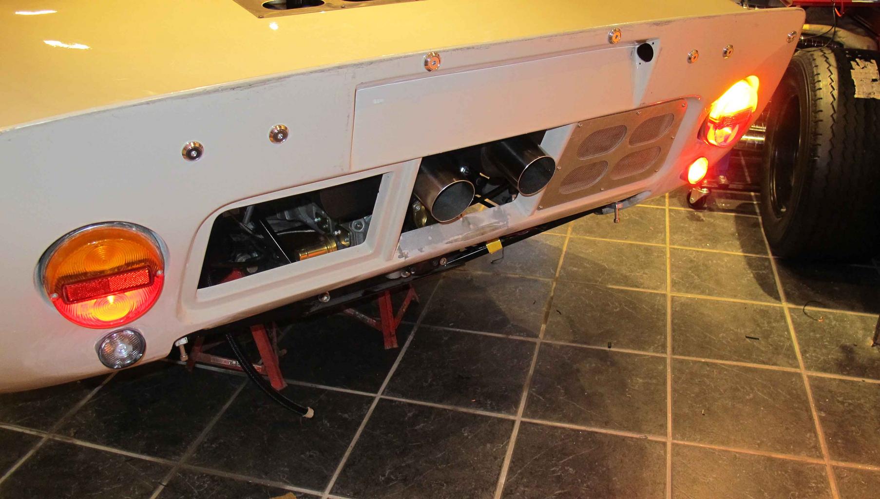

After a brief battle with an earth wire the lights are now working , on the back at least.
IVA OK Fog lamp and indicators work with dash lamps responding, not all at the same time of course

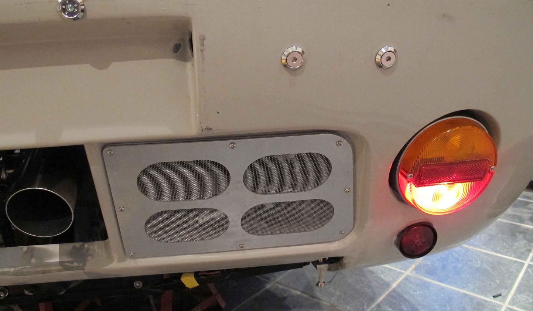

Rear grill fitted without any cutting just needs finishing at the paint stage.
I don't like the waterproof connectors joining the rear loom to the main loom and may change them at a later date.
The rear number plate lights I have wont pass IVA so Mick at SGT has his own number plate and IVA lamp set up, but there's power to them OK.

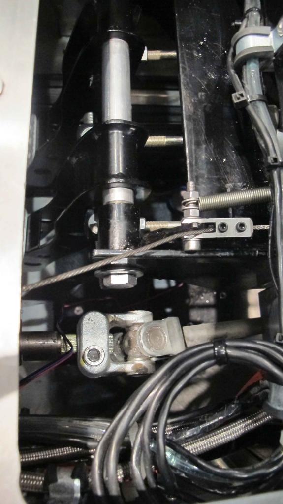

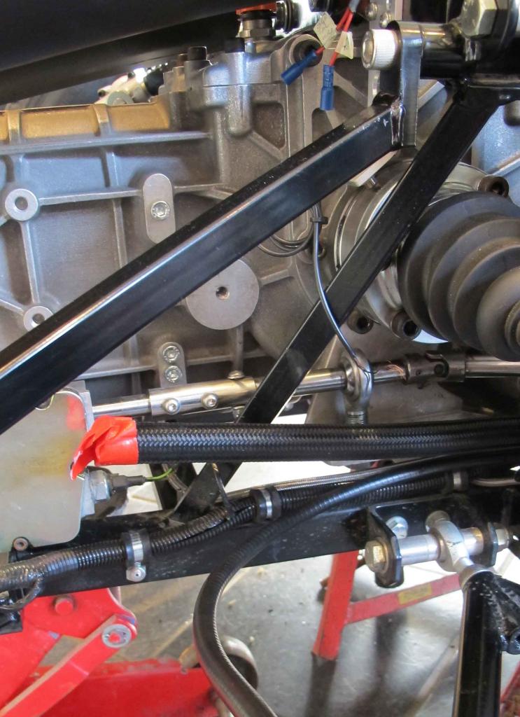

Installed the throttle cable. Sounds an easy job but took much longer than expected.
I had a quality cable made up by Frank Catt with flex joint one end and solderless on the other, this allowed me to route it and cut to suit.
Although I have still to finish the spring return at the pedal end it operates sweet as a nut.
Heat shield with 1200 deg protection slipped over the cable, It's a really neat looking cover.

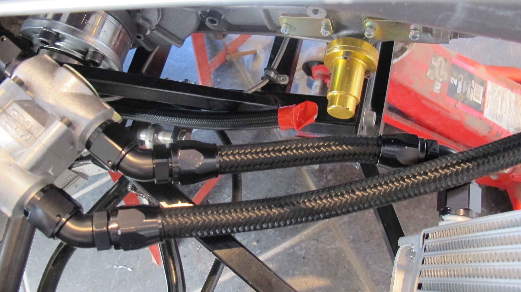

I mounted the Mocal oil cooler thermostat and now making a bracket for the rear engine oil cooler, the gearbox cooler will mount on the opposite side of the engine in the same position so I'll make a mirror image bracket at the same time, even though I probably wont fit the gearbox cooler till after IVA.

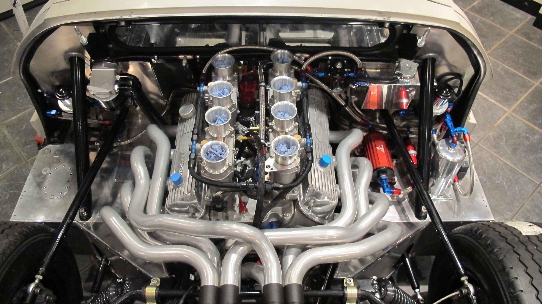

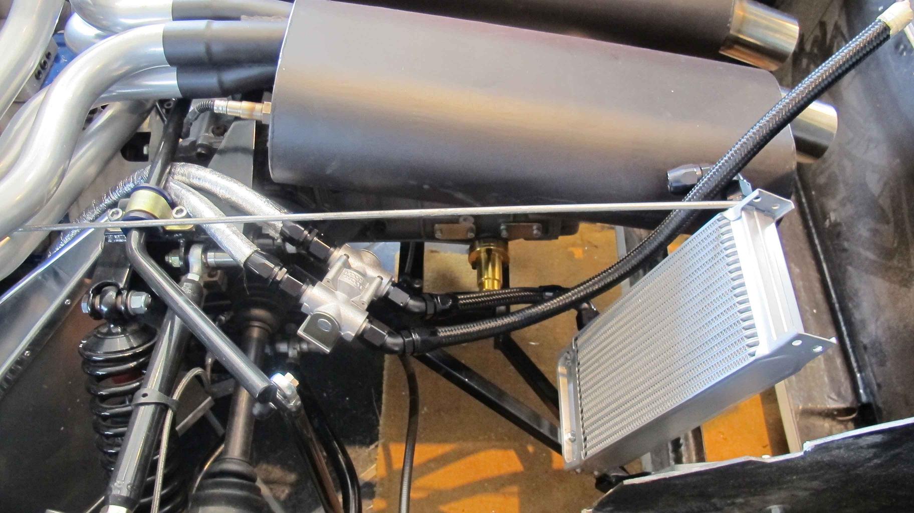

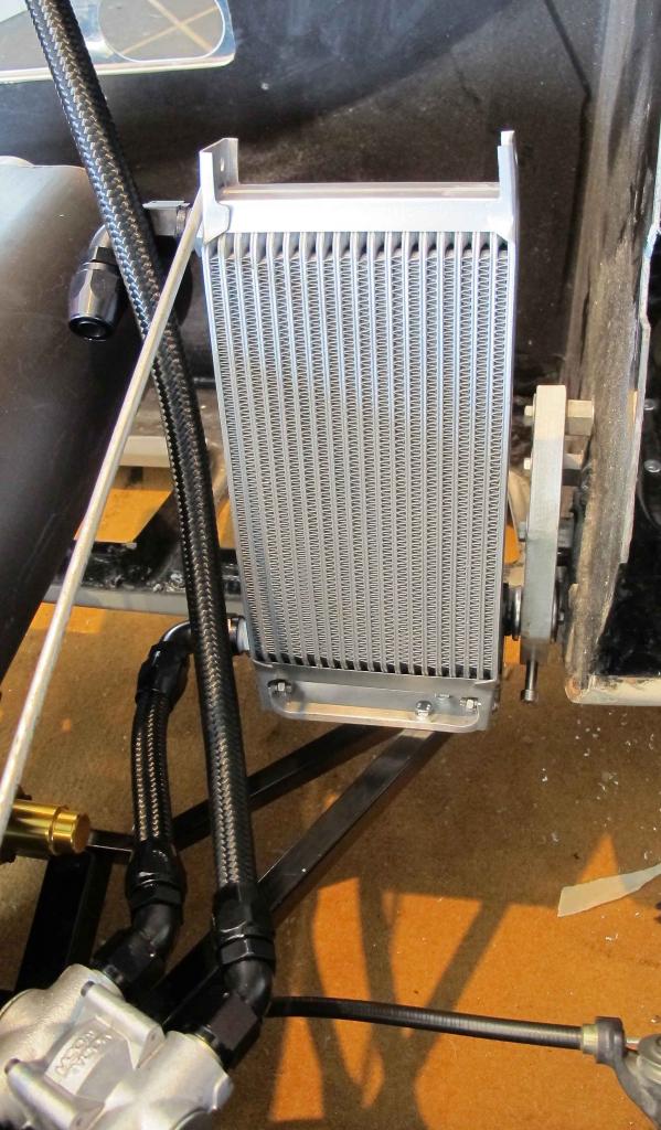

Anyway fitted the engine oil cooler just got to get an angled -10 fitting to miss the exhaust box and will make a support rod for the cooler in stainless steel.
The same will have to be made later for the gearbox cooler.
Not sure where the pick up points are for the box cooler hoses but I think there in -8.
I find out from someone for sure !
Decided to run the rocker cover breather pipes forward and below the exhausts, there's a small space at the back of the gearbox on both sides for the collector boxes which I wll make in ally. . I think routing the hose this way will look better rather than trying to squeeze it aroung the exhaust pipes.
Filled the system with water / anti freeze coolant.. NO leaks that's another first.
