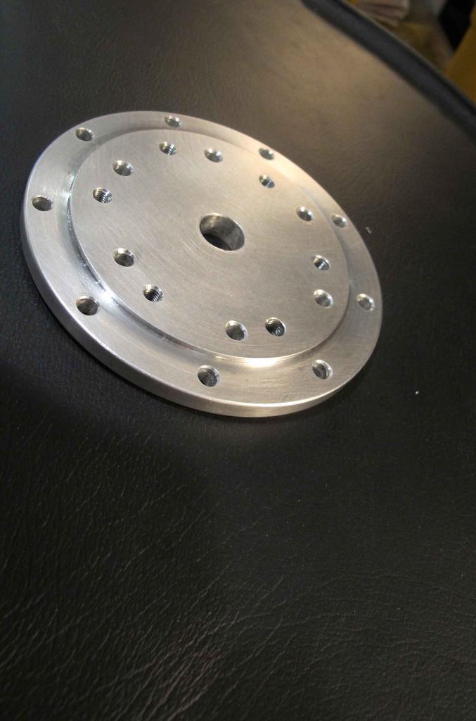

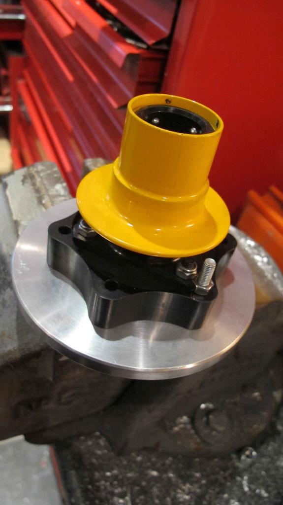

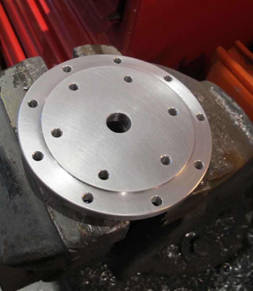

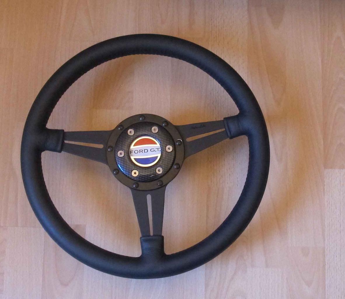

After having a short circuit in my brain I decided to machine a new steering boss for the quick release and the Moto Lita incorprating the Ford GT emblem.
Although all the machining is done and the wheel is finished I will need to get some tapered black bolts of the correct length.
I'm going to the Kit car show at Detling, Kent tommorrow for a couple of hours before all the family come round for diner, so may pick some up there.
Pictures are various stages.

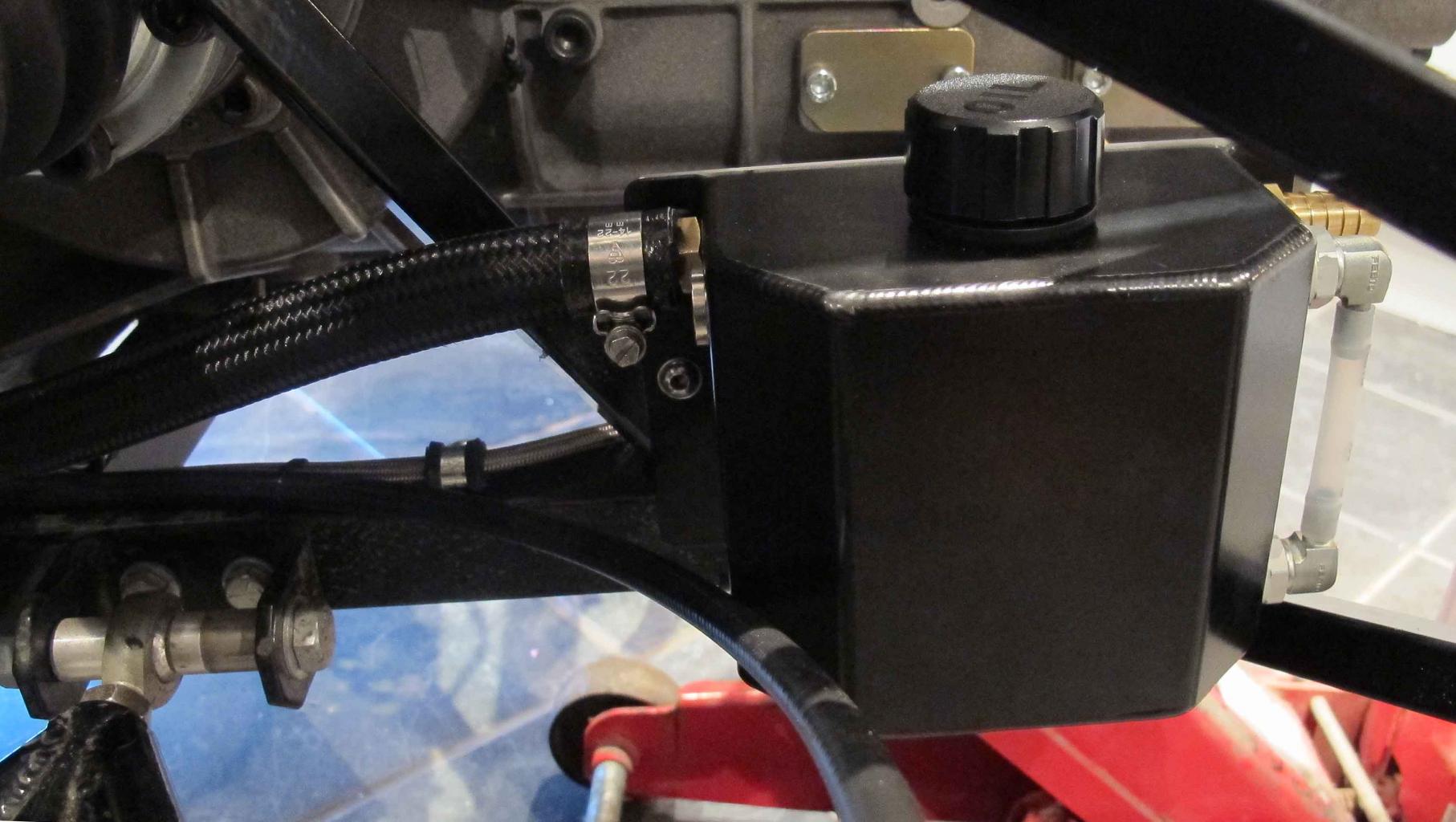

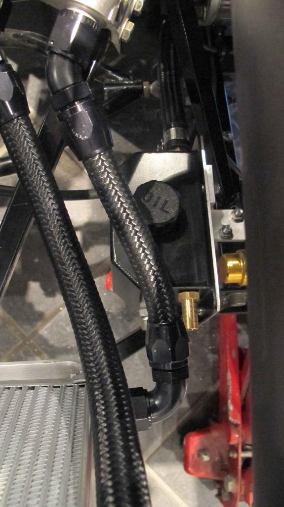

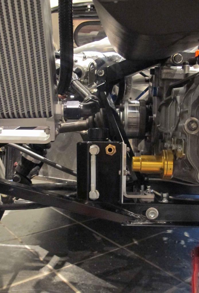

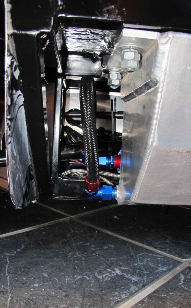

Also made the brackets for the oil catch tank passenger side.
Not sure if I will extend the drivers side flex to the same tank or fit another tank.
Probably fit another and blank off the spare hole.
This tank is 1 Ltr capacity and fits well in the space.
Purchased from Car builder solutions and is made of thicker ally plate so the welds have not distorted the metal. I think thin ally welded looks crap.

The black hoses are Goodrich 210 series hoses, good for fuel , oil and water.
There not so heavy duty as stainless but if had used my noddle I would have used them throughout the plumbing not just the oil lines.
There much easier to put the fittings on and more flexible.
I would suggest that anyone at that stage of the build buy a length and see what I mean.
Demon Tweeks amongst others sell it.
Managed to fit the second oil catch tank today and a few other little jobs.

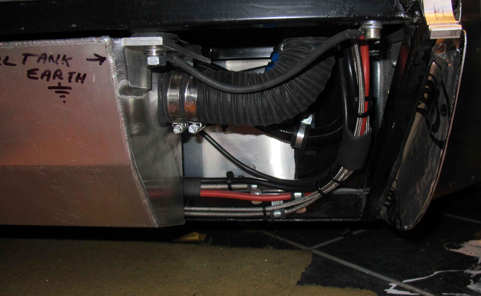

Fitted up the air con ducting and an additional Fused power supply for the H.P. pump.
Tanks in for the last time ( probably not ) and earth straps fitted.
When building these cars at the early stages you forget how little space there will be at the end. Shoe horn most things in.

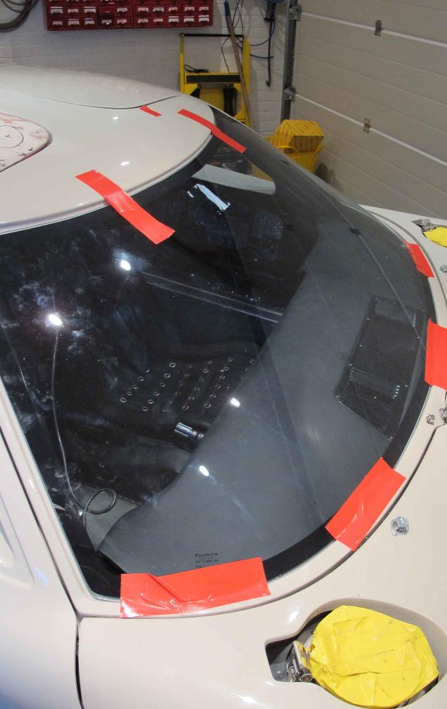

Having the screen fitted tomorrow, roughed up the fibreglass edges to get a good bonding.

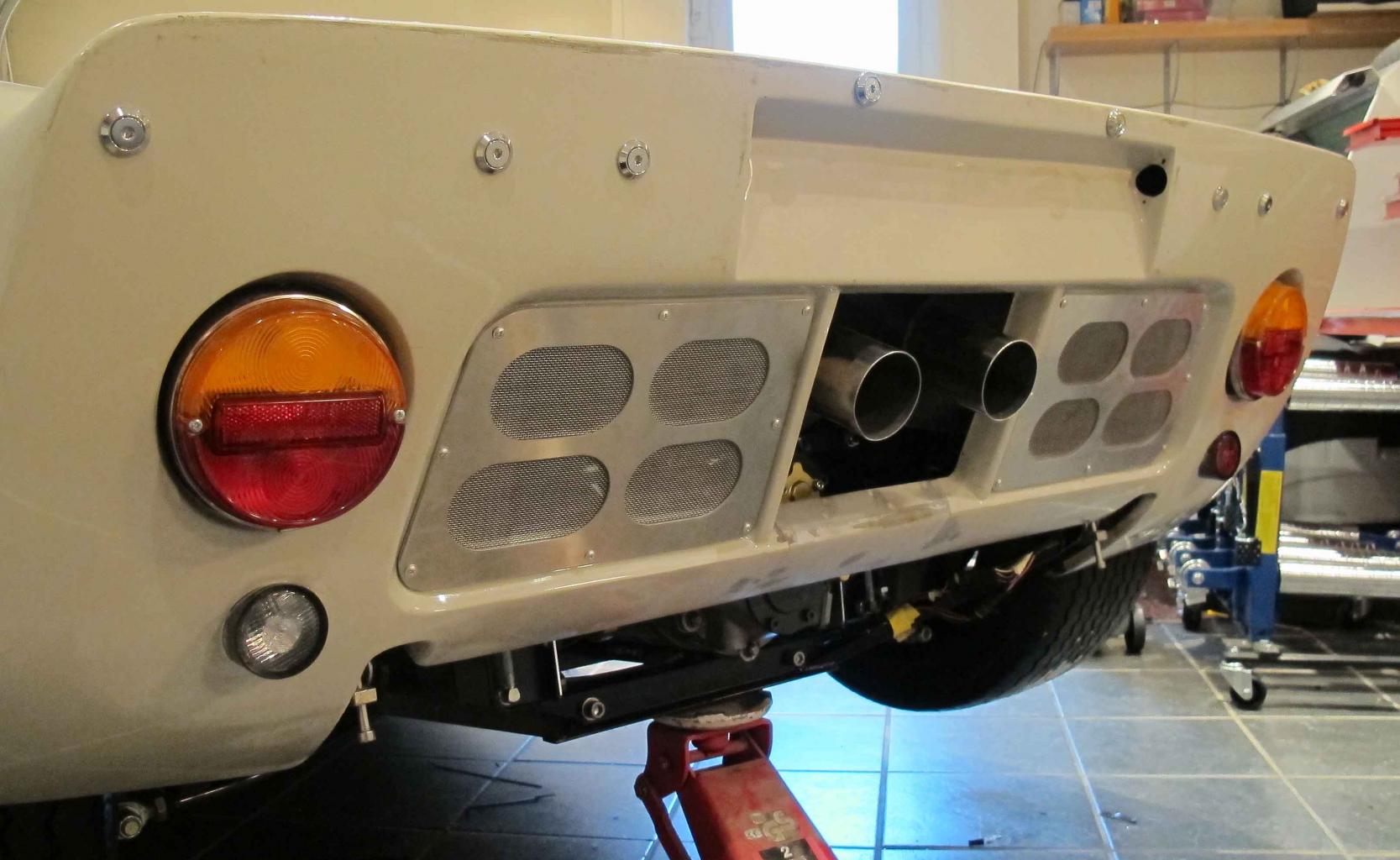

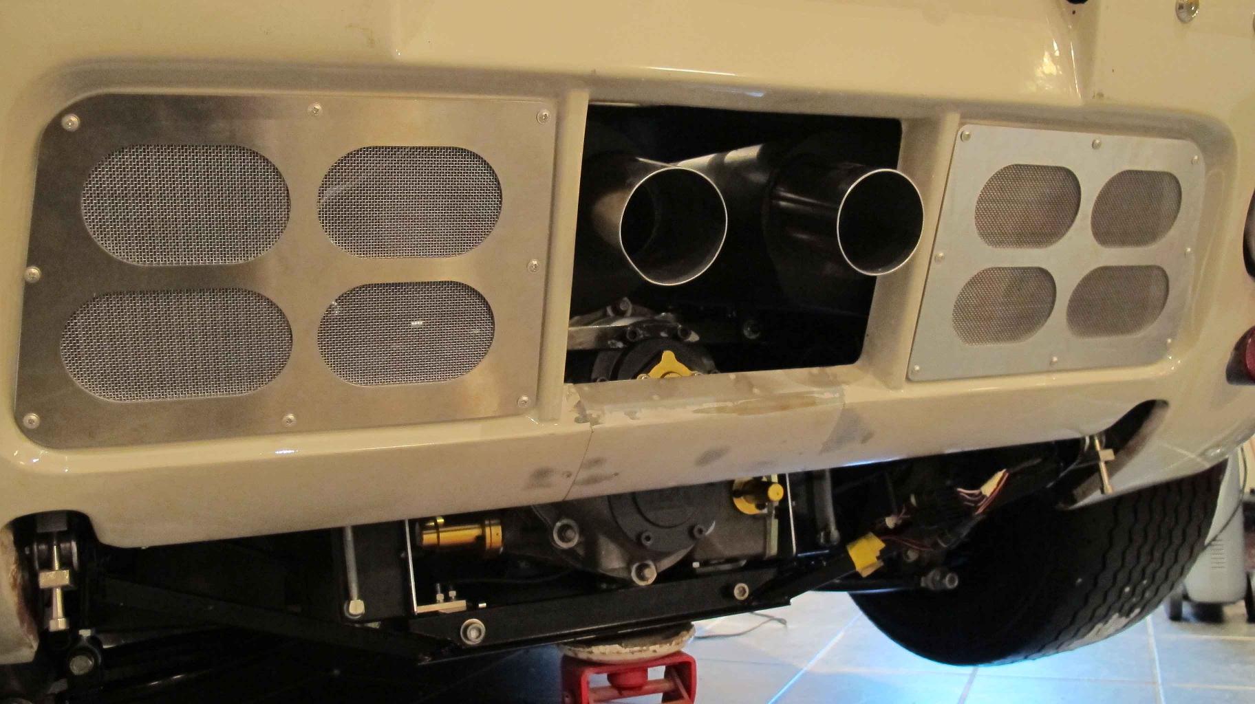

Fitted the other rear grill, that's done now except had to trim the left edge a bit and one hole needs welding and moving over 3mm,thought I'd say just in case someone notices it. decide whether to polish it or paint it later.
Lastly trimmed the inside of the rear body to miss the suspension arms etc on full travel.
