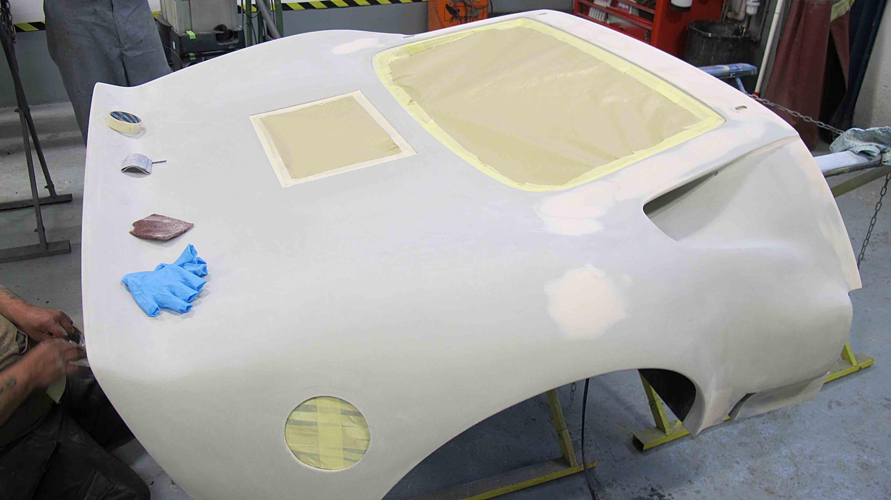

Small update on the bodywork.
The rear deck being final prep'd ready for the primer coat tommorrow.
The hole is cut for the identification lamp
The front canopy where it meets the nostril panel needed a little work and filler to get flush but again not much filler used.
They have decided to toughen up the cill panels at the front end with fibreglass on the inside, as they have sanded some of the outer face down to meet the front canopy.
These things are pretty standard body mods and they know what end result I want.

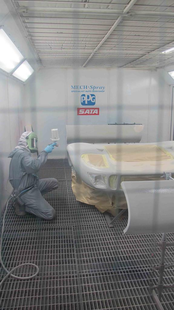

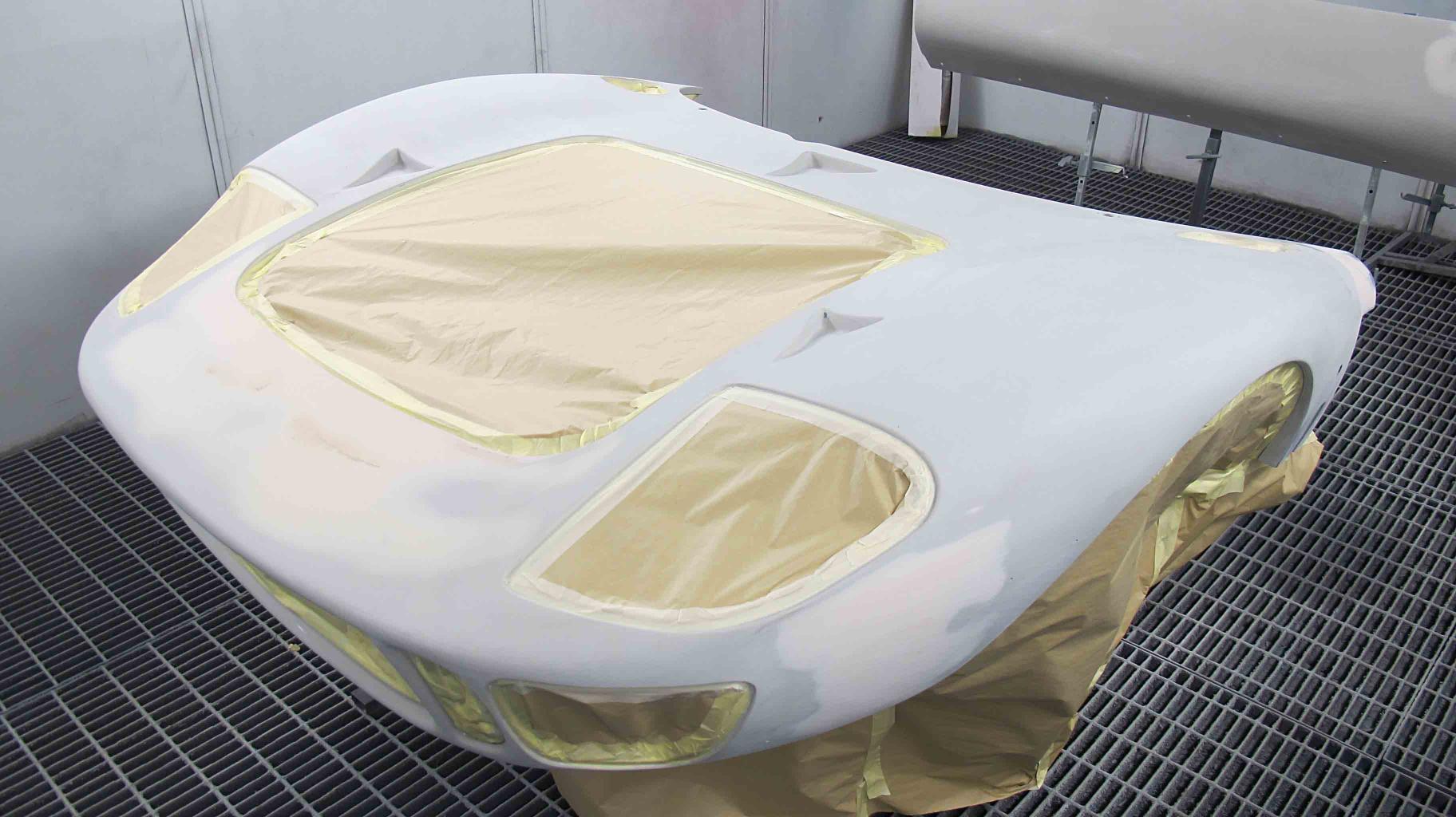

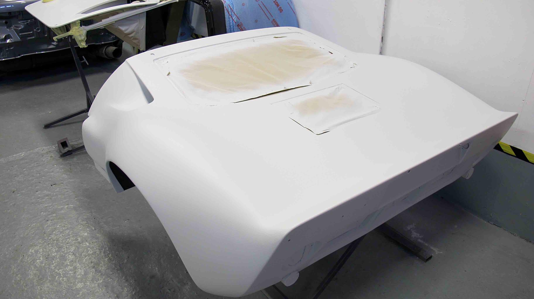

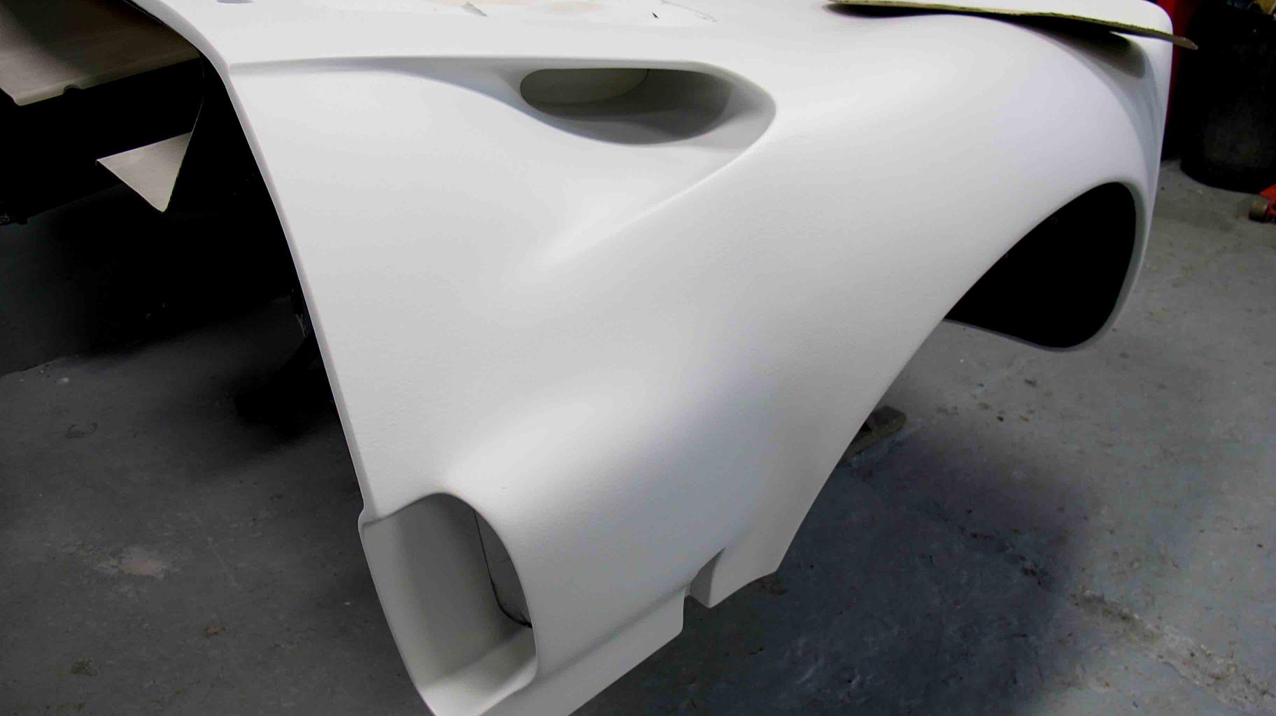

Further bodywork update.
The rear canopy and nostril panel are now in polyester primer and have been hardening for the last 3 days.
The front canopy and cills are just being primed as I was there.
You can see the additional work done on the front nose area.
All will harden for a week, although the primer feels like concrete already.
The primer is sprayed onto the prepped bodywork that has been rubbed down with 180 grade paper, this gives an excellent bonding.

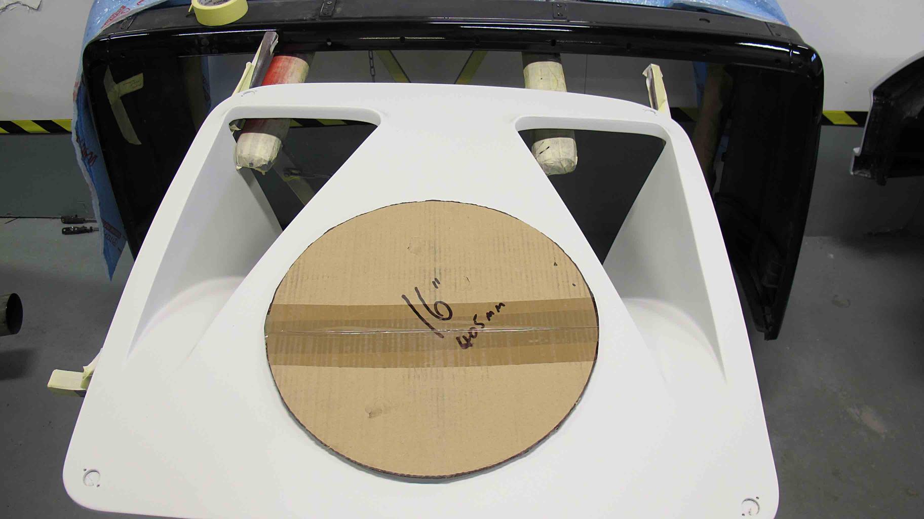

The nostril panel was in good shape and needed no real work, remember in my build log I had built out the sides so that the gaps were better.
I made up some paper discs to get an idea of the roundel sizes that would look best.

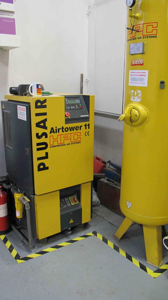

The paintwork will only ever be as good as the painter and the equipment they use.
I supplied this compressor over 10 years ago and it still runs sweet as a nut.
" German technology "
I also supplied the SATA filtration and breathing air equipment.
The prep work at this stage is always done in the main workshop as the heating is on most of the time.
No condensation allowed in the primer coats

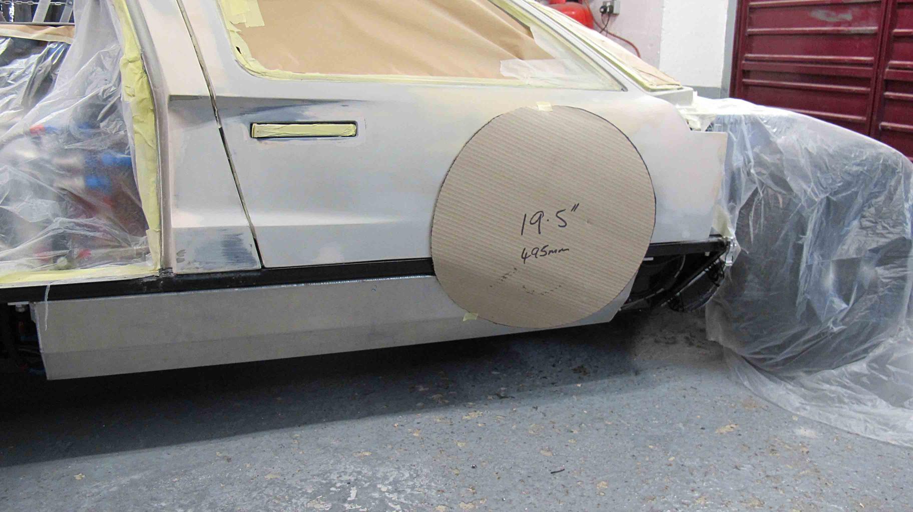

Thinking about the size of the door roundels.
I would like for the top of the roundel to be slightly down from the side windows as in the picture, this would intersect the cill stripes nicely. Also the roundel has to be more forward on the door and not central because of the body lines.
Typically what is the size of other cars roundels out there ?
Rear canopy and front nostril roundels will be slightly smaller.

Hello keith
From what I remember when i was ayoung mecanic ctting these from white vinyl in year's 70's they were 500 mm from the rules but ACO allowed some variations when cars had small doors !!
To day they provide their own stickers !!!and we use some special white vynil luminescent in dark light ( wtach some pits stops ) !!may be you can use this
one 'it will be very smart at night !!

Malcolm
I always got my own roundels cut as the off the shelf type are pants on a 40, too small and with a matt finish. I used a gloss finish for a more period look. Also I always felt they needed to be bigger as the number decals you get here are standardised at 9, 11 or 13 inches. Suggest you get three number 8's of the size number you may choose to run and then see how it looks.
Thanks all.
The roundels will of course be painted onto the car in off white with no raised edges felt.
Malcolm
I measured mine yesterday at 20 inches so would agree with the suggestions of between 20 and 22 inches as being a good size.
