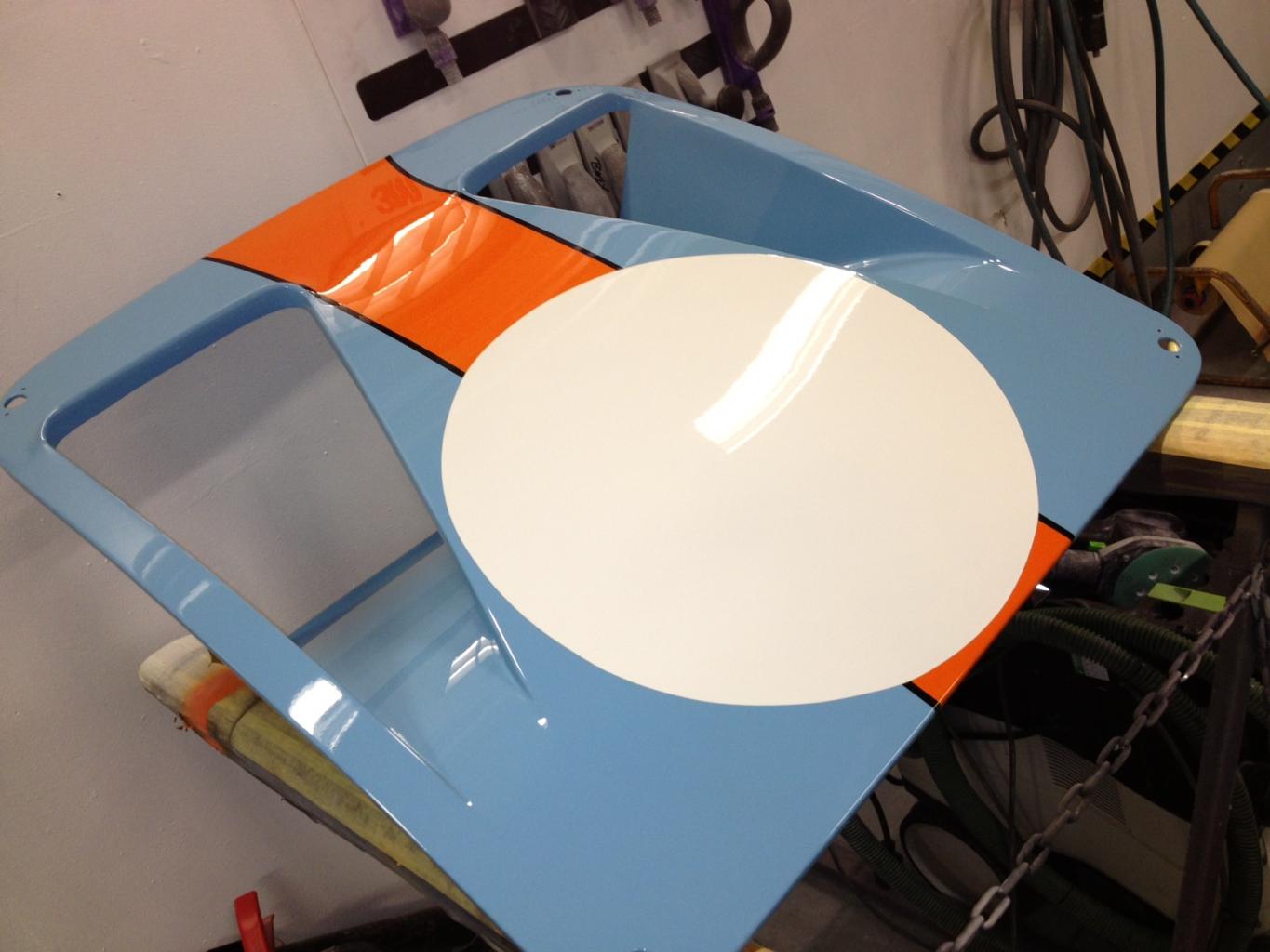

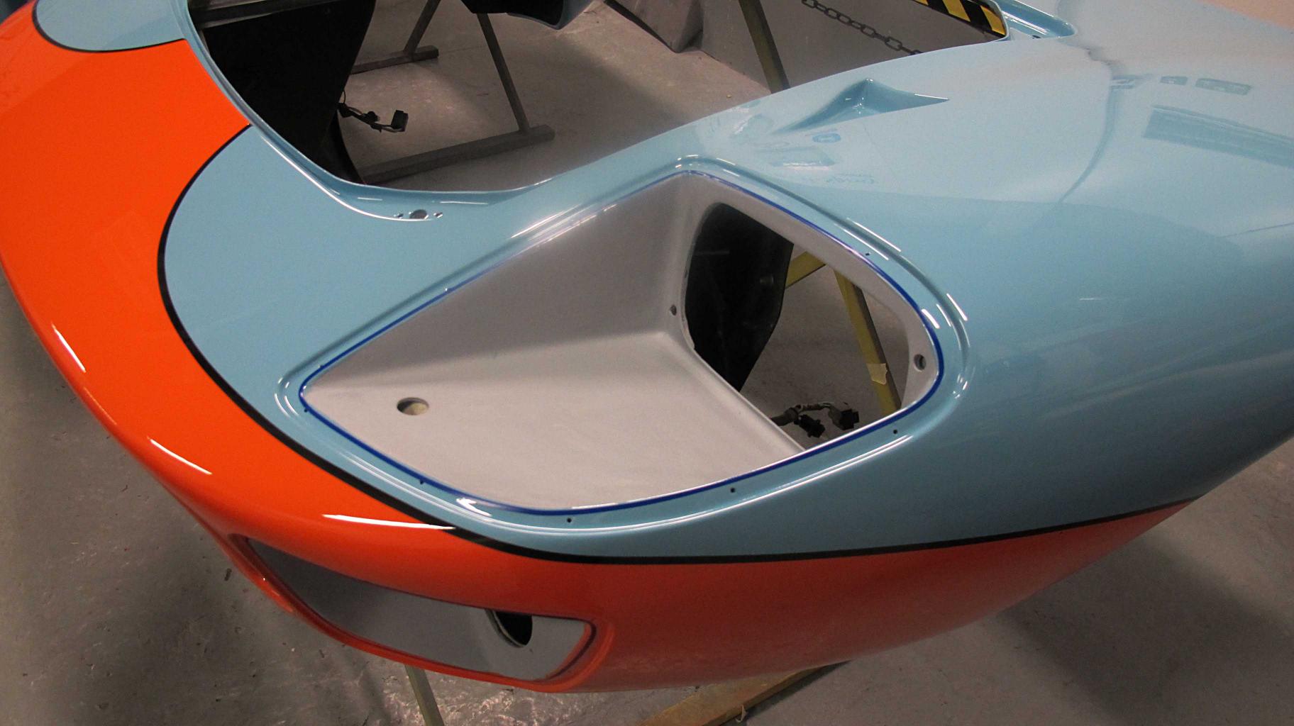

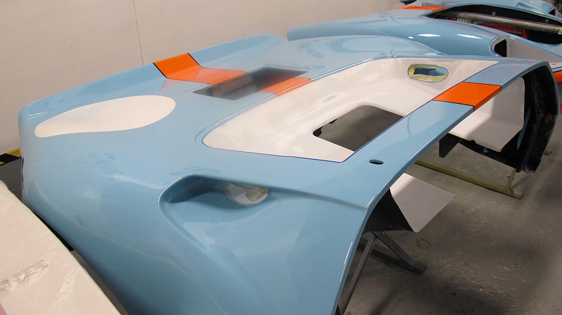

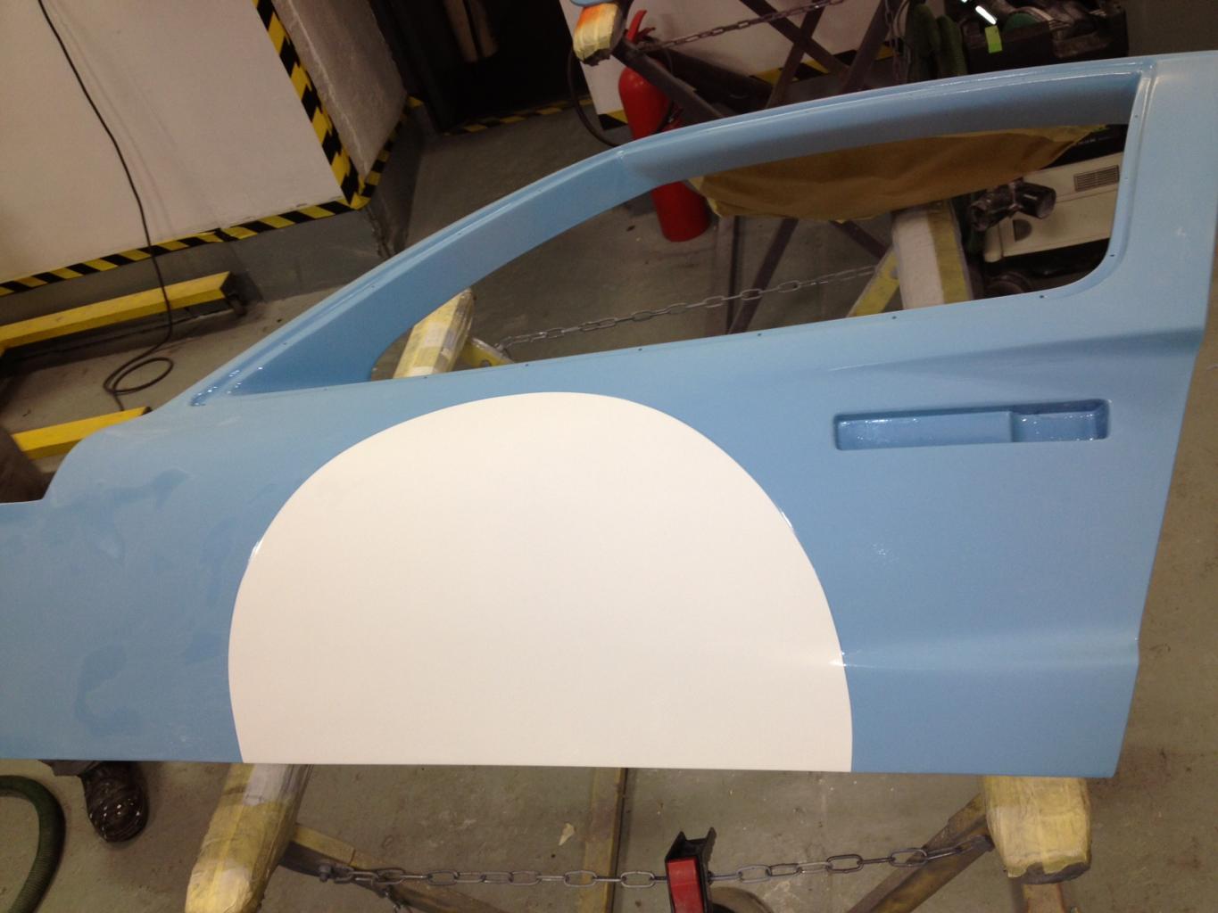

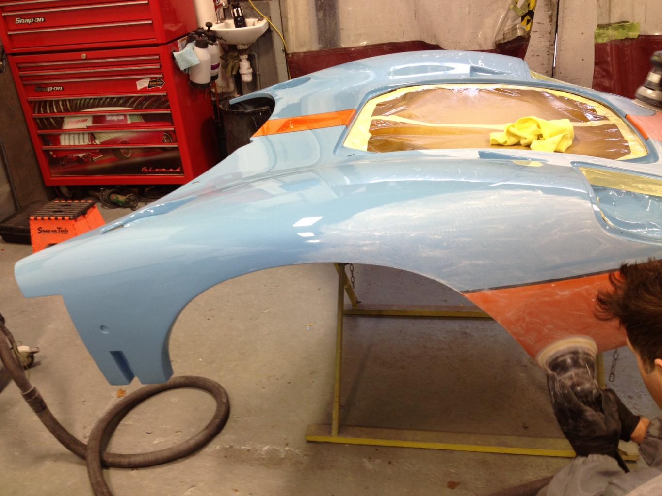

The roundels are painted in off white, then the 1st coat of laquer is applied. When it's hardened it's gone over with the sander to take the edges off where the colours overlap and any little defects.
The black line is flatted and finished off.
The car is the laquered again after polishing in a few days thats it.
The satin black bits are added last.
The shiny picture of the front section is prior to sanding.

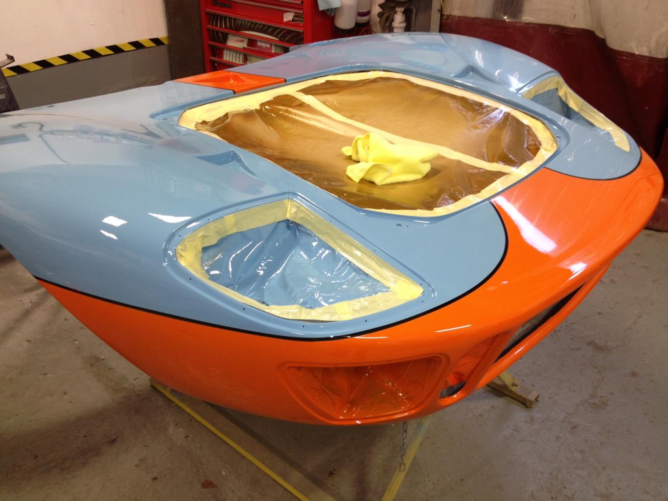

The rear section and nostril pictures are also prior to sanding and re laquering.
Doors and cills sanded and waiting for 2nd coat of laquer.

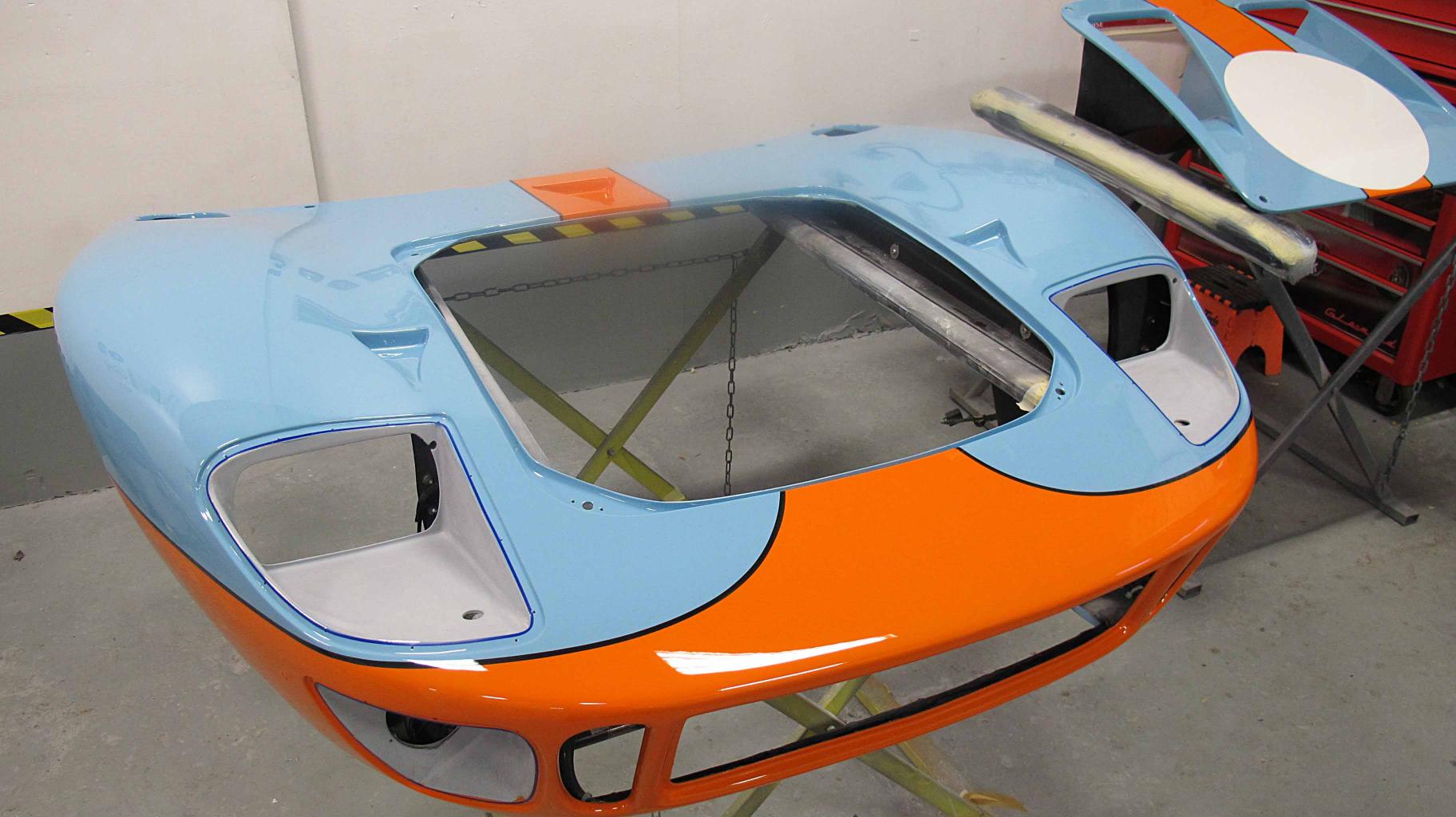

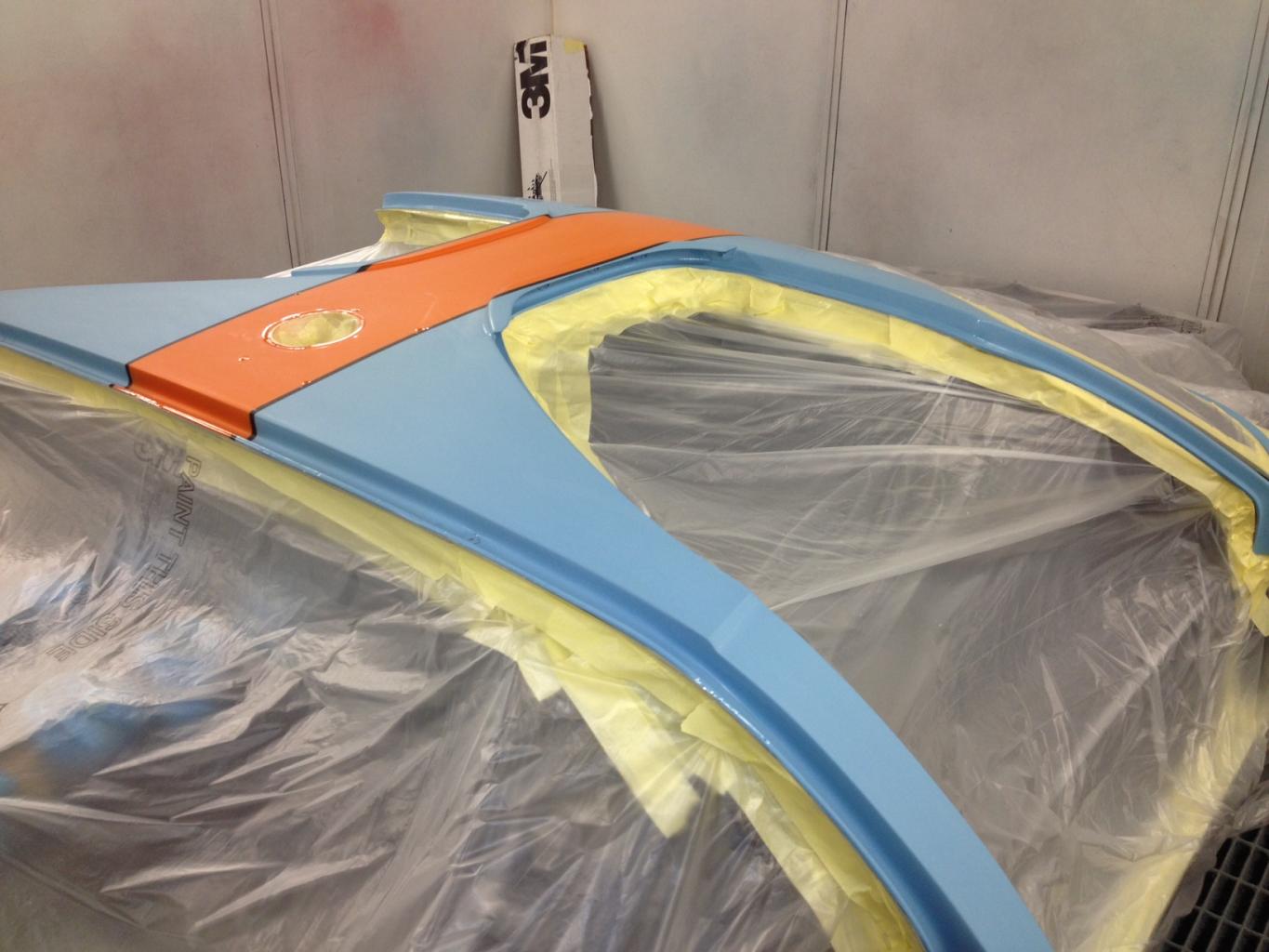

Spider section has been laquered and flated down . It's ready for the last coat of laquer.
The pictures don't show how nice a finish this is, well pleased so far !

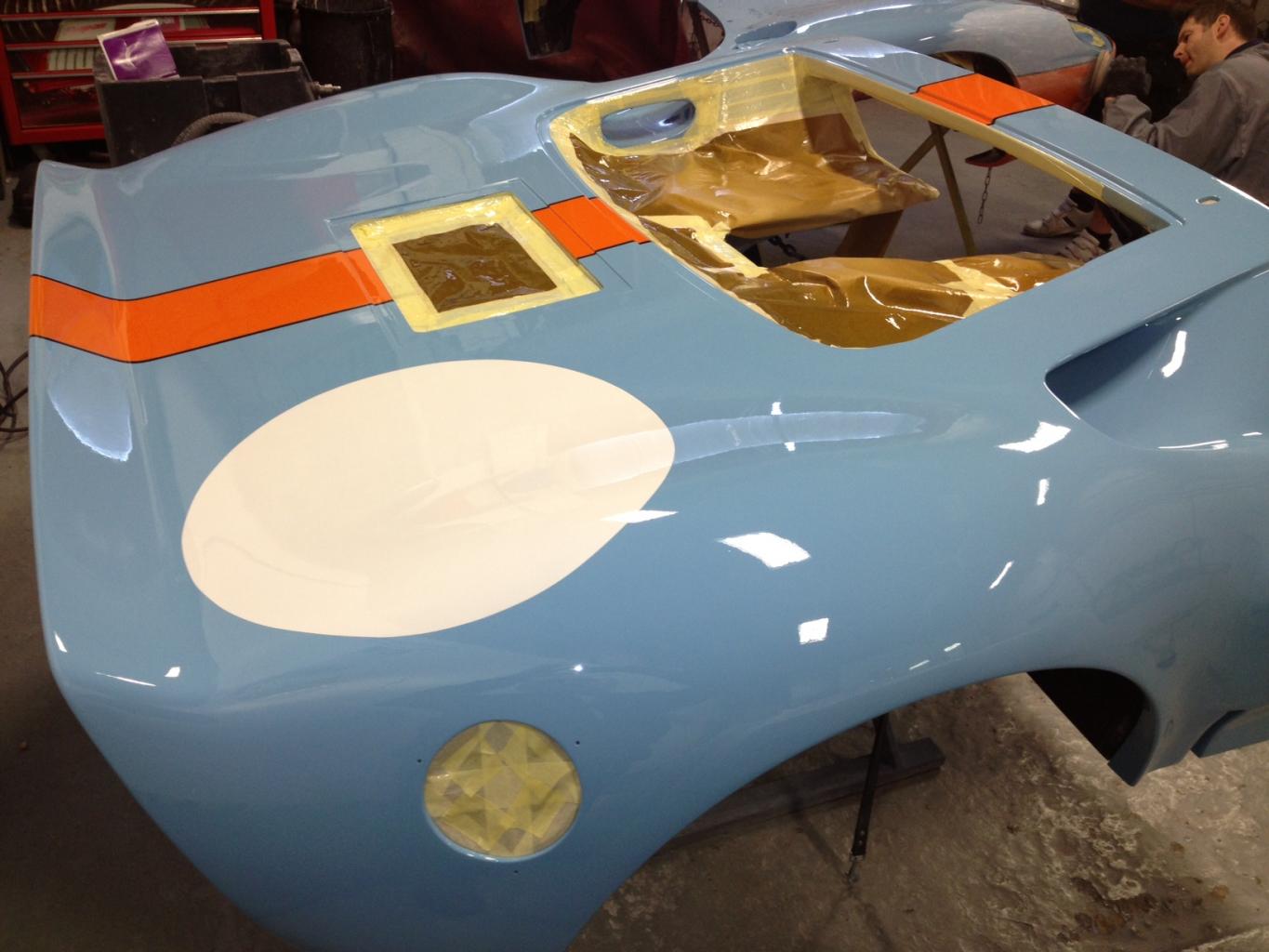

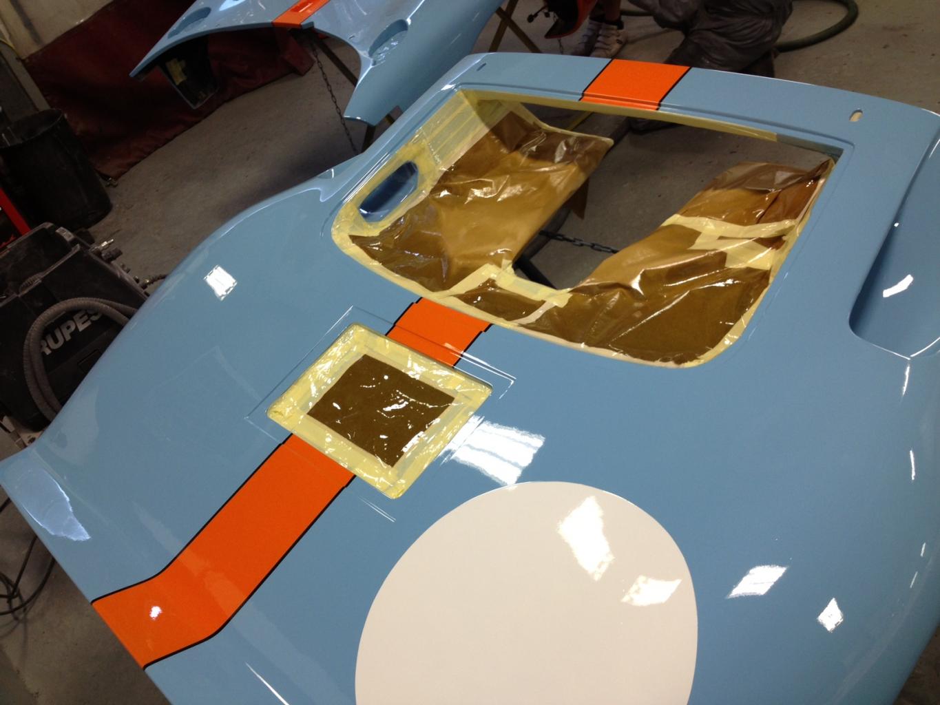

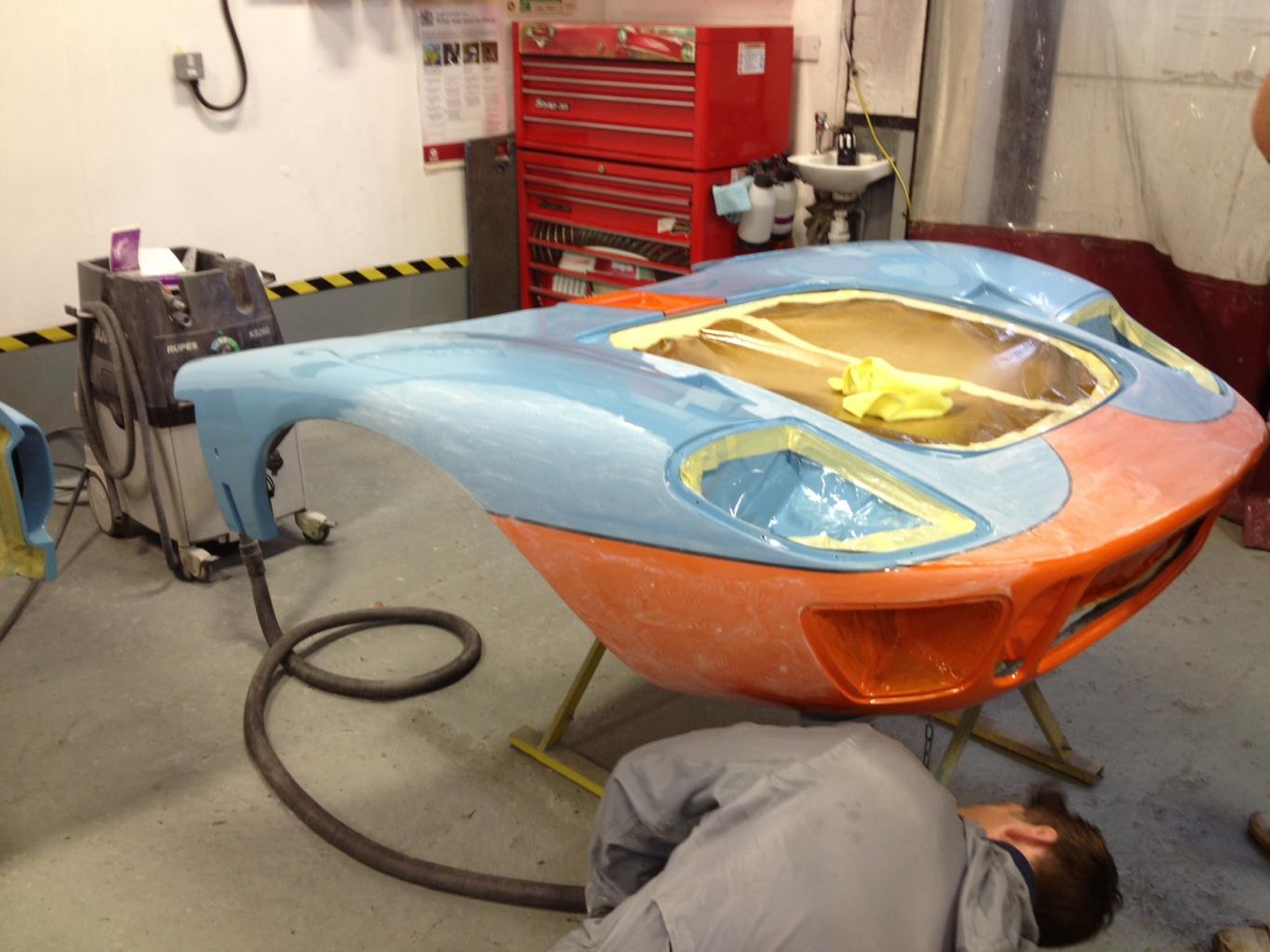

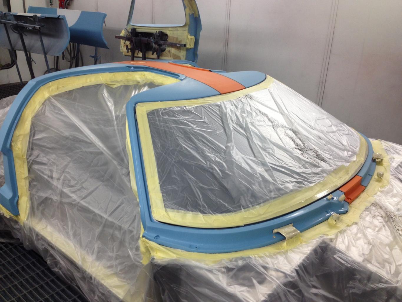

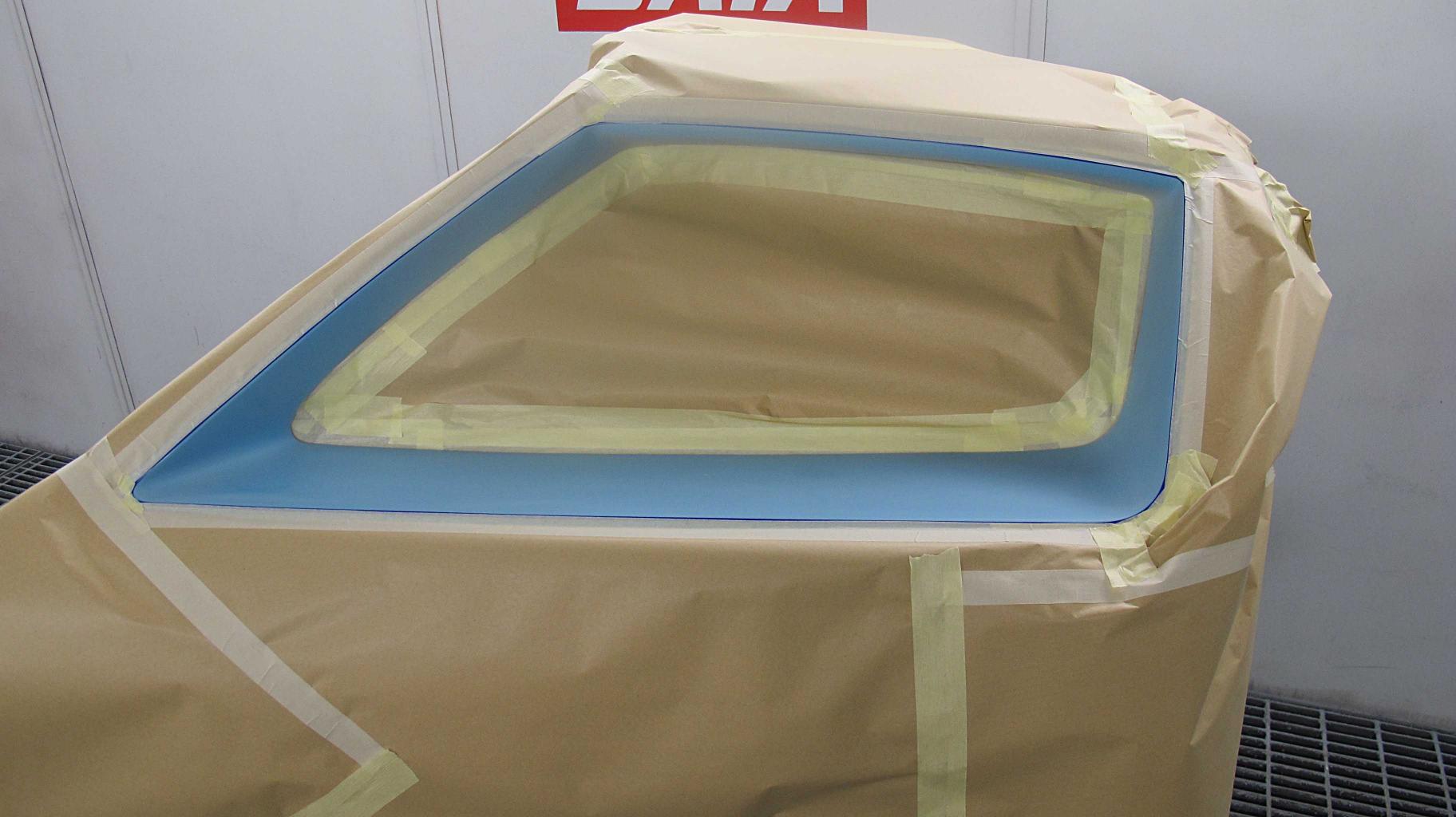

It's amazing how much masking is involved in doing a car especially a multi coloured car.
Overspray is a real bugger to clean up after. These painters are really clean in there preparation.
The front and rear screen rubbers were removed. The area at the front drivers side top of the screen dipped so had to be built up, so removing the screen rubber was essential.

Spider is now ready for the final lacquer coat

The 2nd sanding is only very light, it's a 1000 grade paper just to take out any little blemishes and that horrible ridge where the lines are.

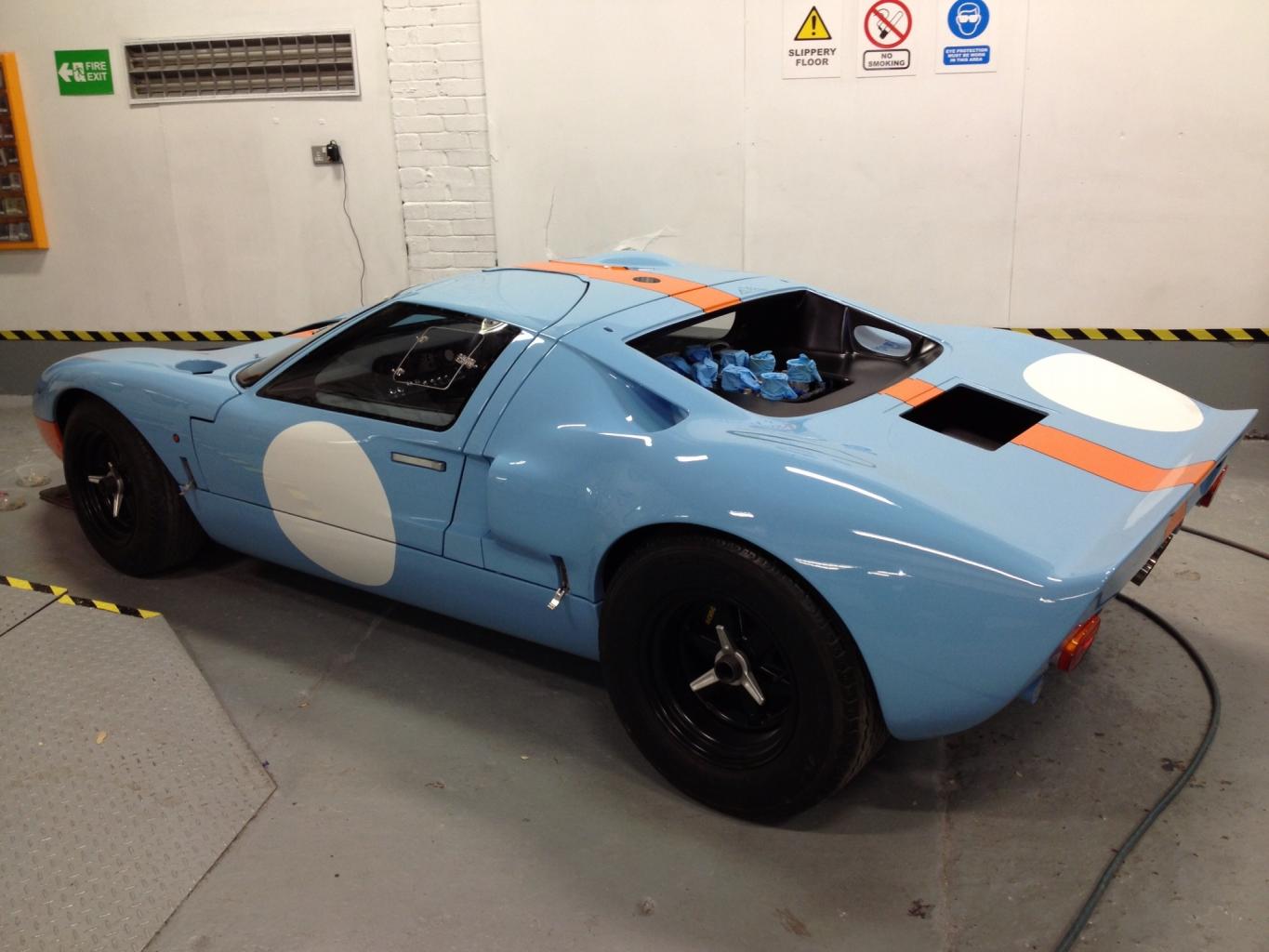

Last pictures before finally putting it back together.
All the panels are now finished, just a couple of bits to paint black.
Reassembly then transport it home... " Praise the lord "
Last picture is the door prepped before it was blacked.

well it's painted and getting ready for collection tomorrow.
Windscreen fitter got busy so he'll have to fit the rear screen at my house later.
Now starts the fiddly bit of not damaging the paint when trimming up.

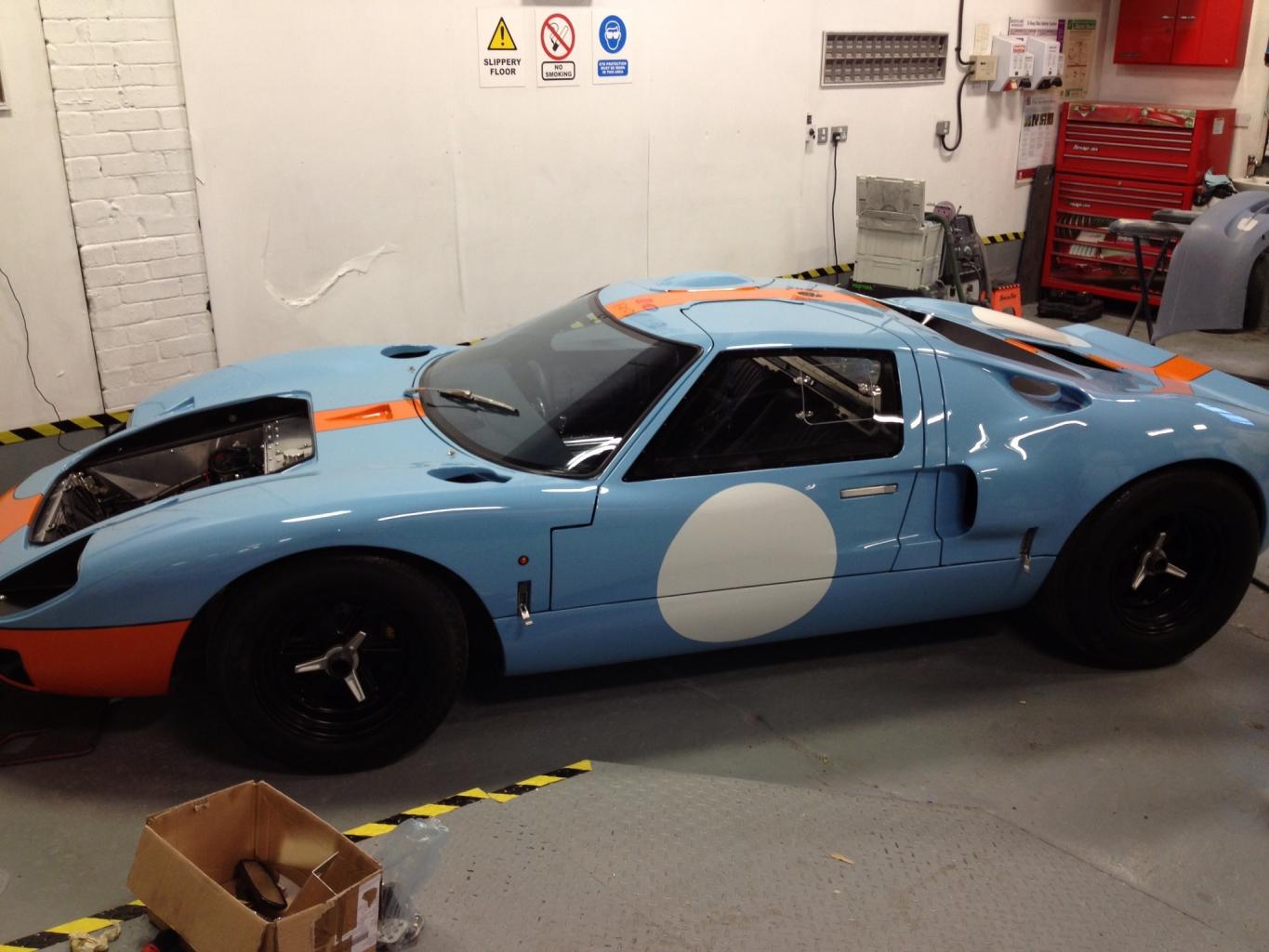

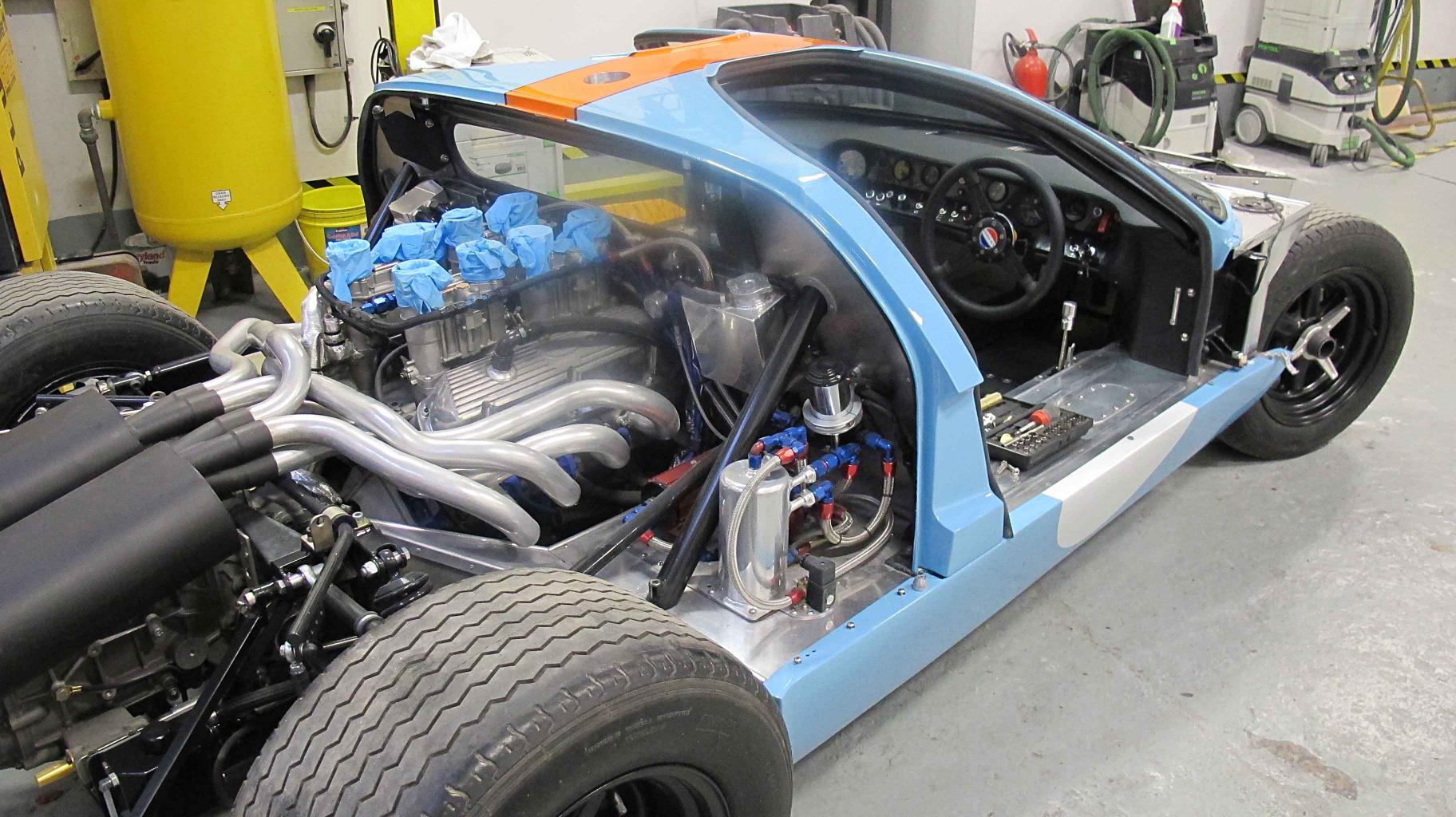

Car is now in my garage at home.. Boy that feels good.
Rear screen was bonded in today, the surround rubbers really tidy it up.
I Will spend the next few weeks fitting out with all the trimmings.
