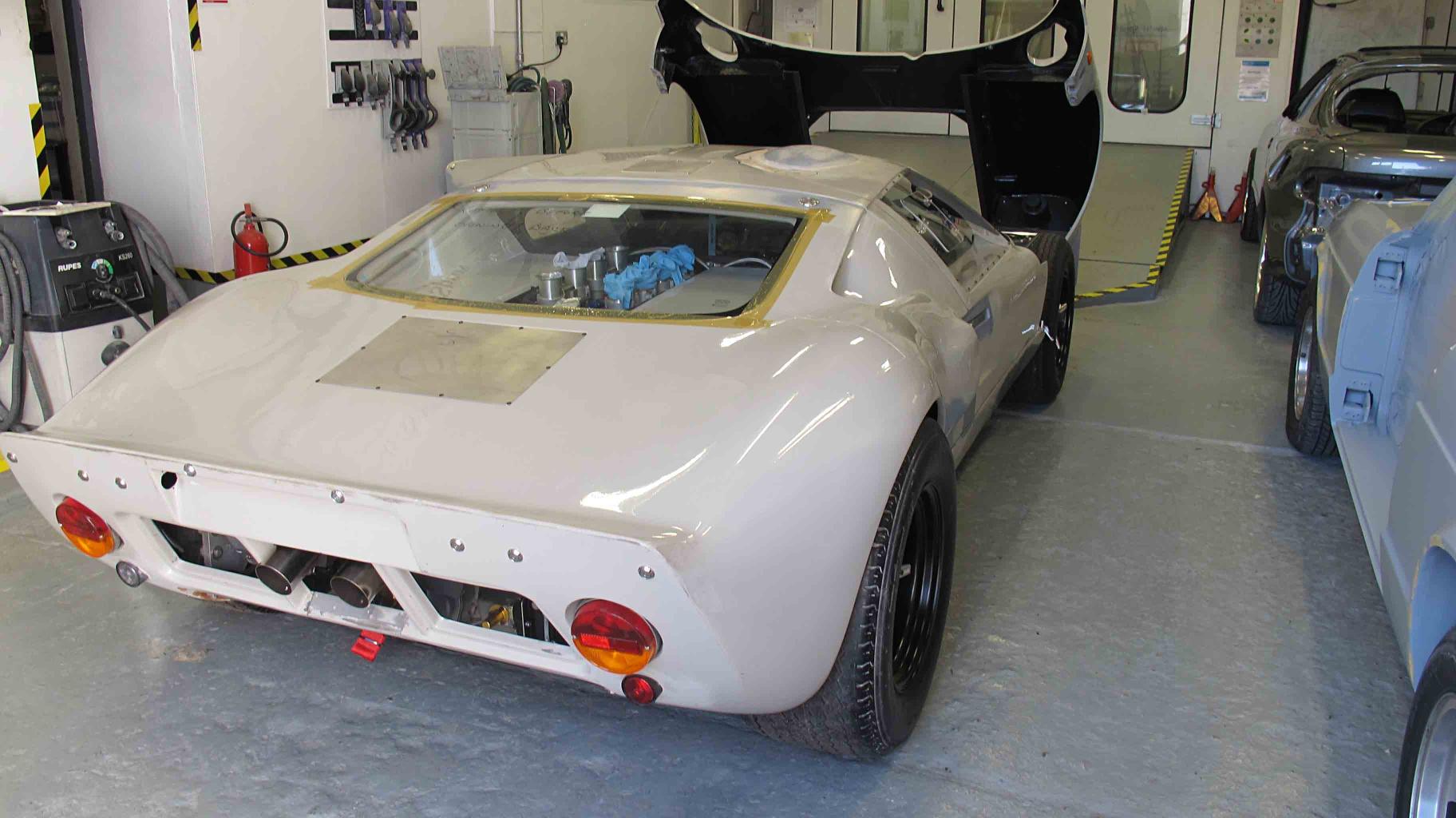

Cars in the bodyshop this morning and their starting on it today.
Could be up to six weeks but I will be popping in weeky and will post pictures of its progress.

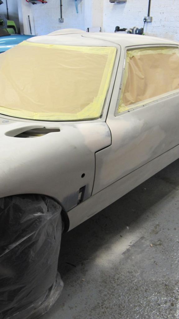

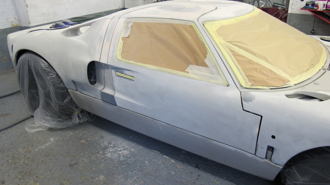

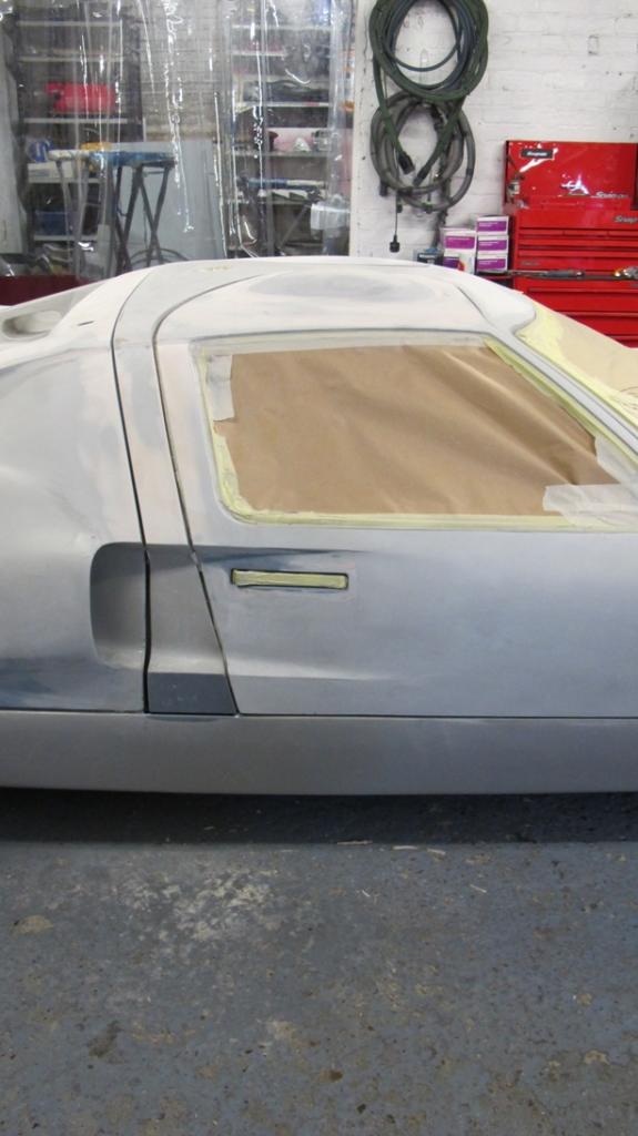

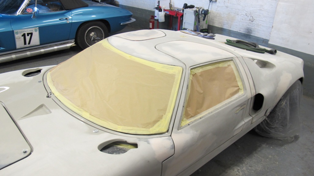

Well it's been week one in the bodyshop and the uneven areas and shut lines are getting done.
After all the bulky bits are out of the way the car gets a coat of polyester primer and it will be left for about a week to harden off.
It's he usual places that need work.
Last picture shows what sought of gaps have got to be made better.
a week? I guess most "ordinary" bodyshops don't know about that?
I only know that such sort body needs way different treatment then say a steal body...
my 2 younger sisters (a twin) have a special day car, a lovely dark blue Maserati Mistral 4000 coupe from 1967 with a aluminium body, and that can "corrode" too, they are going to give the car a respray to make it smooth again and I heard last week that this sort carros needs such sort of special treatment too, otherwise you probably get those sort of little air/corrode bubbles under the paint.
Those types of primer need lots of time to dry. The previous owner of mine didn't wait. When we grafted on the wide rear fenders we could peel the paint back like an apple and you could smell the primer some 7 years later:shocked:
We had noticed that when we lifted the rear clip off the car using cotton strapping and a lift, that the pattern of the webbing was left in the paint.
