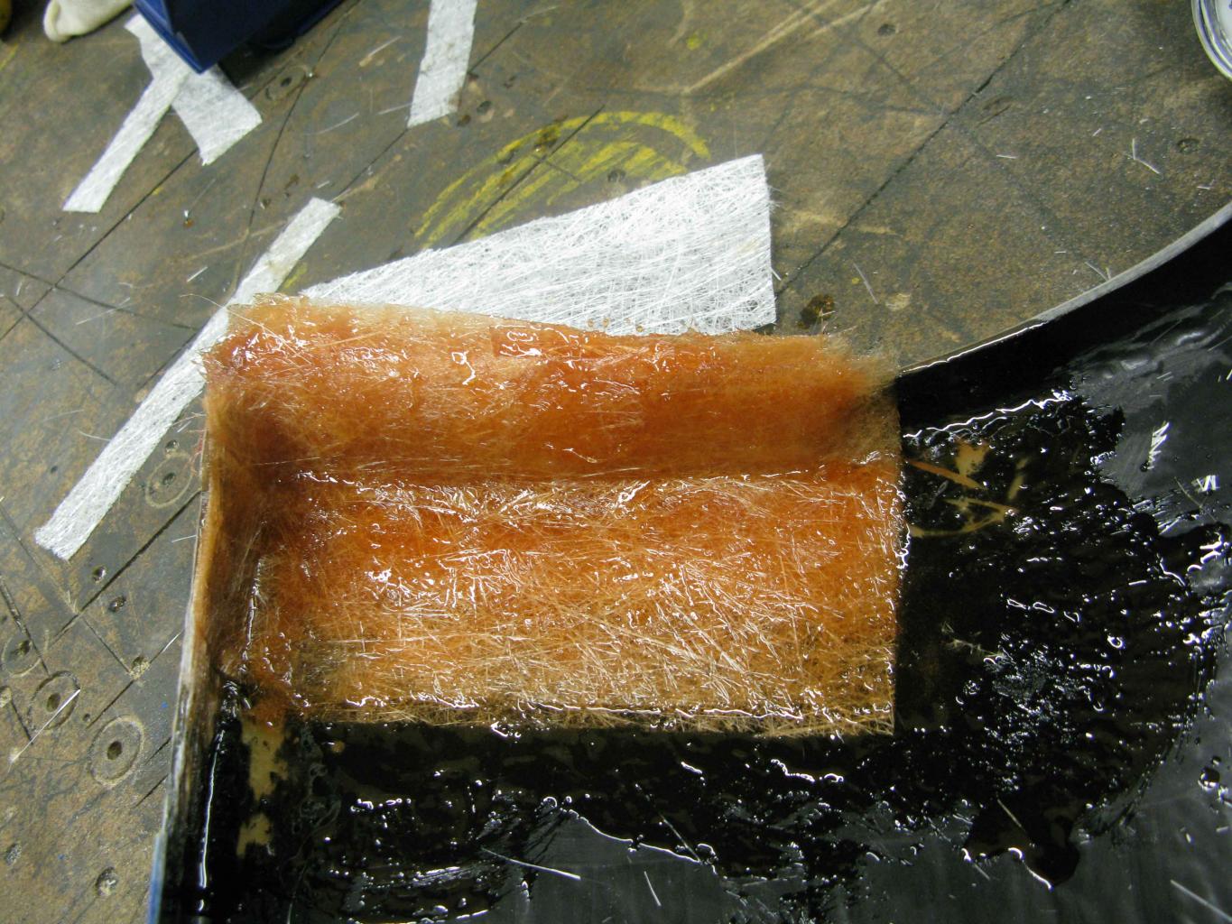

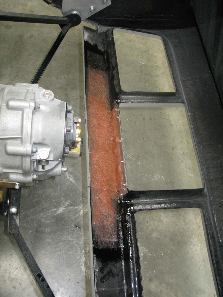

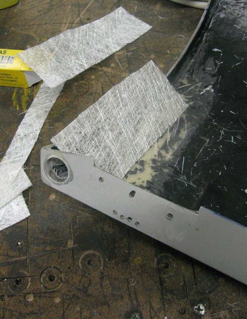

Tommorrow I intend to repair some of the digs and dents in the body, Originally the body was pre fitted on a GTD chassis so a few bits were chopped and cut about. Also at the bottom of the rear deck I had removed a small piece of fibreglass to clear the gearbox which was to be a G50 porker.
Having changed a bit I need to replace the section.
As you can see in earlier pictures the passenger cill is about 20mm longer and this will be cut and made to fit correctly.Some small blow holes in the gel coat will be made good.
Pictures to follow.

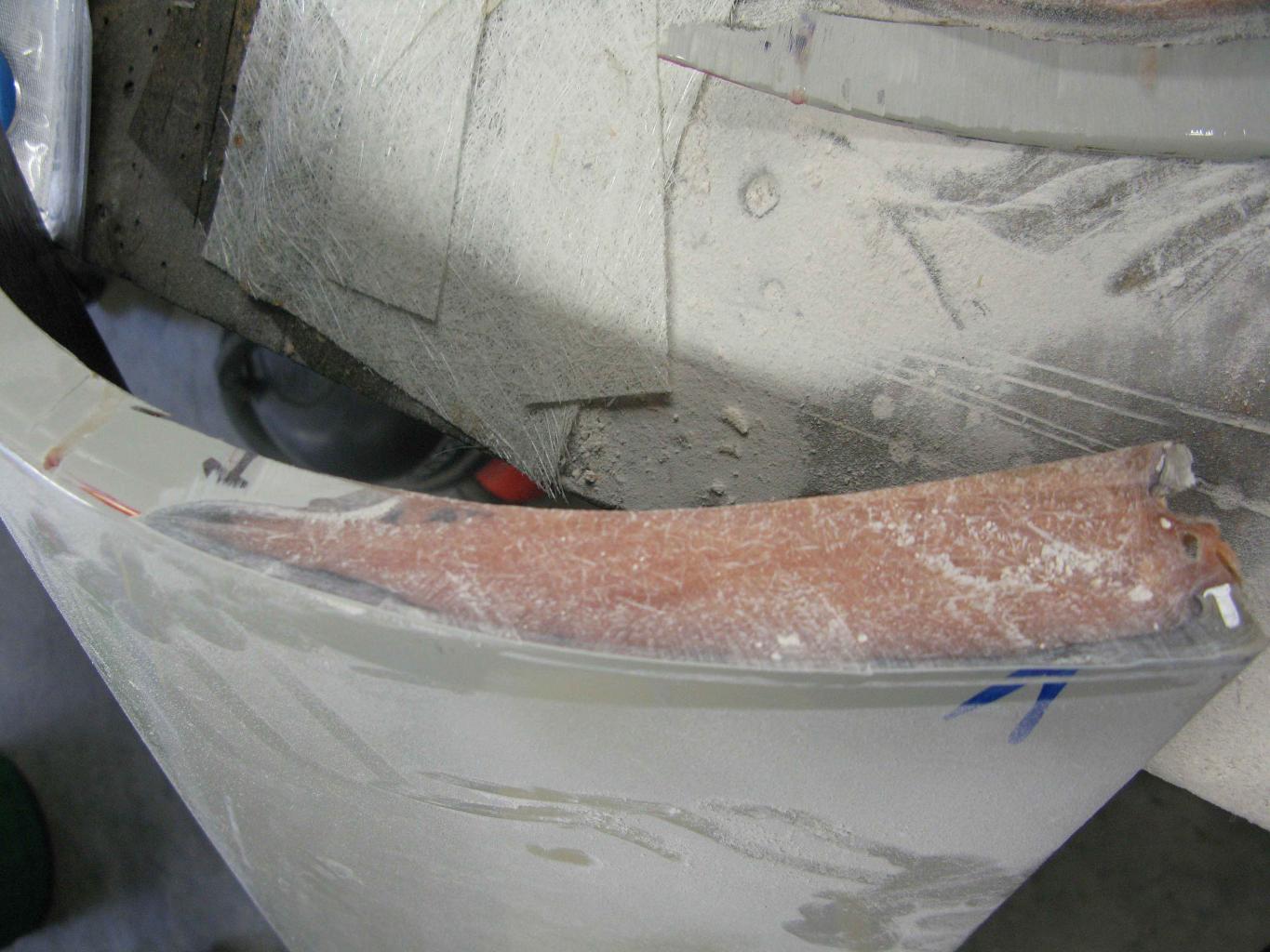

Well today I did repair the cill and a few bits as well.
The cill was actually 12mm longer than the other cill and now it aligns with the car just so.

Next stage after fully set was to cut the 12mm oversized section out.
The final shape and finish will be later.
The lower section of the rear deck was also repaired and the incorrectly drilled holes filled.

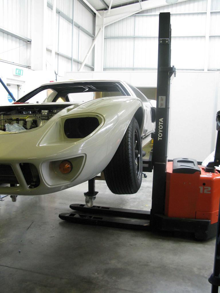

By the way, If your lucky enough to have a fork lift you can use it to lift the car to a suitable working height.
Saves the back a bit.

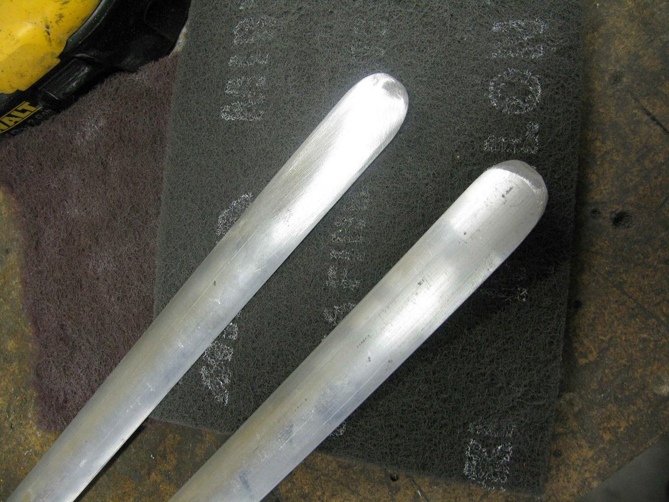

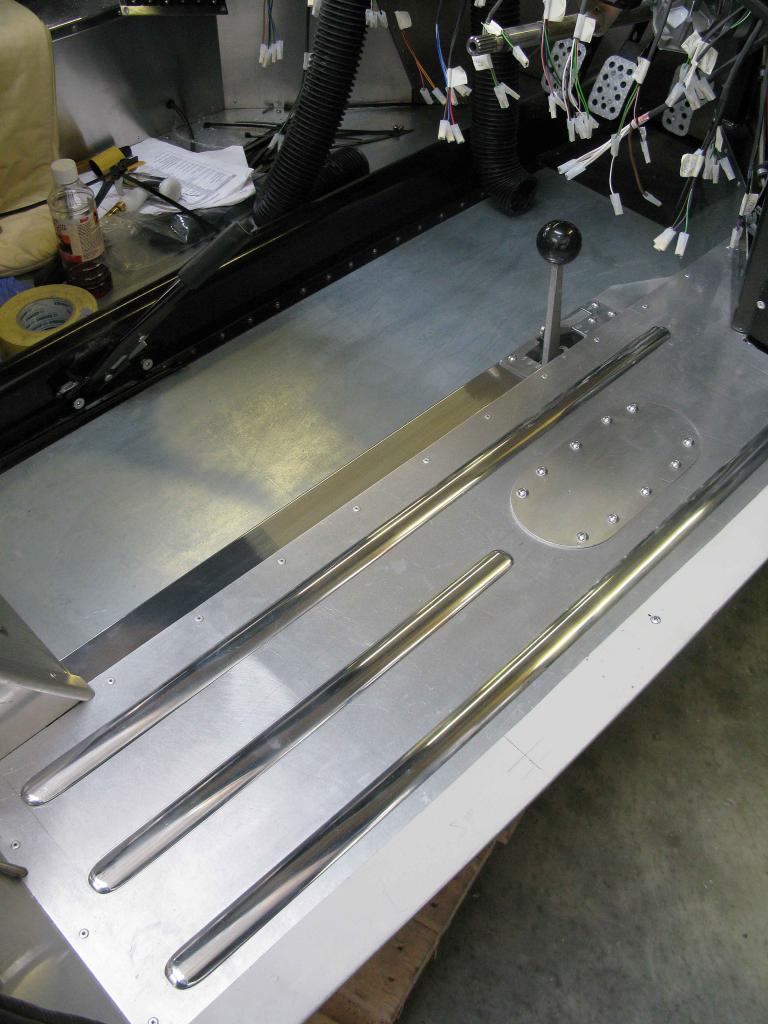

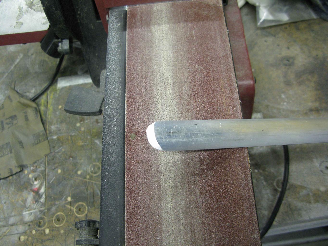

I first saw these cill strips on an Glenn Masons 40 down at SGT and wanted to fit them. I know there stick on but they add that little extra bit to the final look.
You buy the ally strips, cut to size, shape the ends and stick them down with something like sikafex 227 and there down for good.
At this point in time I have only done the drivers side and wont stick them down until I'm happy with the position of the cills.
I shaped them with a belt sander, finished them of with 240 grade wet and dry then 600 grade, then a rub down with scotchbrite fine and ultrafine. Finally Autosol and on the buff machine.
They will get a final buffing before I stick um but the result is super.

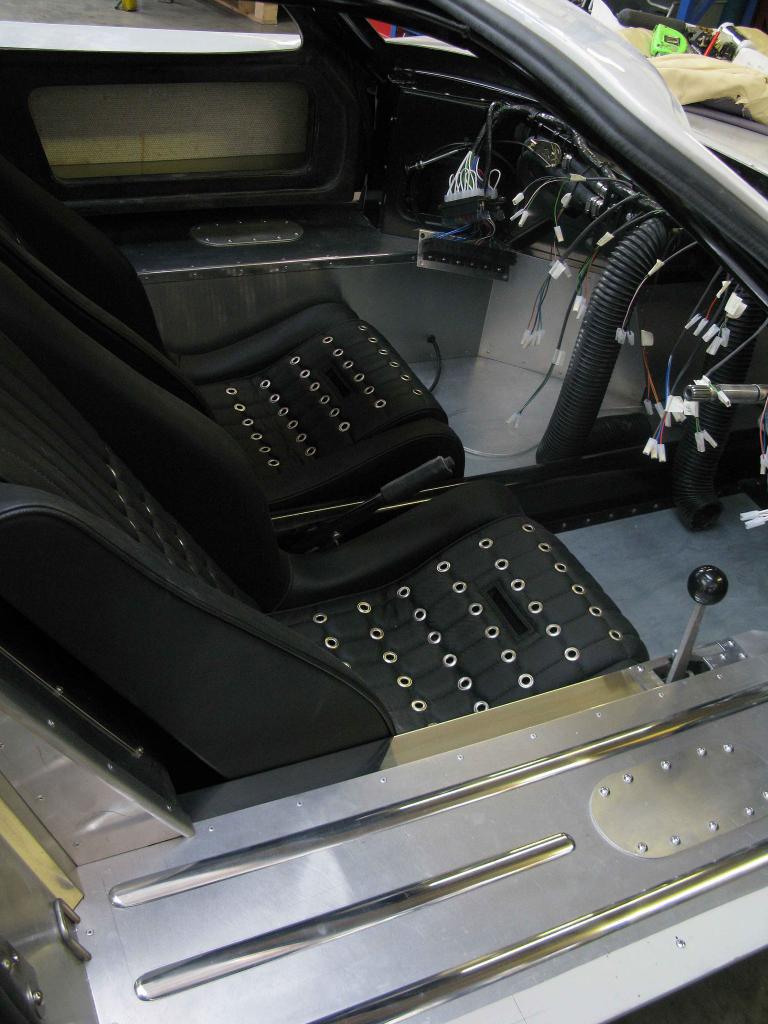

nice to see that Keith, I also saw such stuf on this website, but they pressed it into the alu sheet I think? see picture 35 and more when painted some pictures further>> it looks nice.
Gelscoe Motorsport - CHASSIS 4 GEL 004
Hello Keith. Long time no see. Excellent work rate. And eye for detail too. Just to add, i now make that sill shorter on the passenger side :-)
Hi lee,
Thanks for that info, too late for me though i'm afraid, the cill has been butchered... In a nice way.
Good to hear from you though, Considering a carbon rear section, and probably will go for that next year.
Maybe I'll build another 40 I have a couple of months free next year !
Keep up the good work.
Hi Rene, It would be nice to have the recesses pressed into the sheet, it would be more authentic and of course add some strength.
But cosmetically nobody will know difference as the strips will eventually be blended in with the sheet.

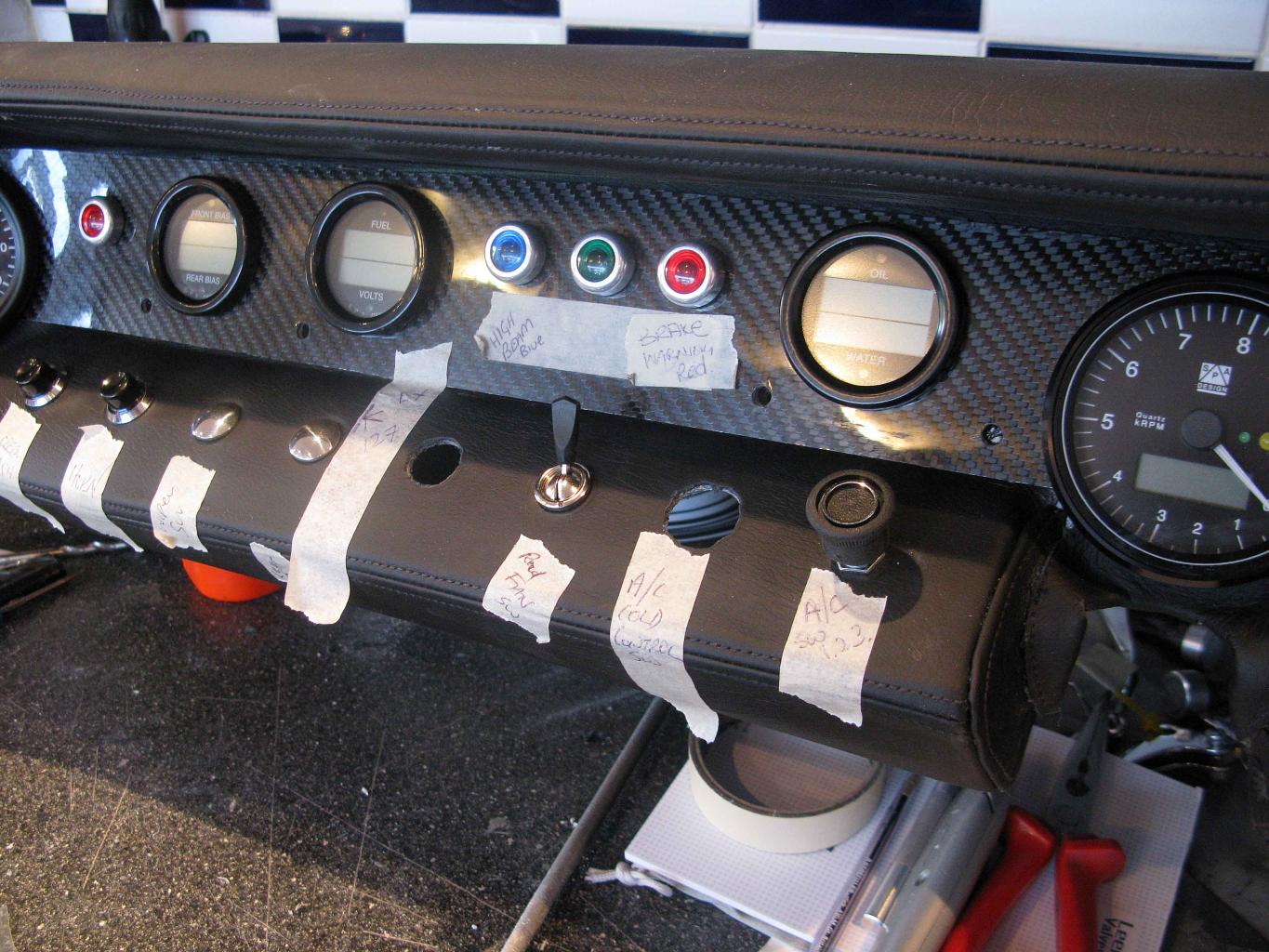

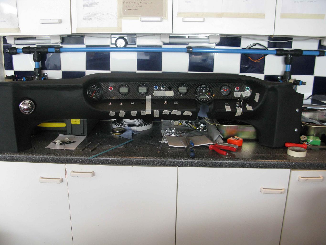

Told the wife I wasn't working on the car on Sunday, so we went shopping "briefly" and then enjoyed the sun in the garden. Later in the day she went for a snooze and I slipped into the garage where I just happened to have the dashboard which needs work on it.
Well rather than being bored I set to it and modified switch holes, added a few more and pondered over the IVA.

Keith, no offence meant but I don't find it logical to replicate the originals to the point of totally fake stick-on strips on the sills, then upgrade to a modern dashboard detail with carbon-fibre panel and digital gauges.
Why not just stick quiet, comfortable (insulating) and attractive carpet on the sills? Notwithstanding, your build and workmanship are inspirational; please keep posting.
