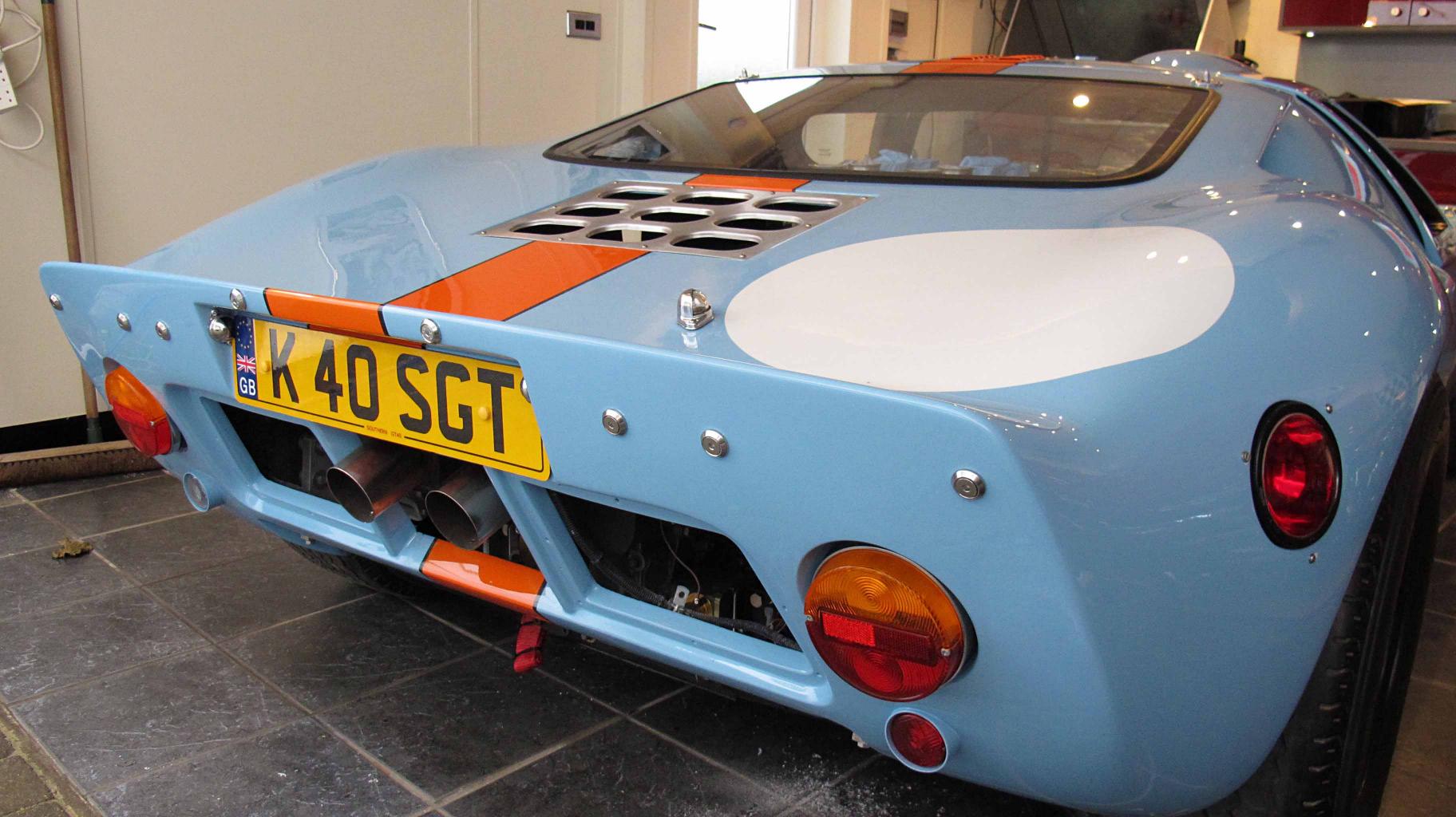

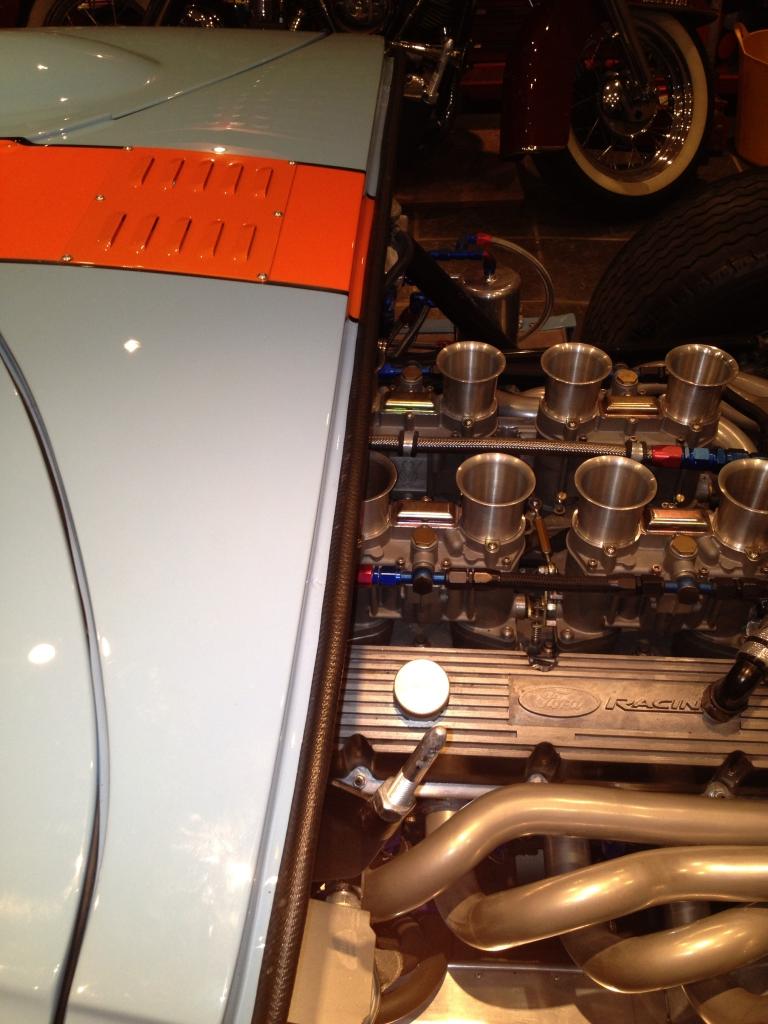

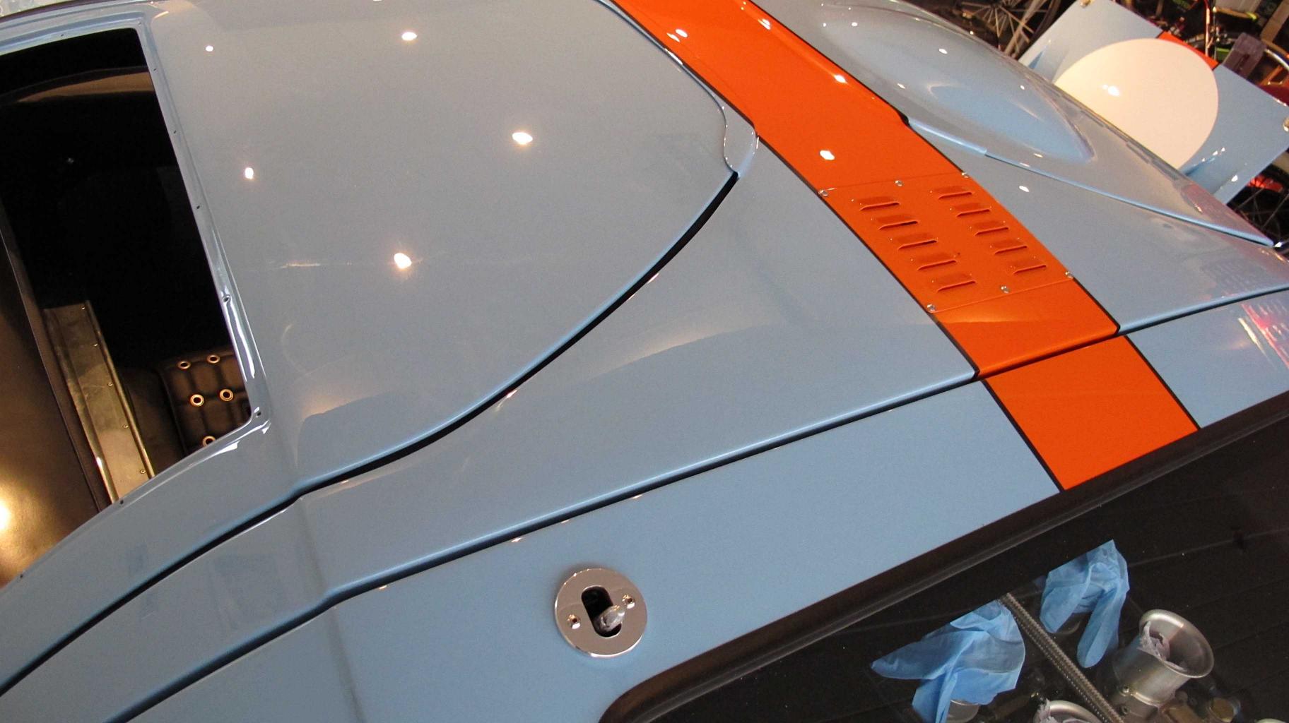

Can't resist putting a few bits on.
I'm happy with the way the louvre grille over the rear of the spider looks, also the rear screen rubber trim adds to the clean lines.
I polished the two rear canopy lock pin plates.
I decided to fit the door lamps to the front top as opposed to the bottom of the door, just a personal preference.
I had too set the mirrors up for best vision and for me they were on the front canopy and not the doors, I can see better through the screen rather than having to turn my head.
One fuel filler cap latch touches the body, Not sure why but I'll trim 5 mm off it and it will clear.

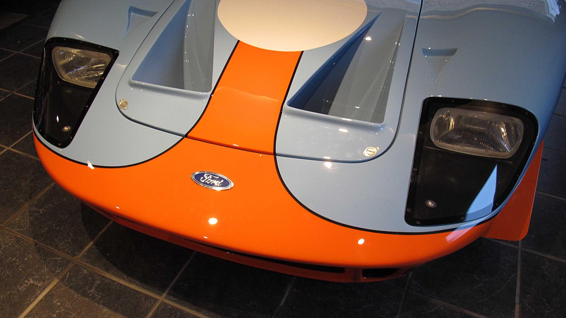

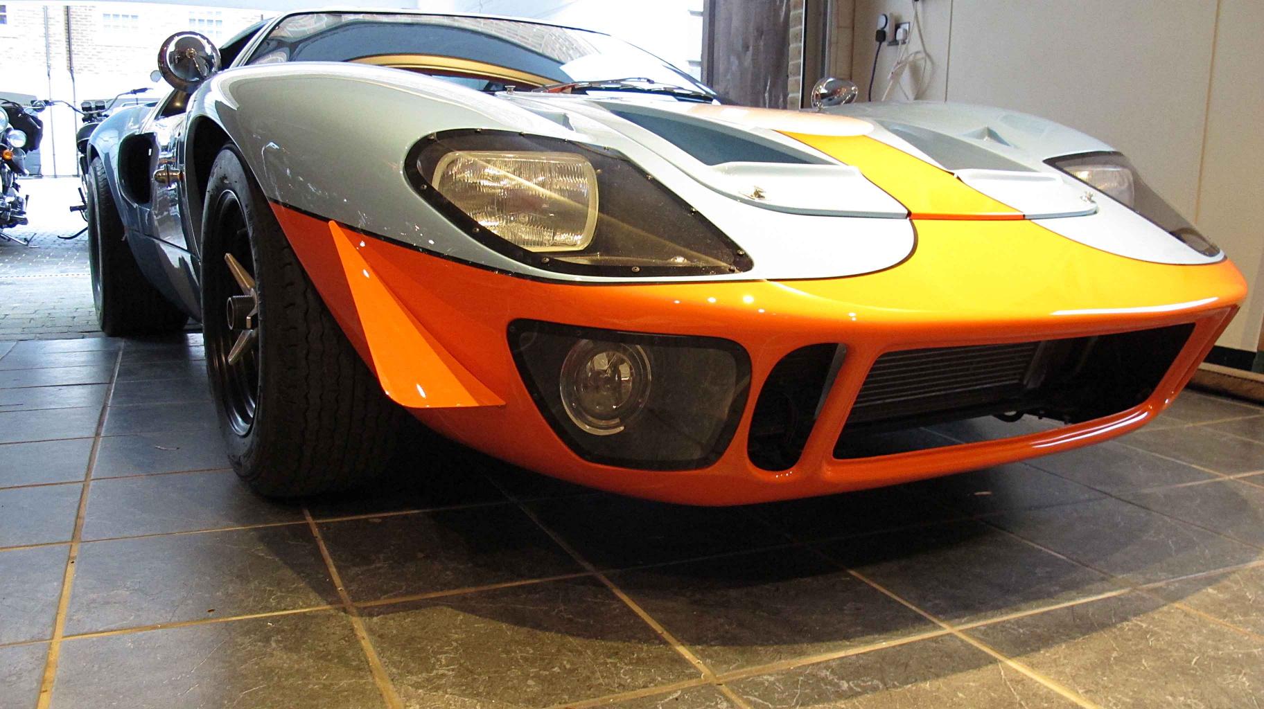

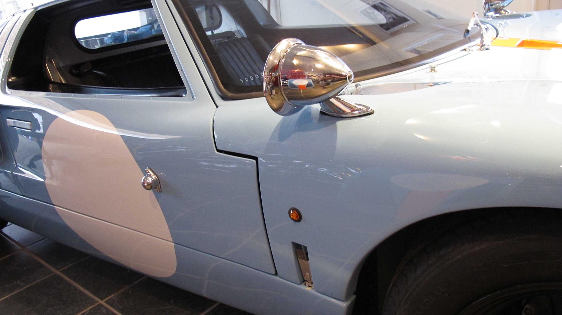

Fitted the canard wings, spot light surounds and of course a Ford badge today.
For some reason my central locking is having a funny 5 minutes, so will need to sort that.

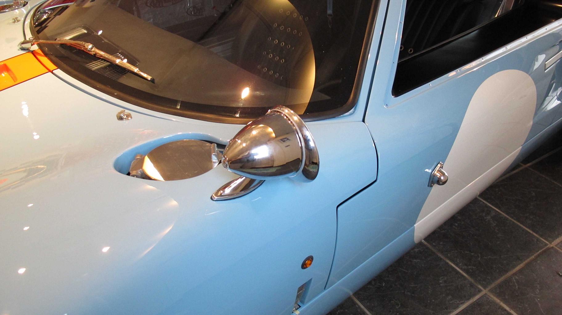

indeed a very nice build and great looks with al those details and extra lamps etc, that filler cap hole was before it went to the painter ok I guess? maybe the pipe/neck needs a bit adjustment so that it fits nicely in the hole again?
those canard wings are also well in proportions? or how you say that :D I mean they look very good in the right shape.
I also see some little space in the down in the corners of the window seal? do you fill that up some way?
Hi Rene, well spotted there is a section of the windscreens that takes a different profile to the screen, this was the same with my 1st gtd. I will have to fill the small gap with a blob of sikaflex, when dry it probably won't show.
Also when they removed the screen rubber it did not go back correctly so I will re seal it later. Although the body shop did a good job they put some wiring back wrong.

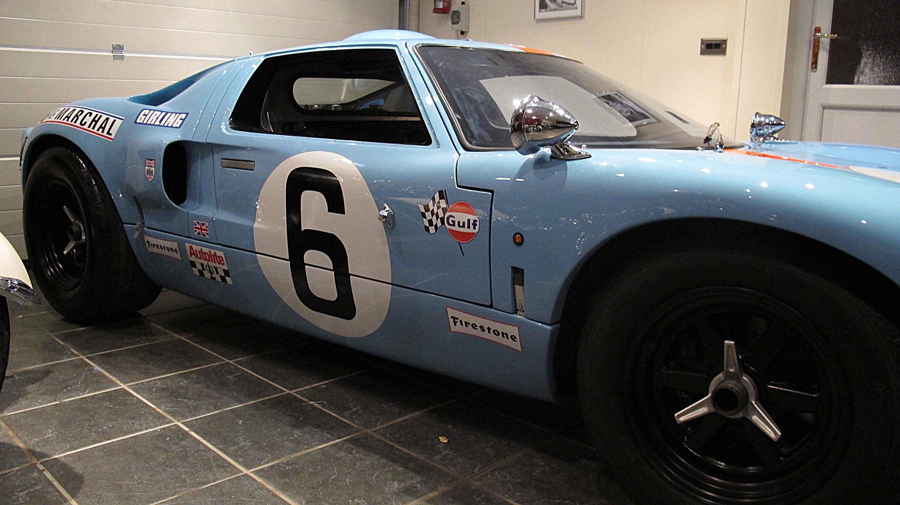

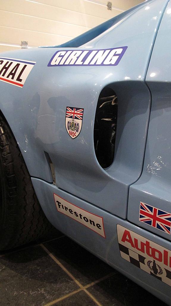

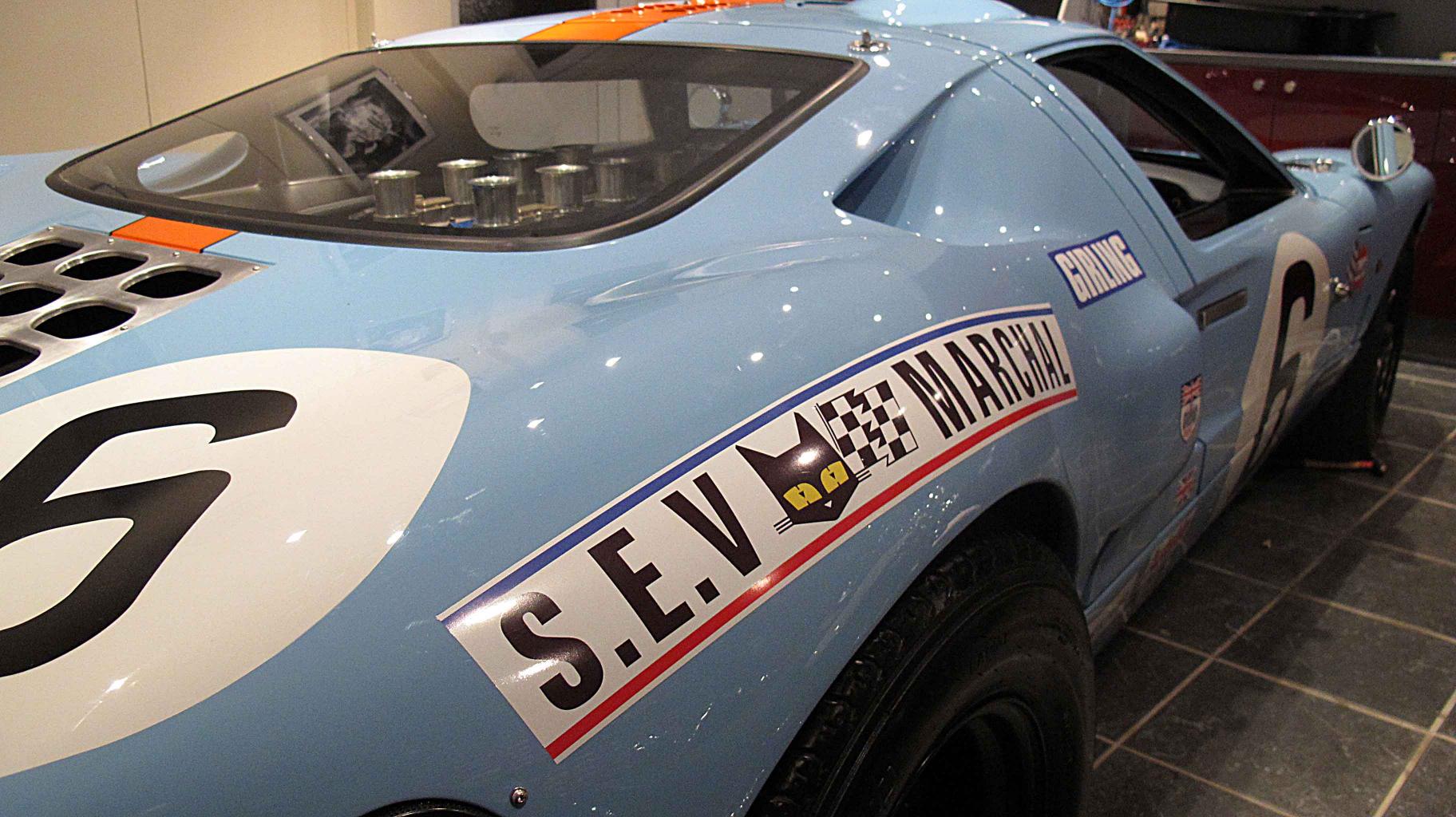

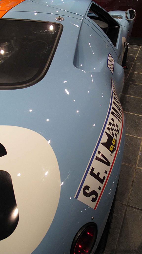

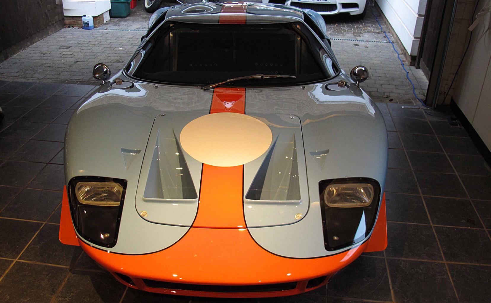

Fitted some of the vynils today.
Buggered up one of the SEV Marchal and a nose cone number 6, the rest were ok.
I was missing two of the KONI ones from Raceline digital but wont fit them anyway.

Hi Keith,
Nice job mate. Were the decals a pain to apply or not too bad ?
I'll be in the same position as you in a couple of months time and don't know whether to tackle the job myself or not. I'm going to get the stripes done by an experienced pro as there are some areas that need stretching but the roundals and decals I might tackle myself.
Cheers,
Martin
Hi Martin, decals were ok but the bigger ones are the hardest , any creases that can happen are virtually impossible to rectify. You don't need to be an expert but you have to plan it out correctly first and I pre marked the positions with masking tape.
I messed up one of the sev and a no.6. Race lines sev vinyls are bowed and look good. You may bugger one up but it's only a bit of vinyl.

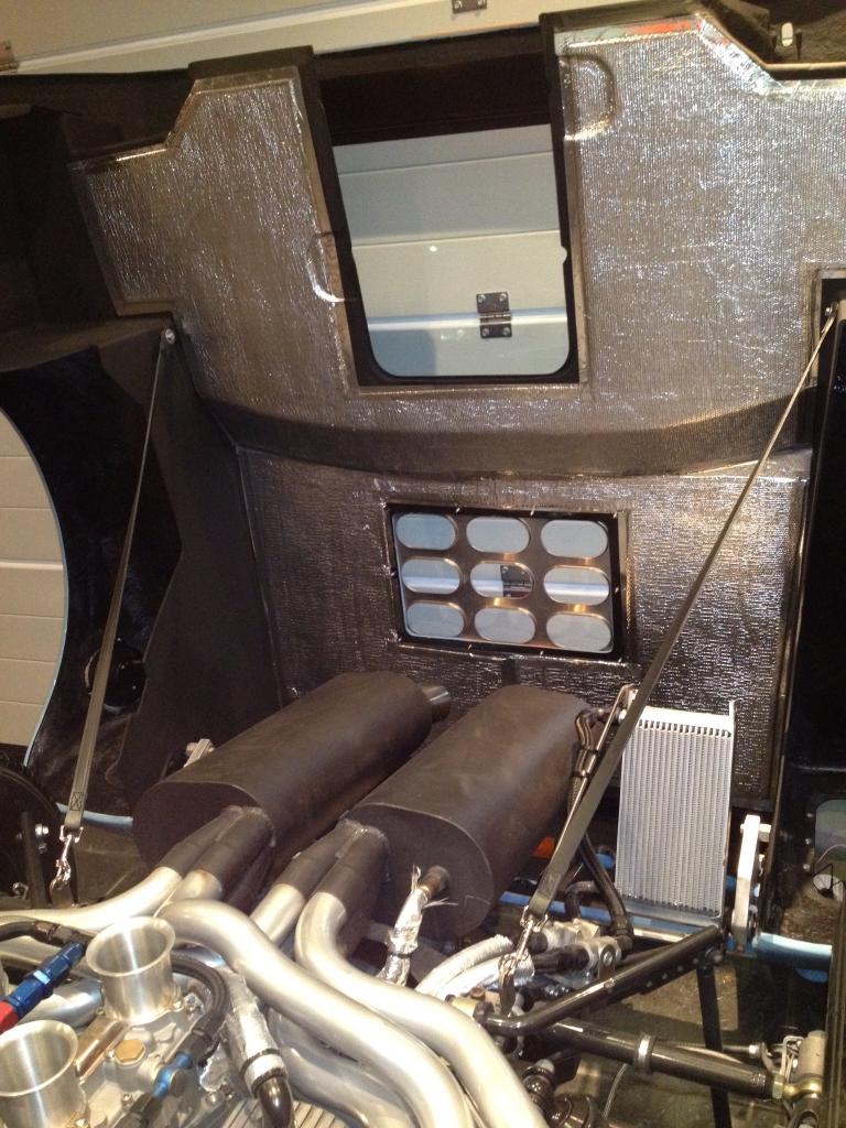

Fitted the heat protection to the rear canopy and trimmed up a few edges, the spider needed a bit of a trim but the rear canopy sits flush and the trim finishes it off nicely.had a problem with the headlamps not working, it ended up being a wire connection under the dash. The indicators didn't work after it came back from paint, that ended up being a faulty flasher relay.
As I have now 4 LED and 2 bulb rear lamps I fitted an electronic flasher relay of the correct wattage. It now flashes all at the correct time intervals. Painting all the canopy panels is quite time consuming, this was done in a matt black, same as I have used on other cars, not having a shine to it looks better in my opinion.
