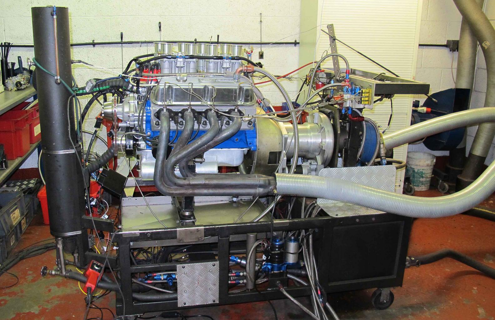

Engine dyno'd today a little bit of communication problem with the Accel program but all sorted and runs well.
Produces 452 H.P. @6500 RPM & 386 Torque @ 4900 RPM.
That will do for me ' Dont want to be greedy '

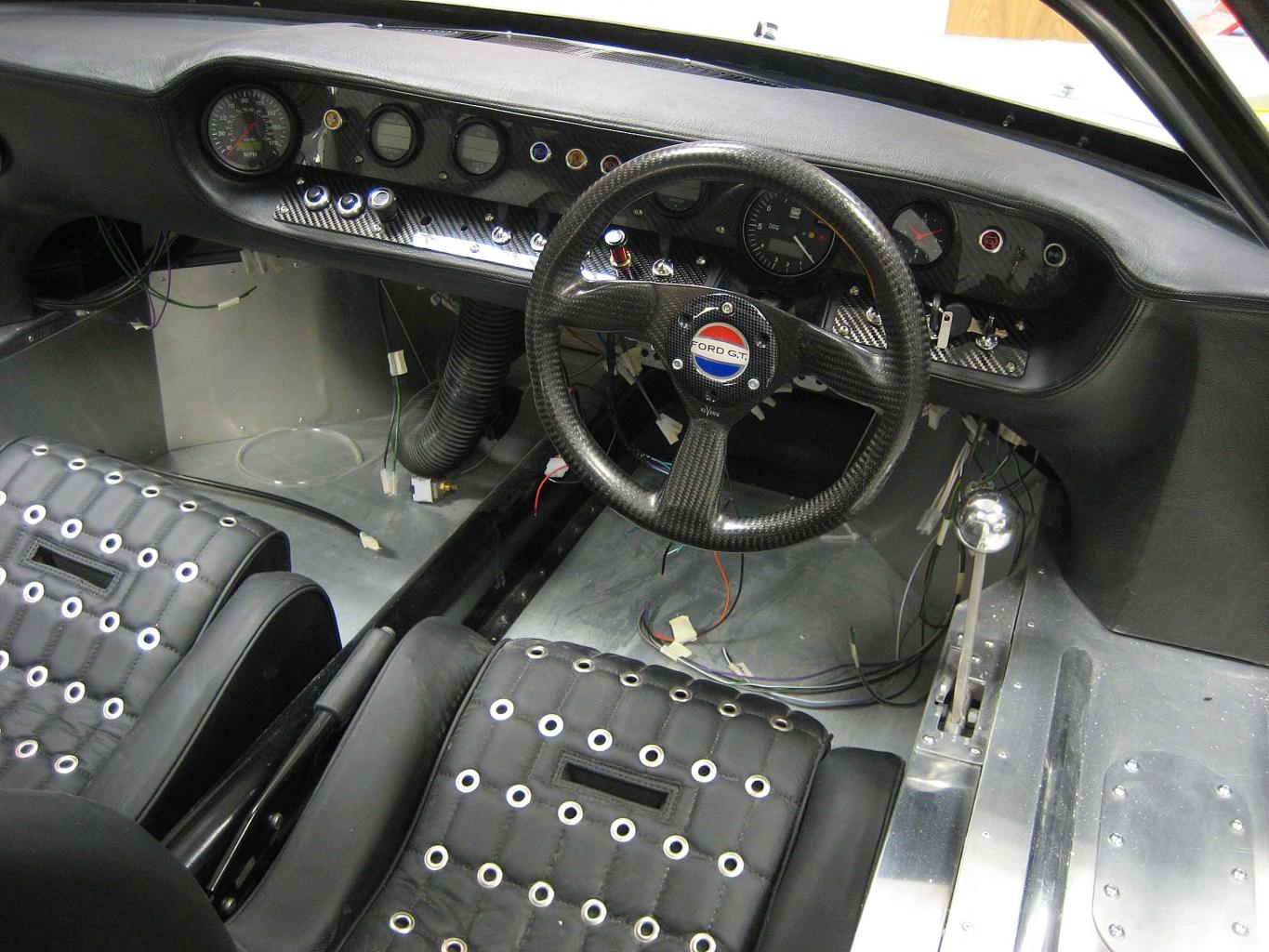

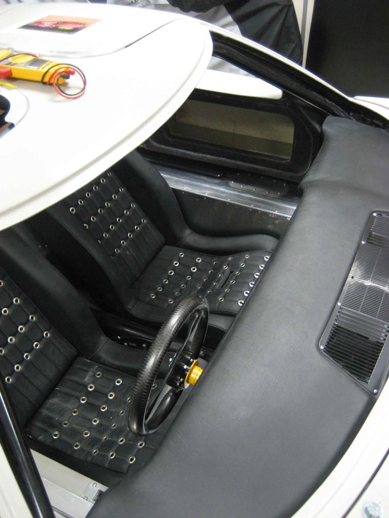

Anyway I put the dash in for yet another trial fit.

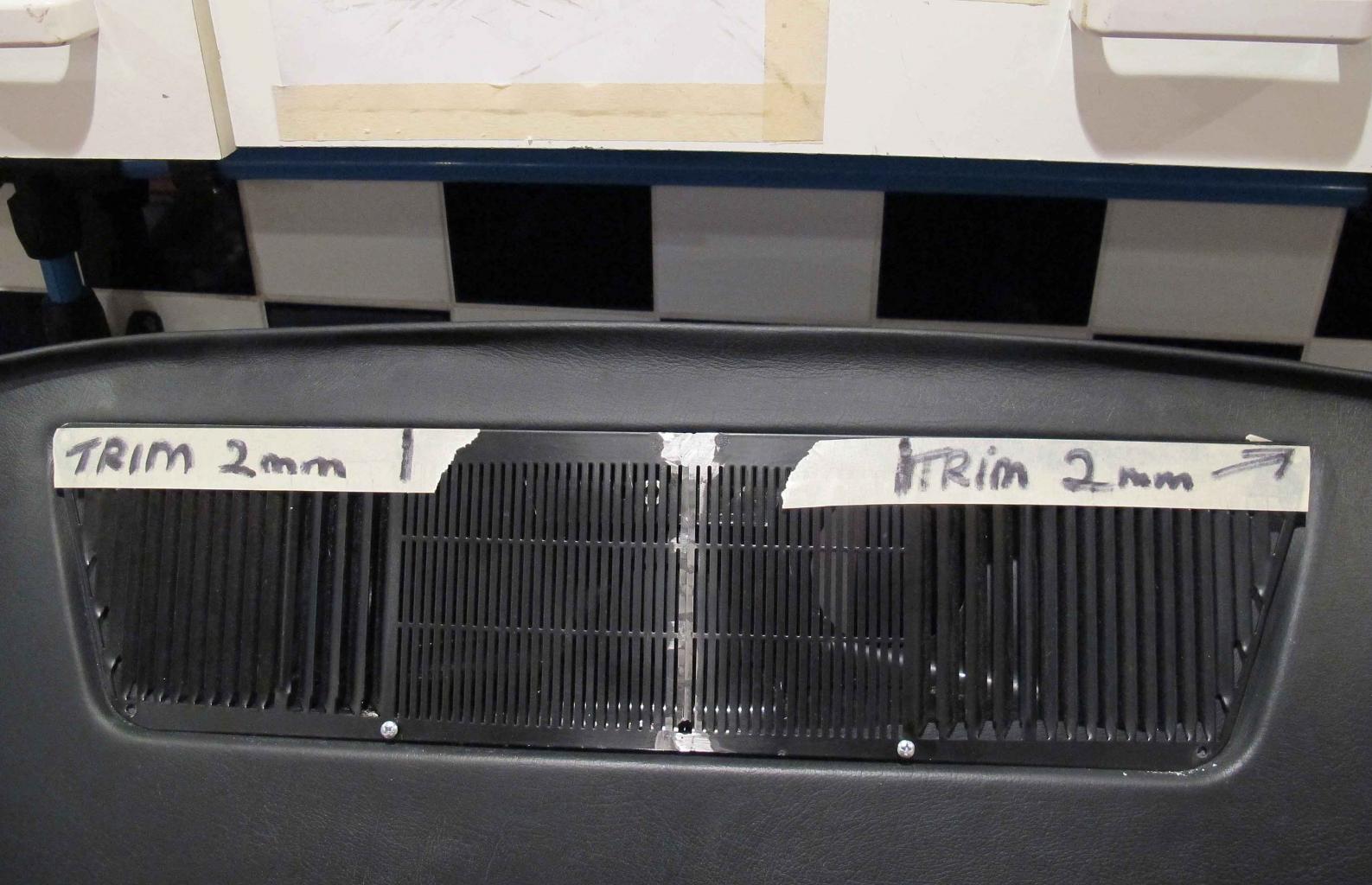

I wanted to make sure that the dash is totally removable when the screen is fitted. There are cut out sections to miss the cage but I dont think I'll cover them, they will hardly notice.
As the air con unit had to be mounted length ways instead of side ways only one air con duct was allowed for towards the screen. BUT the IVA test is a piece of paper against the screen and if there's not enough air flow to clear the screen it fails, so I'm cutting a second vent in.
As I have fitted digital duel gauges instead of Smiths I need to alter the wiring as they run off sensors.

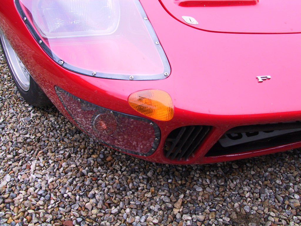

I have been asked about the headlights and how I'm going to fit them. Well I dont know is the answer, but I know a man who does.
I have been told the lights I have are hard to get now, Valeo Cibies.
The frame supplied by SGT has all the adjustments but it aint going in the body without some modifications and fibreglass bonding. I know a man who knows how to do this job as well as a few other little jobs that need to be IVA compliant.The side lights will be cut into the headlight shell.
For IVA the indicators need to be seen from a pre determined angle therefore a small indicator lamp will be mounted within the headlight cut out then later replaced with a smaller white indicator with amber bulb. The lower cut out for indicator and sidelight will now become a larger round driving lamp.

Hi Frank, That looks like it would be ok for the IVA neatly done but it looks a little bit un GT40 ish.
I have seen a couple of 40 's with the set up I like If I can get a picture of what would pass IVA and be descrete at the same time I post it.

Collected the engine today, Yahoooooo !
Although the engine had been run and tested a week ago, Pete put the engine back on the dyno and had it ready for testing for me to see.
We gave it a couple of runs up to 6600 rpm but Pete says it will run all day @ 7000 and I believe him.
6500rpm gave 456.5 H.P. and 390.4 torque.
Sounded awesome.
Disconnected it, stuck in the the van and spent the next 3 hrs stuck on the motorway, but boy it was worth it.

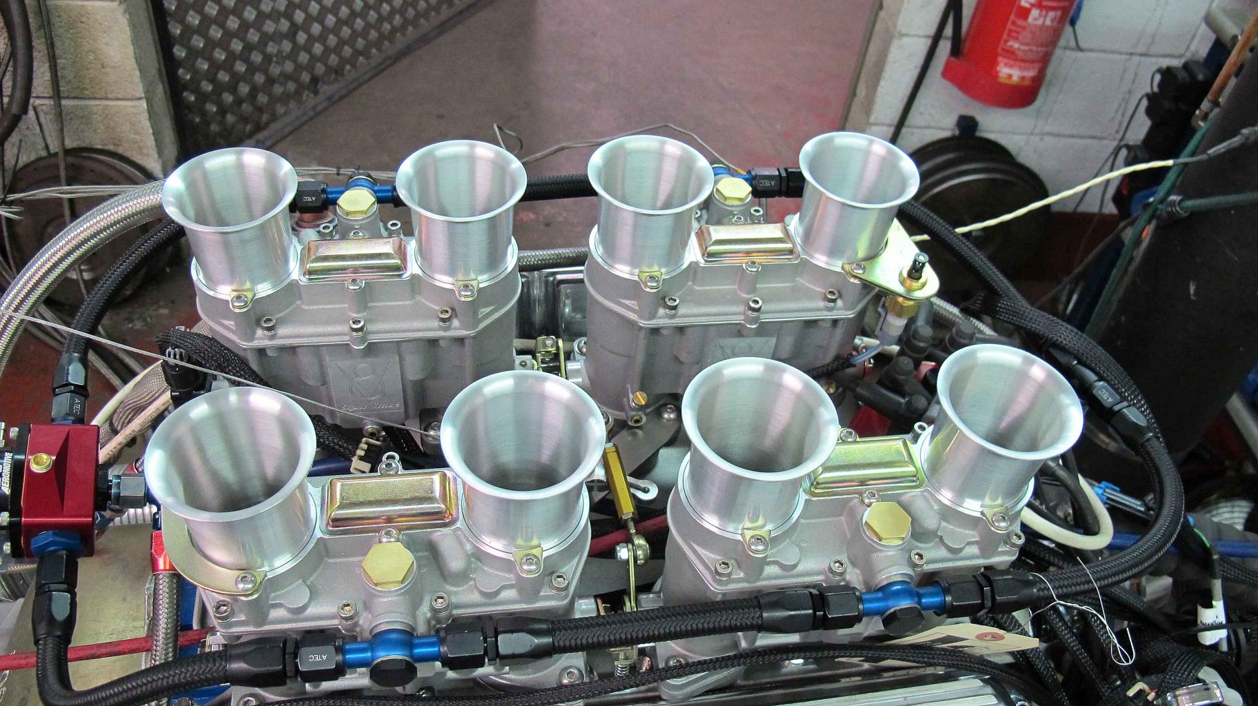

Hi Paul,
It's an Accel ( spelling may be wrong )
To be honest I saw this injection system at Southern GT and liked the idea and the look. They fitted it to a car or two and got good results, I think Glen Masons car has it.
There's a lot of loom that's not needed and Peter Knight seems to think it's a Mustang loom.
Mick at SGT says that he just cuts out the unwanted wiring so as to tidy the hole thing up. I'll let him do that or I'll cut the wrong bits off.
By all accounts it took a little setting up but fired up 1st Kick.

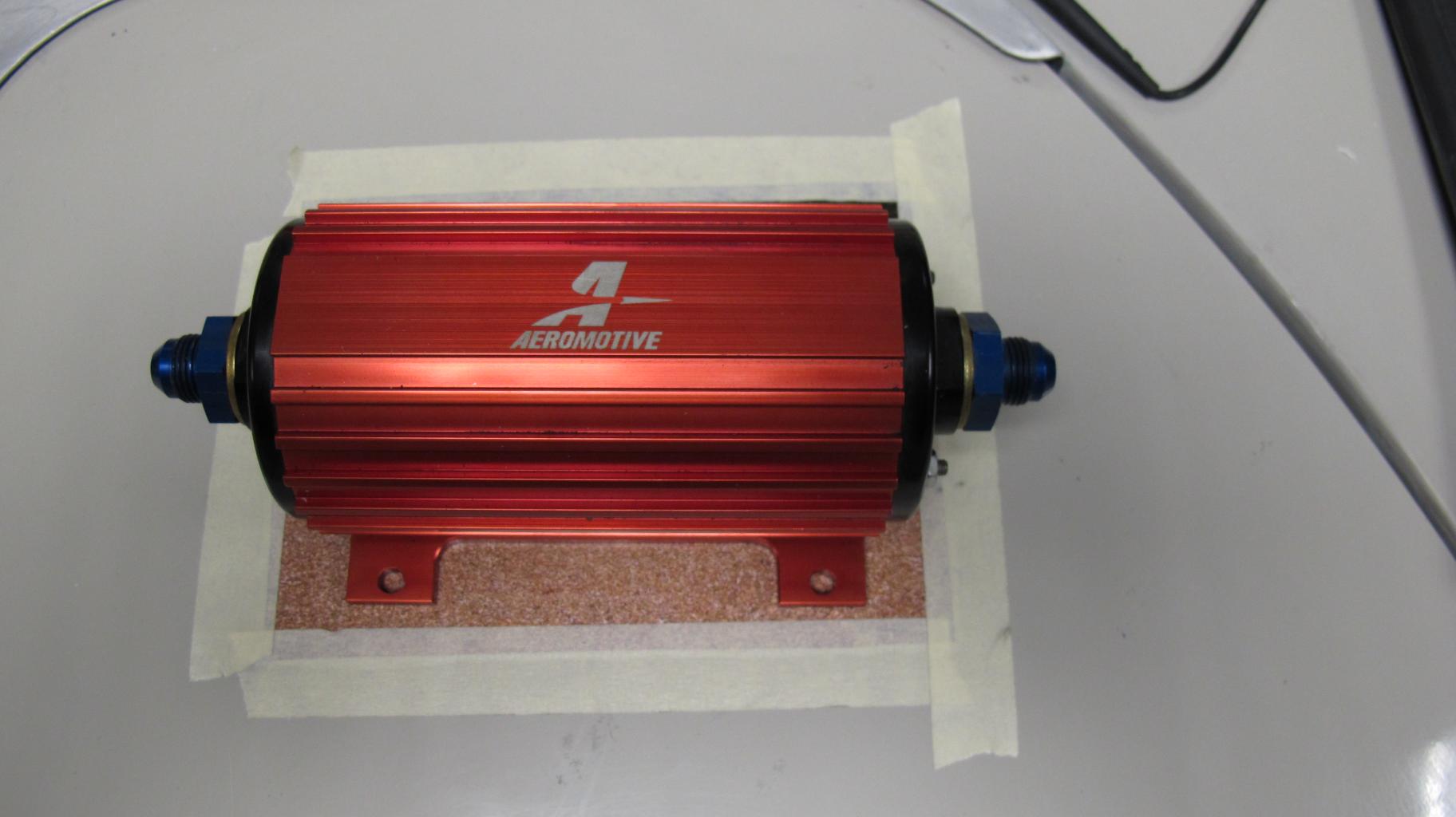

As part of the package Pete has supplied a single H.P. fuel pump of the rotary vane type, I was not sure if two H.P. pumps would have been better but Pete " is the man"
The alternator and brackets will be with me in a few days and visually the air con bracket and air con pump seem to align ok but will need to get another grooved pulley made up.
All looks and sounds good
Now looking at where to mount the high pressure pump.
QUESTION
Do you think this should be mounted on rubber for vibration ?
It didn't come with any mounts
