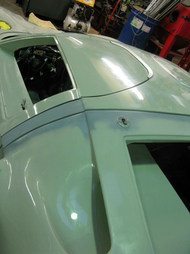

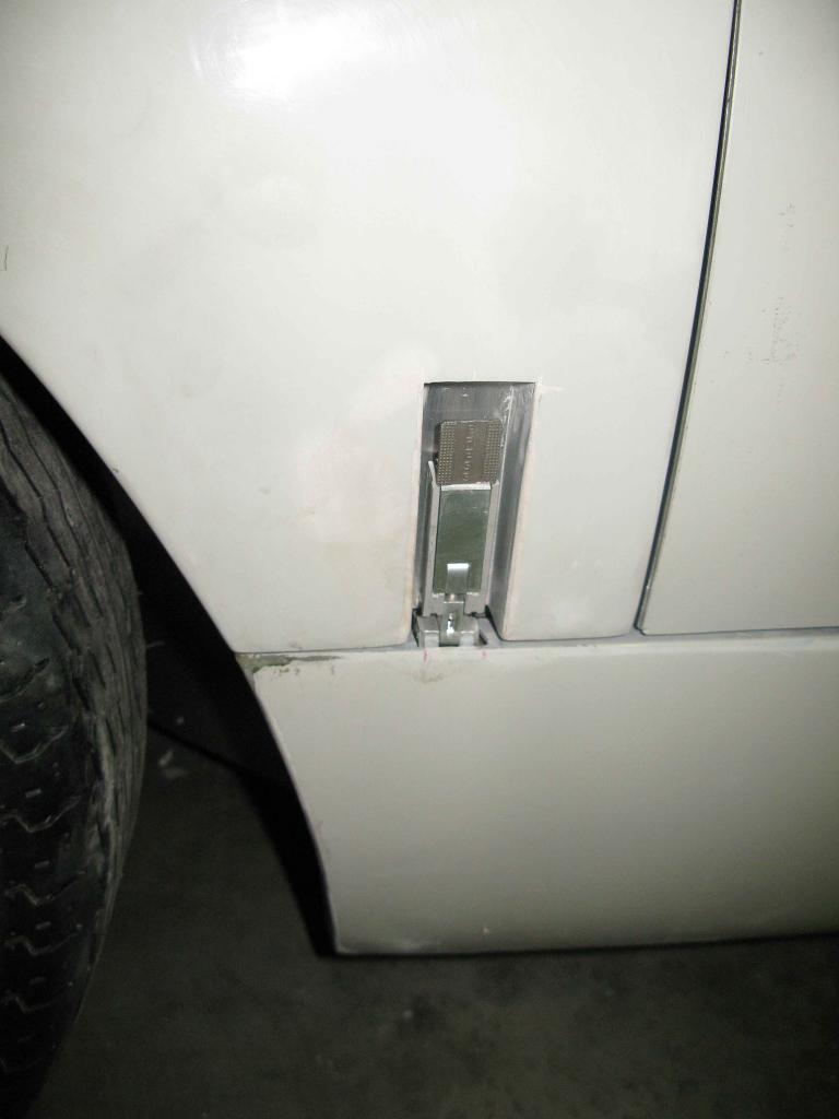

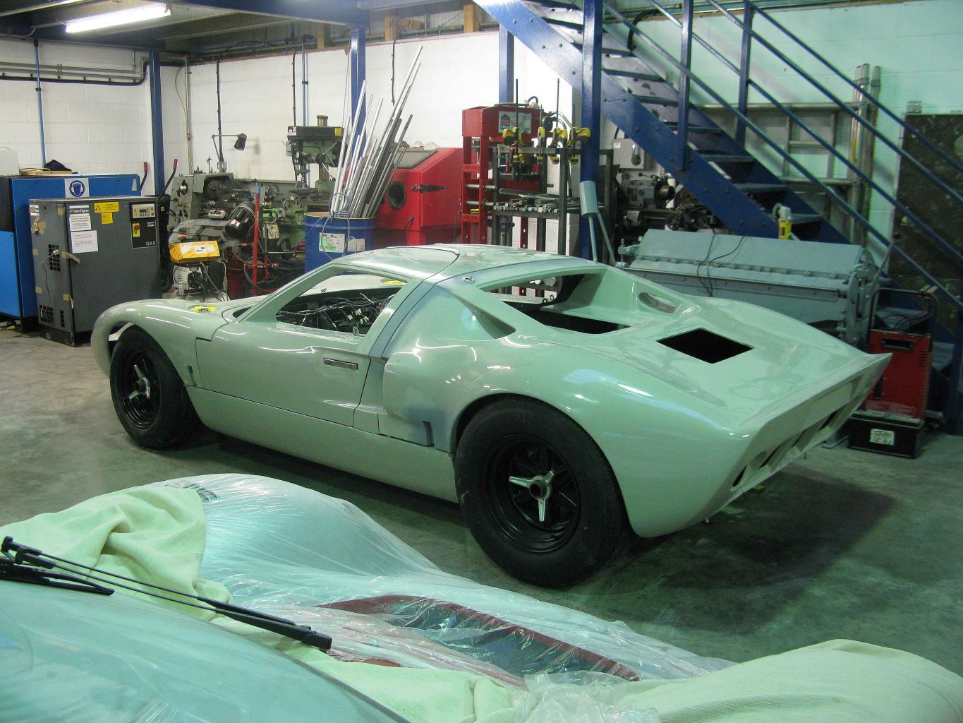

Few updated pictures.
Shows catches slots, shut lines and the car is now sitting on it's wheels.
No I haven't had the car painted linden green it's the overhead lights in my workshop causing the colour cast.
The last picture shows the recently modified cill that was 12mm too long. Now it's not

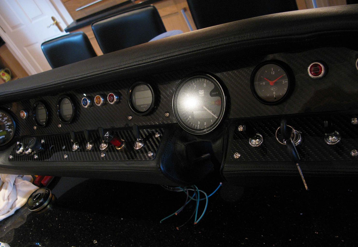

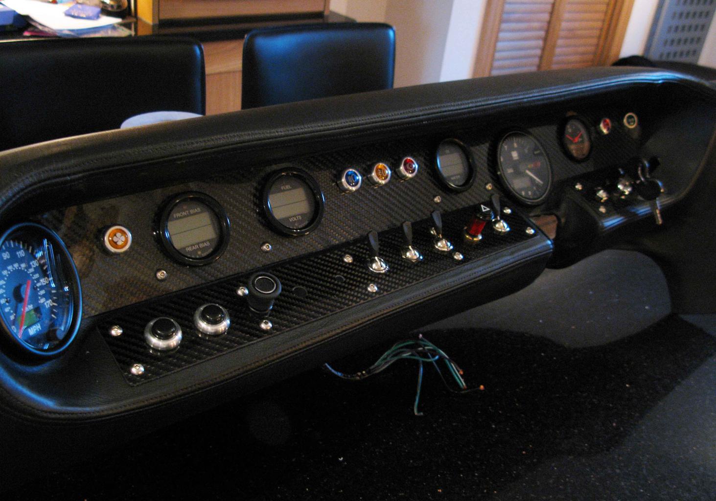

After taking into consideration the IVA test I decided to modify the dash to allow for the switches to be in the 127mm range of the steering wheel and IVA compliant buttons and air con switches outside of this area. Hopefully based on information given this would mean not having to move switches later.
Also I forgot one switch that needed to be fitted, therefore I decided to fit two 2mm thick carbon dash inserts, one either side of the steering wheeel with the correct amount of switches cut in and a spare switch hole for any future items I may install.
Fiddly job cutting the dash and the leather stuck to it but a small hand saw that fits into a stanley knife did the job a treat.
The plan is to pre wire all the sensors in and put some power to the dash before it's put in the car. Like a Pre Test.
Not great pictures, but it gives you an idea.

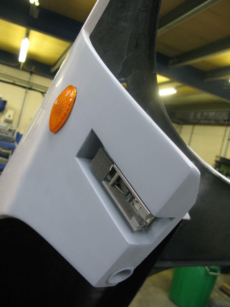

Gurney bump arrived today, got the measurements for its fitting but I'm not sure about them, so I will take some measurements and fit it in a couple of days. Finally fitted the body catches, they work well.

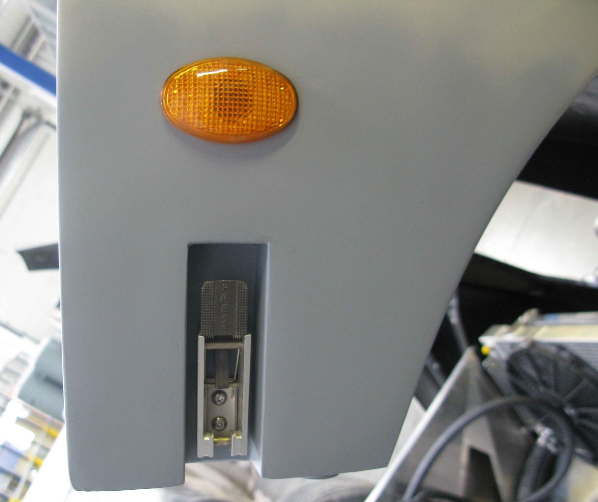

Fitted the IVA compliant side repeater indicators.

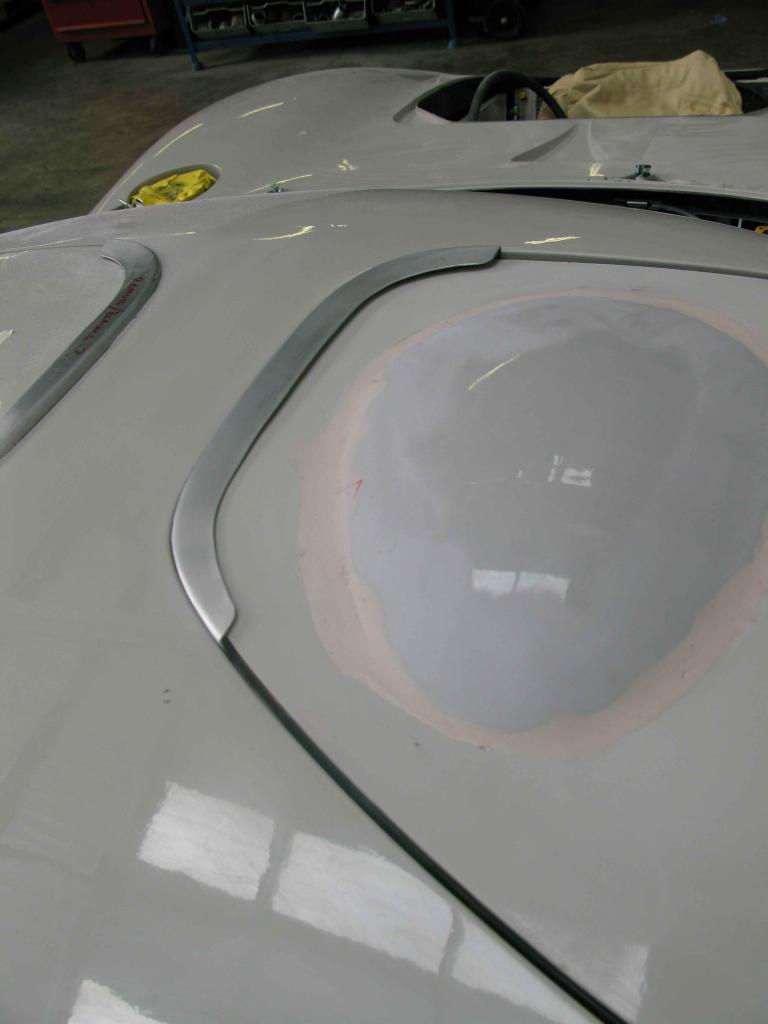

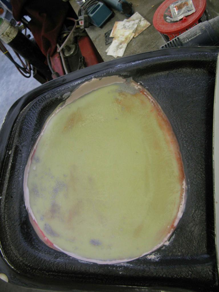

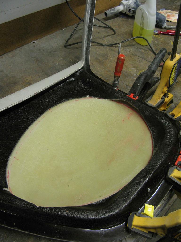

The Gurney bump has arrived, no it's not a decease I have.
It looks rather large to fit in a hole that small.. excuse the pun.

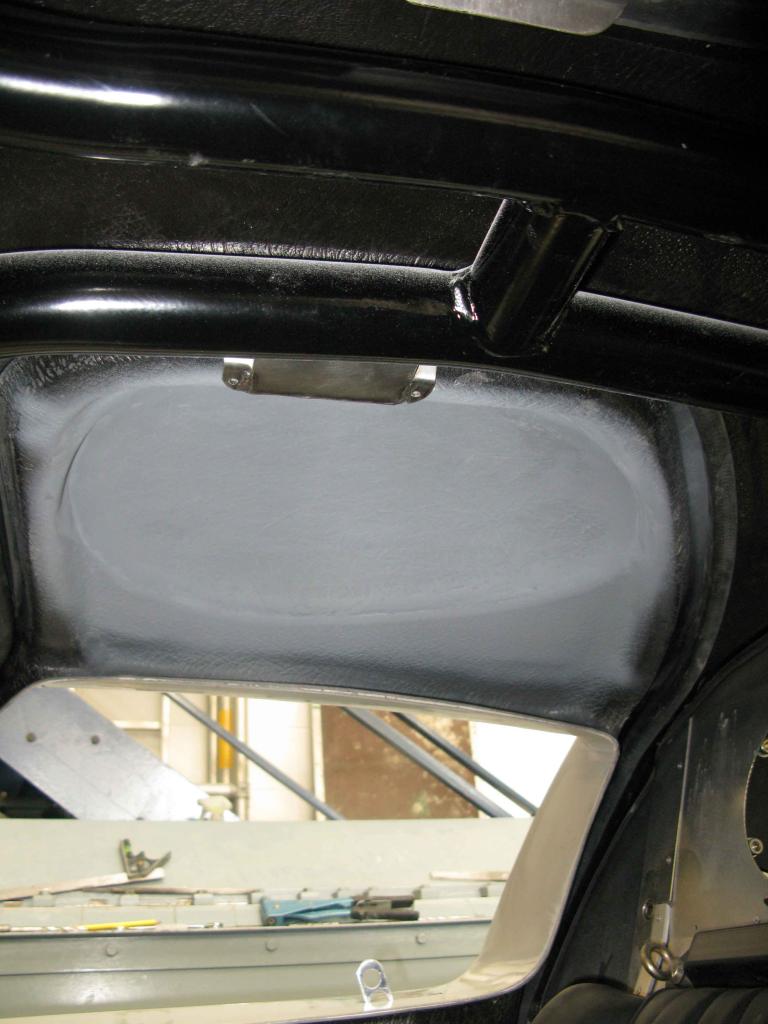

I marked the bump onto the door top and then marked 20mm in from that.
Drilled a 10mm hole and set to the shape with a jigsaw, cutting through both layers of the door.
Once cut you can see between the two layers and you can prise the layers apart with a screwdriver.
The bump with and push and a shove goes between the layers.

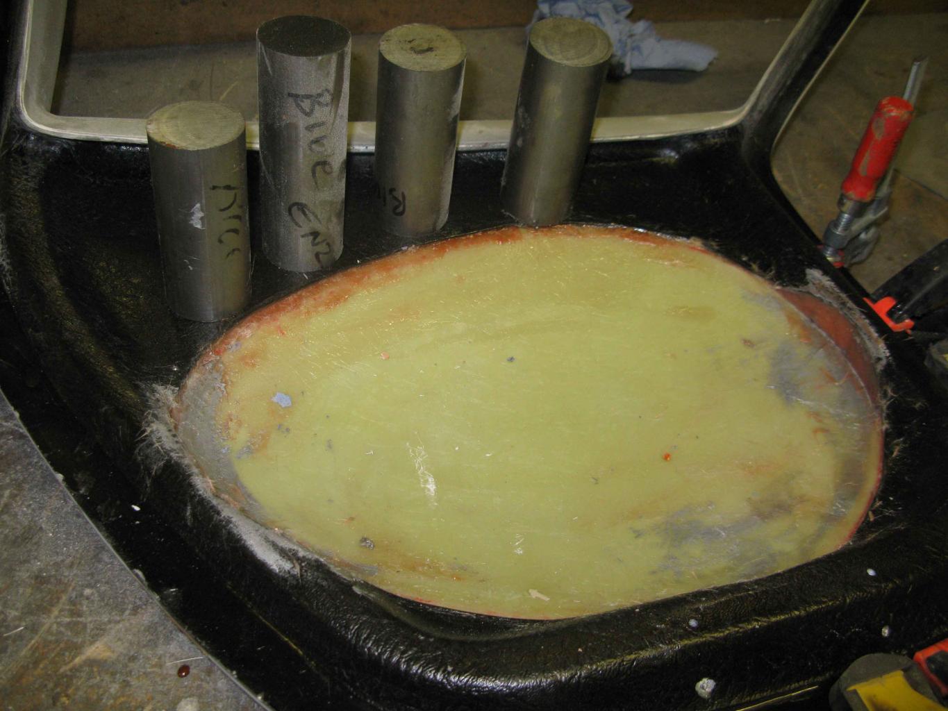

Prior to alignment I scored the 20mm edge with a grinder and 40 grade paper to give a good bond with the fibreglass.
With the doors I have you need to cut into the stiffener ribs on the edges. I packed these with fibreglass matting and the bump was sandwiched between the layers with fibreglass matting and resin.
This was clamped until solid.
The edges inside were sanded down and finished off with P38 filler,
the outside was scored and again resin, matting and filler used.
All this is only rough finish with a DA sander, prior to the bodyshop.
The only problem I had was that all this cutting twisted the door top about 6mm and I need to straighten it.
The pictures look like I'm repairing a toilet seat, perhaps
it's a S..T job

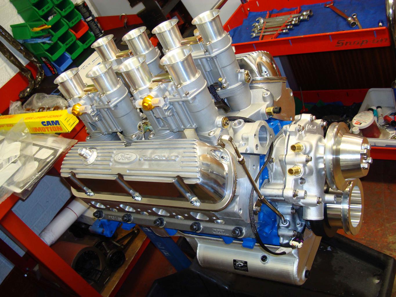

Also 1st picture of my new engine. The Injection system was held up at customs / Fed Ex.
It's on the move, should be about a week or so.

Finished off the catches today, the next time there touched will be by the bodyshop hopefully. Side repeater indicators fitted in the position that a car recently passed the IVA , 170mm from the bottom of the deck and central to the catch.

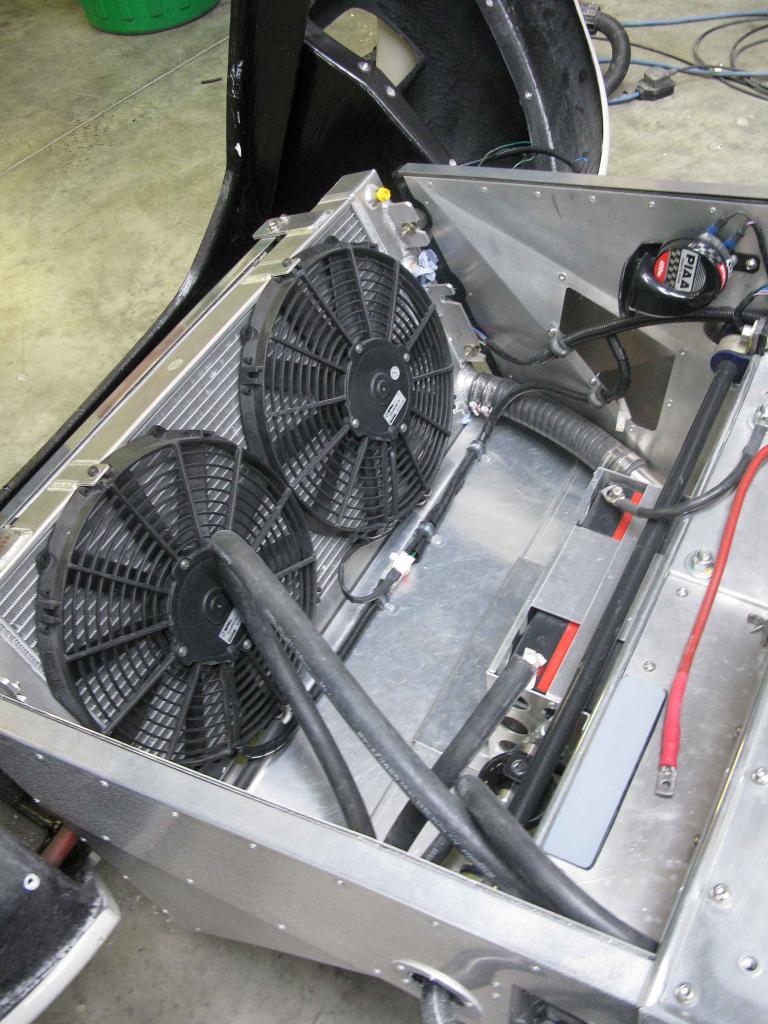

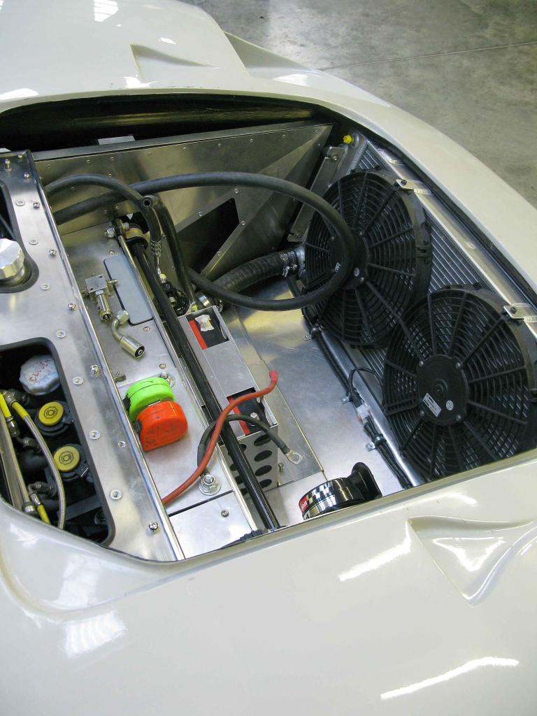

Wired in the fans and put some power on them to test, all ok.
Bonded the front deck loom in place and made sure all the wiring goes to where it should do.

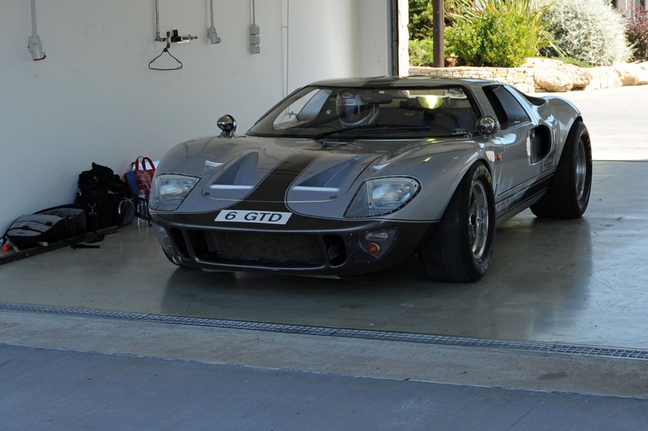

Sometimes you need a little reminder of what's coming.
I was looking through some old pictures and came across the 1st GTD I built back in 1999 this was about a month after it was finished.
Still going strong, upgraded of course and now down at the Ascari circuit in Spain.
Regret selling it. " Of course " but the SGT will be better
Yes, the old girls still going well, I will be seeing her again this weekend, Frank
