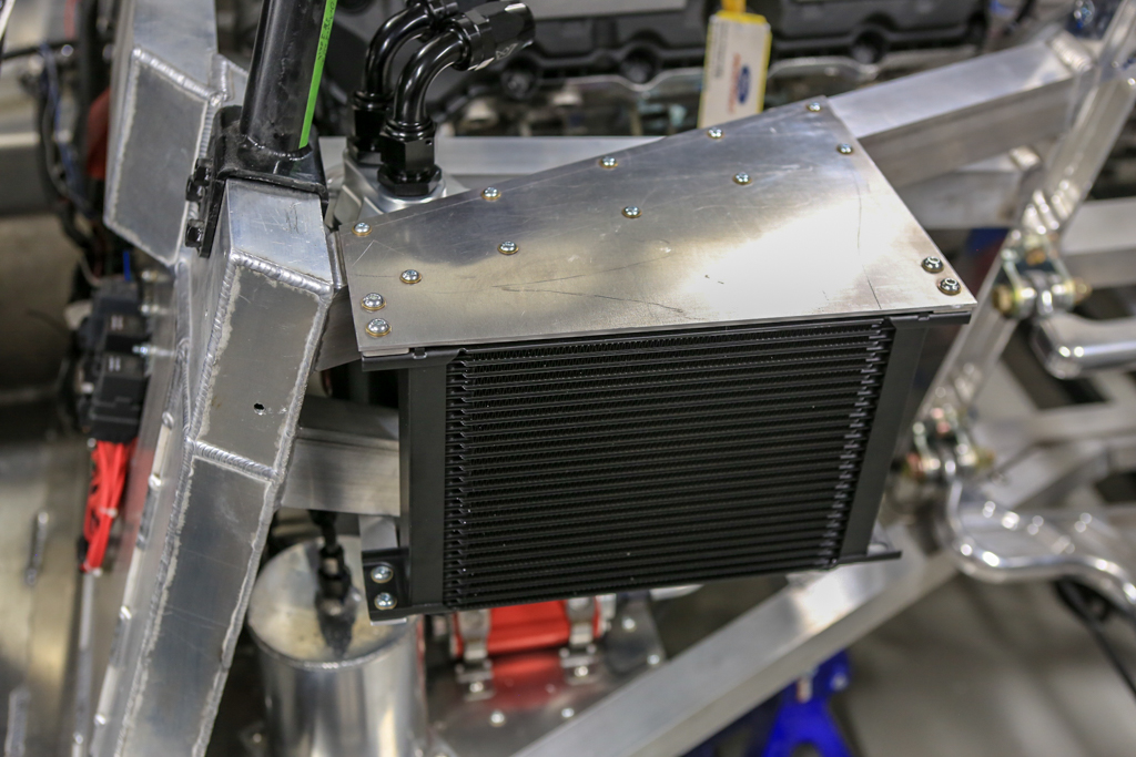

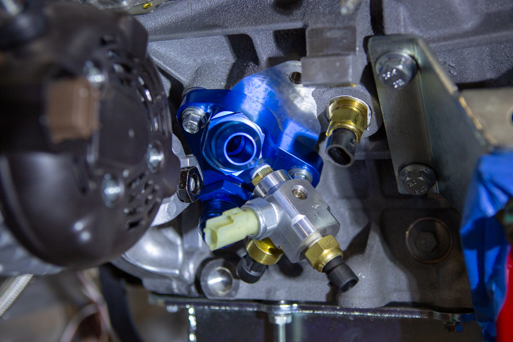

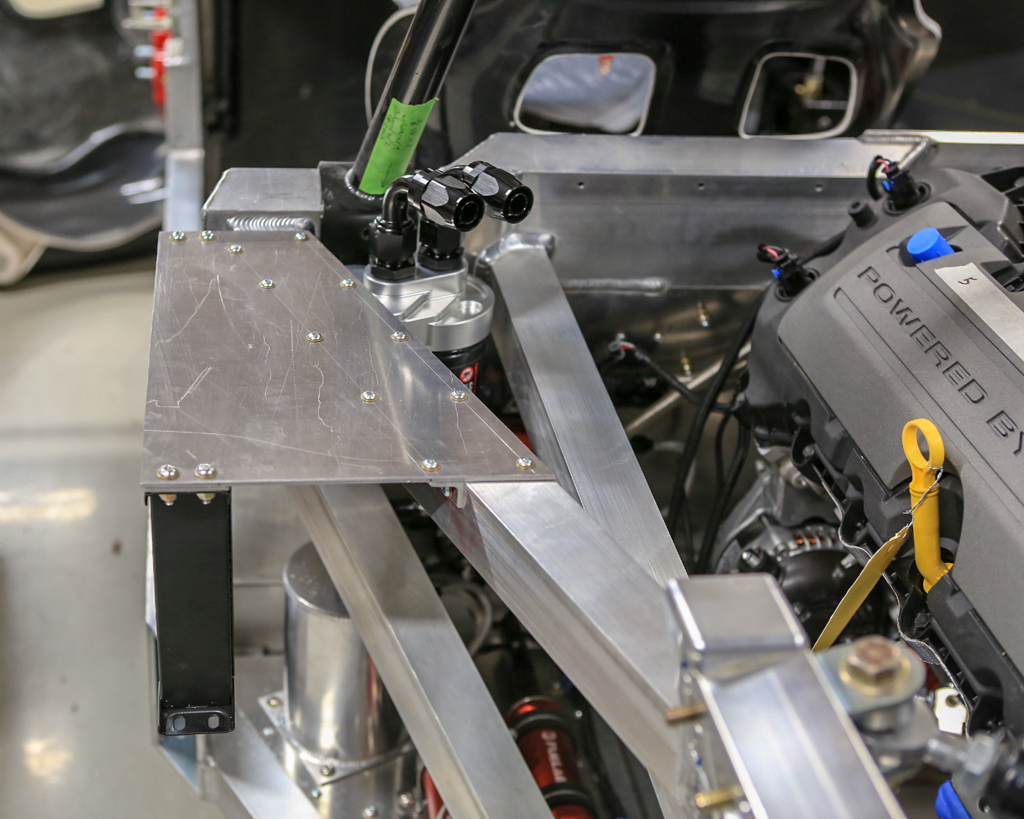

Due to Dean’s unfortunate engine oiling issues, I decided to remove the stock coolant/oil heat exchanger and install the Ford Performance remote oil cooler adapter (P/N M-6881-M50A) and a Setrab series 6 cooler and Hamburger’s 3347 remote oil filter (all with -12 AN fittings). The oil cooler aligns well with the side scoop.
I will add the oil lines after the exhaust system has been built.

I know this isn’t the same engine, wondering if you can expand on your decision on not using the stock oil to water cooler for the engine. I am putting an LT4 in an SLC and was planning on using the stock water to oil cooler but just curious about your decision.
Kurtiss
Member
Hi Joel,
My decision was based on Ford Performance’s oil flow requirement. In 2015, Ford Performance changed their engine oil line size recommendation on the Coyote engines from a -10 to -12. As you know, a -12 (3/4”) oil line is BIG.
Dean’s engine seized after a dyno run and Ford said it was due to lack of oil flow. I purchased a 2017 Coyote Aluminator crate engine. After I removed the stock oil filter, cooler and adapter, I noticed the oil passages in the adapter assembly were small or restrictive due to poor machining. That’s when I decided to go with a remote oil cooler and filter.
I’m not familiar with the LT4 and the stock oil cooler may work just fine.
Hope this helps,
Kurtiss

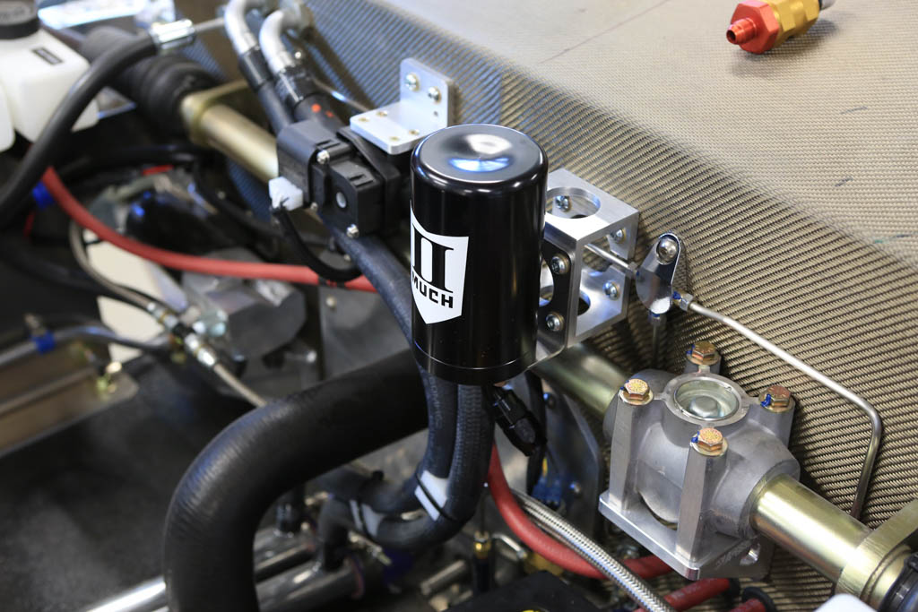

What’s that smell?

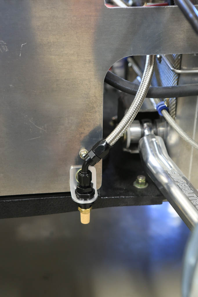

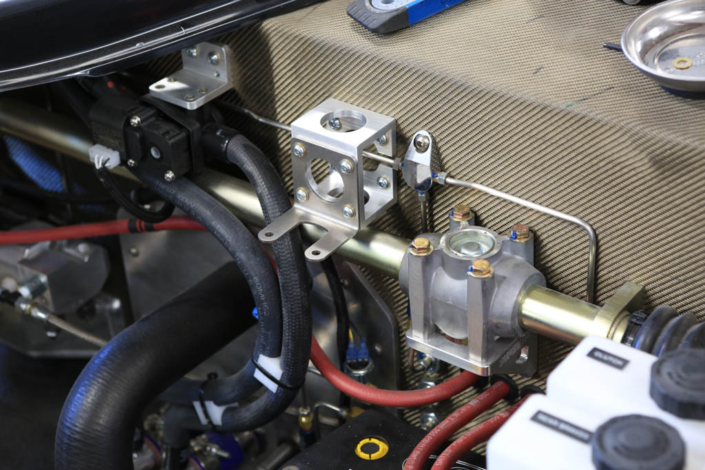

To capture the fuel vapors and add a layer of safety I installed a JAZ Products external fuel tip-over valve, a II MUCH VSR fuel vent and a II MUCH bulkhead fitting with a sintered bronze vent filter at the bottom of the vehicle. I machined a bracket so the II Much VSR fuel vent would clear the rack & pinion assembly. Note: I may need to relocate the vent filter when I install the wheel wells – stay tuned.

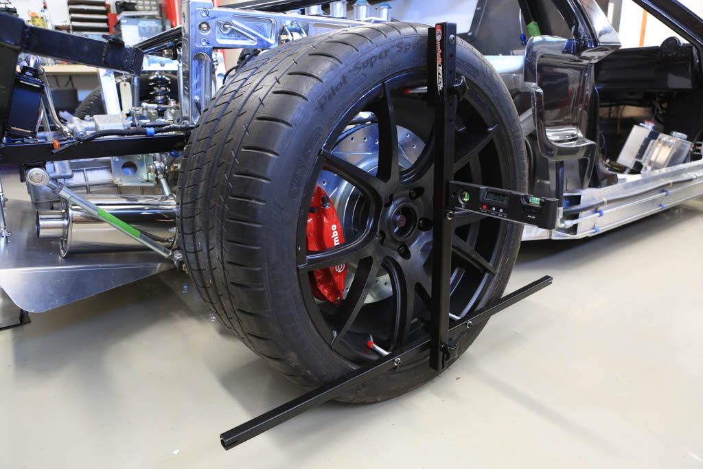

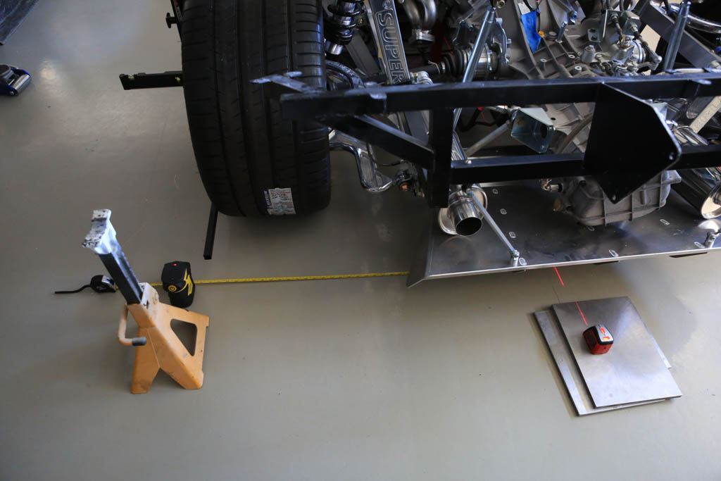

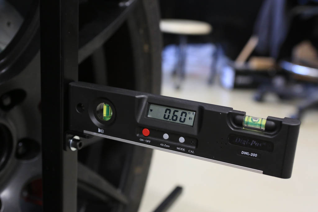

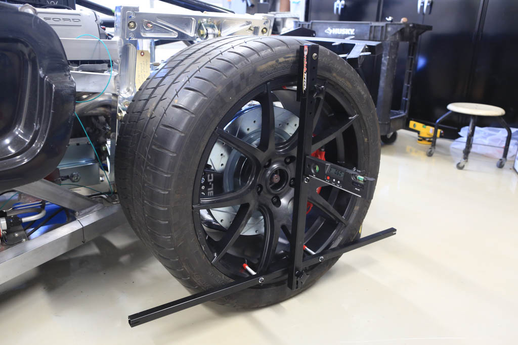

Wheel alignment – after adjusting the shocks to give a good ride height I used the string method to set the toe-in and QuickTrick alignment tools to set the castor and camber. I adjusted the height with a 4” clearance from the chassis to the ground at the front A-arm and set a 5” clearance at the rear A-arm then adjusted the rear camber and toe-in. In the front, a few modifications were necessary. The front A-arm upper Heim joints were replaced with QA1 PCYMR10T (High Misalign Chromoly Heim Joint Rod Ends 5/8-18 RH Male) to achieve the proper thread engagement when all adjustments were made. Also, the steering rod ends were too short to achieve thread engagement when the toe-in is adjusted. RCR supplied new extended rod ends but each steering rod had to be shortened by ¾” to make them fit. This was a rough alignment and the final alignment will be done by a professional shop prior to taking it out on the road.

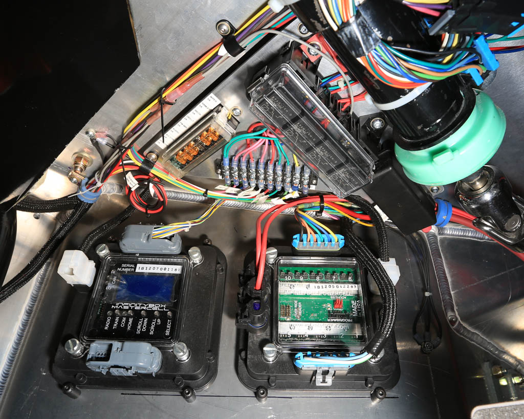

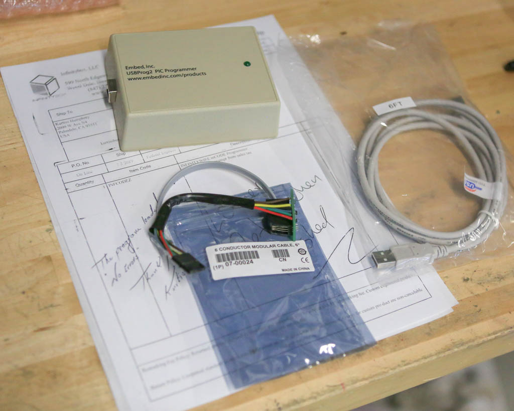

My desired changes to the electrical system programing was first mentioned in post #136. I sent the desired changes to Jay Harris of Infinity Box and within a few weeks he sent me the updated code and reprogramming box. It took 5 minutes to upload the new program. Easy-Peasy. Thank you Jay!

Hi Larry,

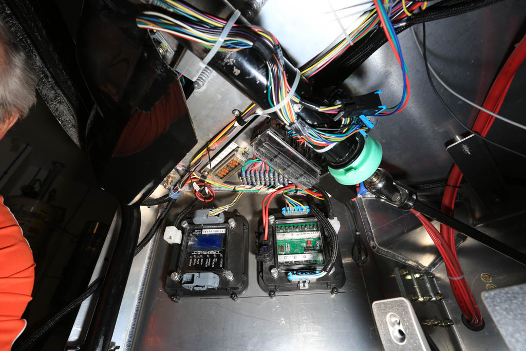

The Infinity Box system was part of the car purchase. There was an issue between RCR and Infinity Box but they worked it out and I received my electrical system a year and a half after I took possession of the car.
I like the Infinity Box concept, clean looking install and ease of troubleshooting but I felt limited on the number of circuits available. I could have added another power cell (10 more circuits) but opted to add a relay and fused circuits. I plan to do a "smoke check" soon (put power to it for the first time) and begin checking out the switch inputs and power outputs.
