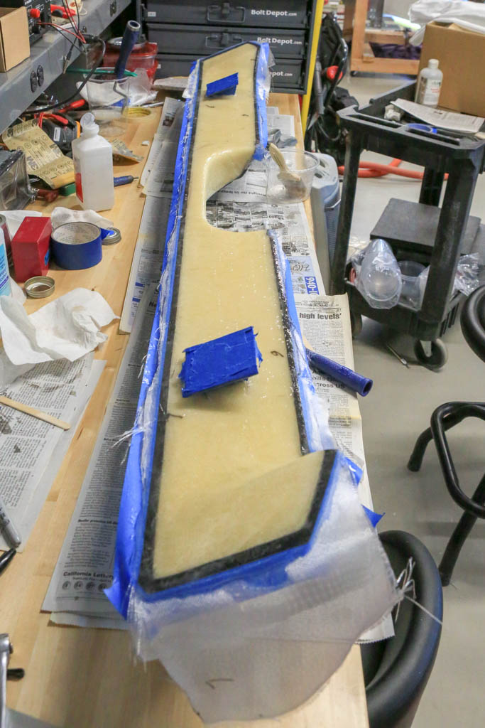

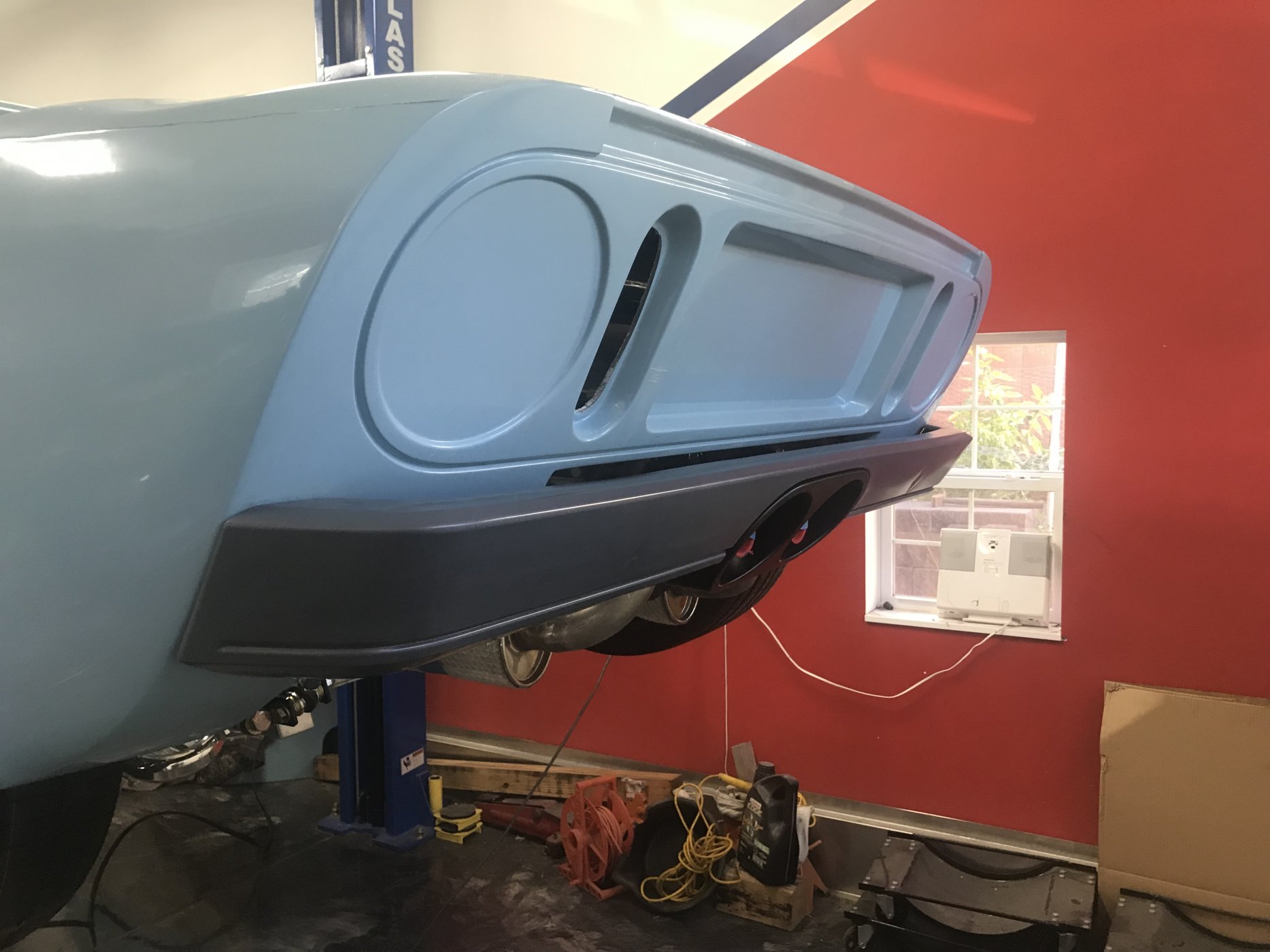

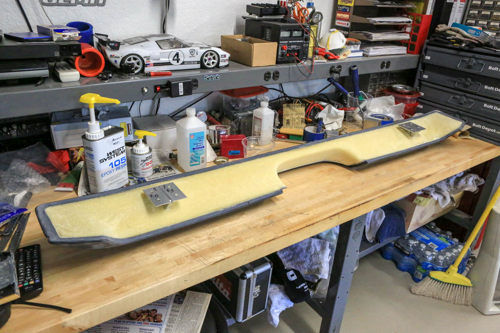

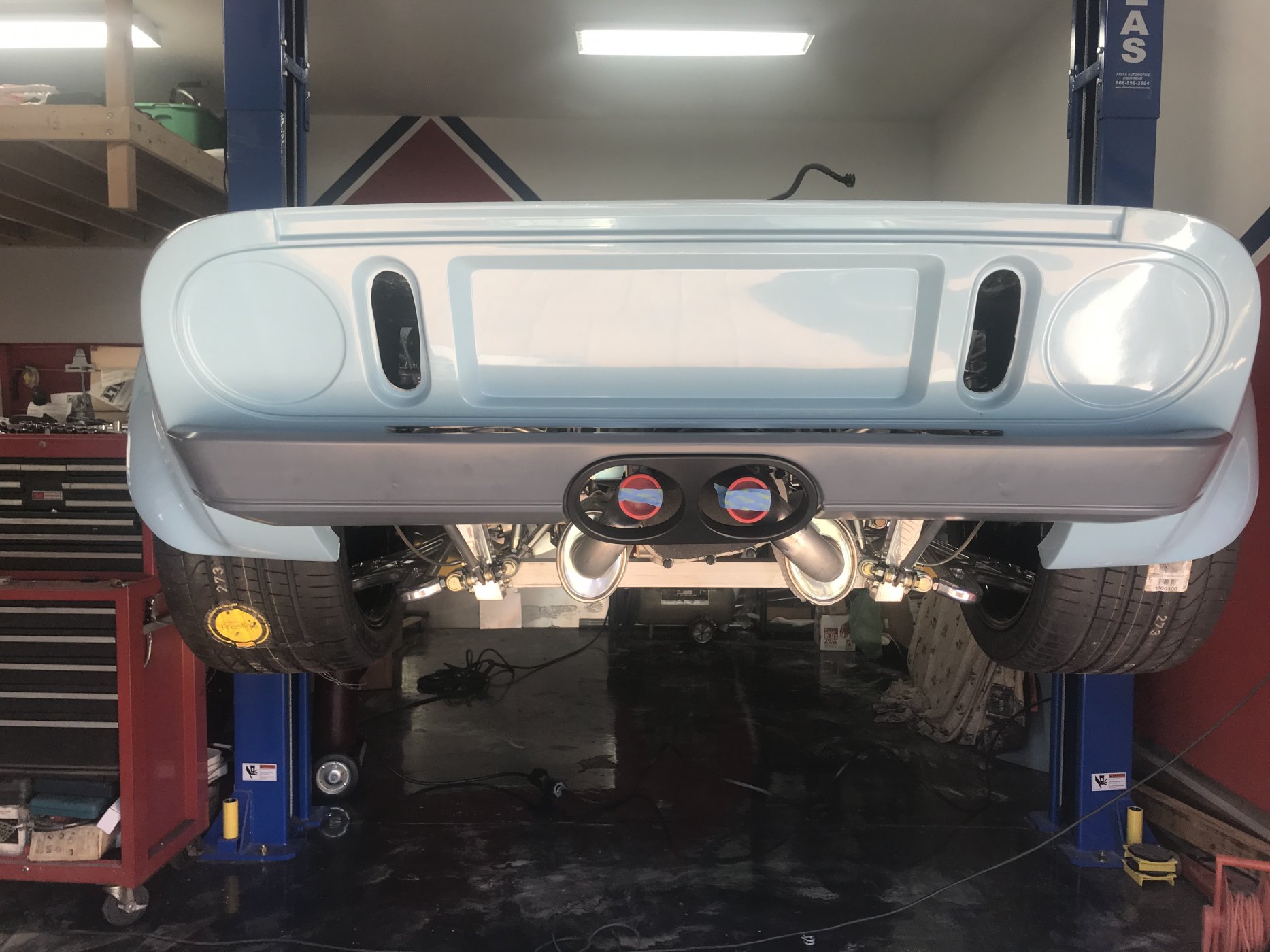

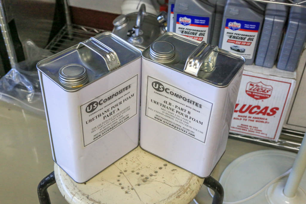

I really like the look of the rear bumper with the diffuser and exhaust tips (my post #135). One issue I had was the bumper felt a little flimsy so I filled it with two part urethane foam. I covered the foam with a few layers of fiberglass to seal it. This gave it a solid sound and feel and added very little weight. Now it’s ready for paint.
Kurtiss I agree that’s why I fab’d a galvanized frame to attach the bumper to like the original GT 40

Good idea Larry, looks great! I didn't want to add any weight to the bumper since I'm hanging it off the rear clip.

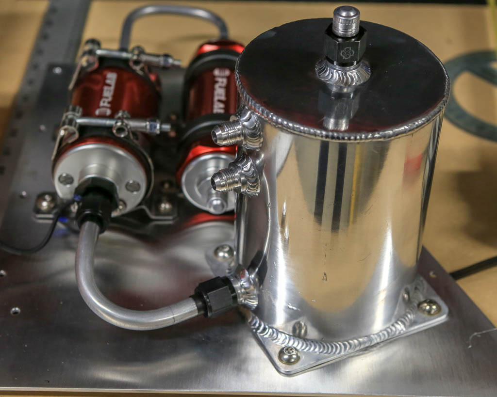

Fuel Tank Mod – Internal Pump

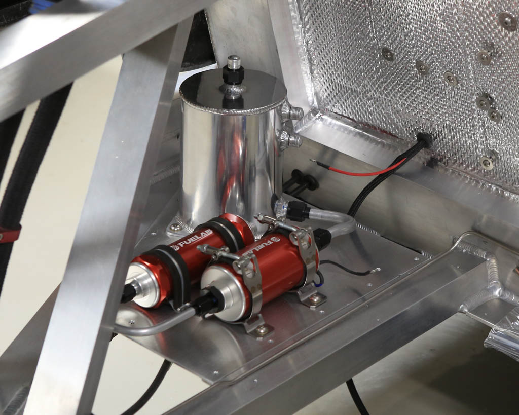

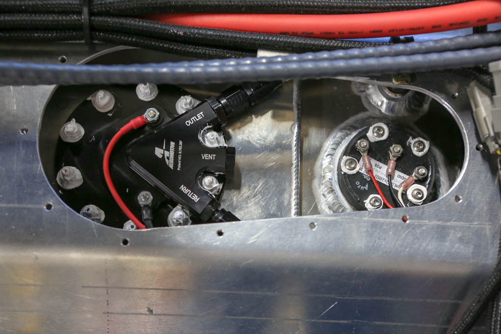

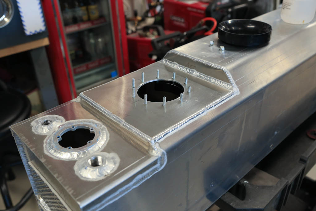

See my post #48. My original design used a Fuelab fuel pump made for a carbureted engine. After talking to one of the Fuelab technical guys, I realized it would flow too much fuel and could actually pressurize the swirl tank and therefore provide back pressure to the return line from the pressure regulator and possibly push too much pressure to the injectors. I needed to replace the low pressure pump with a simple lift pump.

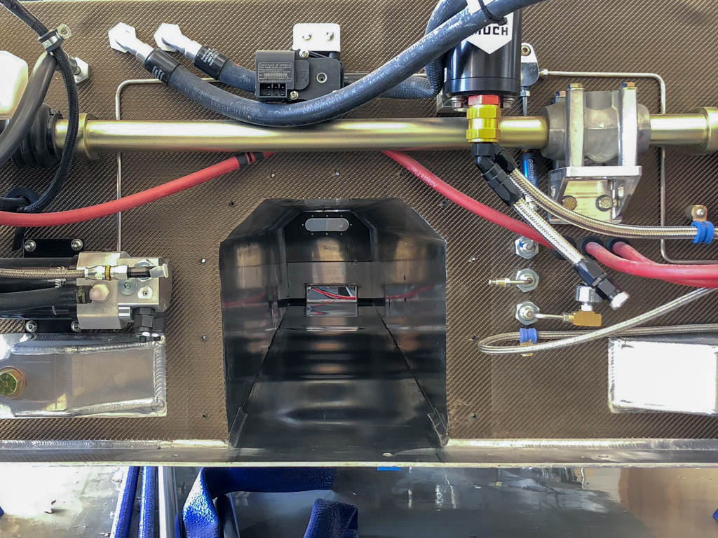

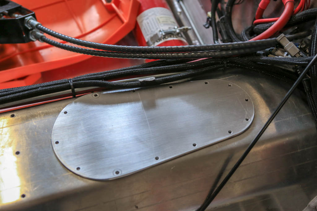

I decided to use an in-tank pump (AeroMotive Phantom 200 Stealth) and move the Fuelab high pressure pump off the firewall. After installing the fuel pump, I pressurized the tank to 5 psi with shop air. I noticed all the pump fasteners were leaking as were the sending unit fasteners. I removed and reinstalled all fasteners wet with sealant (Dowsil 730). I did another leak check the following day with no leaks noted. Also cut an access hole in the tunnel for access to the pump and sending unit – sure makes it easier to tighten the fittings and perform leak checks.

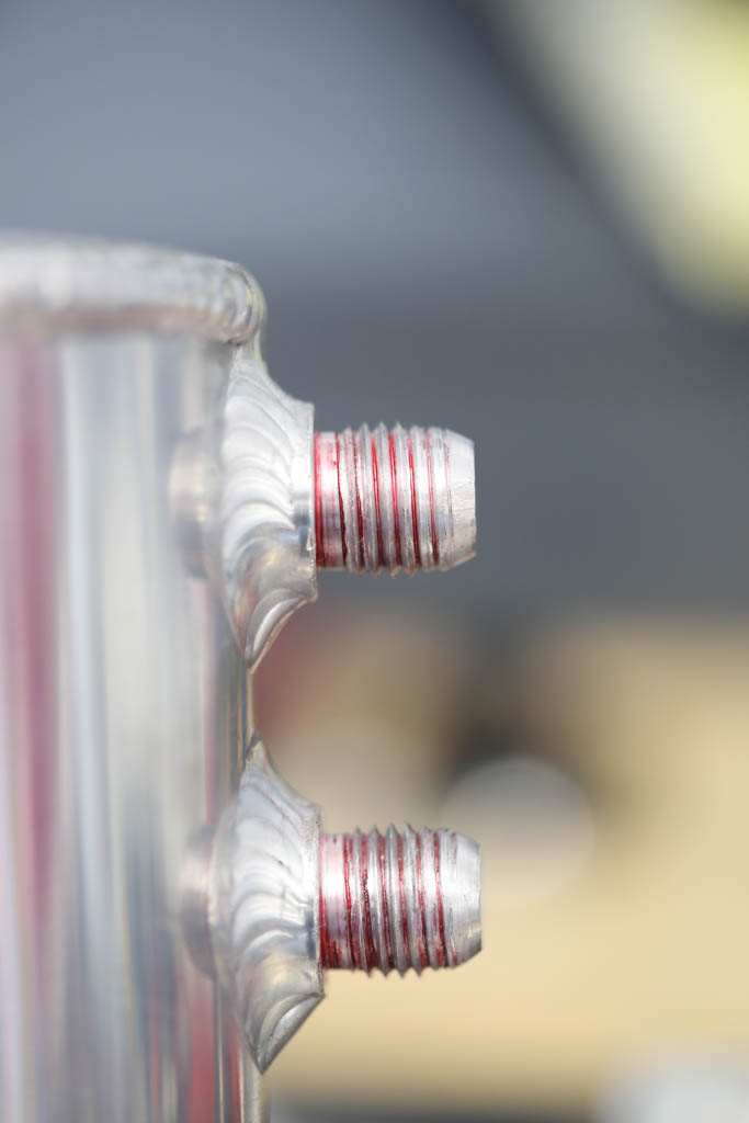

Note: If you use the swirl tank that came with the car, take a good look at the -6 AN fittings. Mine were damaged and had to be replaced.

Good advice about the fittings on the swirl tank. I sent my uninstalled tank to Ron and he sent me a pic showing the fittings damaged. Nice work on your car!

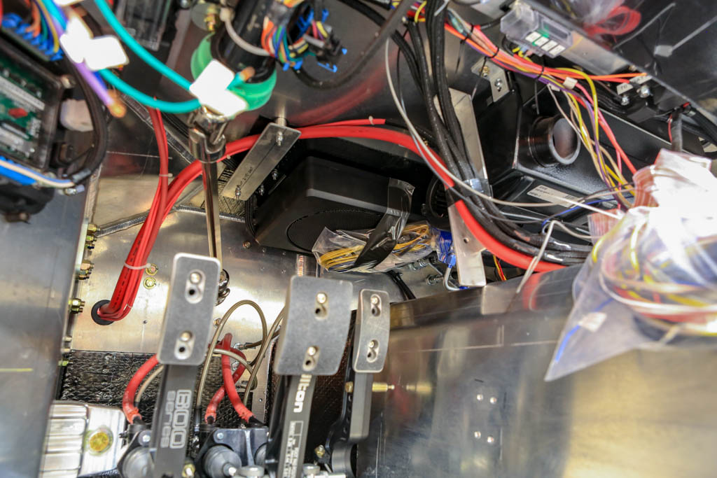

I removed the pedal assembly to gain access to the foot well for insulation. This is a good time to install a Kenwood KSC-PSW8 compact powered subwoofer for the audio system. I found a piece of real estate above the tunnel behind the A/C unit. It’s up and out of the way.

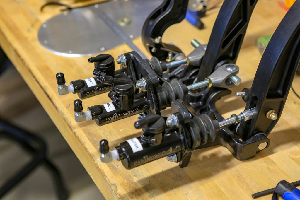

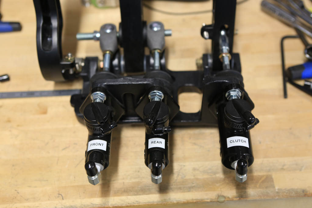

Master Cylinder Swap
I have the basic brakes (Corvette/Brembo) and the Graziano transaxle. Common thought is to use a ¾” master cylinder for the front brakes and 7/8” for the rear and ¾” for the clutch. Thanks to Rufus for letting me know the correct master cylinder configuration on the GT-R is ¾” for front and rear brakes and 7/8” for the clutch.
I swapped the master cylinders and used the PowerBleeder by Motive Products with the Wilwood 45mm adapter to bleed the brakes and clutch. No issues with the bleed and the brakes feel good.
