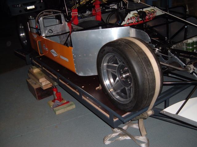

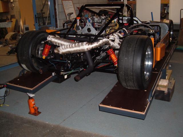

Run the motor for 20 minutes on Saturday, the only gap of fine weather between the increadably wet last couple of months. Motor ran faultless at 2000rpm, a max of 70 degree with both cooling fans running and an auxilary fan throwing air over the general area. I have the temp gauge on the inlet side of the motor and may shift it to a hoter spot for a quicker reading. The carbs which are off an Alfa 133 are probaly pretty close to correct apart from may be a bit much accelorator pump juice. Only a track run will confirm this after I balance the carbs and put on some trumpets. Sounds good. Have now put it on the trailer whilst I wait for the axel to arrive so then can work out the balance. Interesting enough, I had added up all the components and allocated their relative position in the car to come uo with a COG at 910mm in front of the rear axel, it turned out to be 900mm. so we have a 40 / 60 to the rear weight bais.
I will take the car to work and set it up on a flat floor, whilst I think I can figure out the wheel alignment, are there any good instructions on `stringing` the car for toe set up etc.
What sort of tyre pressure do you think I should run on the trailer.
Cheers for the help.

Would this work. After squaring off the car can I set the degree`s of toe and camber using these measurements from the tyre face. There is a ring moulded at 500mm dia so x 3.3 for the circumference gives 1650 divide that by 360 deg gives 4.6mm per degree. Using that figure of 4.6mm then its just a case of getting out the ruler.
Is it that easy.
Is it that easy.
Just about! Pay to spin the tire/rim first to check for runout. Failing that you can use a scriber device to spin against tread center to a acheive a similar result. Car weight may cause sidewall to distort in relation to camber measurements taken this way.
3.1416 (pi ) is factor for circumference. Therefore 500 x 3.142 = 1571mm divided by 360= 4.364mm per degree. Double that if measuring from top/bottom or front/rear of that 500mm circle which would be 8.727mm per degree. ( this is due to the 360° being drawn from the hub center ) accurate enough for a few degrees as in camber & toe.
I find it easier to use the diameter as one leg of a triangle, and use trig and the desired camber angle as the included angle to get the lenght of the opposite side, which would be the dimension you meaure with your ruler
As above for 500 dia, 1 deg would = 8.73mm

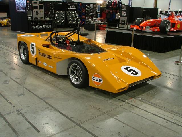

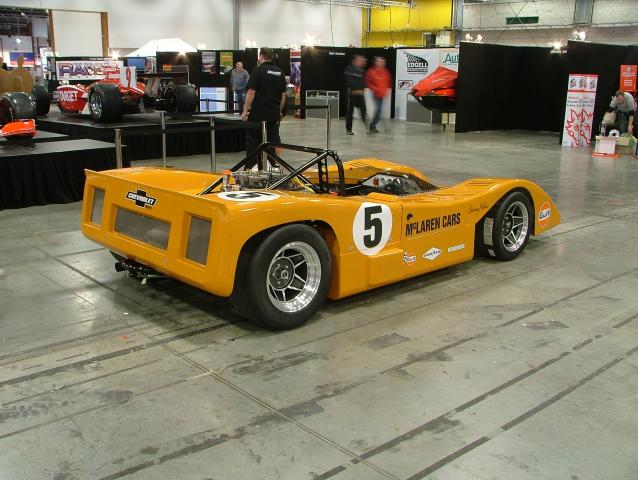

Well at last I have actually driven my car, It has been in the local Speedshow this weekend and come hell or high water, I drove it out of the show and around the car park a couple times just for fun. Boy it sounds great and feels awsome. The show resulted in tremendous reaction and memories from people who lived that era. It was a neat way to celebrate the completion of my car as there was a fair bit of pressure in that the show operators wanted to place the car centre stage beside Scott Dixon`s indy car. I had been working hard to get the car completed for this show so now I will have a break and then set up the car ready for a track drive. I will let you know how the real drive goes in a few weeks time.
Nice going Russell, that must have been a great feeling to drive it out under its own power and to have been asked to display it alongside the other two cars, Well done. Time for a nice quiet sip of your favorite beverage & take a moment to reflect on your achievements.
eh lad, glad to hear it was a success this weekend. returned from aus yesterday and was wacked, so sorry i wasnt there .( 5 days of shopping wif da woman, six pair of shoes and clothes to suit) none for me, but nevermind the next trip is for moi.. ) just for the record Russ, i wasnt going to mention the timing problem. and yes guys, it does sound good. not too loud so the locals should be ok and the whole job would be a credit to any professional builder let alone a first timer. i dont think the T 70 will be as well finished, i'm just not that patient. regards steve
Nice work Russ, looks better than the original car. Keep us up to date on the track testing. I am interested on how your handling turns out and what changes you make to improve it. I have been doing work around the house and not working on my car. I did put a shed in the back yard to give me more space in garage. Now I can get rid of the garden tool rack and make room for my sand blasting cabinet. I am still waiting for the drawings from the Engineering Student. I may start the new chassis in the next few weeks without his drawings, just wanted to make sure they were accurate.

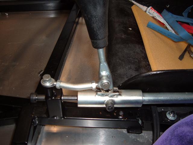

The gear shift system is very simple in this case as I am running an Audi 13 gearbox out of a 1988 Audi GT and it has the rear shifter similar to a VW.
I have used good quality cheap 3/8 drive socket universal joints and turned a round step onto which I have welded my steel tube which just goes as straight as poss to the gear shift which again is very simple. Depending on whether you need to push or pull will determine where you attach the fixed point via the rose joints. The first picture with the rose joints is the actual one I have used and works perfect. The second one, I had made before properly checking the direction required so I gave it away. The shaft is carried in teflon tube bearings and so far all seems fine.
