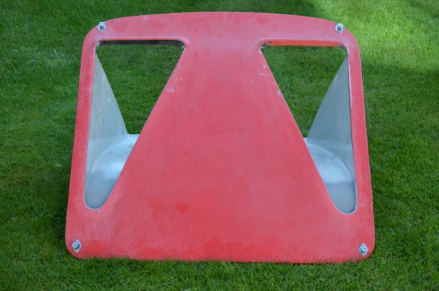

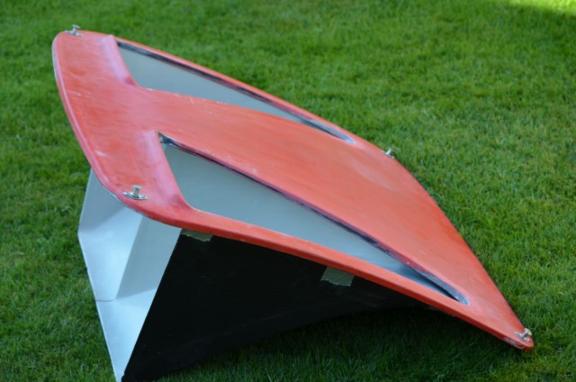

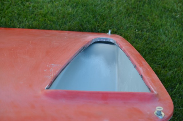

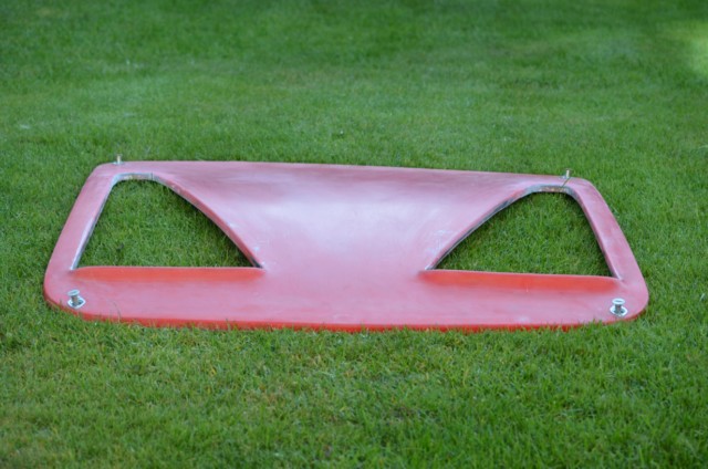

In preparation for paint, i've changed the way i'm finishing the nostril panel. The photos show the detail but basically the lower part will be Matt black and the top body colour. I wanted a more defined segregation of surfaces at the rear than the normal bonded on and blended panels so I had the bottom section sent to me separately and did my own thing with respect to shaping and finishing. I've seen some original cars done this way and wanted to replicate it. It wasn't easy though.

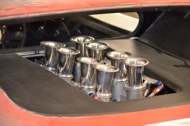

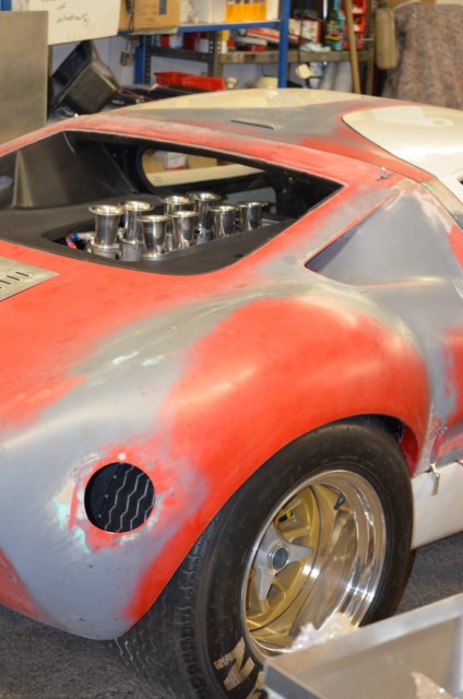

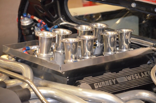

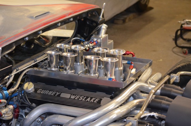

Got my leaning throttle bodies + Turkey tray :happy:
It's coming together so well, I couldn't be more satisfied. All credit to Mick Sollis for figuring out how to do it. A hell of a lot of work, but it's worth it.
Phase two will be to add the stand offs and top V-Tray. Although I'll probably not wear it that often as the throttle bodies and Ram pipes look so good naked.
Martin

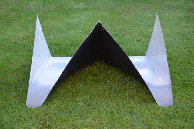

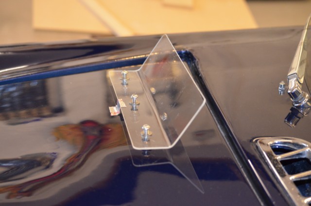

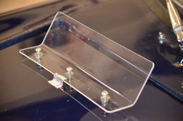

Made myself a bug deflector today.
Shown modelled on my MG. I'll offer it up to the GT40 next week. Nice to be concentrating on the finishing touches.
Martin
Looking @ doing something similar Martin but I'm trying to get the right thickness of perspex.
Also I was looking at the angle being the opposite way round so that fixings are at the back.
I have been looking at polished persex poster holders from stationary suppliers but most are only 2mm thick and it feels a little floppy " excuse the pun "
Really want 3mm and cut it to suit.
Malcolm
Suggest you make these out of polycarb sheet to give it some strength in case it gets clobbered by something a bit more than a bug. Don't want it breaking up! But polycarb is a pain to fold.

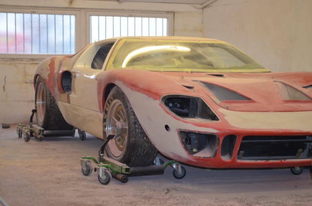

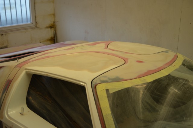

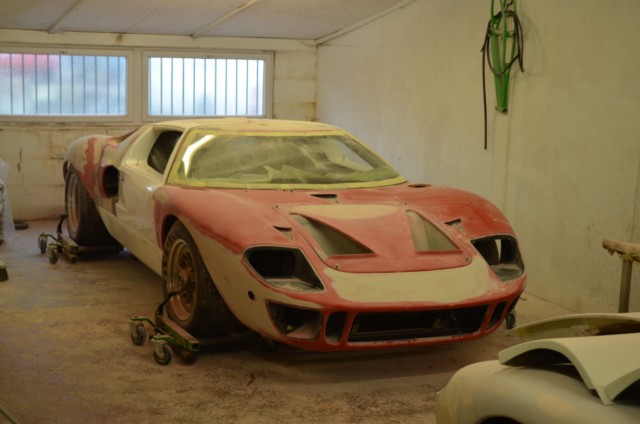

Some pics from the paint shop
Getting there martin.
If you look at where the filler is you can see the usual places where it needs attention.
There all the same
Looking good
Was this the latest MDA chassis Martin? I know that SGT have had input but I must say I like the way the car sits.
From what I remember, the latest (or last) MDA chassis had some nice parts especially the uprights.
Is that a practical ride height for the road?
