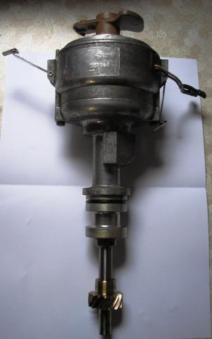

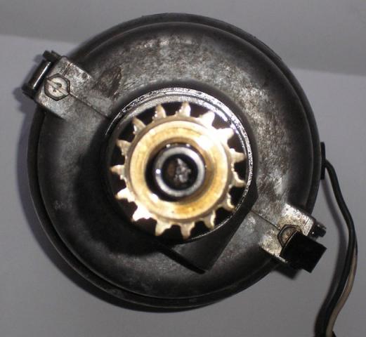

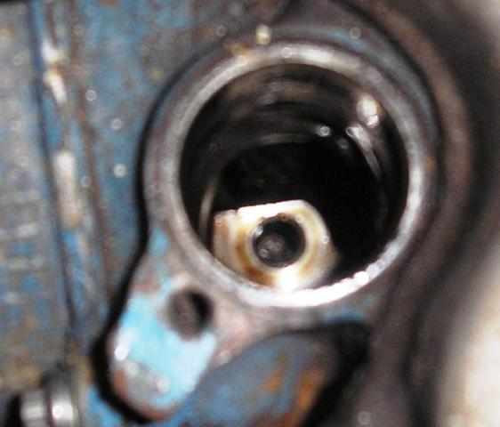

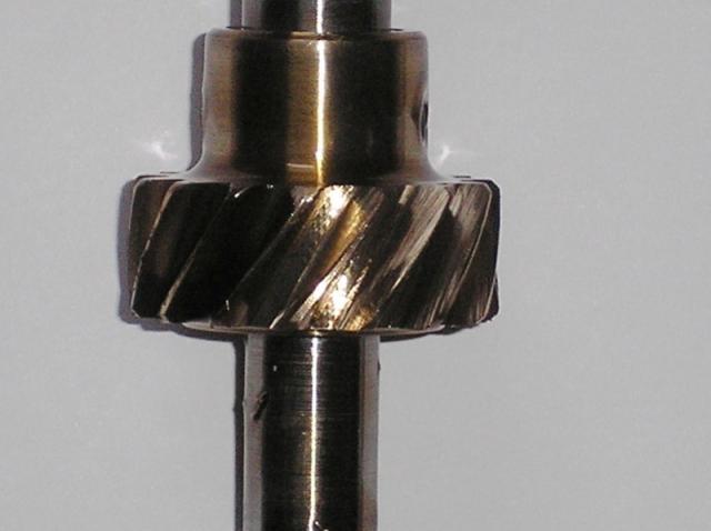

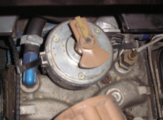

Removed distributor today. Piccies attached below. Although there is some wear on one side of the teeth, maybe sufficient to replace it after the 3000 or so miles it has done, all of the teeth are intact and the drive pin is also complete - checked by looking thru roll pin ;)).
So - what are your comments? I repeat the symptoms.........
popping in carburettor.
turning over but not firing
turning over then "siezing" as if it is firing on the compression stroke
taking 20 mins or so to start
sounding like it is running on 4 or 5 (ish)
running fine for a while
stalling at junctions
I intend to fit the distributor back (for the time being) whilst a new gear(s) is on its way from the states, so that I can carry out a compression test. It is looking, in my eyes, more like stuck valves or HGF (although I cant see why HGF shud happen over winter.
