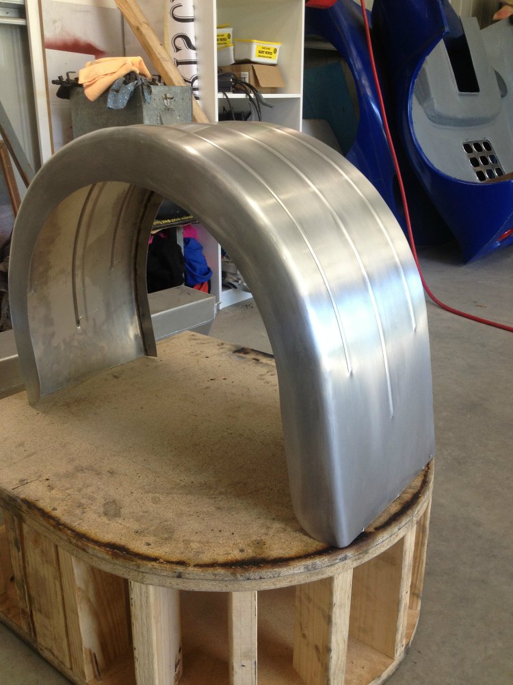

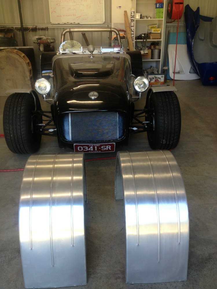

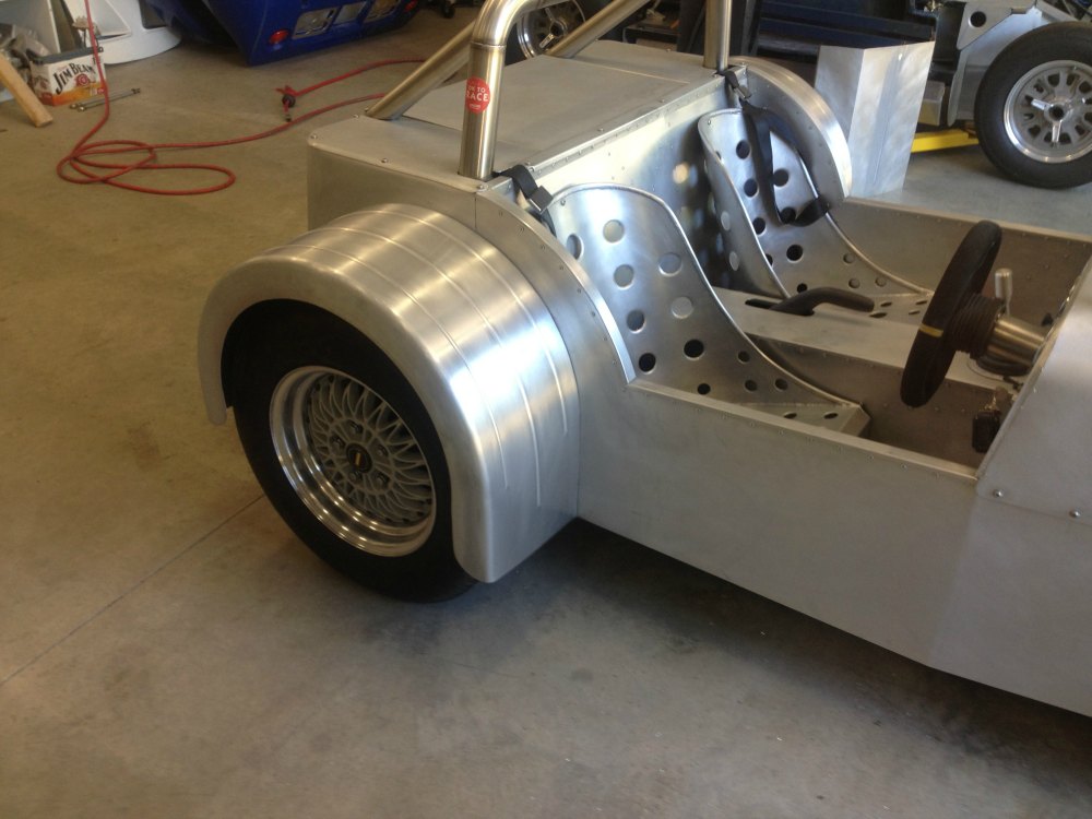

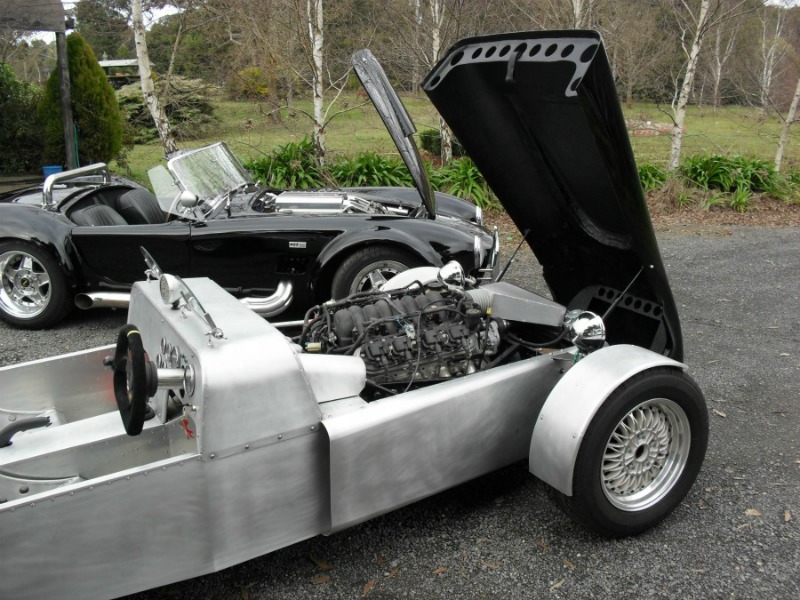

my clubman
I have had it on the road for a couple of years now
and after watching jim cowdens alloy r/f 105 build
decide to have a go at making some alloy guards
I only have basic tools so finish is not perfect wich
will match rest of the car now I need some bigger
rubber as I made them 25 mm wider

Nice, Chris. Built from plans?
I had an original 7 America and a series II Caterham long ago. Built another Locost
a few years ago as well. Lots of fun.

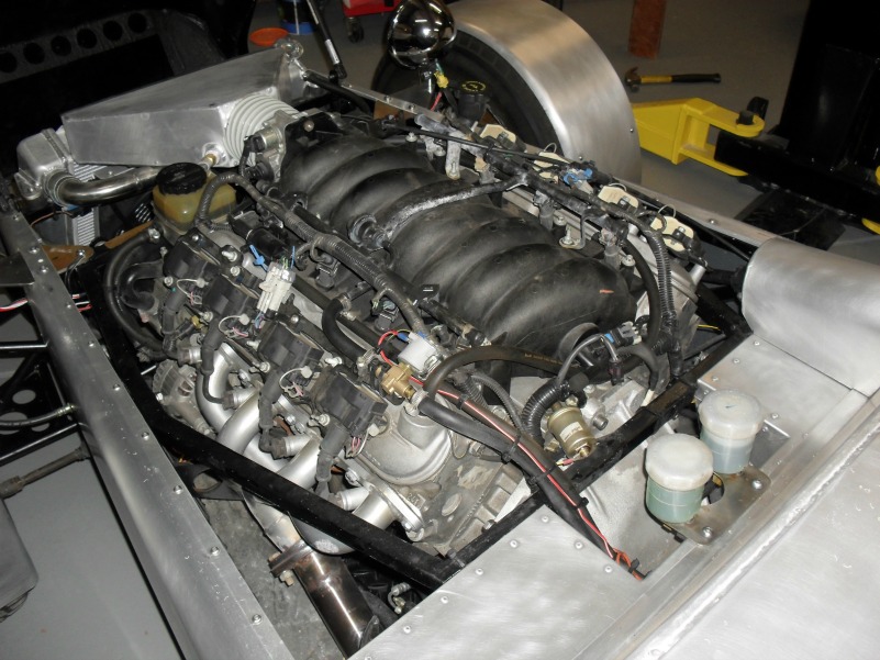

hello jack I had a mate building one that I tried to fit in
but was to tight so took some measurements of it and
made mine bigger as I am a fat bastard it uses pushrod
suspension with springs mounted inboard the rear has
unequal length a arms on indipendant commodore diff
motor is ls1 v8 to t5 gearbox power 260kw at the tyres
and is a little heavy compared to most clubmans at 820kg
chris

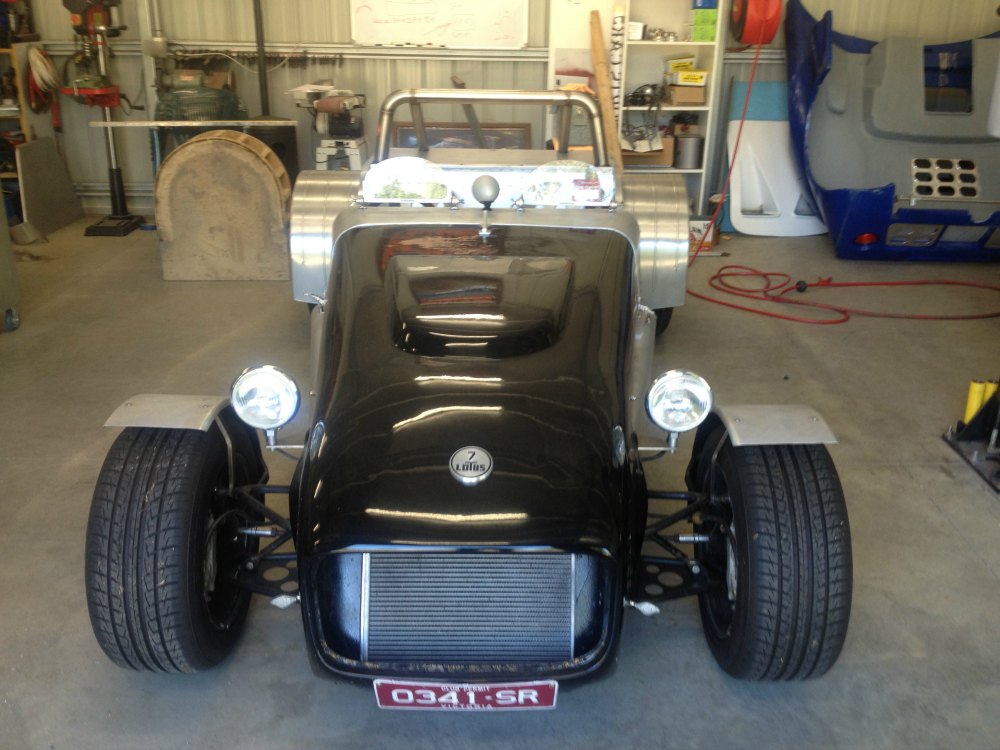

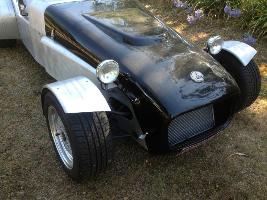

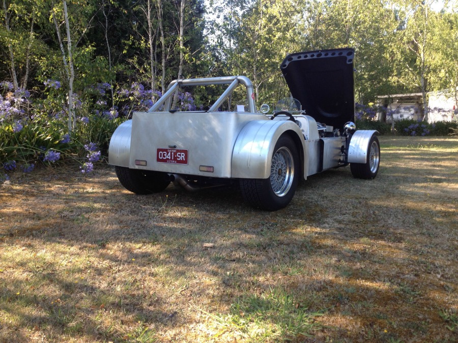

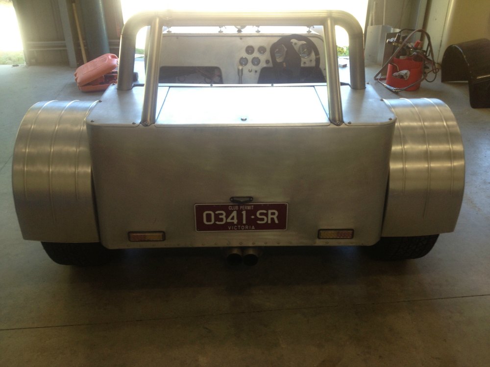

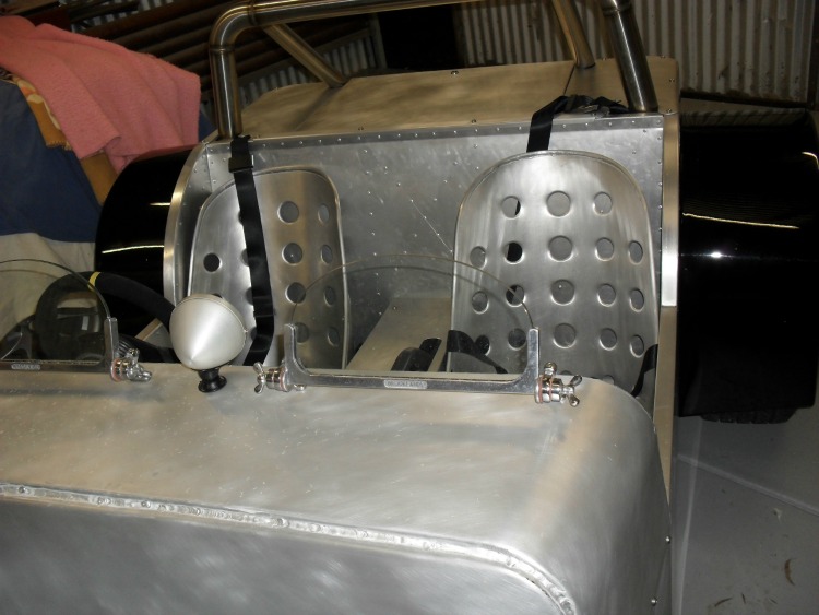

hello some more photos of the clubman may have
a go at making an alloy bonnet next
chris

hello dave the main reason for the alloy body is
I am lazy to clean the car wd40 a rag and all done
drive it in the rain and don't have to worry about the
interior
chris

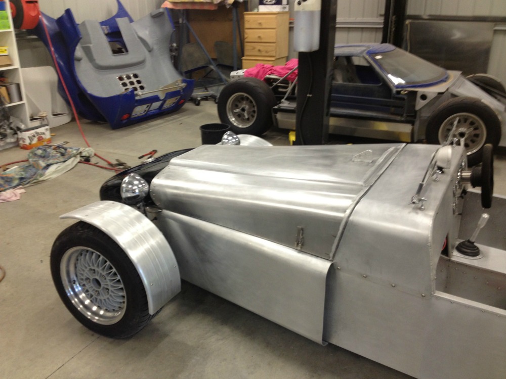

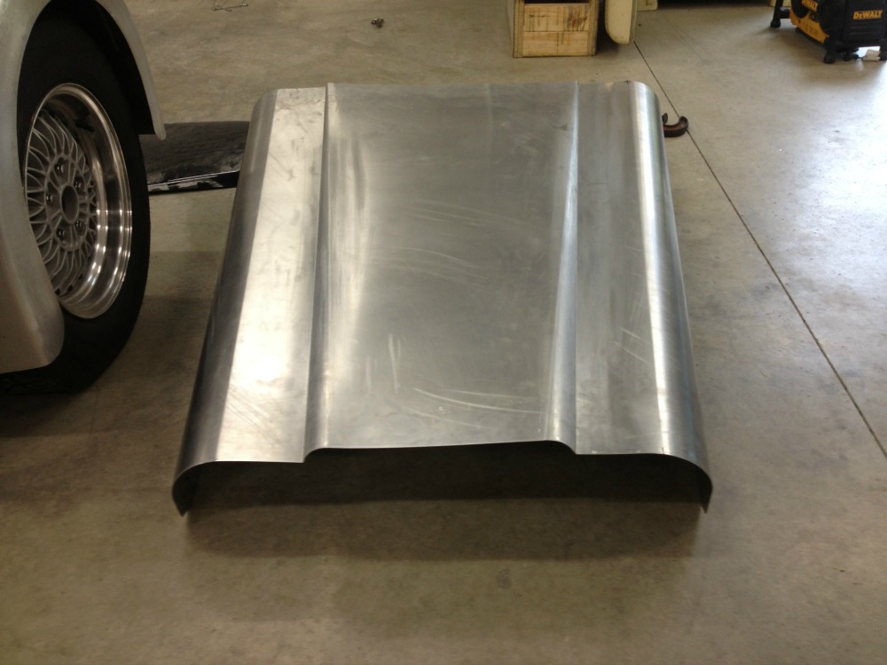

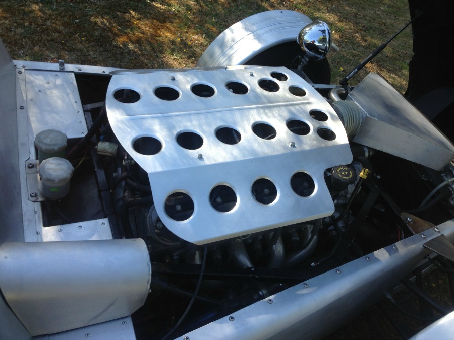

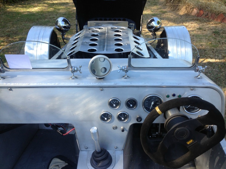

any way I made some front guards and engine cover today so that
is it for now back onto the 40 next weekend
chris

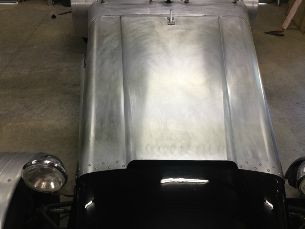

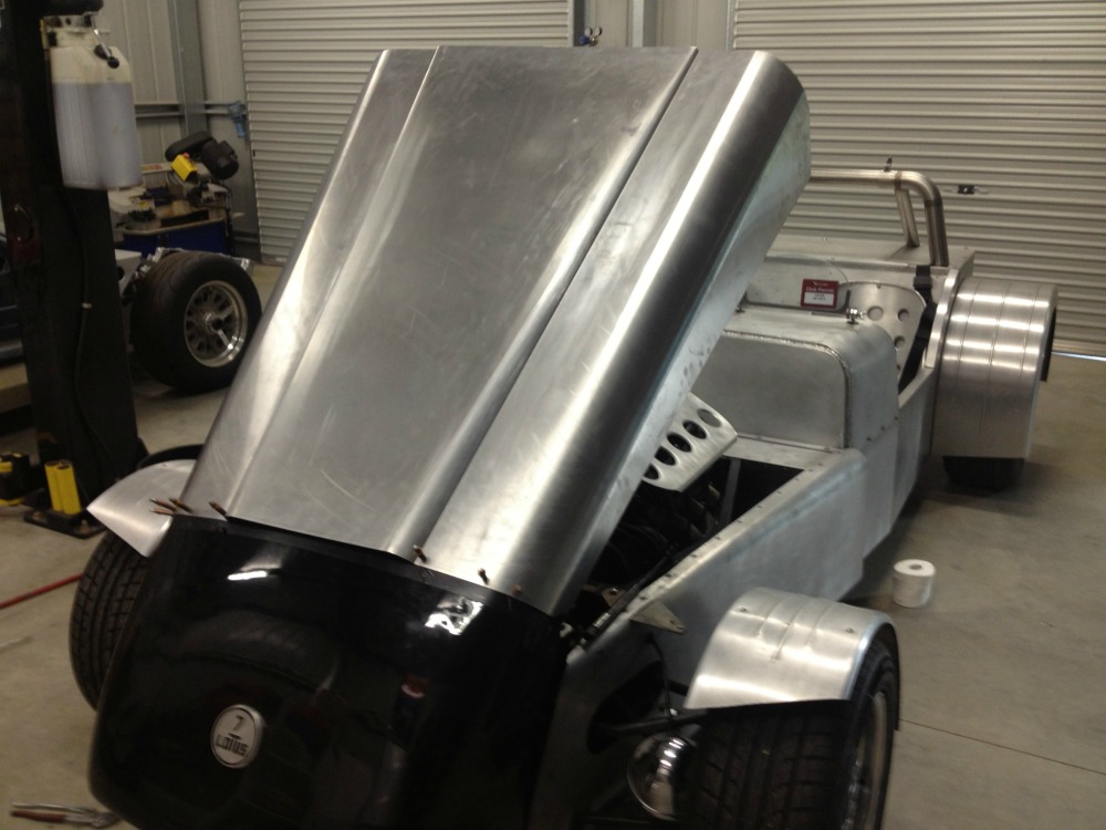

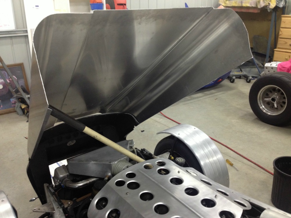

I have finally finished bonnet all I need
to do is connect the gas struts
chris

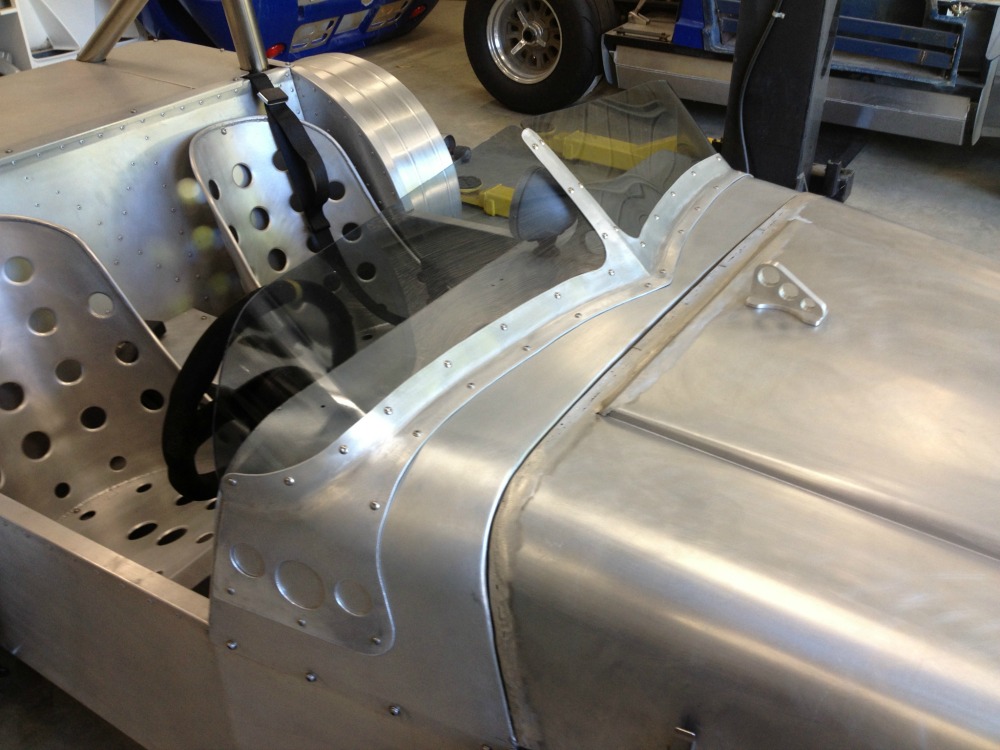

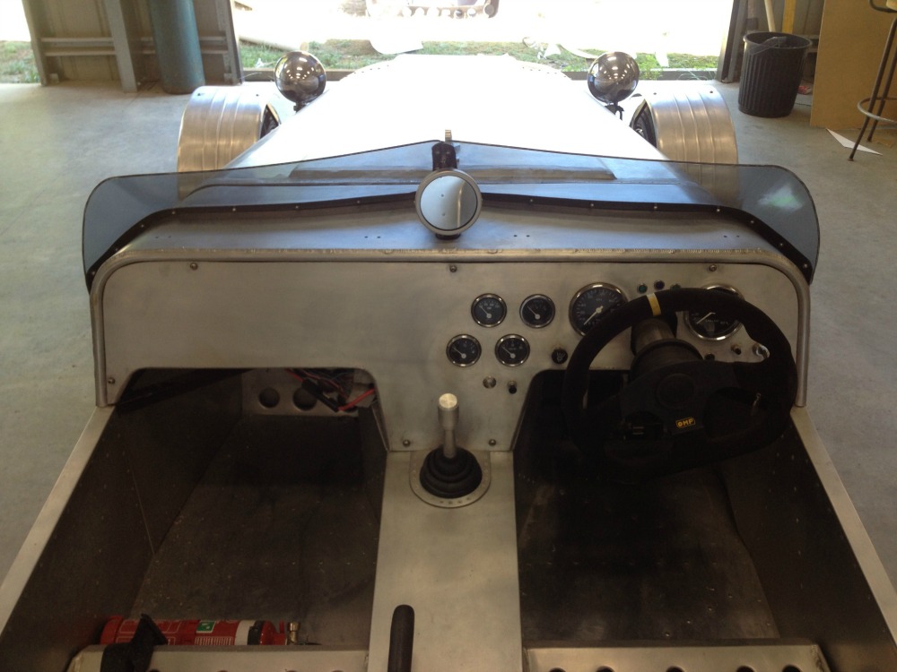

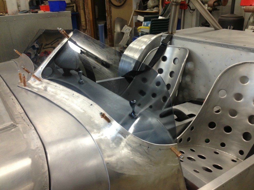

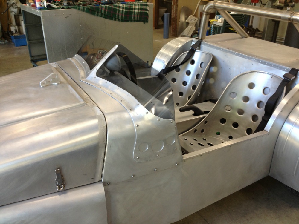

had a go at making a new aeroscreen as the brookland screens
did not give much protection works much better
chris

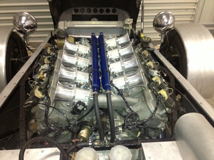

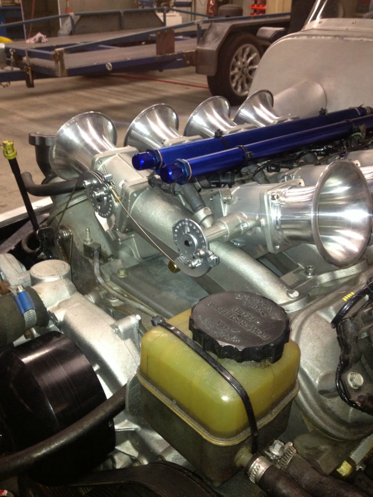

have put a new intake on the clubman quicker throttle responce
and something a little bit different also tried to load
chassis dyno video but could not load
chris
