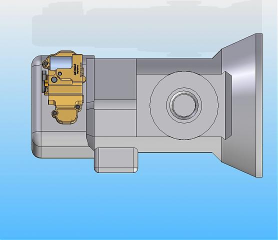

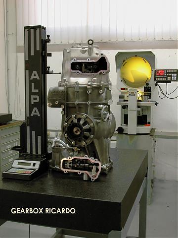

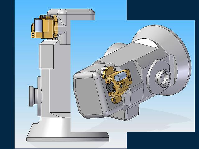

Well done from my side and already automated, if someone is interested.
