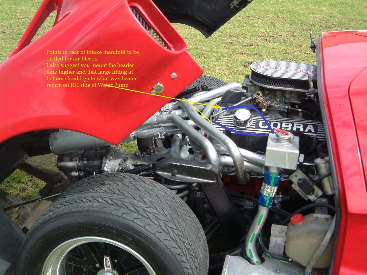

Does anyone know if air in the system can cause overheating? Sounds like a very stupid question. I know air can cause an airlock, which from my Renault Gordini days, meant the water didn't circulate through the radiator at all, but on my 40 the water does circulate and still it runs too close to boiling for comfort. And this was not always the case- the cooling system hasn't been changed. Any ideas?
Yes it can/does and going by this pic you posted of your car you should drill/tap the two rear corners of your intake manifold ( arrows & lines drawn in on pic) for small -3 vent/bleed lines to free any air pockets caught at the rear of the cyl heads. Due to your higher/nose down engine mounting due to the transaxle being used air gets caught at this point.
The bleed lines are just that, keep them small to only bleed air/not pass large amounts of coolant. Also have a check of your cooling system for any possible leaks especially on the suction side of the pump. The two lines at the forward end should go into either the top of thermostat housing or in your case header tank just below the cap. That header tank should also be mounted higher to function correctly.
Sounds like tricky job, but if you grab a spare intake manifold gasket to check where the intake manifold needs to be drilled/tapped to intersect the water opening in the heads its pretty basic stuff. If it was mine I would look into another header tank & mount higher & on the firewall.
You could of course have an engine issue that is causing the engine to run hotter and create air bubbles- head gaskets- ignition timing- water pump speed-low octane fuel etc etc.

Although my engine/suspension configuration has changed drastically from the pic you attached, you are telling me, I think, that air trapped in parts of the system( eg. cyl. heads) can cause overheating even if the basic header tank to radiator and return system does circulate.
Many thanks for your advice jac mac.

Look a little closer at the picture of his header tank. He states in the post above yours that his cooling system has not been changed, and that [** if the basic header tank to radiator and return system appears to circulate **] he is running the entire flow of coolant thru the header tank, but with only one pipe???
In the pic the only connection between engine and header tank is the large fitting at bottom of tank[wide green dashed line]. Narrow green dashed line is from header tank cap to plastic overflow tank. The large fitting goes down before it connects to the water pump or wherever he has it attached [ possibly radiator return tube ] so its extremely unlikely for any air trapped in the cooling system to get to that low point in order to be pushed into the header tank and purged, and I do not see any other lines fitted from say the t/stat housing that might act as a bleed line- hence the suggestion for the vent lines.
Also the car has an Audi or similar trans that places the crankshaft above axle shaft and usually ends up with the engine being mounted in a slightly nose down attitude which in turn tends to trap air in that rear corner of each cylinder head, again the fitting of vent lines helps with this.

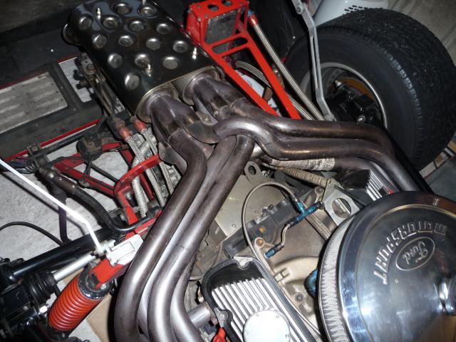

Here is a diagram that has been around for a very long time. Do it like this with the addition of the rear of the intake manifold lines and all your air in the coolant system problems will be forever gone.
Here is also picture of somebody's intake manifold steam port system in a GT40.

Sorry Jac I did say my system HAS changed drastically since the pic. And the header tank, now on the firewall, has both an inlet and outlet of course. The system worked well for a year or two since these changes before it started running hot (possibly after working on it and letting in air).
My question-which you kindly answered- was if air trapped in the system (the example you gave was a cylinder head) could cause overheating even if the water circulated through the radiator and back to the header tank i.e. there was no obvious airlock.

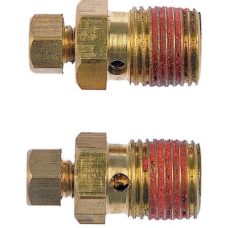

Just one minor thought on this one..... I've fitted "bleed nipples" in a couple different spots (high spots) rather than an open bleed line back to the header tank (or elsewhere). Right or wrong, my reasoning on this has been that I'd like to avoid potentially having coolant flow go through the bleed line on a continual basis, perhaps lessening the flow through the radiator.
The bleed nipple is just a threaded fitting with an internal screw and a port. Basically, you just periodically "burp" the system. I'm no expert on cooling systems but this seems to work pretty well.
