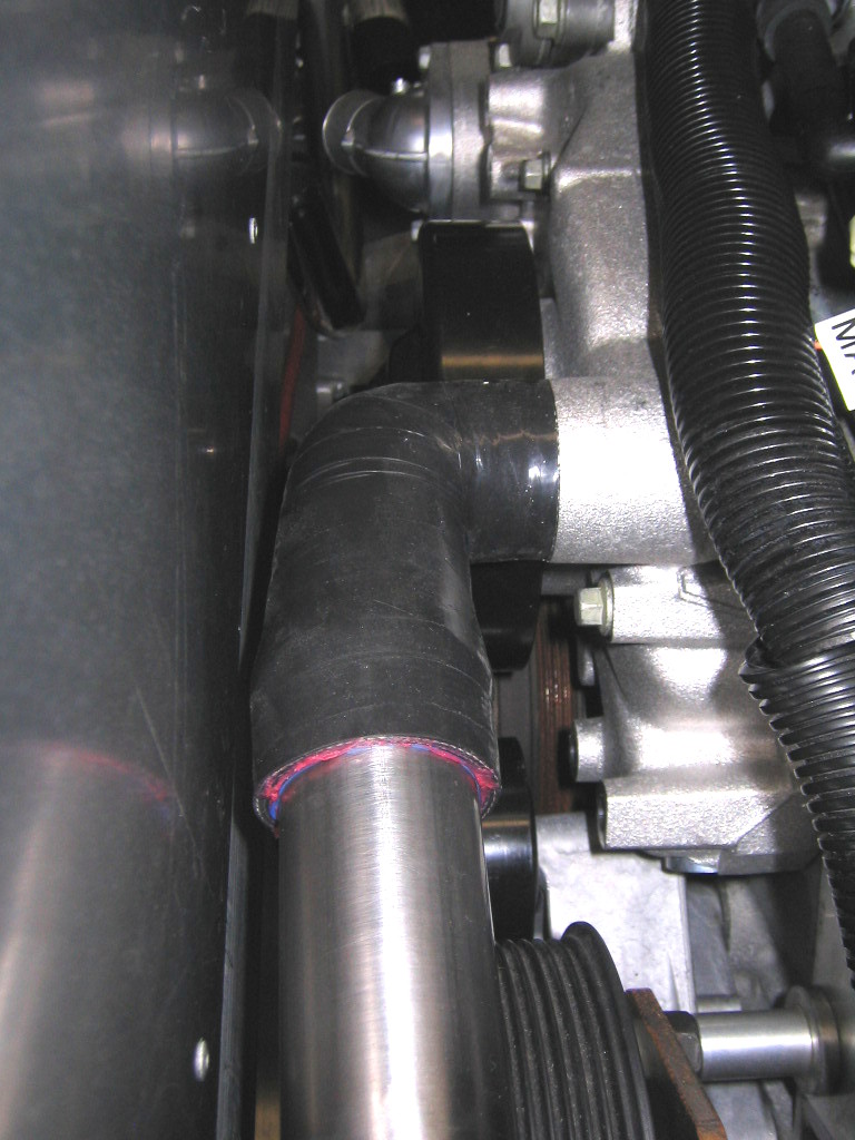

I'm going to take Bill's approach and just shorten the inlet and use a 90 degree molded hose. The thermostat housing can easily be unbolted if it needs to be modified.

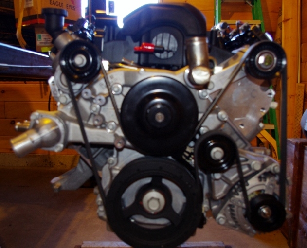

Can you maybe get a little more belt wrap on the water pump & Alternator -- just my 2 cents.
Are those pulleys just idlers? Fooled me, when I looked at the pic quickly I assumed they were OHC cam drives which then got me thinking "what the heck kind of motor is that?" :)
Sorry for thread drift..
