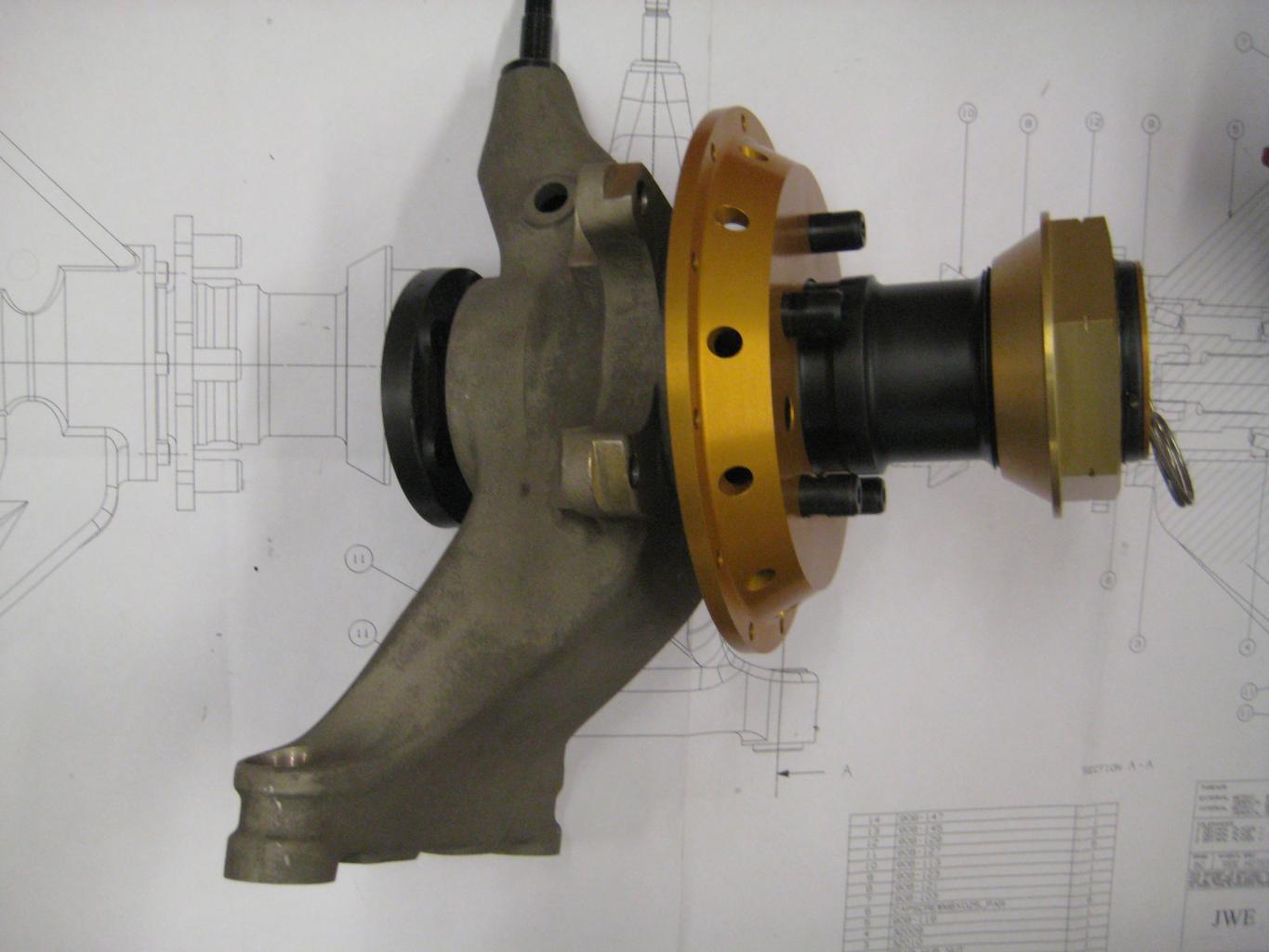

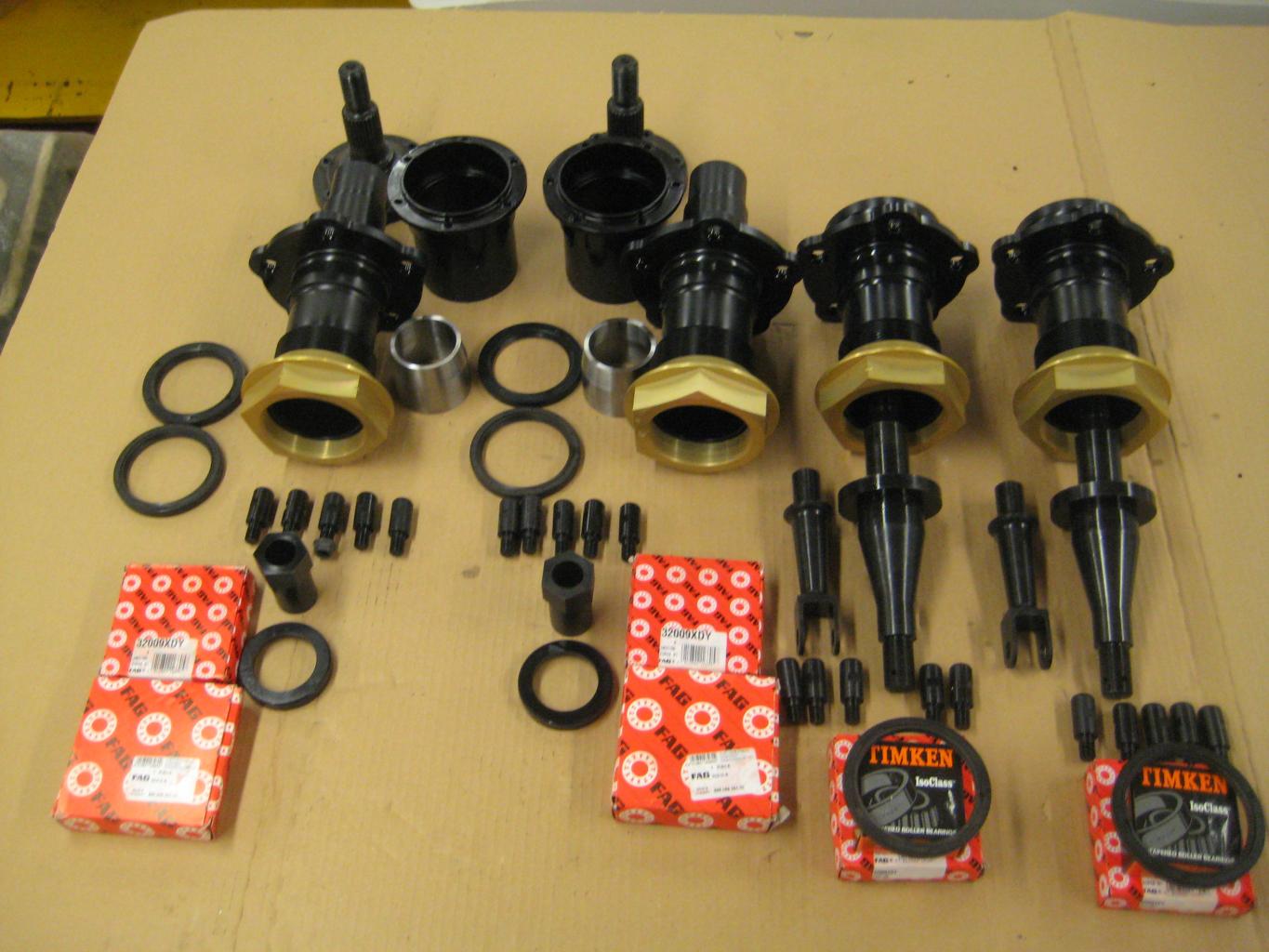

Wheels are replicas of original 15" one ( made by one of the group close to Chris Melia in charge of casting and machining uprights , hubbs and wheels) :idea:
If you want similar parts to built similar récréation car Just PM to Chris Melia he would give you all details for acquiring parts ( now everything is avaible from him and his partners I guess):thumbsup:

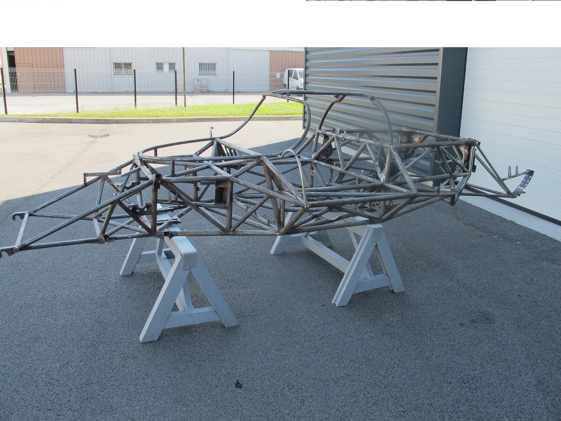

As writted some post aboves long time ago this built can be done by people who have skills in fabricating as tubes kit are to be welded to form the chassis , then bodywork have to be bonded on the right position ; arch wheels are closed so it's along ang precautionus work to do

With tubes laser cut strictly to original drawing redone in CAD and provided By Chris ;
Tackwelding ; 85 hours
Welding only tubes ; 195 hours
Drawing all specific brakets to have these laser cut ; 85 hours
Tackwelding and welding ; 85 hours
Whishbone drawing and fabricating : 257 hours
Upright Provided fully assembled with specific wheels ; then preassembling to
chassis ; 55 hours

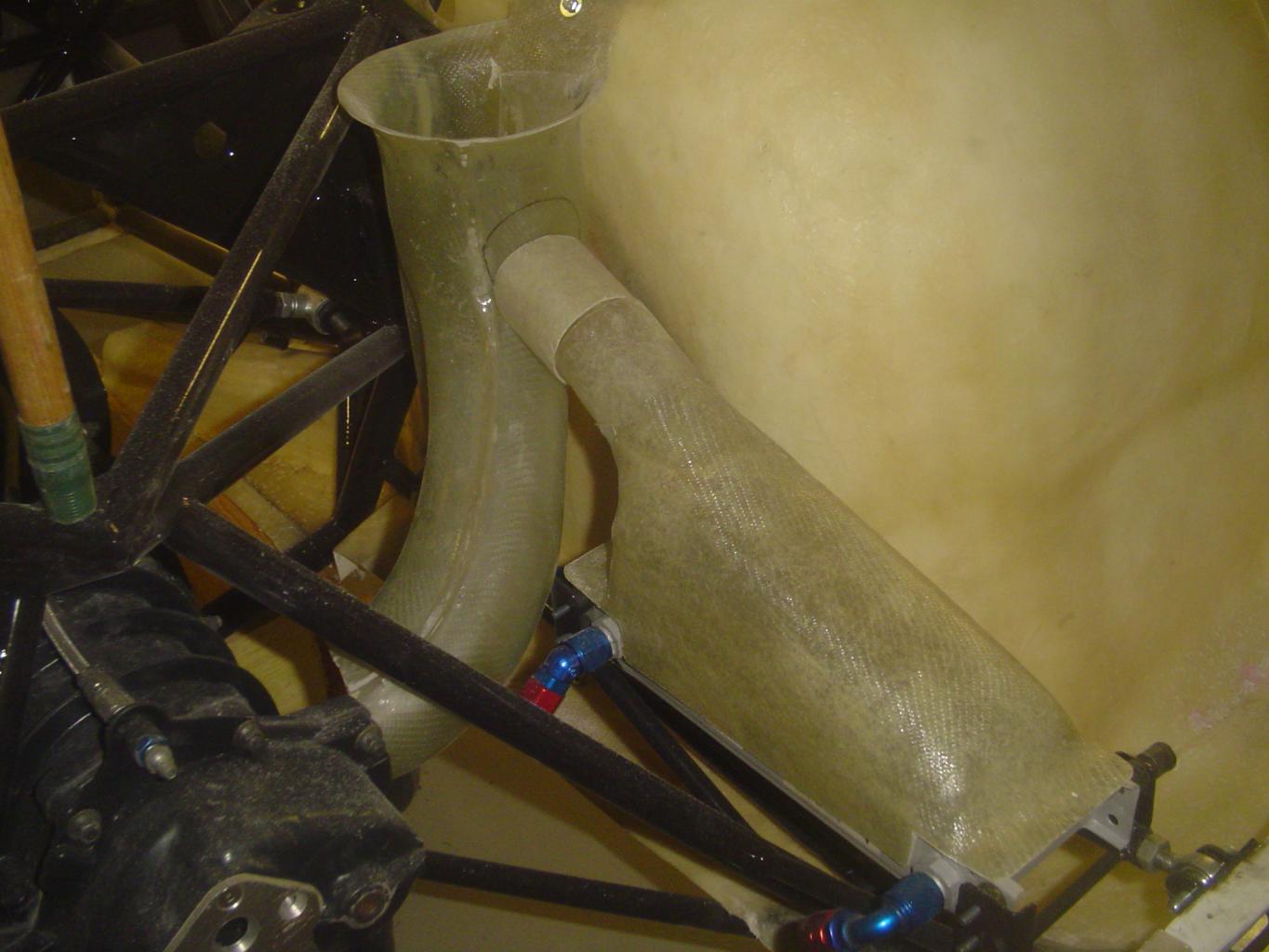

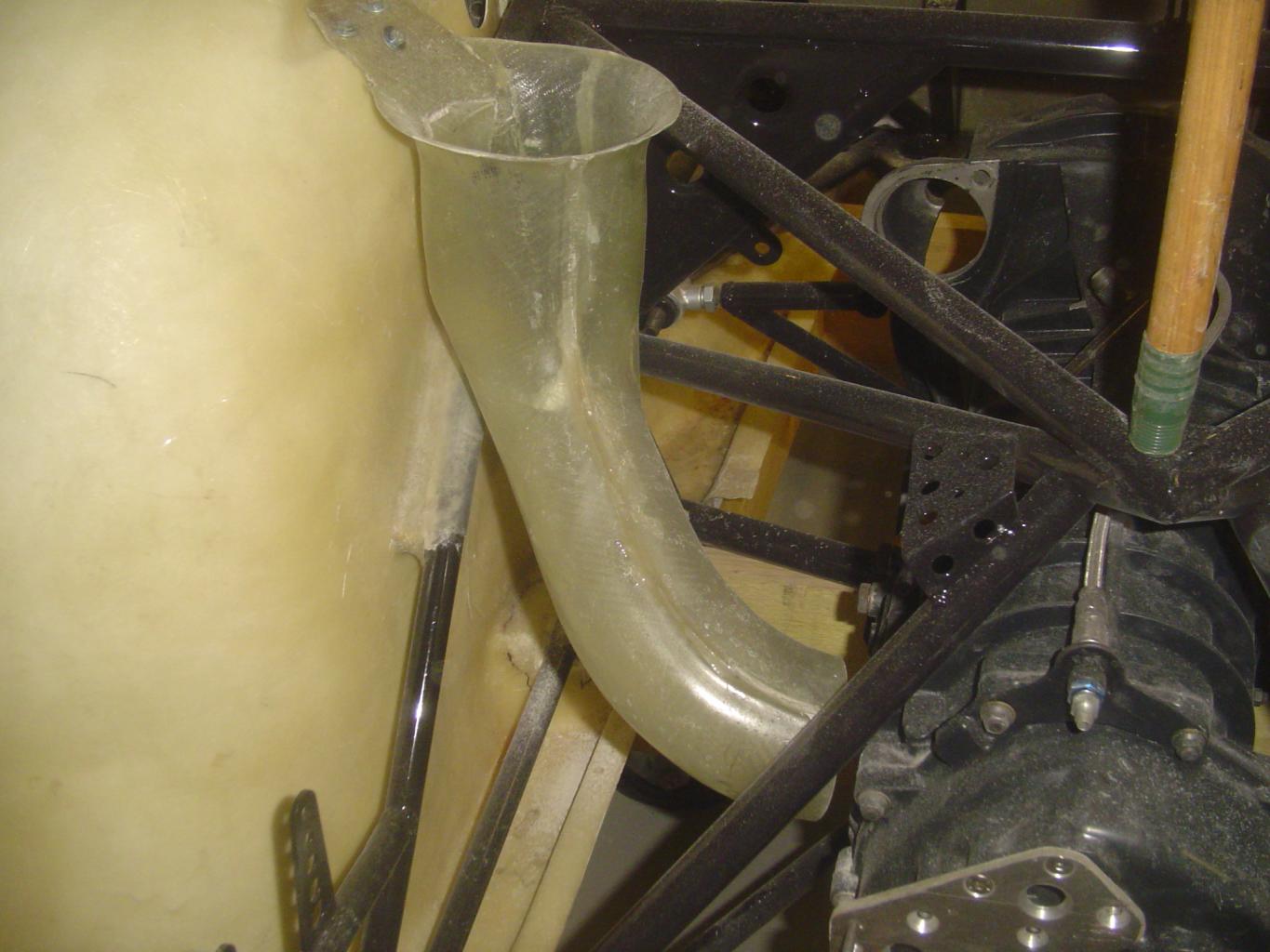

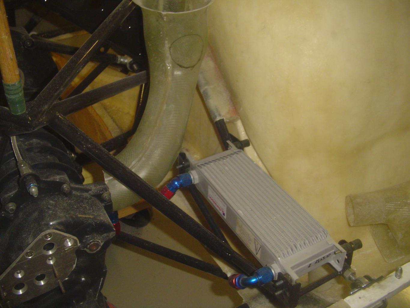

It appears from the pictures the ducts behind the doors in the rear body are only for rear brake cooling. Or is that air directed to other cooling needs as well?
Beautiful work.

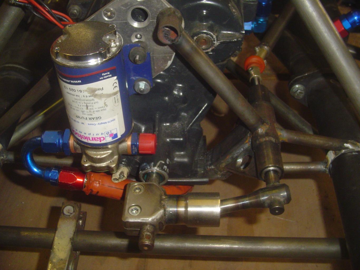

Thanks for your comment
Those ducts are for fresh air to the gearbox casing both sides and the brakes ( below)
The right inside duct one have a small deviator versus an oil cooler ( gearbox oil driven by an electric pump)
Those ducts where strictly fabricated to dimensions and shapes of original ones !!
'(Apologise on dust on parts ; pics are from the engineering phasis!!)
Some pics are better than thousand words :laugh:

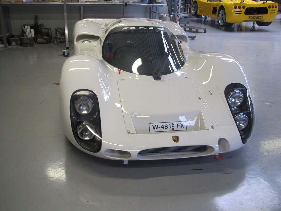

After finishing all small details and all car being achieved I finally was able to start the engine this week !
Video of the first start and injection set up is there :
907 RMS on Vimeo
Now all stickers are on and the car is ready for the first run weekend 19/20 july ; on my city they are organising sort of "small local le mans/rally classic" into the streets of the old city harbour ( 200 historic cars planning to come for parade and regularity laps in closed town circuit )

I have to admit that it is really thanks to Chris ; due to the very neat work his guys did on the fiberglass and also fabricating a round chassis tubes with nice laser cut parts is a real pleasure .
John Whisher did alos asuperb work in doing those exceptional uprights and Hubs
