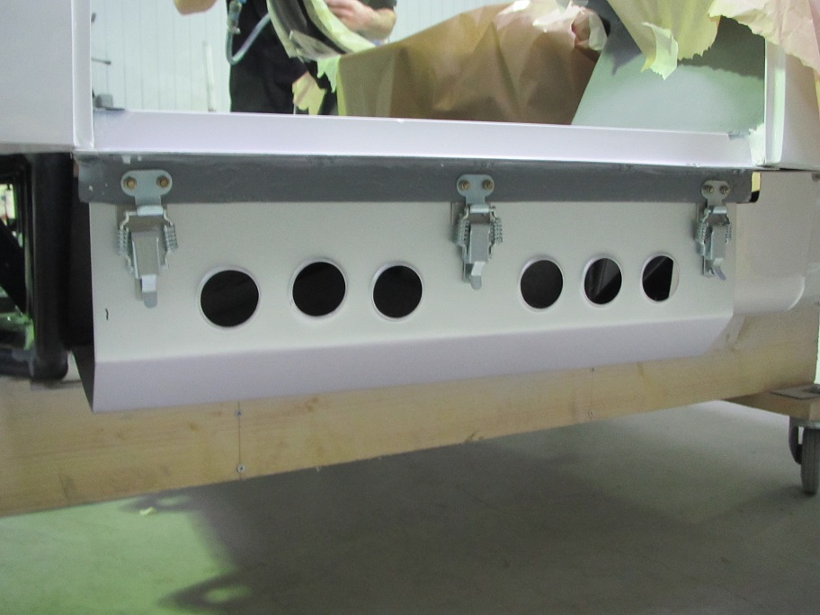

fuel tanks are in the sponson
As I plan to do very short races or parade ( an hour max ) I decided to install only one of the two ; this one is an fully FIA homologated rubber tank filled with foam I enginered and have it done by friends manucturing those cheap in France
The 58 liter rubber tank is instaled behind the driver sill and it is protected and hold by a folded aluminium panel ( see the pic) it have an 70 mm big rubber tube protuding toward rear and a small 7 liters aluminium welded tank is fit into
with an anti splach back valve ;
to this aluminium tank all returns inlet and outlet pump are connected
